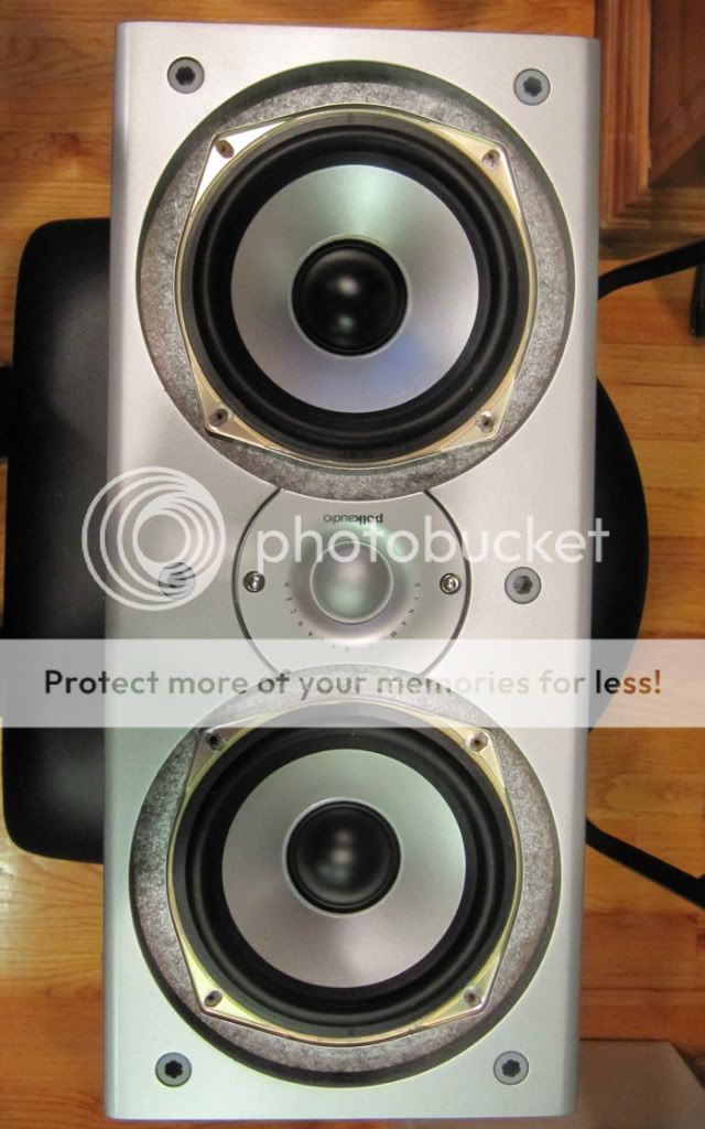

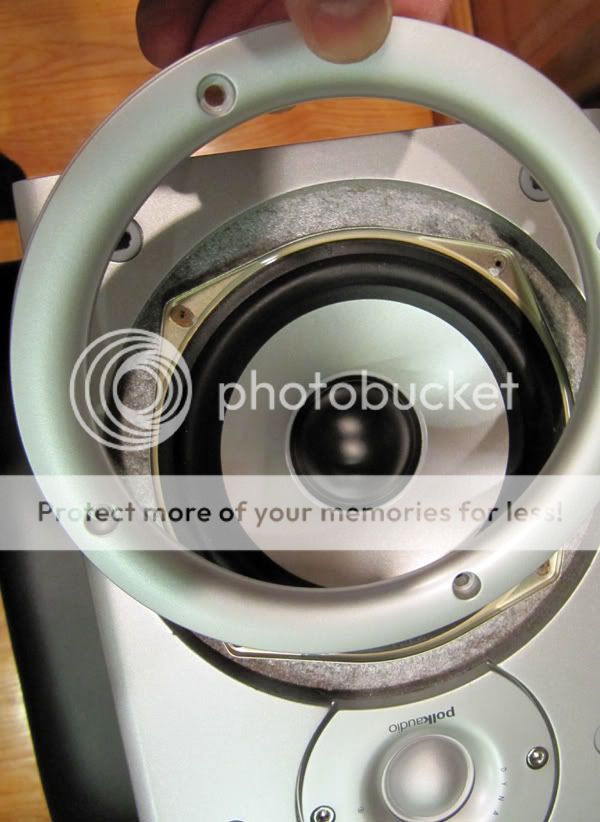

Here's how I did mine. First of all, I did not waste my money on Dynamat, but of course that's completely up to you.
I use Peel & Seal
It's very similar to Dynamat, but a fraction of the cost. Lowes and Home Depot carry it. It's around $17 for a 6"x25' roll!! Works very well for damping and awesome in auto installs as well, where it can get very expensive to cover large panels.
On the MB drivers, I covered the basket and then wrapped the magnetic shield and put a cross on the back of the shield - using small strips of the Peel & Seal. It's light weight so it does not add much mass to the driver. It kills any basket ringing. I noticed the driver rang if I tapped the magnetic shield, so yes, I covered it. I don't think you need to wrap a conventional magnet structure, but since these are shielded, it makes sense to deaden that surface as well.
I had a bit of trouble with the large fastons on the MB's mainly because of the short length of wire. You may have to use a flat-head screw driver to pry them off ? be careful. Take care when removing the leads, especially since you will be very close to the exposed tweeter. Good luck.
Here are a few pics:
