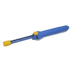

  • TennMan
    TennMan Posts: 1,266
    edited April 2011
    Are you guys talking about having problems with the suckers that have a squeeze bulb or the spring loaded type? I've found that the spring loaded type works pretty good.
  • Joe08867
    Joe08867 Posts: 3,919
    edited April 2011
    The sucker I tried to use was a squeeze ball type. Never tried a spring loaded one.
  • TennMan
    edited April 2011
    The spring loaded suckers are much easier to use. Makes the sucking a one handed operation. You push the plunger in to **** it. When you are ready to suck up the solder you press the button on the side that releases the spring. The spring pulls back a plunger causing a vacuum inside the tube. A hole in the tip sucks up the solder. Prices vary from about $5-$30 depending on the quality you want. Amazon has a good selection.

    Ronnie, That looks like a better solder sucker than I have, maybe that's the problem. The Radio Shack desoldering braid is to narrow for sucking up a solder joint. Anyway the crossovers are all done and the sound went up to the next level.
