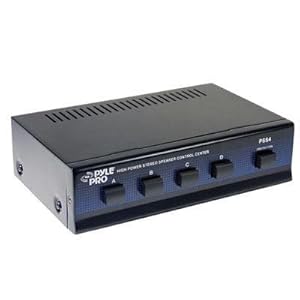

    Thanks, Joe. How do I match up watt RMS using a speaker selector? Do I still want to keep the watt RMS within what my speakers can handle, or more to compensate?

    Thanks, Paul. Is that a better option that if I got a solid receiver and got a niles speaker selector with independent volume control? Which would sound better?
    I think so but it depends on the speakers. A separate amp gives more power which means better sound. My friend uses a speaker selector but he is driving all satellites so it is fine. I am driving some lsi7s (power hungry) so I knew that that wasn't a good option to me. So the answer is more power is always better, but whether the selector will work adequately depends on all the speakers involved.

    My speakers will be either TC80i's or RC80i's (not decided yet)...no big towers or anything. Do dual amp speaker selectors have more power or is it just so you can play form 2 different sources on your system?

    The potential problem is that the speaker selectors take the power from you rear surround speakers (so that you can only do 5.1 if that matters to you) and splits it among however many pairs of speakers you have. Most receivers do not have enough power on tap to do this well. That is why I suggest an external amp like the sonamp if you want decent sound quality. You could also get a used two channel amp and a selector and that would also help with power issues.

    I think 5 pairs of speakers would be tops. I don't care about surround sound at all. Just crisp, clear music. This will never be used for movies or anything. So assuming the selector takes 100W like the Niles, that would mean my RC80i's would get 10W per speaker? If so, is that enough to get fairly loud but not teenager Honda civic loud?

    OKay now I get it. Get a good stereo receiver like the NAD geppy posted in the fs section, get a speaker selector from even amazon or monoprice, and I think that you will be done. I was assuming ht plus section zone like mine. Sorry ;-)

    Thanks for your help. Re: my last post...Do you think 10W will power those speakers enough?
    In short, no.

    It will sound okay because those speakers are efficient. But it wont sound great; wont have much baddfor instance. If its just background music like a department store then its fine, but the sound will be just soso.
