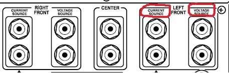

    I bought some Monoprice RCA to XLR 6 foot cables and got a "out of phase" message on my reciever while doing a calibration. While the speakers were just sitting with no audio, I got "poping" noises from the mains via the amp. RCA plugin on Pio SC-37 Elite reciever and XLR plugin on the Sunfire Cinema Signature Edition 405. Checked scematic on the Sunfire manual for the XLR and compared to Monoprice XLR and the wiring doesn't match. Went to the Mackie Speakers page and looked at a XLR plugin and it is different than the Sunfire plugin as far as the pin arragnement with hot and cold. What gives??

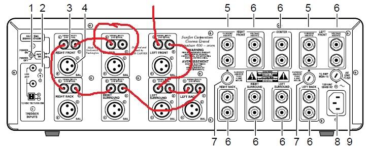

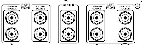

    You guys are misleading bsoko2. He's talking about the DUAL RCA INPUTS on the Sunfire. They are intended for being able to bi-amp (or MULTI-amp) from a single source by daisy-chainging from one channel to the next. It's fully possible to drive 7 channels/speakers from only one input this way. Pretty cool feature:
    The Current/Voltage tap OUTPUTS are separate:
    THESE can be used to separate the voicing (Current = tube-like) between upper/lower range of your speakers.

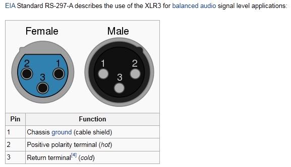

    bsoko2 wrote: »
    Going to get my $$$ back. I was wondering why the Sunfire XLR and the Mackie XLR are wired different?
    Sunfire pinouts follow the EIA International Standard for balanced pinouts:
    EIA Standard RS-297:
    So your Mac must be WRONG!!:biggrin:

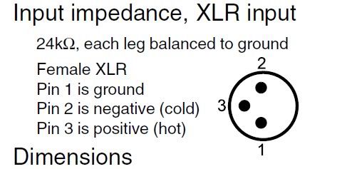

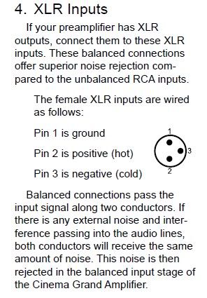

  • bsoko2
    bsoko2 Posts: 1,449
    edited March 2011
    The sunfire grand signature edition 5 channel 405 wpc manual has the XLR as;
    1 is ground
    2 is negative
    3 is hot
    misprint or was Carver ahead of his time????

    Tour2ma Posts: 10,177
    edited March 2011
    TNRabbit wrote: »
    Sure we are... :rolleyes: ...that's why he said this...
    bsoko2 wrote: »
    There are dual RCA jacks on the back labled Voltage Source and Current Source.
    So get your little pic back out and circle the RCA's labelled "Voltage" or "Current".
    More later,
    Tour...

    There are NO RCA jacks labelled Voltage/Current; there are SPEAKER BINDING POSTS labelled Current/Voltage as I showed in the following post.
    TNRabbit wrote: »
    These amps are incredibly versatile.
    bsoko2 wrote: »
    1 is ground
    2 is negative
    3 is hot
    Tour2ma wrote: »
    Here ya go: :tongue:
    As I said above, the SPEAKER outputs are the V/C taps. The RCAs aren't labelled at all. One is for input, one for output---makes no difference which you use. So bsoko2 was confused as far as I know.
    Do you have the pic from your manual? Are the same pins labelled with the same numbers? I pulled my pic directly from the Cinema Grand Seven manual...I pulled the pic below from the 400x5 manual on Sunfire's website:
    Weird; that model is different for some reason...??? Is the U.S. standard different from International Standard?

  • bsoko2
    bsoko2 Posts: 1,449
    edited March 2011
    Quoted from stereo_buff on carveraudio.com:
    Quote:
    Originally Posted by stereo_buff
    The same condition exists with the ~two stereo amplifiers; the manual claims that pin 3 is hot, 2 is cold. The de facto standard is, however, the reverse: pin 2 is hot, 3 is cold. I asked Bill at Rita's and he said they changed the units over during production to the latter configuration but failed to revise the documentation. His advice to me was to try it - if it's wrong it will be out of phase.
    With this info from stereo _buff, my carver amp XLR is wired wrong and is wired as per the manual. Monoprice cables were wired proper and that is why I got a "out of phase" warning from my reciever during setup.
    Bill
  • TNRabbit
    TNRabbit Posts: 2,168
    edited March 2011
    Bill, you might consider going inside the amp & swapping the wiring to the two XLR connectors. That would probably be the easiest fix.
