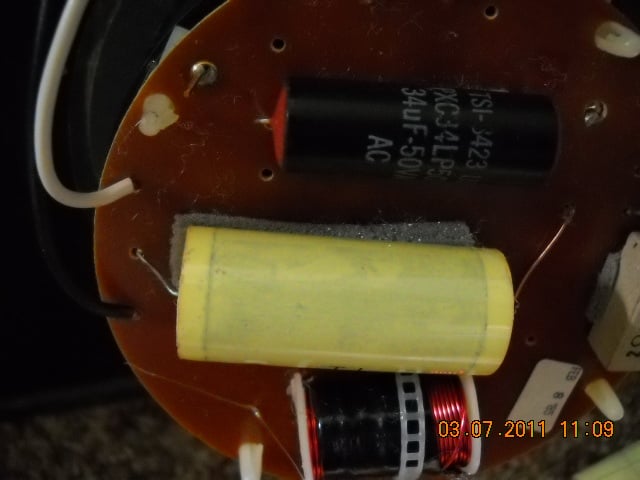

Just got out my Polk 7Cs. I have owned these since in the Navy in the 80's new.
1 woofer is cracked out of the pair.
Everything else looks good
Been going over some of the old threads.
What is available to replace the woofer MW6502, (should change both of them out)
Maybe change the caps and the SL2000 tweeters?
Crossover BE0700-A
Are these 8 or 4 ohm?
I'm very good with a iron, but need to have a list with some part #s if possible
Thank You
Jim

    Just look for another 6502. The caps should be changed, and most folks prefer the RDO-194 replacement for the SL2000. You can get them from Polk for $48 shipped if you mention that you are a Club Polk member,

    Crossover schematics are in a sticky at the top of this forum page. However, it's best to verify the part values on the actual crossover.

    Just ordered 2 RDO194 and 2 mw6502
    Now what about the Caps
    TI E-0012-1 12J100v USA
    TSI 3423 PXC34LP50TF 34uF-50 VAC AC Mexico
    You all have had more experience than I
    Where can I get these
    Thank You Again

    A thread I started will answer a lot of questions for your. I have monitor 10s but most of the tread will apply to your 7s.
    Click here: Tweeters or Capacitors First?
