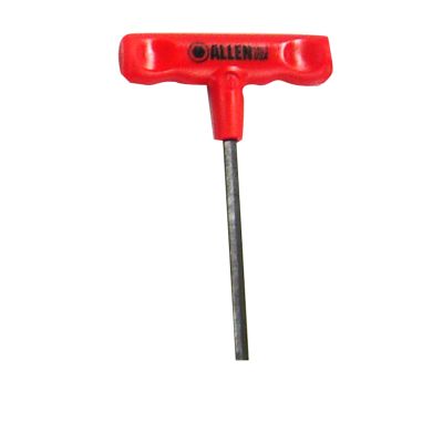

Ok, First off I am VERY happy with the rings that Larry created and offered to us (Toolsforlife)....The craftsmanship and results are outstanding!!
My question...Now that they have been installed for awhile they keep wiggling loose. Is there anything I can add that will keep them inplace? I don't mind going around and tightening them every month, but the last time I accidently cut the rubber because the allen wrench slipped.
Any ideas? (besides slow down...ha ha)
Post edited by Hamatym on
  • Audioquest
    Audioquest Posts: 104
    edited October 2010
    Hamatym wrote: »
    One idea might be to buy a T handle allen wrench so the operating end is away from the driver. Another might be to use lock washers on the screws so they don't work loose.

    Thanks Guys! I will try the loctite and see how that goes....I do not have Mortite, and trust me I tightened them VERY tight. I feel the basket will bend, so I want to be careful.

    ok, I got the Blue loctite and applied them to my first set of speakers....very easy to do and I feel this is the correct route to go.....Thanks for the help guys!
