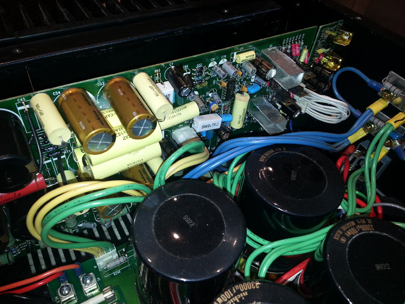

    Great pics, DC.
    I run a 2200ii. What do you think would sound better, an upgraded 2200ii or a stock 3500?

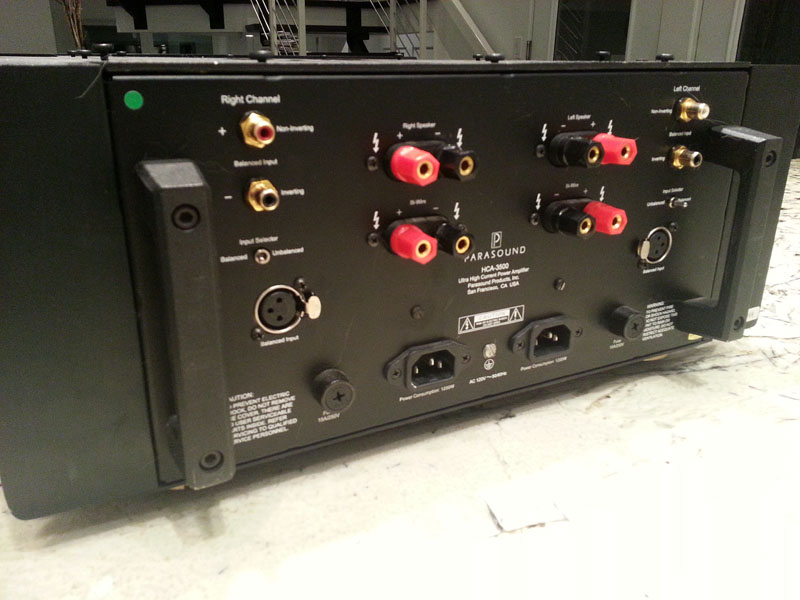

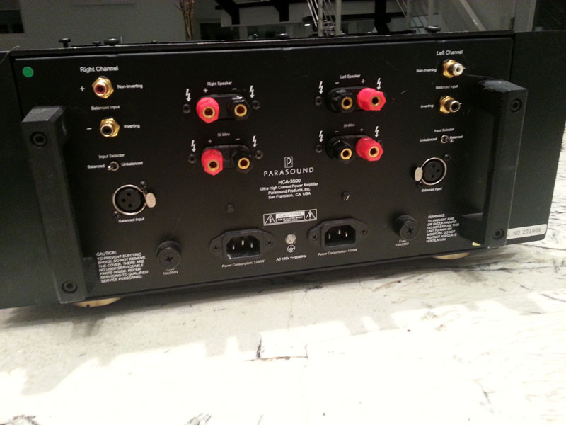

    Also, what's up with your unbalanced inputs being labeled balanced? Did they do that on all the 3500's???:eek::tongue:
    Holy crap! I never noticed that! It is always so close to the floor, I don't see it. That is actually a new rear panel sourced from Parasound. The original was damaged during shipment from the person I purchased it from. Now I need to go check out the original!!!
    That is a tough call on the upgraded 2200II versus stock 3500... But I would put my money on the upgraded 2200II. The 3500 was a little harsh on the high end stock, the 2200II does not exhibit that behavior, and I can only imagine would get better with upgrades.
    Don

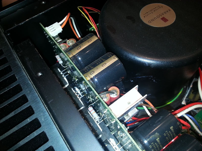

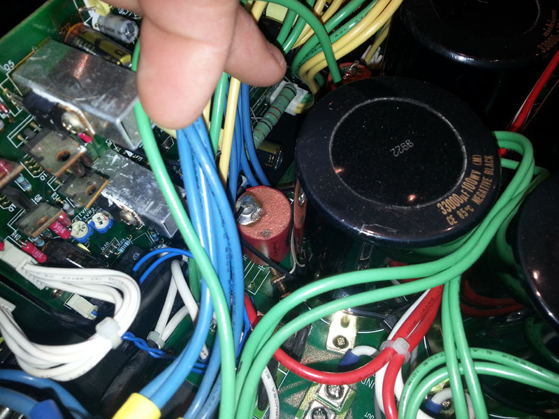

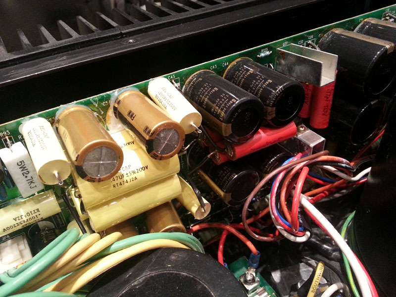

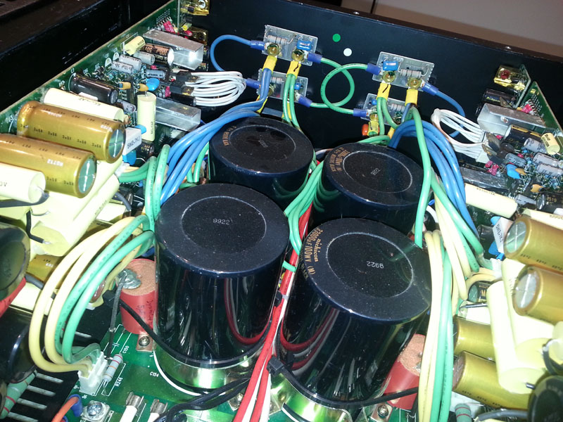

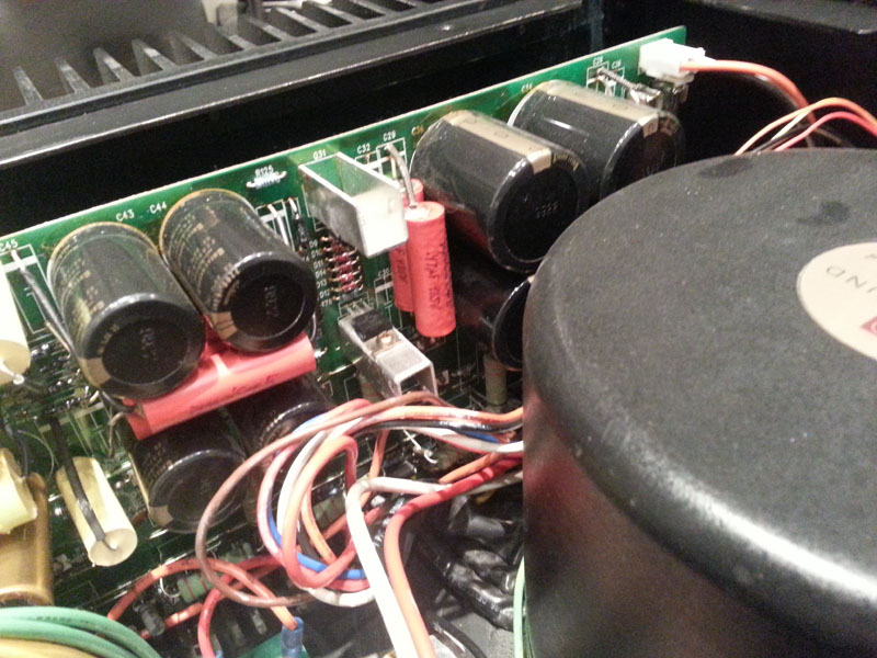

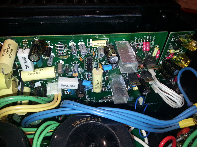

    I will have to look it up again... I had a lot of extras done outside of the standard upgrade he had at the time. Looks like he has added a lot the options he developed during my upgrade with John Curl to his basic mod and then added 2 additional upgrades. Based on his current pricing, what I had done looks like it would cost $883.
    I have the base upgrade plus Rubycon Black Gate capacitors and REL AudioCap RT polystyrene capacitors for driver/output stage and power supply bypassing.
    It is worth it IMHO! You can read my many rants and raves in this thread about just how wonderful I think it is!

    Both caps are fine and both brands are used in the CTC BBQ.

    I think the nichicon muse will be just fine. A very good capacitor. In my 3500 I wanted to pull out all the stops. I am not sure on the cost of this, but you might want to ask about the REL AudioCap RT polystyrene capacitors for driver/output stage and power supply bypassing. I think this is more worthwhile upgrade than the blackgates. I just did those to push it to it's limits for 2-Channel. My amp still has the nichicon caps in it too, blackgates are just used in a few key areas.

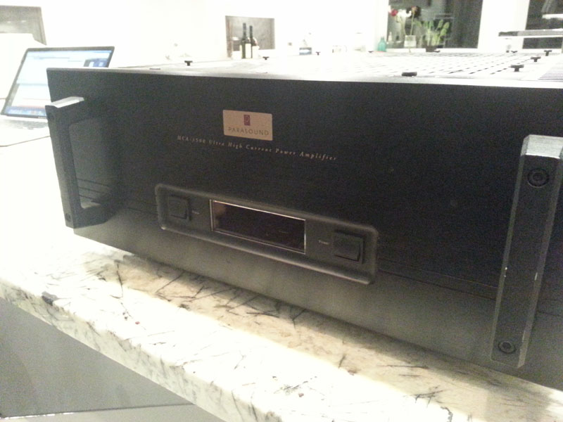

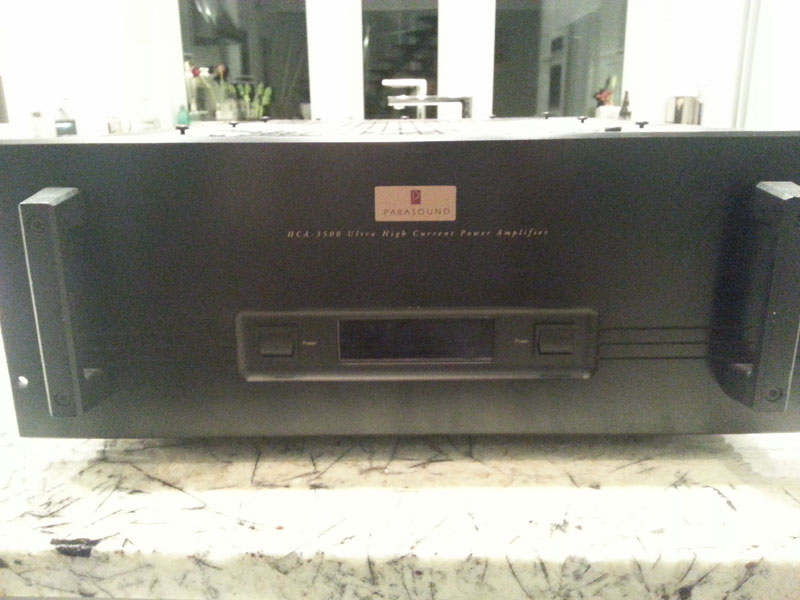

    Finally got some pics of my HCA-3500! Went through some SERIOUS mods. About $1,200 in parts and over 80 hours of soldering! It literally took 5 revisions, swapping out parts, values, etc to try and solve the ground hum and top end harshness. Keep in mind this is running my Wilson Watt Puppy 7s, which are infamous for being very analytical and and bright on the top end. This amp has never sounded so neutral and revealing. The mods added another layer of dimension to the imaging, heightened dampness and the control over the bass is incredible, super fast and tight. The high's are sweet and clean, no more hurting my ears!
    The primary changes involved: altered the balanced input to be straight pass through (for some reason Parasound changed the balanced input path making it single sided, weird). Replaced multiple smaller in-line caps with single larger higher quality Holco, PolyStyrene RelCap and/or DynaCaps (depending on values). Swapped out the big crappy Bridge Rectifier with (4) FREDs. Then used the old Rectifier in the Power Supply to solve the ground hum/hiss by mating it with a resistor and cap (as seen in all Bryston amps). We had a really difficult time trying to fit everything, the higher quality caps are physically larger than the stock ones. We tried to keep it pretty, but there is only so much you can do!
