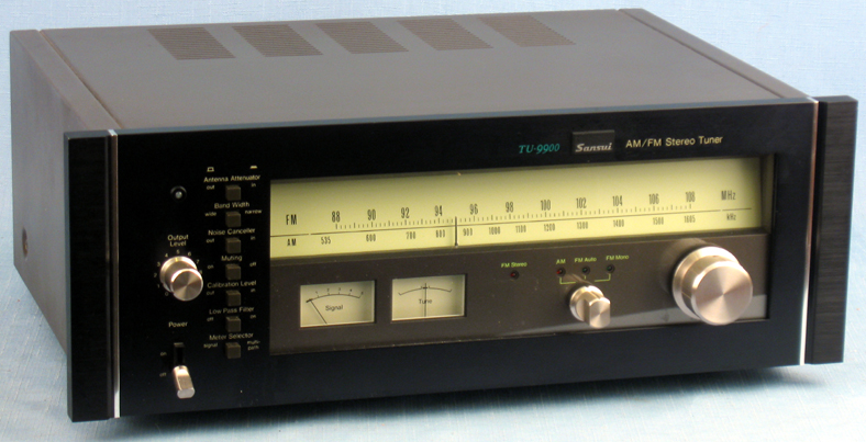

    Nice snag, indeed.
    Another "9900" tuner that you might consider is the TU-9900 from Sansui.
    There's not a chance in Hades of picking it up at the Kenwood price, but ...
    there are a couple of Sansui TU-9900's on Ebay right now. The "cheap" one is starting at $450 :( with 2 days to go.
    The other one's starting at $795. :(:(
    And those haven't be refurbed, either. :(
    Nice, nice tuner.
