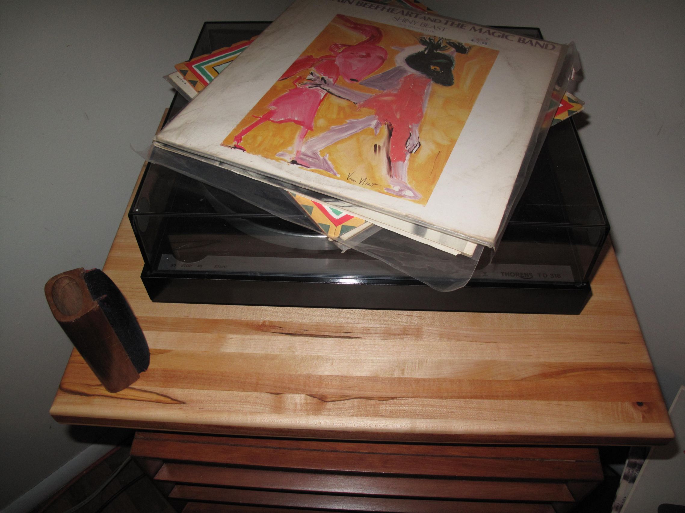

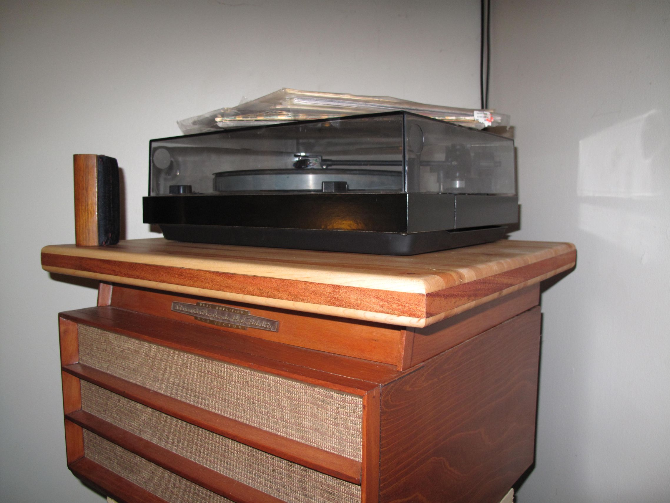

    I did finish making the slab on sun. and thought I'd share some pictures.
    I decided to add a bit o' pizazz and inlaid a strip of mahogany in the edges.
    Here it sits on top of an older refurb project.
