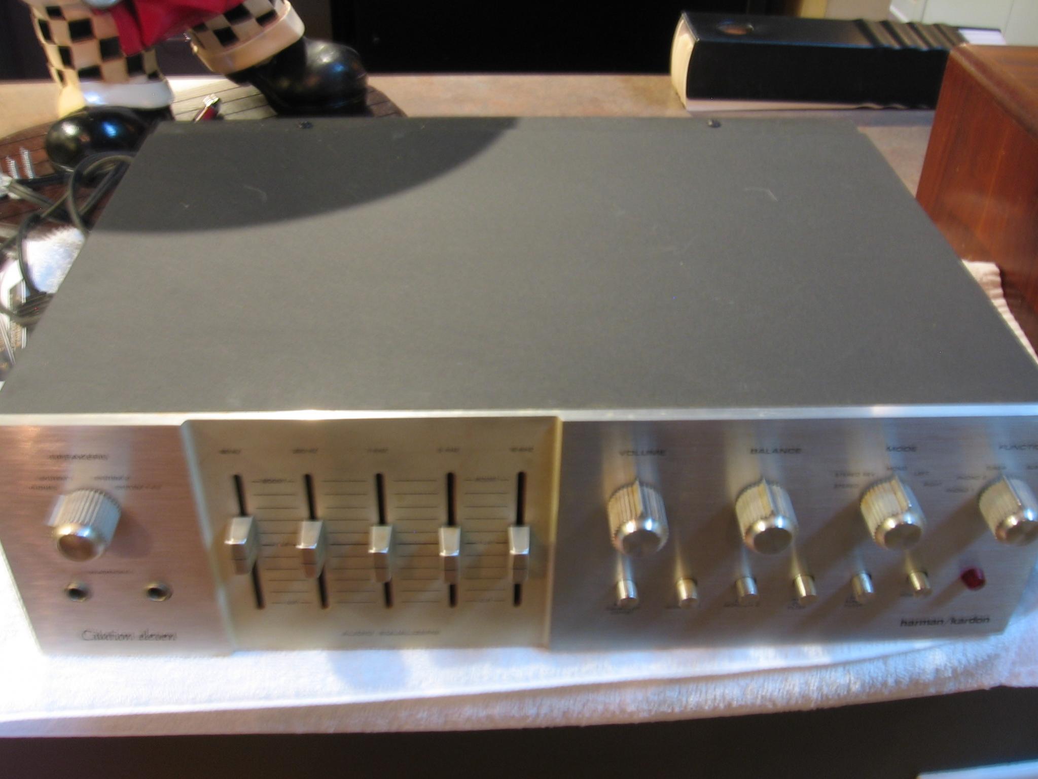

    Dug this out of the closet today,, my first pre amp--cleaned it up--still works,,sounds pretty good too.
    George, that Citation is gorgeous. Unfortunately, I had a run-in with H/K Canada, which has a non-existent customer support (compared to H/K USA, which was always great when I needed help). So I got rid of all my Citation gear a couple of years ago.
    Very pretty George.
