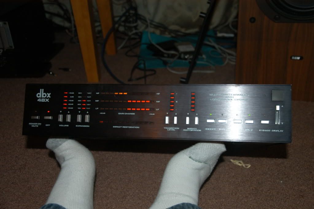

Picked this thing up at Goodwill one day on a hunch. I have no idea what it does. Hooked it up like an equalizer to play with it, and it seems to do what a compressor does.

    It does the opposite,its a 3 band dynamic range expander.

    I lifted this from another post of mine and slightly edited it.
    Dynamic range is the difference in volume, measured in dB, between the loudest and softest passages in music. Recording studio engineers used to compress the dynamic range of music (literally squeeze it onto a record or tape) to fit the limitations of those media. Dynamic range expanders increase the dynamic range of any source.
    DBX 3BXIII
    It divides the audio frequencies into three ranges (HF, MF, LF) and handles each separately. The unit lets you choose how much expansion you desire, the transition level and the threshold at which the upward and downward expansion occures. In addition, the unit restores the impact (impact restoration - reconstructs the initial transient of a note) of a live performance that is lost during mixing. The range is 0 to 12 dB.
    Even though we have moved forward with media capable of greater dynamic range, we appeared to have taken a giant leap forward with the amount of compression applied. I would keep this. I have my 3BXIII from the mid 80's and will never sell it.
    All truth passes through three stages. First, it is ridiculed, second it is violently opposed and third, it is accepted as self evident.

    The 4BX is NOT a tape noise reduction unit like the dbx Type I (professional) or Type II (commercial eg. 224x) units. The 4BX can be used to improve any line level signal; FM, tape, LP, CD, other digital etc.
    If I had a monitor loop on my current preamp, I would still have mine connected for use when desired or needed.

    It's a dynamic range limiter/expander. It's worth at least $400 without the remote.
    Great find. I't excellent for analog/vinyl use.

    Try it. You'll keep it once you learn how to use it.
    If you're patient and plan on keeping it, I can send you a copy of the owner's manual. I need to dig it out of storage.

    I found the manual, apparently dbx still has it online.
    I used it last night with some streaming music. Very interesting effect. I liked it, but still I prefer a straight signal to my amp.

    This would be a keeper regardless what you could get on the open market, but that is my opinion.
    FWIW, based on your picture, you do not have the unit properly configured.
    Set the transition level so the bands (esp. the HF band) are equally adding (red) and subtracting (orange) from the signal. This way you are adding to the peaks and subtracting from the quieter to extend the dynamic range. All the people I have known have the unit always adding to the signal like the picture; this is not what the unit was designed for nor does it sound very good. I always found having about 20 - 30% expansion level was appropriate regardless of source.
    I usually set the impact restoration at about the same level. There should also be a release rate on the back of the unit to set how fast the transient is released.
