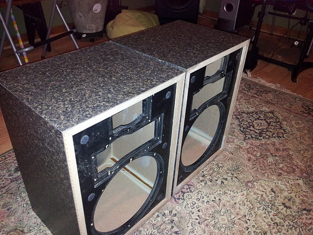

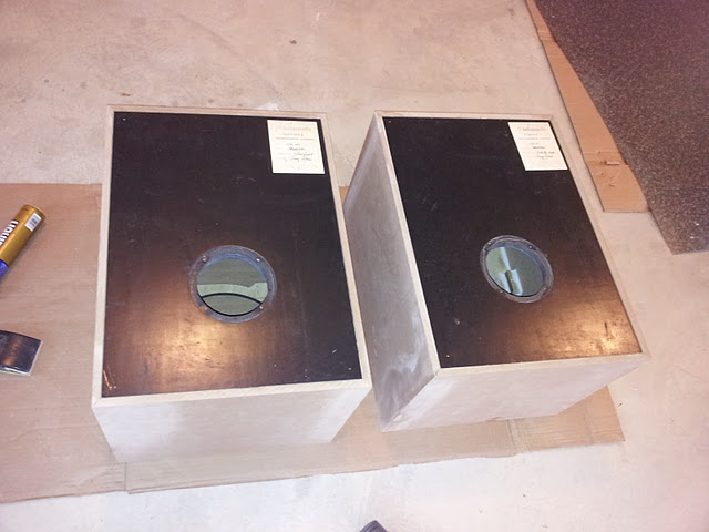

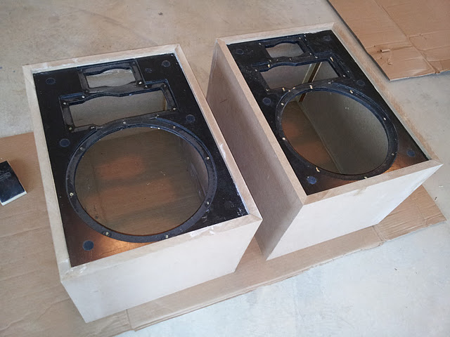

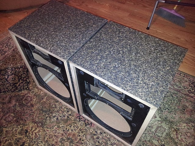

  • mdaudioguy
    mdaudioguy Posts: 5,164
    edited January 2012
    A few pics of what I've done so far...
    I think I just invented myself a speaker that I can set my drink on and not have to worry about it! :cheesygrin:
    Next I need to cut the pieces for the front edge.

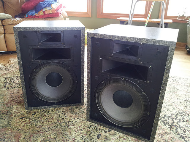

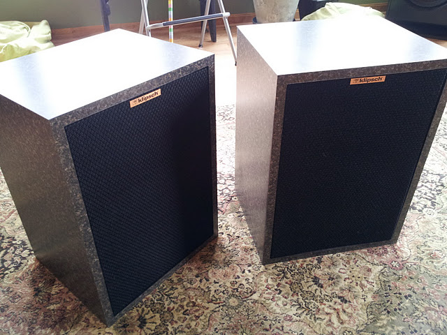

  • mdaudioguy
    edited January 2012
    I'm pleased enough with the results... not quite perfect, IMO, but I definitely learned from the project. It also has me thinking of a future DIY project...
