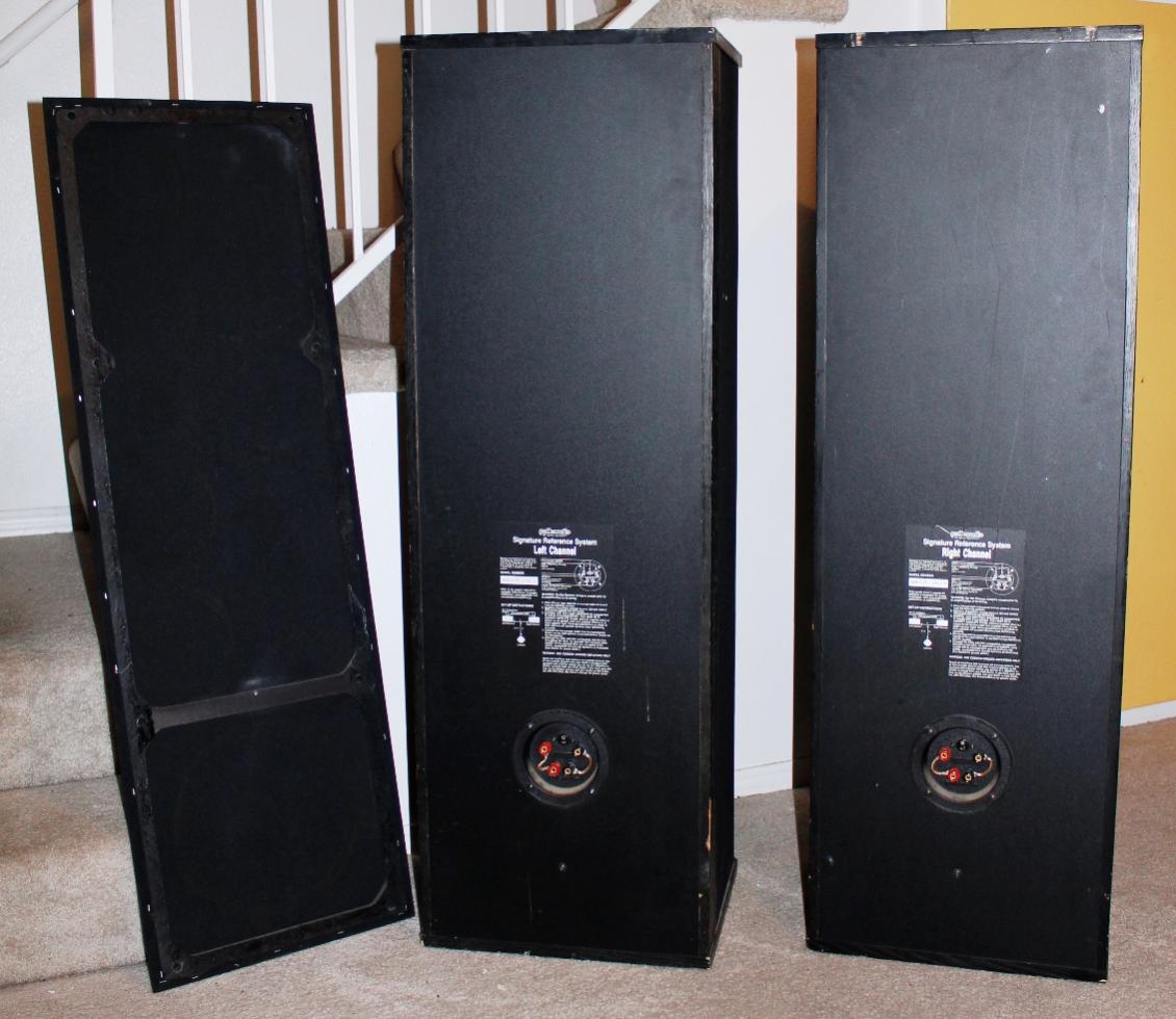

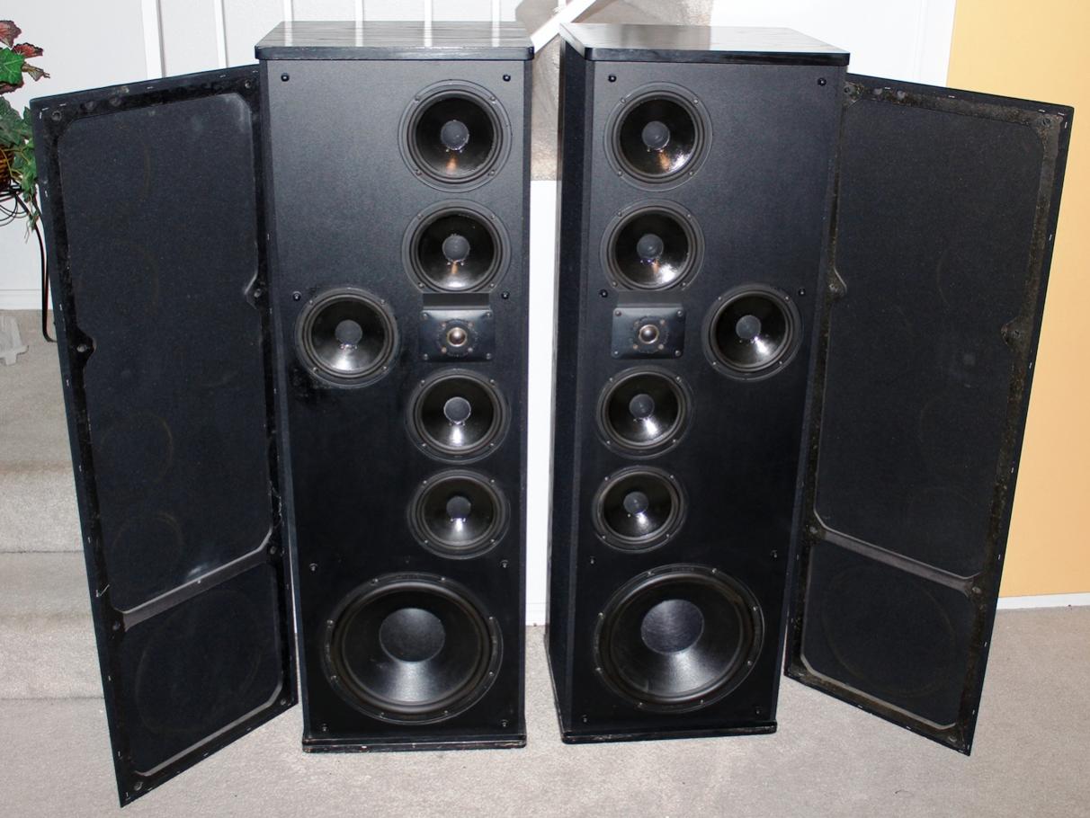

Physical Condition:
Minor scuffs and scratches but nothing major.

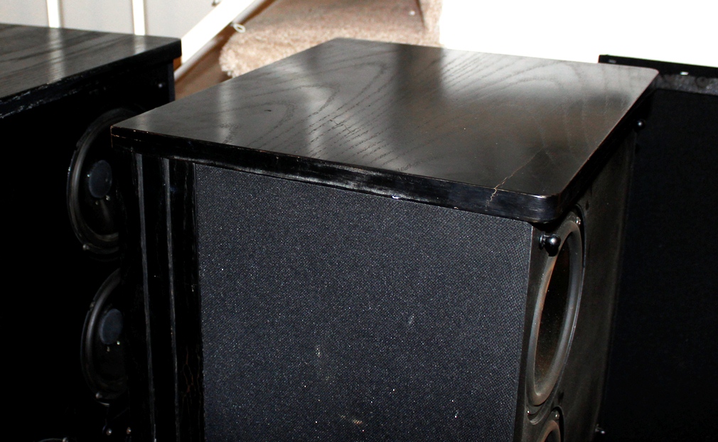

There is one few inches long small crack on top plate of right speaker.
Grills are very good besides minor holes/fraying etc.
Side panels and back cabinets are very good.
Front baffle is almost perfect.

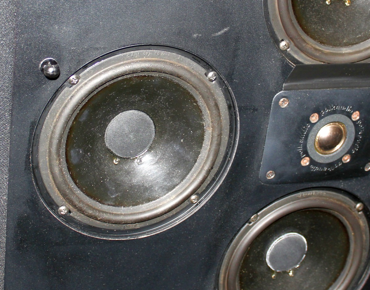

On the left speaker, there is some kind of glue residue around the dimensional driver and some of that glue is also on the surrounds of that driver.
There is no rip or tear on the driver though.
Right PR has small crease on it.

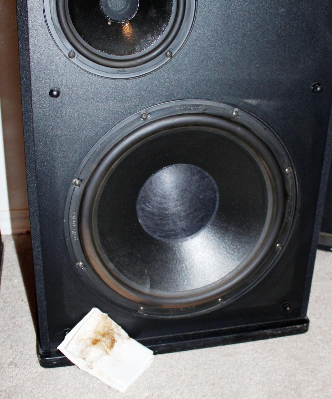

On all drivers' surrounds including PR, there is rusty colored dust layer as seen on the pictures.
Also, that rusty color rings are on the grill cloth from the surrounds touching the grill cloth.
I saw that in my Monitor 7's as well.
Not sure how that rust colored dust gets there but it wipes out clean.
May be it's due to being unused for a while. SDA-2B didn't have that.

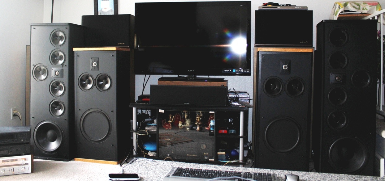

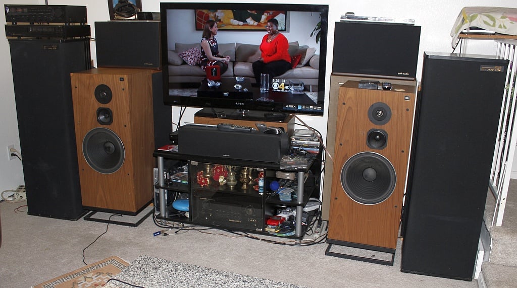

They look pretty good after wiping the dust/rust.
Briefly turned them on this morning and noticed these are more efficient than 2B's.
At the same volume, these are noticeably louder than 2B's.
Also, these have smoother/more midrange and more heavy/solid sound.
2B's sound little lighter and thinner but brighter.
Didn't notice much difference in bass but I only listened at low/moderate volume.
I know it's very crappy testing and setup but I was expecting night and day from 2B's. :rolleyes:
My living room is now crammed.
I have my work cutout for this weekend moving speakers around. :eek:

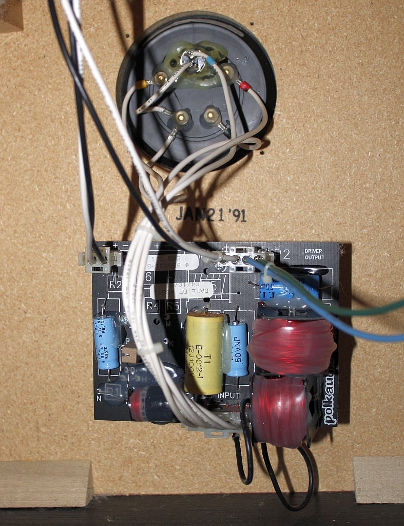

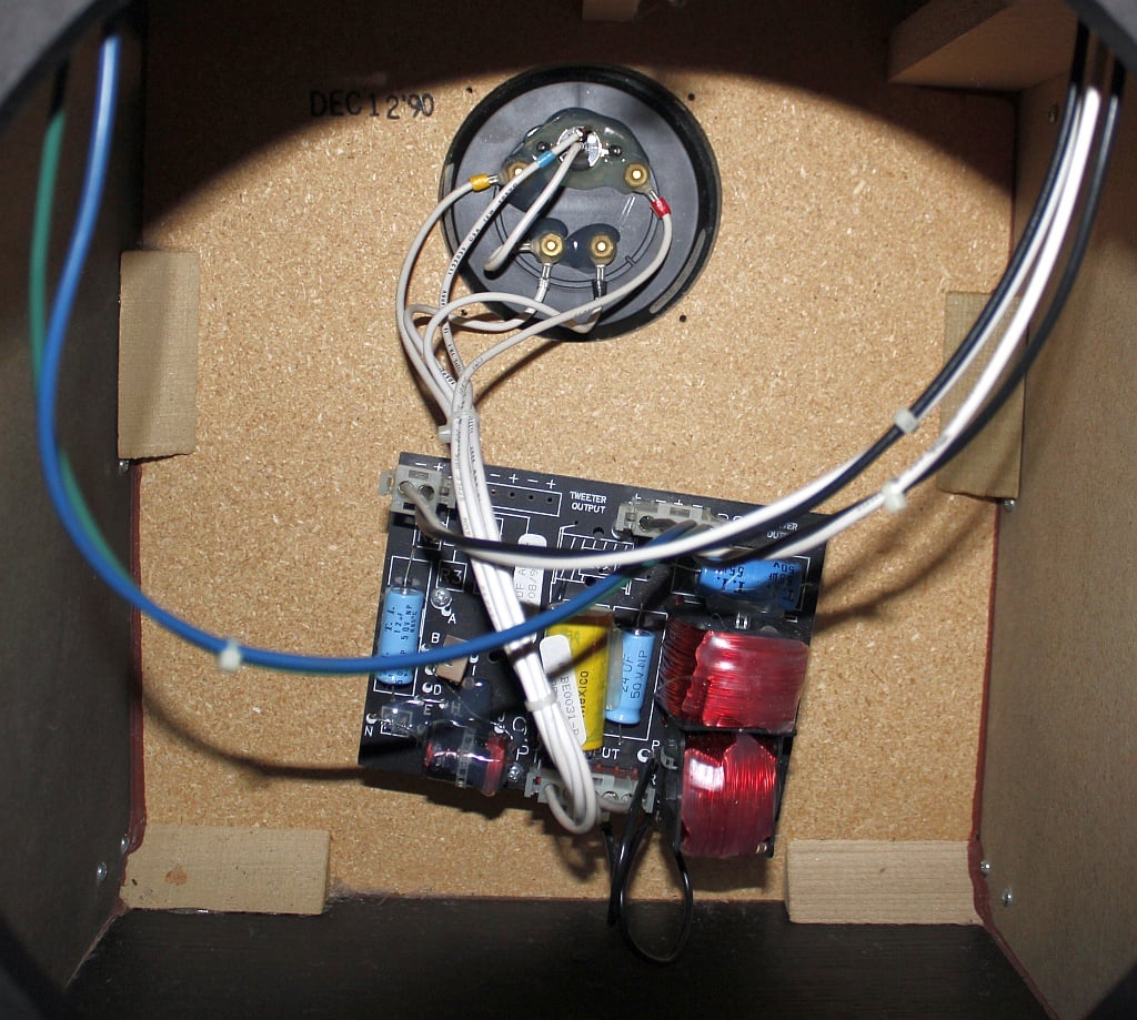

I checked schematics and bi-amp is separated for tweeter and mid drivers.
I was thinking may be few mids + tweeter can be powered independently for upper/mid range and others for low frequencies.

    I had the exact same rust colored powdery stuff on my drivers surrounds also.
    Over in the "SDA SRS 2 needs CPR and ICU" thread that went on for so long, 1st page, post # 15, first photo, you can really see it on the edges. You can also see rust on the screw heads. I wonder if the rust on the screws is sluffing off and attaching itself to the rubber over the years. I've seen several other pictures where there seems to be the same rust colored dust.
    I painted the screw heads, and REALLY cleaned up my pair, now the rusty dust really stands out. I wasn't sure if I should try to clean it up or just leave it alone. Didn't want to do any damage and I doubt it has any effect on the sound. But it just looks gawd aweful. You're a speaker guy right? Can I wipe down those rubber surrounds carefully? Use any cleaner? Damp cloth with water? or armor-all?

    I'm as much speaker guy as you are. :redface:
    I did a two step wipe using paper towels on the surrounds.
    1st was with rubbing alcohol to get heavy dust and any grimes out.
    Then with plain water to wipe off any leftover dusts and remaining alcohol.
    It's not detailed job but way better now.

    I use a lint free or micro fiber cloth (spray the cloth with some Windex, don't apply the Windex directly to the drivers) Clean the drivers with a circular motion and be gentle on the paper portion, removes smoke, dirt, grime and all kinds of crap and leaves the drivers looking like new again, shiny and still tacky.

    Do not get the grill frames too wet, they won't take it, the frame material will swell and disfigure to the point of..."oh crap, what have I done"...trust me on this one, I just just finished making replacement grill frames, going to recloth this weekend.

    The discoloration on the rubber surrounds is simply oxidation. Follow Mike Reeter's directions for using Windex, use nothing else and especially NOT Armor-All.

    Nope. I'm talking about this glue residue on the baffle around left SDA driver.
    http://www.polkaudio.com/forums/attachment.php?attachmentid=80337&d=1359050318

    "If" the cloth is attached well to the frames and the side panels, it will take a good scrubbing without causing any damage. Just don't soak the grills completely, just try to lightly wash the cloth and not expose the frames to too much moisture.
    Mine were really dirty, cig. smoke, pet urine and whatnot, I took them to the bath tub and scrubbed the crap out of them, the material the frames are made of is very soft and porous and will soak up and swell very easily.

    Impressive setup! I wish my wife would let me do that to our living room. :cheesygrin:

    You can probably use some wood filler on that crack, sand and repaint.

    I went over them again with Windex and wiped clean all areas.
    The glue residue on speaker baffle went away rubbing with some 'Goo Gone'.
    Thanks. No need for filler right now.
    That top is very solid and crack doesn't seem to be all the way in.

    teekay0007 wrote: »
    Mystery - did the Goo Gone you used do any damage to the finish (vinyl/paint) of the baffle?
    Looks like I still need to remove little bit of residue but it looks good.
    Baffle has a thin layer of oil from the goo gone I think. Looks little smooth and black.
    Here is picture of residue on baffle before cleanup:
    Here is after:
