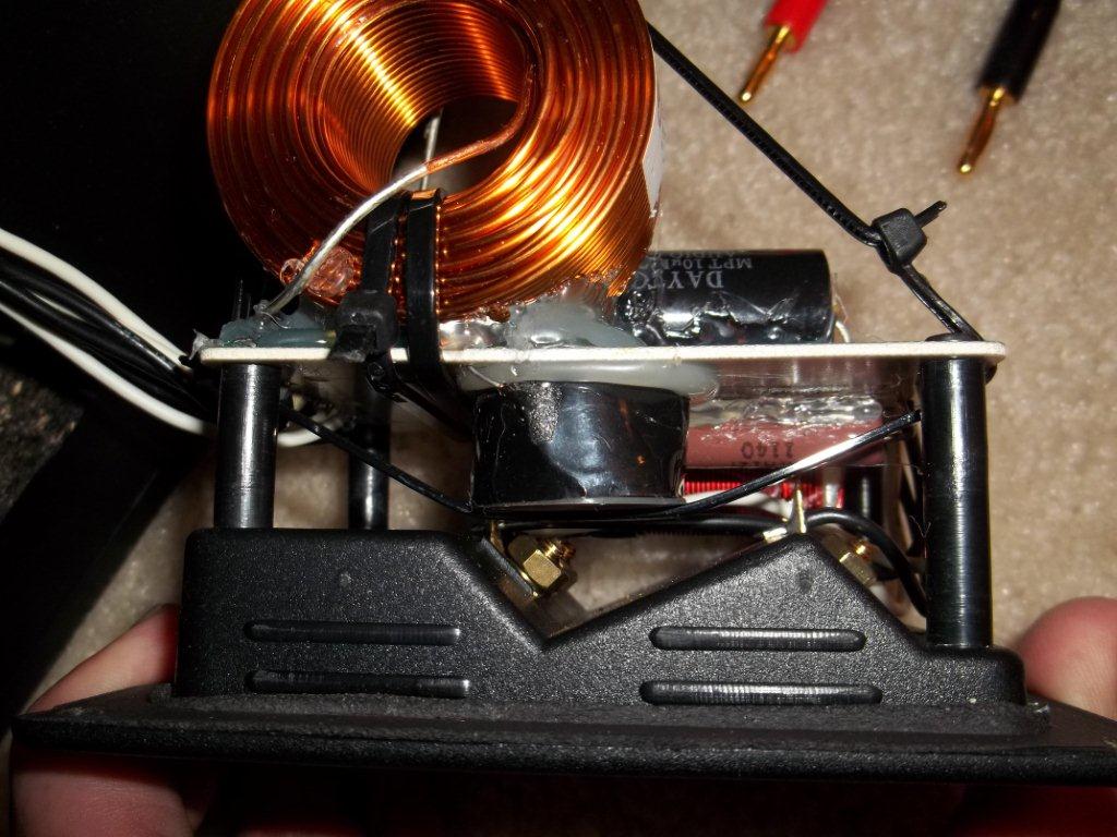

    My 90's were already done with Dayton caps, Mills resistors and Jantzen air core inductors when I bought them last year. Love 'em! I can probably pull the c/o's and take photos if you need them...

    Ken, if you are up for it I would love some pics of your XO.

    Here's some pic's. Like I said, I didn't do the job. Have no idea what the originals looked like...

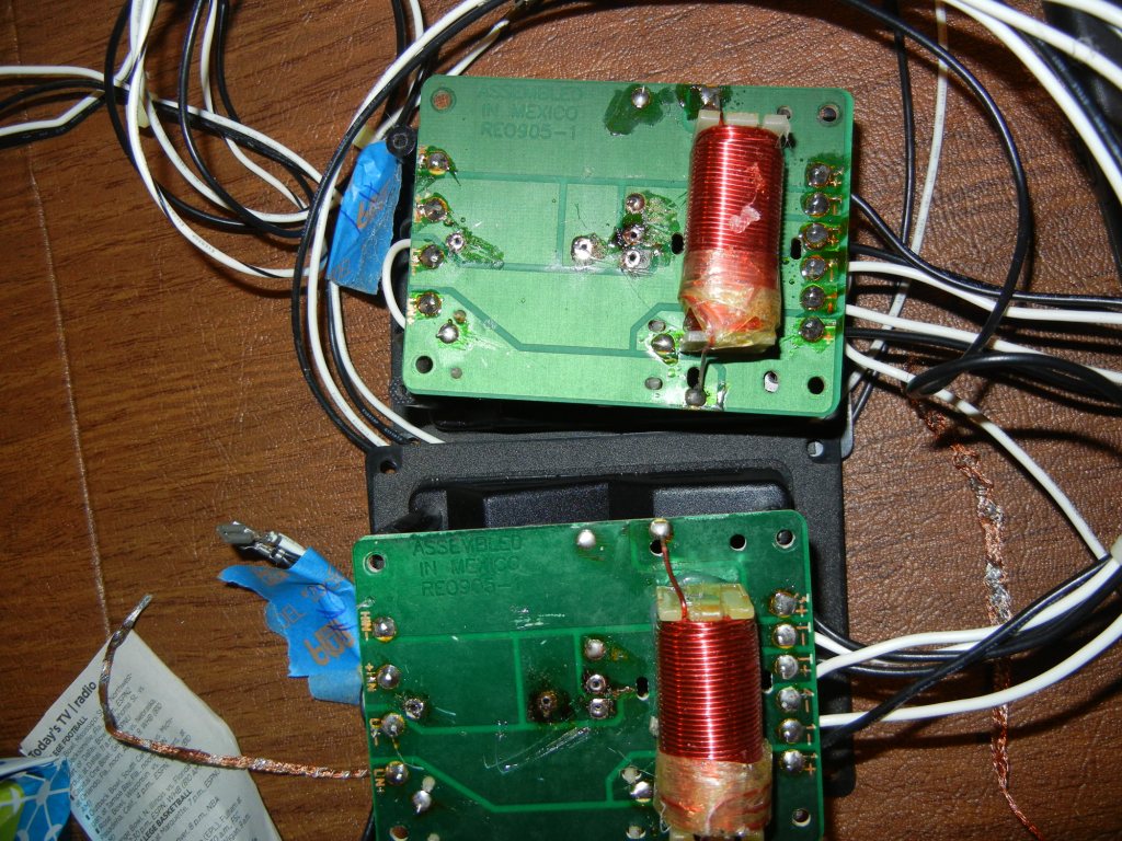

    Opened up one of the LS90s and removed all drivers, tweeter and crossover.
    I think mine are original not revised because I have the electrolytic 10mf cap. What is suprising is the schematic for original has .8 ohm resister as well as the circuit board print but there is a 2 ohm resister in place. The revised schematic shows a 1 ohm.
    I am a little lost on what to do, go with 2 or .8 ohm?
    This I better open up other crossover and see what it has.

    OK, it just got wierd. The other crossover has a 1 ohm resister and the circuit board print under the resister has .8 ohms.
    Thoughts on what to go with ? I am thinking .8 ohms 5w mills.

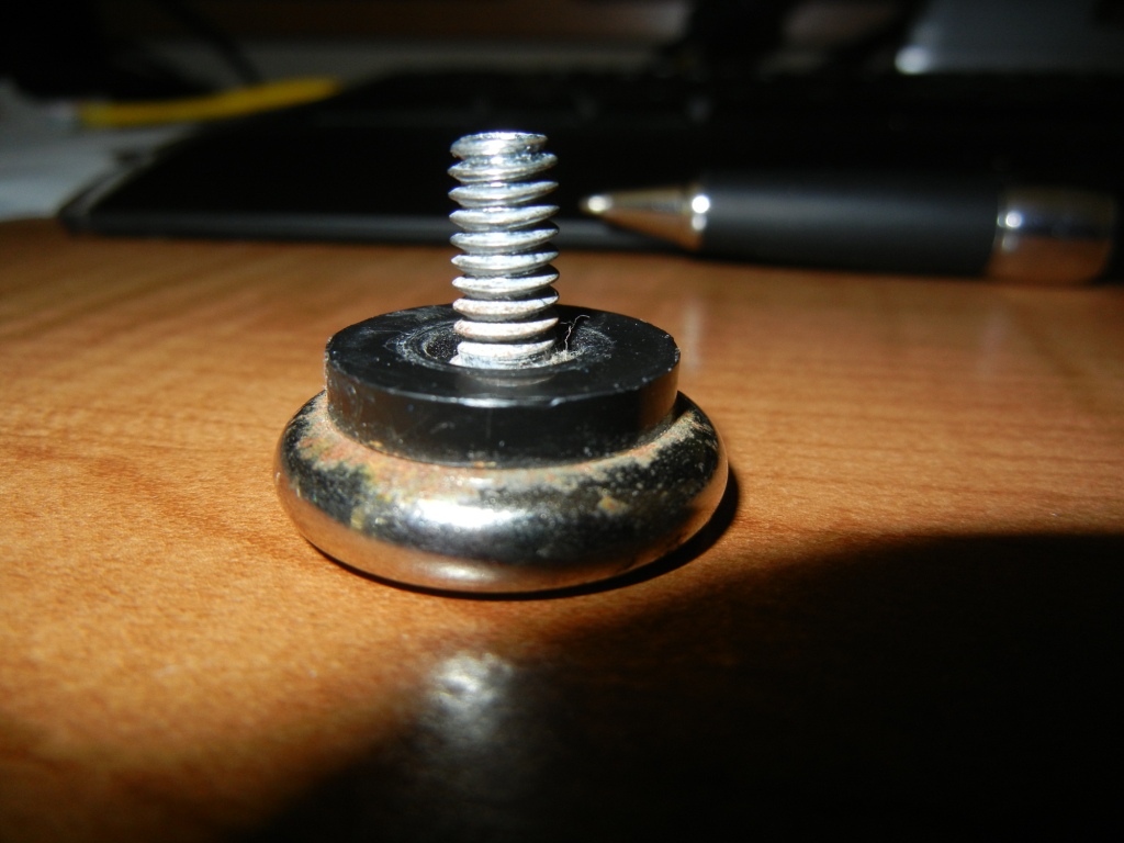

    Do you by chance know what the thread is for the spikes on these ? I have mine out and going to HD tomorrow to figure it out.

    They didn't come with spikes. Likely aftermarket.... Looking into spiking mine.

    mine has these silver flat buttons that screw in the bottom and look OEM.

    Maybe Polk ran out and used what was close. I am going back with .8 ohm.

    The .8 ohm was used in the original design, and the 1.0 ohm in the revised design. The L3 inductor is also different between the two. Yours are marked RE0905-1 which are the originals. Go with the .8 ohm Mills, unless you want to upgrade them to the revised model. That would require changing both L3 inductors in addition to the Resistors. Either way, the LS90s are great speakers.

    Thanks, mine has screw in feet that are 1/4 - 20
    Don't worry about the color of the basket frames, they may have been built months apart, and used woofers from different production runs.
    Thanks, .8 ohms is what I plan to order.

    Turning out to be tough to find some decent spikes

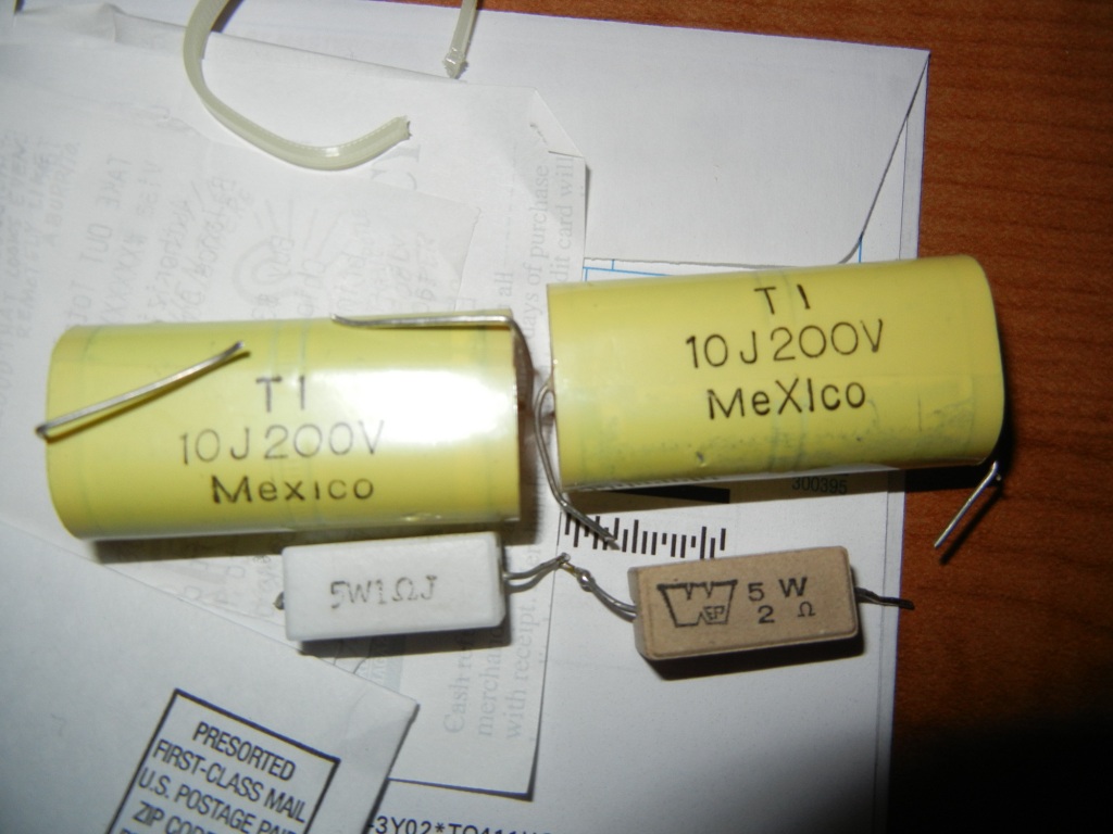

    I ordered these, may be a little small but we will see.
    http://www.avoutlet.com/index.php?dispatch=products.view&product_id=1575

    Will do Ken, I am hopeful as I do like the look.
    I ordered Dynamat extreme, caps and resistors today. Hopefully this weekend I can reassemble and listen.
