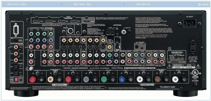

Anyone know if the Onkyo 875 has balanced or not? -
If I'm not mistaken, having balanced inputs is a benefit if you have to have long runs of wires to hook everything up.
The 875 doesn't have balanced inputs. Most receivers don't have them.Marantz AV-7705 PrePro, Classé 5 channel 200wpc Amp, Oppo 103 BluRay, Rotel RCD-1072 CDP, Sony XBR-49X800E TV, Polk S60 Main Speakers, Polk ES30 Center Channel, Polk S15 Surround Speakers SVS SB12-NSD x2 -
rear view of the 875...it does not have balanced inputs
You are correct.Money Talks, Mine says Goodbye Rob!!!! -
