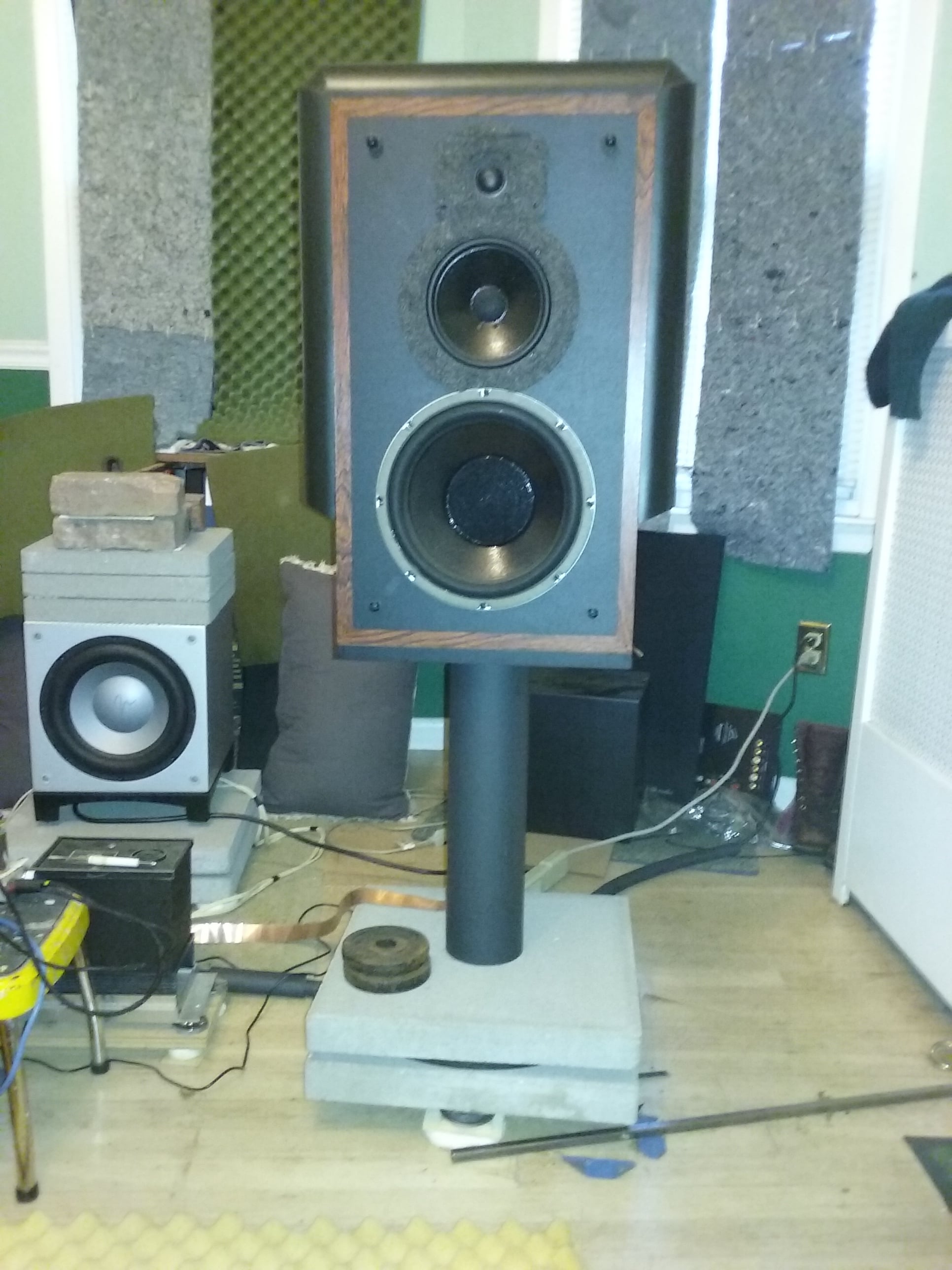

    You lost me when you said "aesthetics cosmetics" LOL. My design was entirely functional without being horrendously ugly (OK that's debatable lol). Has some vibration isolation between the two concrete blocks (two layers of minimally inflated bicycle tubes) and hardened steel ball and spoon isolators between chunks of elastomer material and the bottom blocks. The column has a faux outer cover but inside is steel pipe filled 50/50 with sand and lead shot. I want to nixx the bicycle tubes and go with springs like in the Townshend Platforms between the bottom block and the floor and incorporate xschop's CNC'd 7075 aluminum seismic isolators between the blocks.
