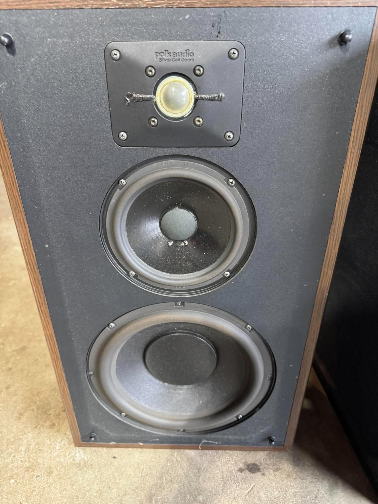

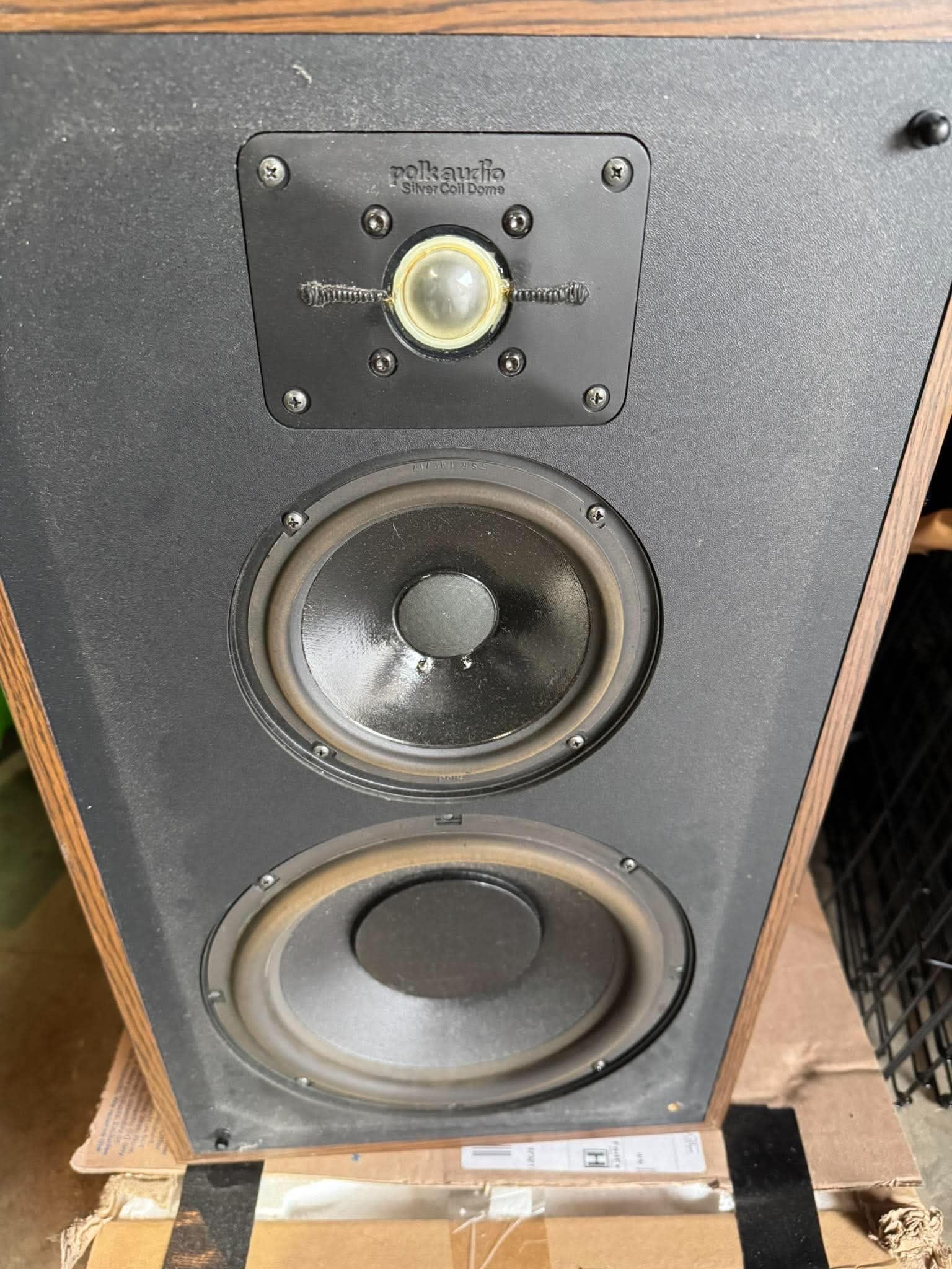

I am new to the forum and currently piecing together a vintage system to linsten to my vinyl collection. I am considering purchasing a pair of Monitor 10s in my local area, but have concerns about their condition. Also, I am looking for more information about the specific model and age.
On the back there are a series of screws on both speakers that are not present in other versions I see online. Is this normal?

    Nope, not normal. A previous owner put brackets to hang the speakers.

    Someone had a wall mount bracket mounted on them. They were not built to handle that cantilevered mounting system so I'd be careful and make certain that the enclosure back to side joints are still sound.
    From what I can see in the pictures they don't look too shabby but one of the pics is more than a little out of focus.
    I think I see a silk dome crease on one of the tweeters. That should take a little $ off the offer.
    You'll need to push on the cones evenly at the dust cap to cone area and listen/feel for rubbing. A very common occurrence with these old MW6500 drivers and they aren't as available on eBay as they used to be, or as inexpensive.
    The red binding post nut is supposed to be on the left. The other speaker doesn't appear to even have any nuts.
    I would say 1979 or earlier because of the silver basket MW6500s. I think that would make them 10As. If they are 1978 they would be 10s. They went with black baskets after around 1979.

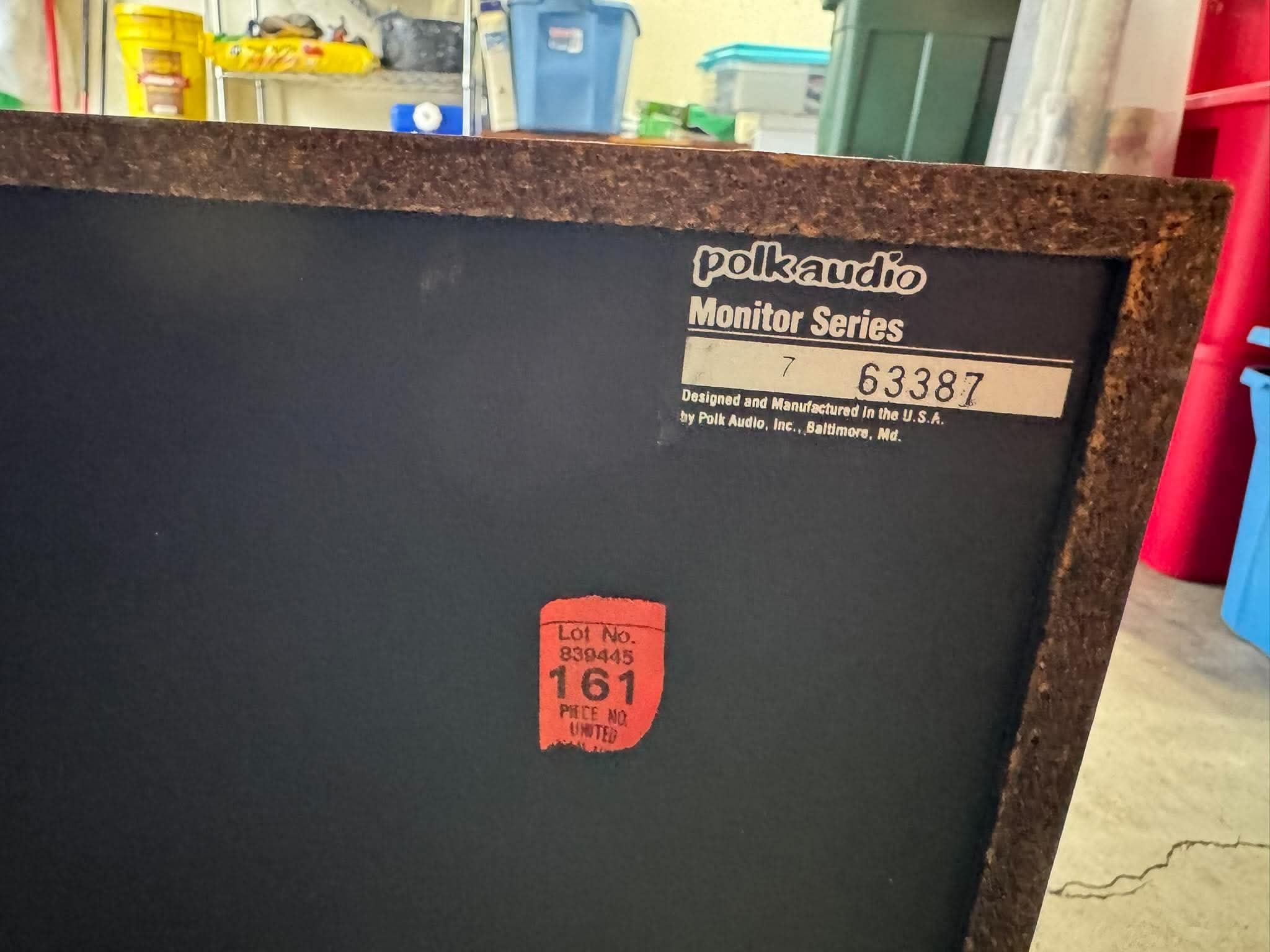

    Thank you all for the feedback... there is another person locally offering 7s, so I think I will go that route. Much appreciated 👏
  • Ramble_On
    these are the 7s
    F1nut Posts: 52,360
    Replace those nasty SL2000 tweeters with the RD0194-1. That's a zero.

    Those are the ones to go balzout modding.
    Id get the 198 tweeters and the 5.8uf caps.
