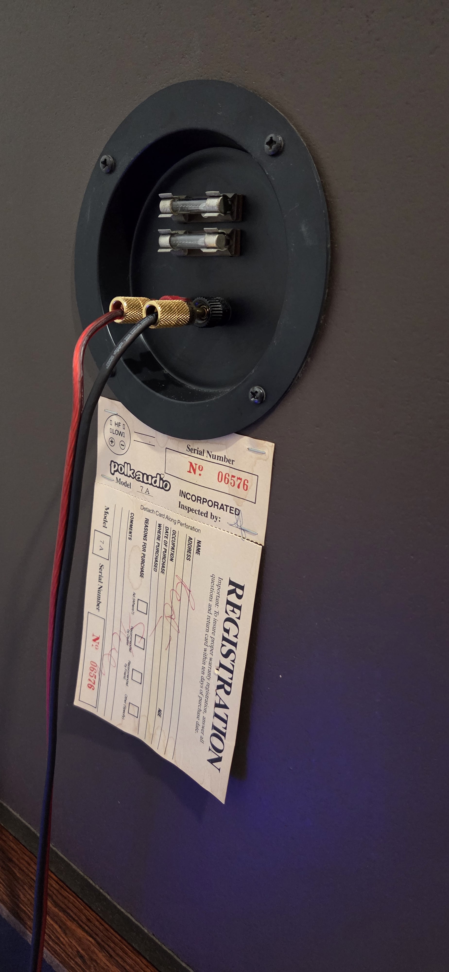

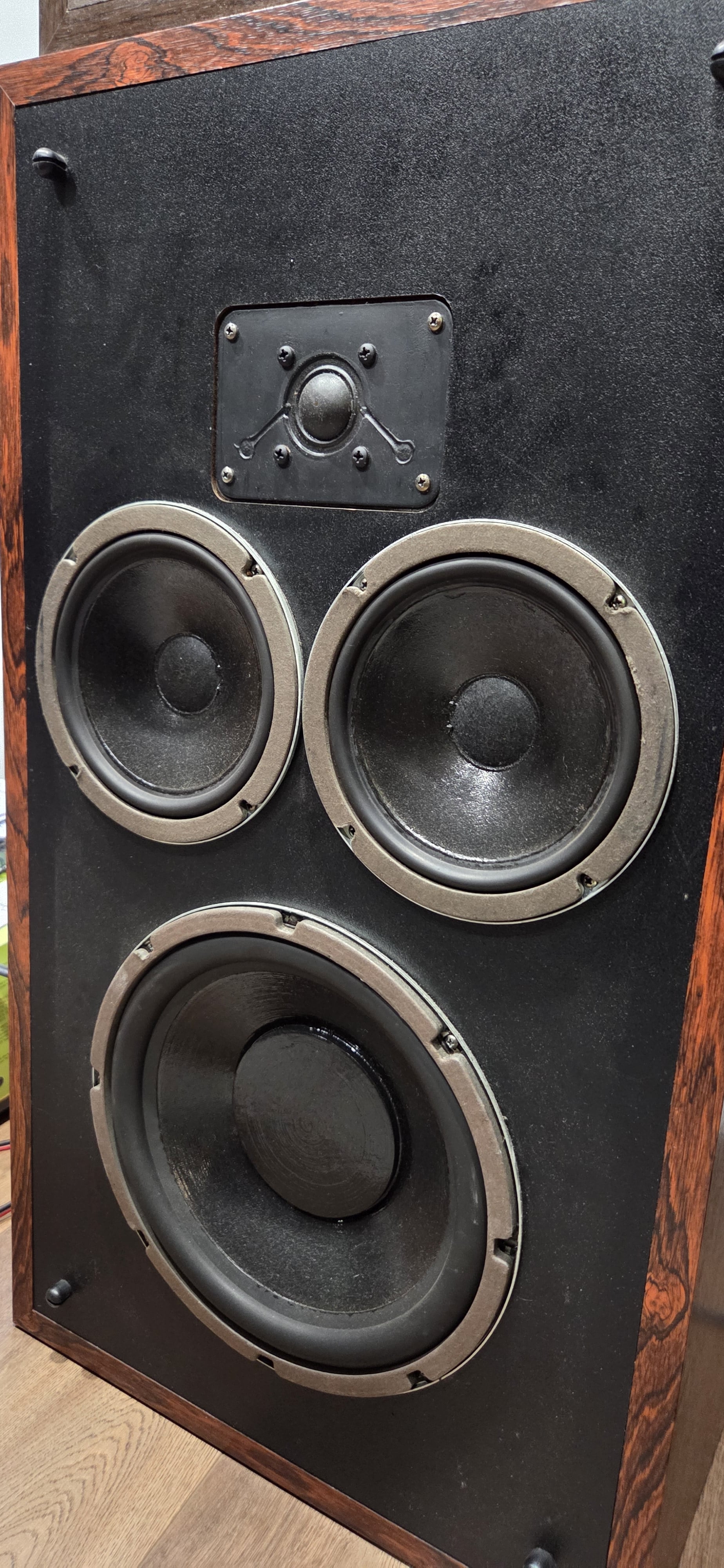

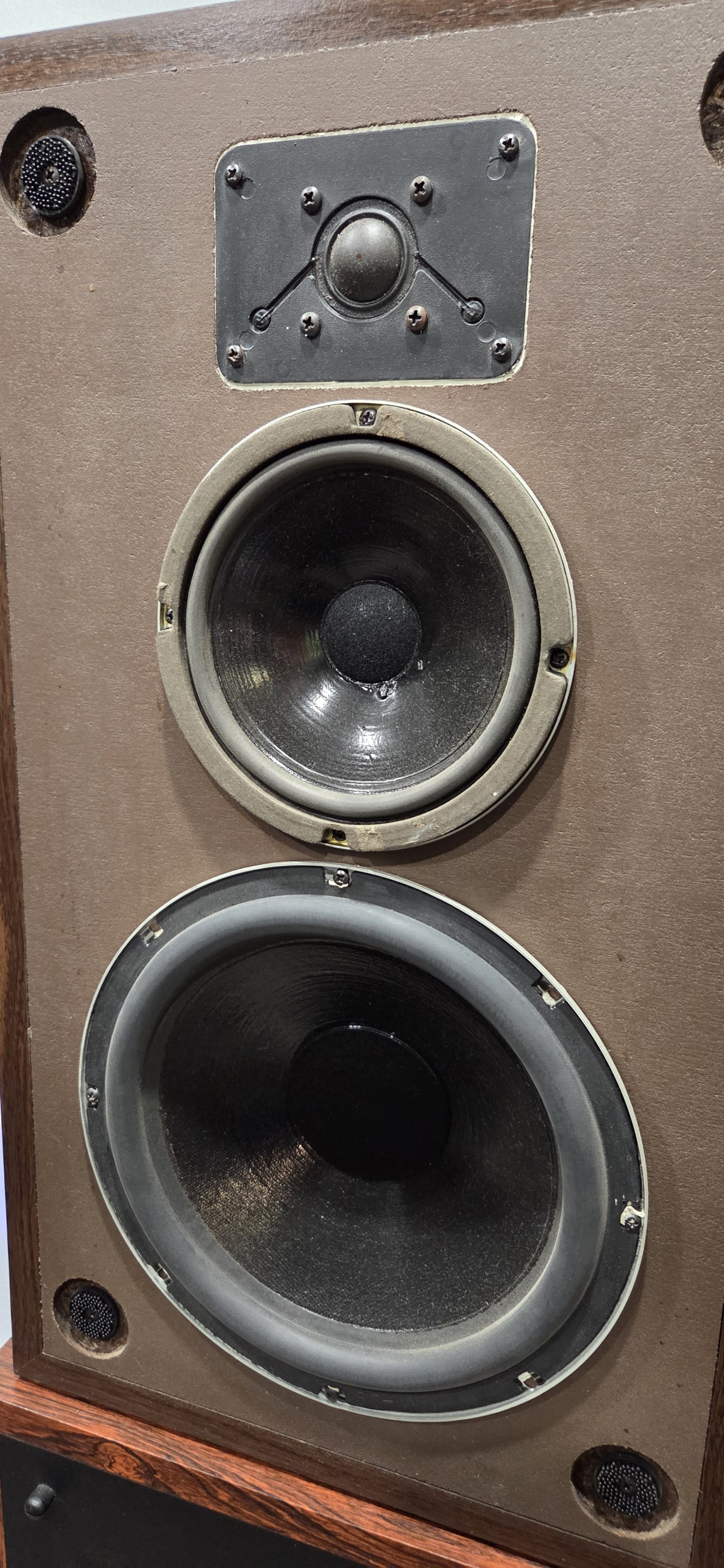

New to the forum but not Polk. I was just looking to find out if there is a member or members that rebuild M7A and M10 crossovers. Both sets of speakers are in very nice shape and the 7's still have the registration tags stapled to the back. Please let me know and thank you in advance...Tony in NC

    Anyone else have any more info on crossover help for these vintage speakers? Both sets are in very nice shape, all original and actually sound really good. I can see where they created such a following but wondering how much better they can sound...thanks again and no worries either way, I always figure it out in the end... 012xt7b0lvho.jpg
