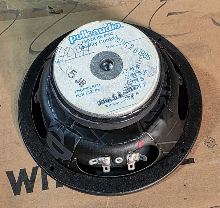

    Found in bottom, fell off driver/tweeter. August 1986 date...

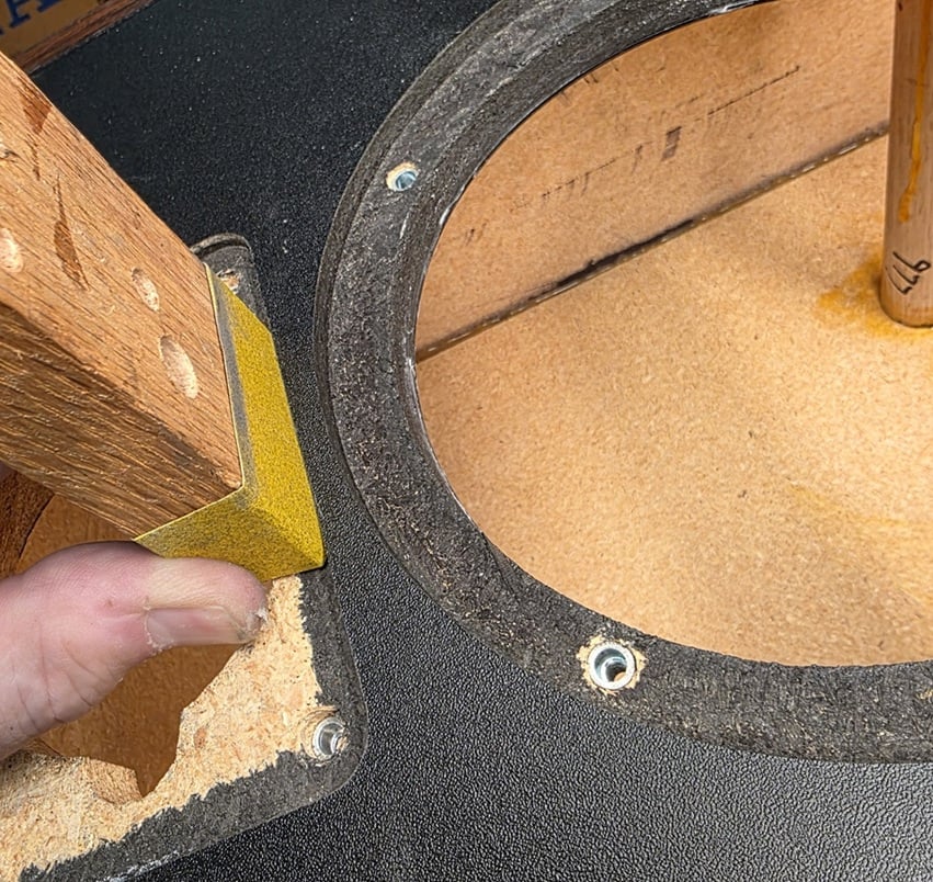

    I glued Larry's Rings in and tightened with screws/template until they dry. Rob suggested I install some braces, so I cut two 1" hardwood dowels for each speaker. That one is just a test fit. I was thinking up a bit and more towards center between driver and passive.
    I had a bunch of 8-32 screws and E-Z Knife threaded inserts left over from the Lenco idler drive turntable project. Actually, they were for the walnut heavy plinth that would match the BottleHead Eros base that I never finished. I used these for the tweeters and xover/speaker terminal plates.
    Once they are screwed down, I'll use use my little body hammer (auto body) to flatten wood around them.
    And the tweeters got them threaded inserts too.

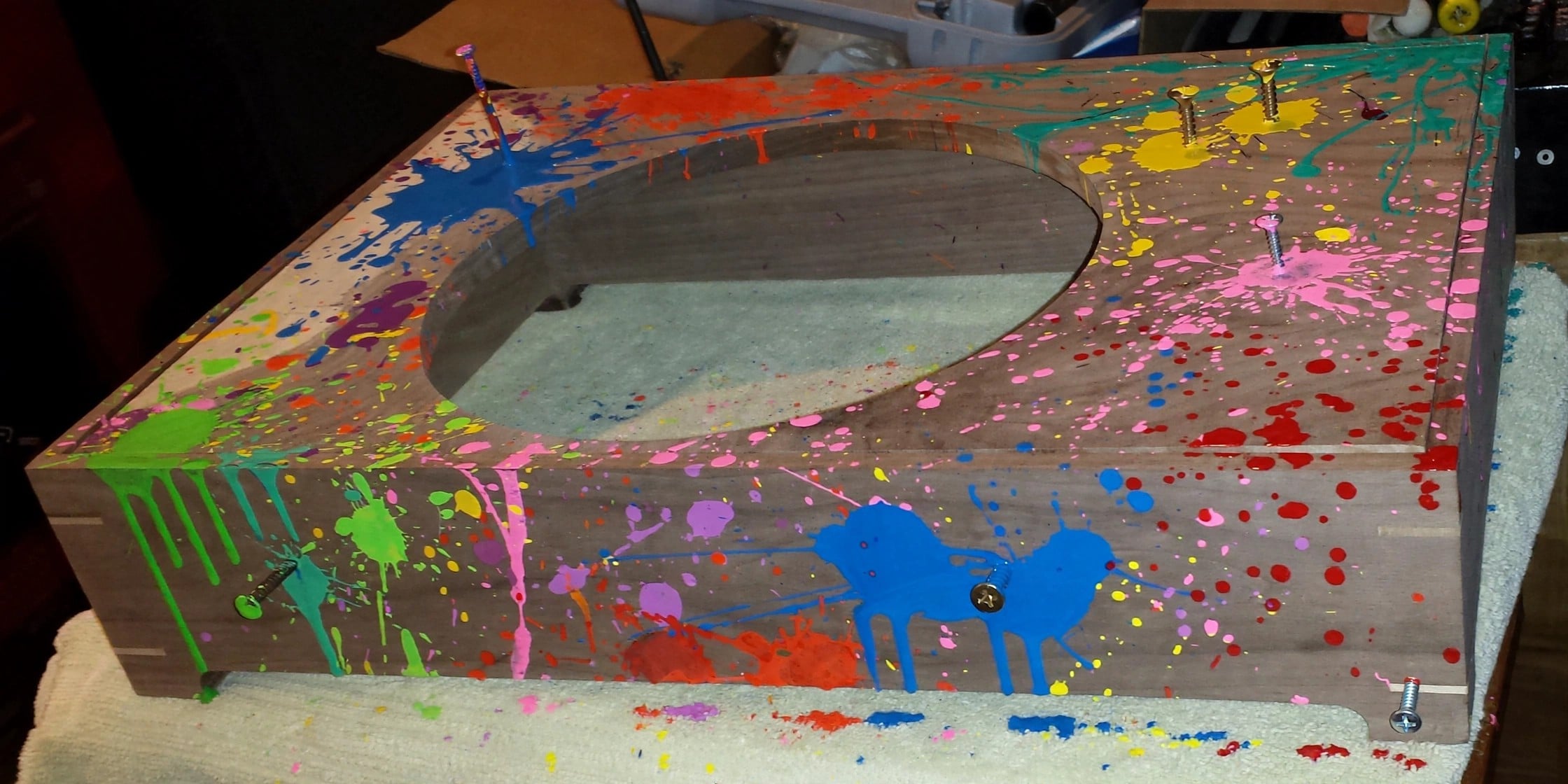

    Since I brought it up....the long overdue Lenco PTP 5 top plate and plinth project. That separates motor from platter bearing. That walnut plinth would be filled with layers of Baltic birch. It would not be hollow.
    The wood moistened to show grain.
    Wouldn't it be nice if the turntable matched the phono pre? Wouldn't it be nice if Aaron @ALL212 finished it for me? :D

    Am I too late having installed the inserts? Carl said he had a set but couldn't put his hands on them.
    pitdogg2 Posts: 27,914
    That's what I'm talking about!!!!!
    I think you'll be fine Rich. I bet the bracket and insert are about the same diameter. Use some epoxy if need be. You'll never out torque the brackets, EVER....
    Yes, epoxy and I’ve also used JB Weld, especially when I am out of epoxy.
    To repair damaged areas around mounting holes where the gasket would not seal, or breakouts inside the opening, I wrap tape around a screw to the diameter of desired hole. I screw it down until tape makes good contact with the threaded lug on the ring. A thin coat of die electric or any thin grease on threads doesn't hurt in case something sneaks by into the treaded lug of ring.
    I apply epoxy or JB Weld around it. When dry, I cut flush with razor blade. I can use tweezers or an Xacto knife to start unwinding the tape from inside the wrap.
    The outer wrap of tape will be stuck but no big deal. I’ll finish with a Dremel sanding disc to knock area flat.
    I like to minimize a mess when doing driver magnets, especially since I am going to wipe the epoxy smooth (wearing rubber glove) after application. For the basket side of magnet, I cut a piece of rope and secure it with tape.
    I wrap the magnet with tape too. A small strip of 220 sandpaper is used to put some scratches on the metal.
    I also use the masking tape trick when caulking showers and tubs. Smear the bead down and remove tape for a nice straight caulk line.

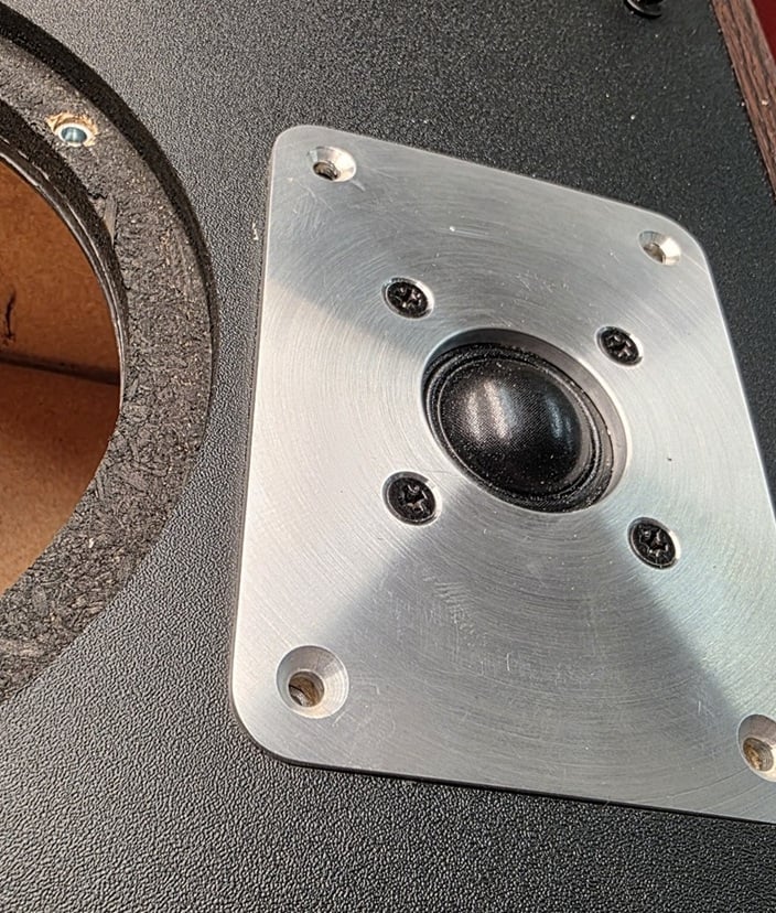

    Inexpensive plastic bezel gonna get replaced with @xschop premium aluminum bezels.
    That white thing looks important.
    I applied some Kapton tape to Rob's tweeter bezels for tweeter terminals/wires insulation.
    Precise hole alignment.

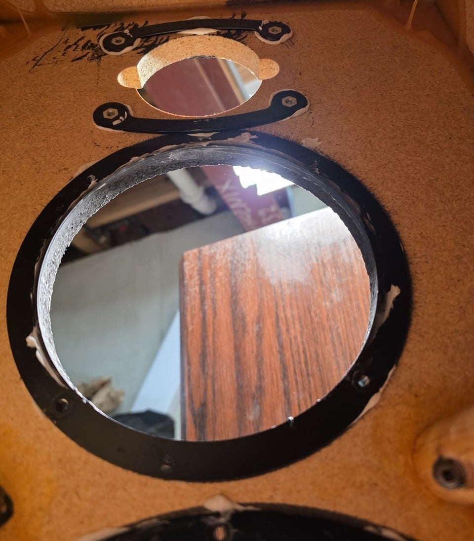

    Rob suggested to brace the cabinets. Two braces on each side about the center line between passive and driver seemed right. Not enough space between driver and passive for one in center. I made a template for marking brace locations so I could apply glue to that area before sliding the near press fit 1” dowels in. You just gotta remember to orientate the template properly for front and opposite side.
    I went with screwed and glued braces. I used my Kreg pocket hole jig to drill holes. You have to select the correct length screw to prevent an exterior surface alien breakout. Orientation of the screws is important, especially at the front. You only have the speaker terminal plate hole to work through from rear using a drill and extension driver (the easy way) to drive screw in. My old man hands and wrist appreciate the drill method.
    How about that placement. Jig hole B worked best. I used the edge of a file to cut some glue grooves in.
    Maybe brace first... With Larry's Rings installed, to get dowel braces in, I inserted them thorough tweeter opening and navigated them to their proper location. Pretty amazing, the cabinets had no real loose or real tight spots (provided I didn't tip the dowel) meaning Polk did a great job of cutting and assembling the cabinet pieces. I smeared glue about an inch before final placement so ends of dowel could grab some glue.
    After installing braces, I applied a bead of glue around each dowel while on its back. Allow to dry then flip cabinet to do front. Otherwise, gravity pulls the glue down the dowel. I screwed up and drilled one hole for the speaker terminal plate 8-32 threaded inserts clean through. I'll plug it. .75" screws will work fine there without bottoming out.
    We are being careful with grill studs too! Always use spacer blocks of wood when speaker resting on front to save from shearing them off.

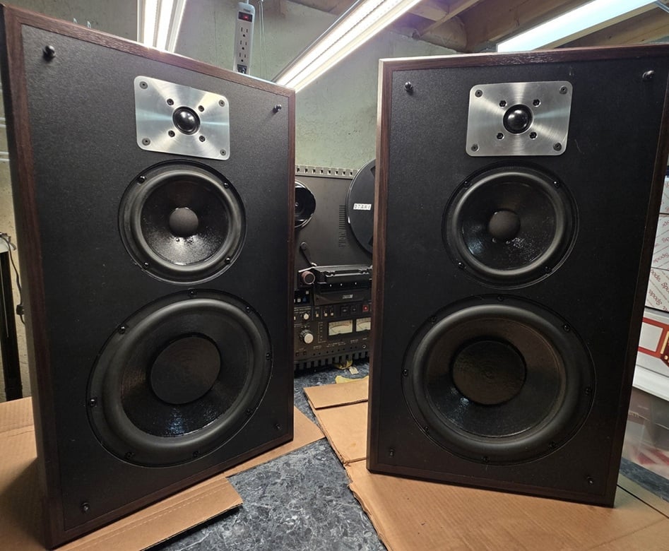

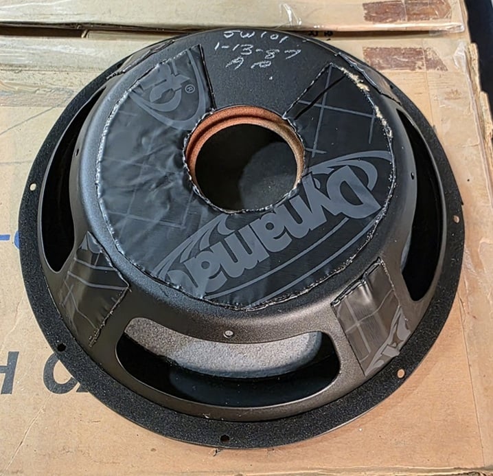

    Larry's tweeter rings arrived! Thank you Larry! Got them installed.
    Dynamat, except over the writing. Now they thunk when tapped, no ring.
    Had one cabinet tight on the tolerance side for tweeter bezel. Both of Rob's bezels were the same size, both fit in one speaker great. This one must have been a Monday speaker.
    I sanded the ID a bit for it to fit.

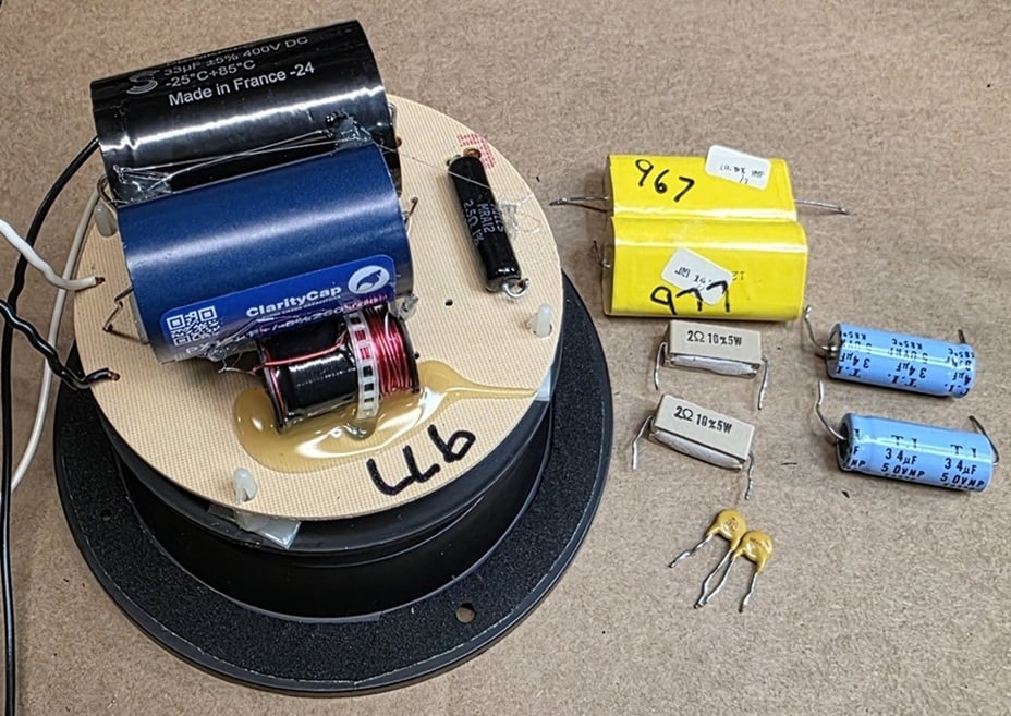

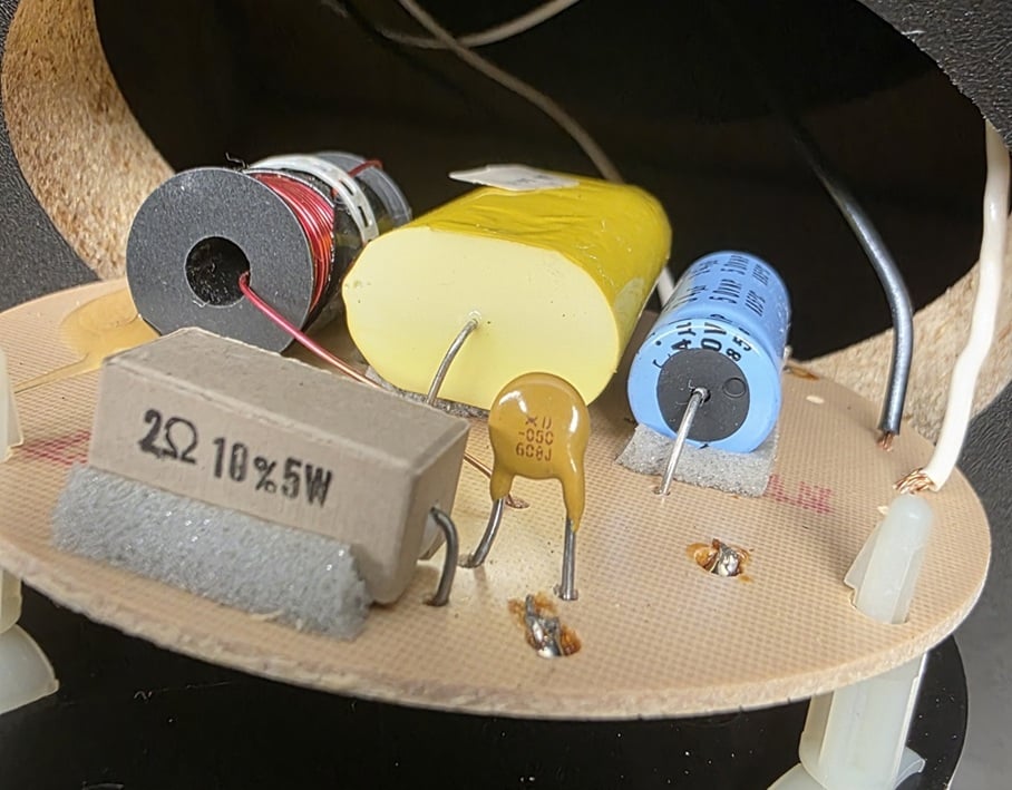

    How long has it been for this xover to see the light of day...
    Nothing too exotic here. Raided the old cap box. Solen 33uf for the woofers, Clarity PX 12uf for the tweeters. Mill's 2.5 Ohm resistors (+.5 for the removed poly-switch).
    Assembled...no collateral damage. Maybe tomorrow drag them upstairs and hear if they still work.
