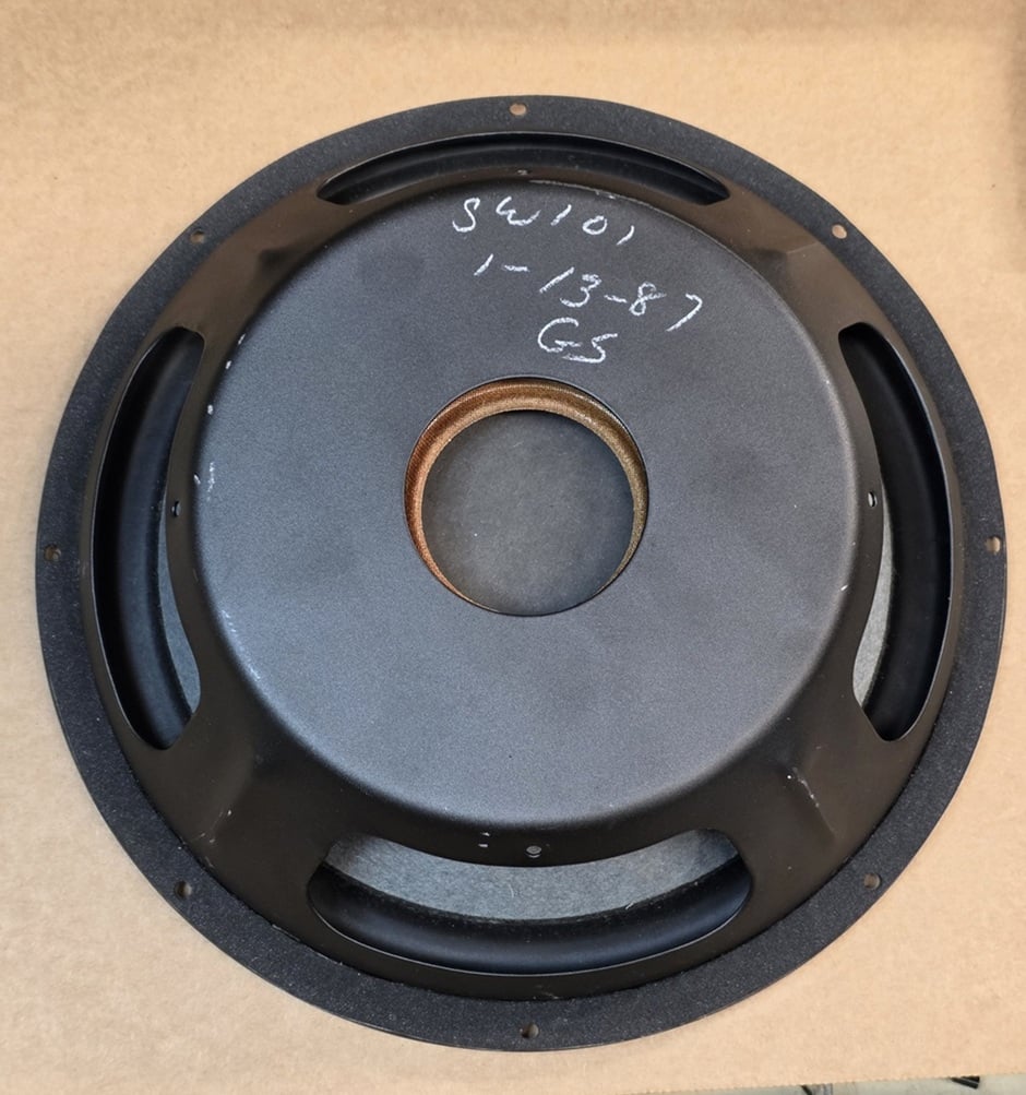

    Found in bottom, fell off driver/tweeter. August 1986 date...

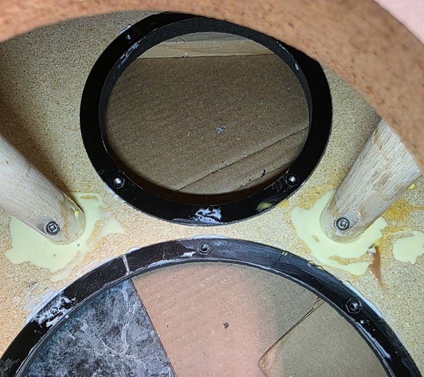

    I glued Larry's Rings in and tightened with screws/template until they dry. Rob suggested I install some braces, so I cut two 1" hardwood dowels for each speaker. That one is just a test fit. I was thinking up a bit and more towards center between driver and passive.

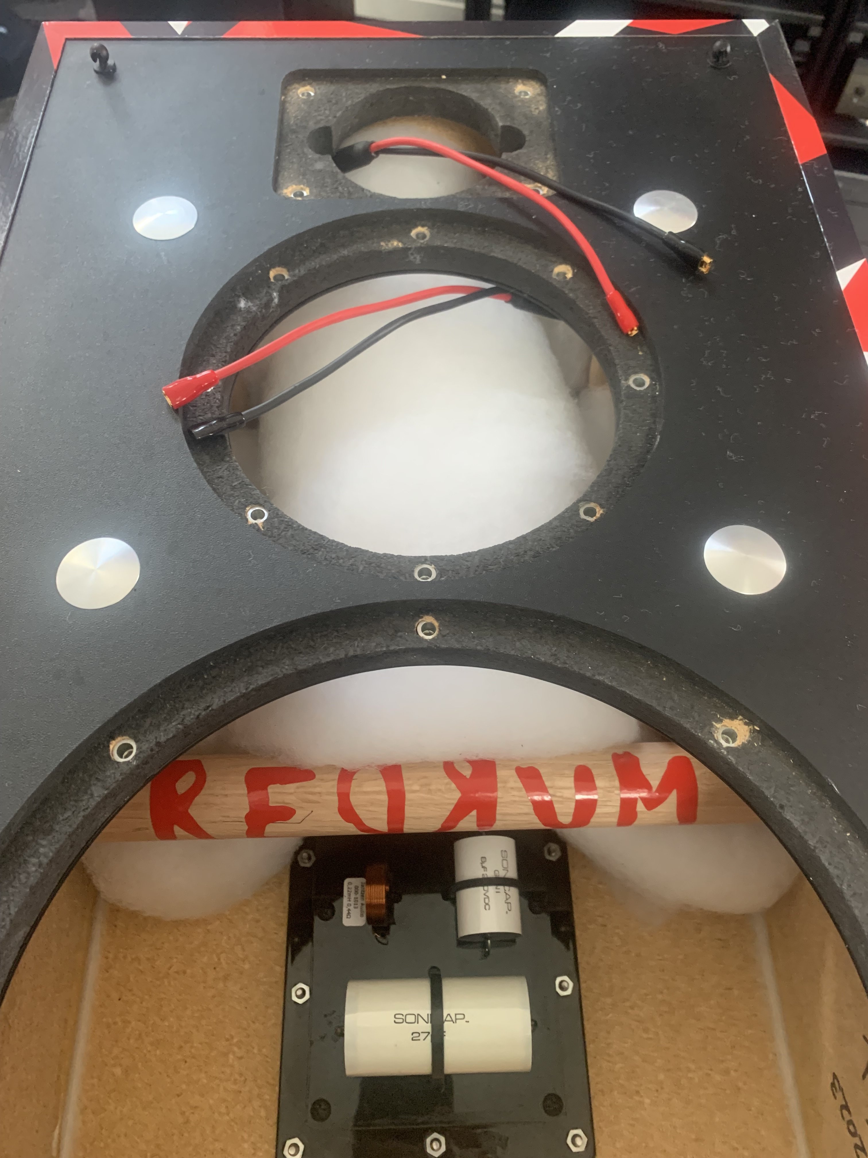

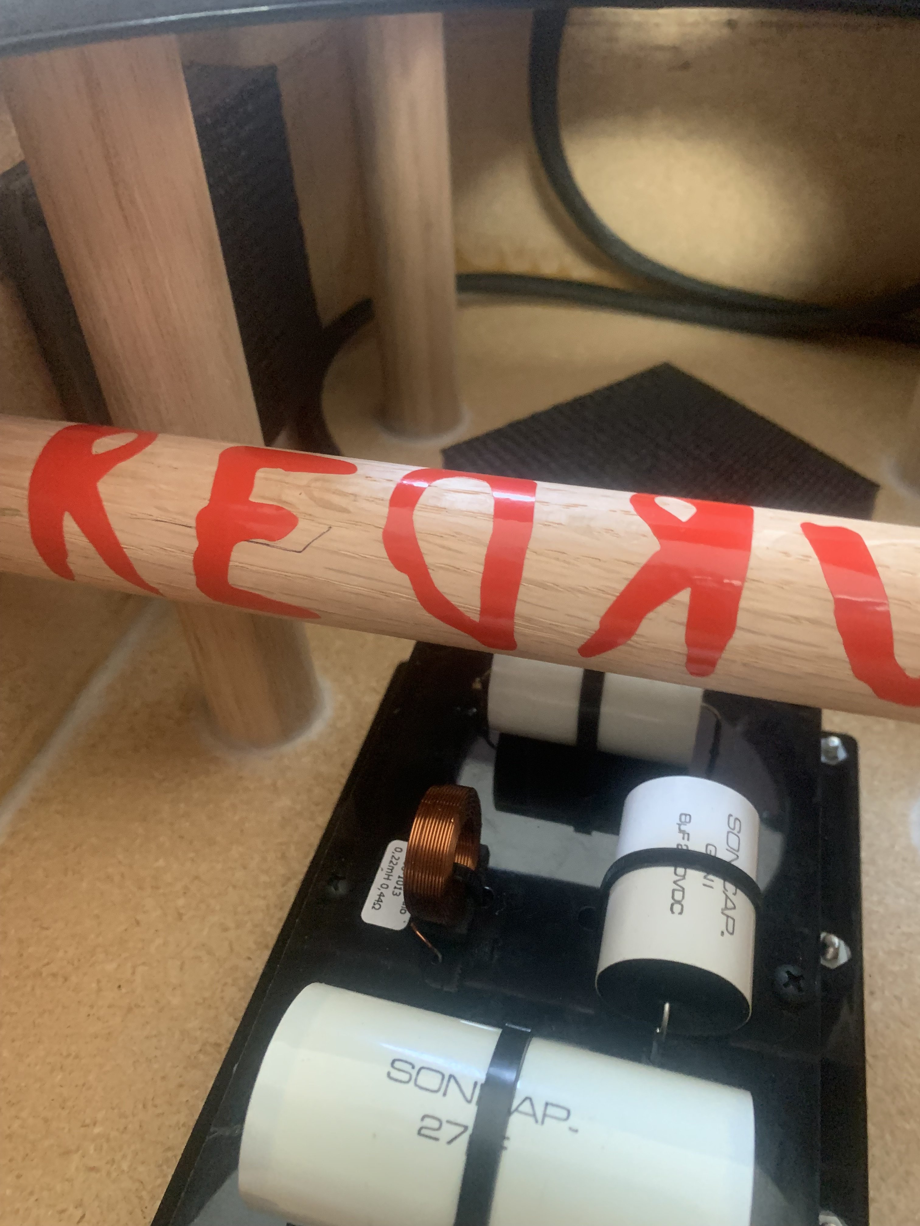

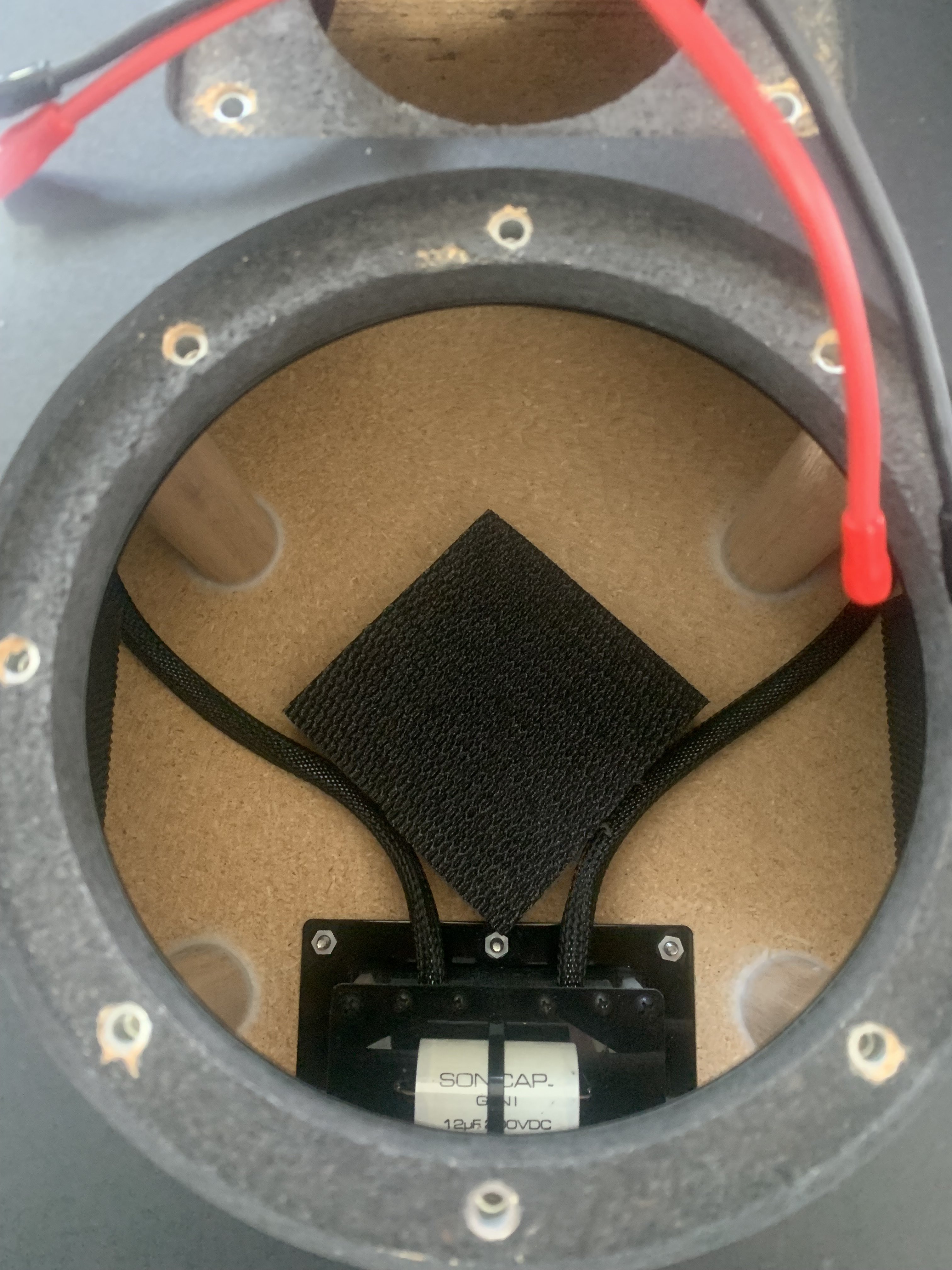

    Brace yourselves!

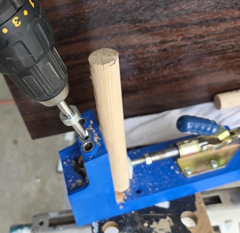

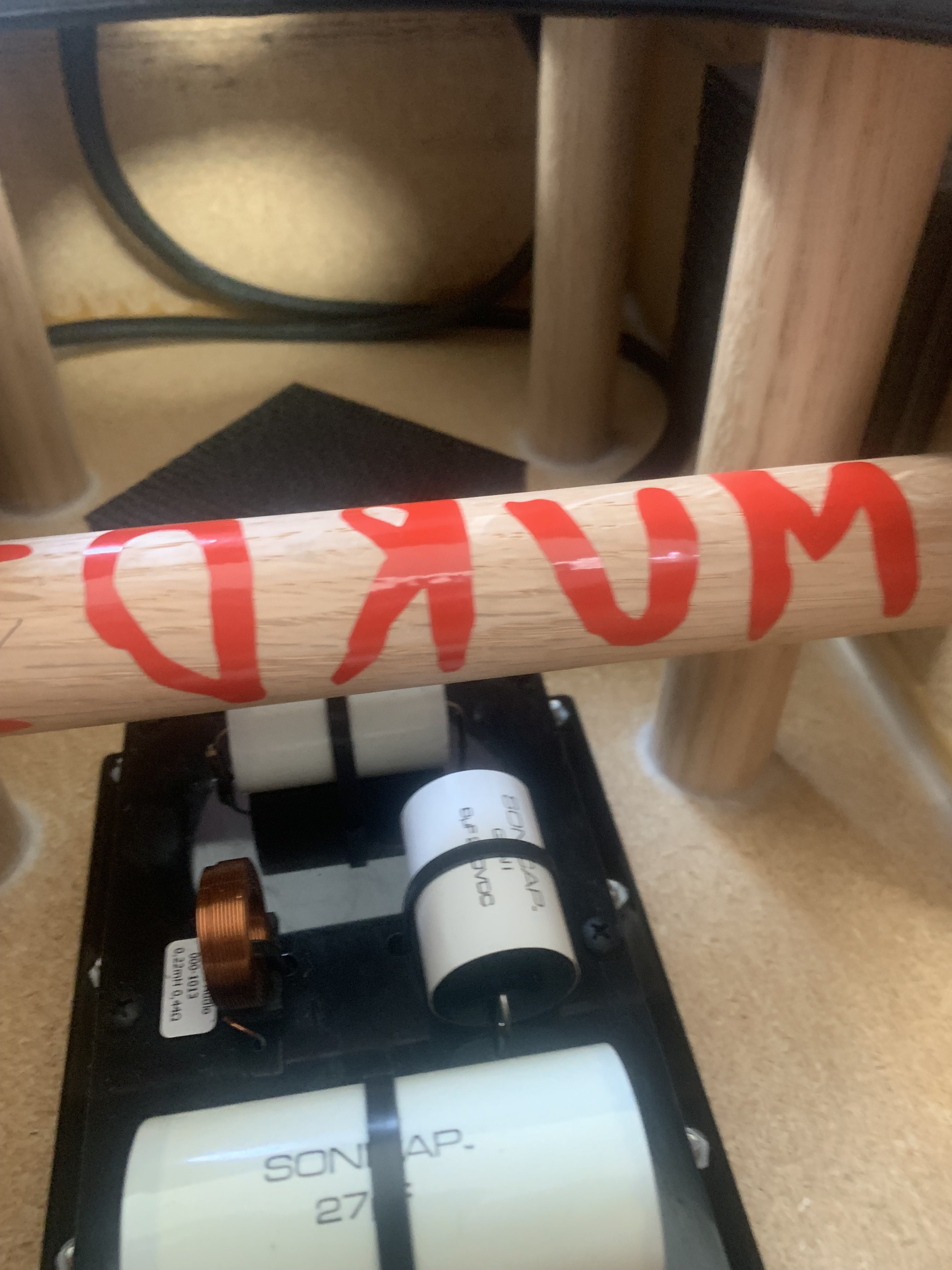

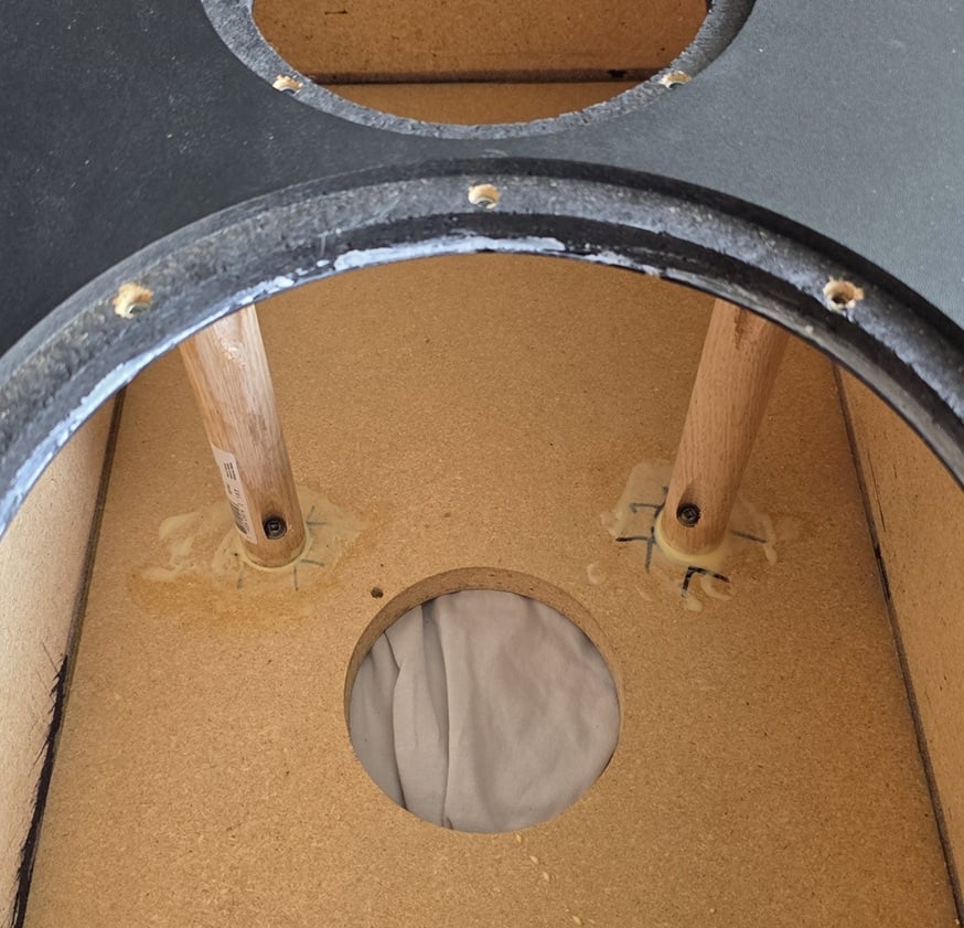

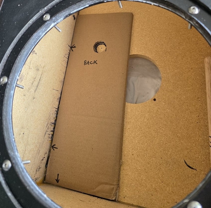

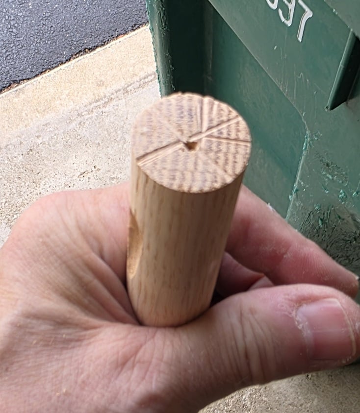

    Rob suggested to brace the cabinets. Two braces on each side about the center line between passive and driver seemed right. Not enough space between driver and passive for one in center. I made a template for marking brace locations so I could apply glue to that area before sliding the near press fit 1” dowels in. You just gotta remember to orientate the template properly for front and opposite side.

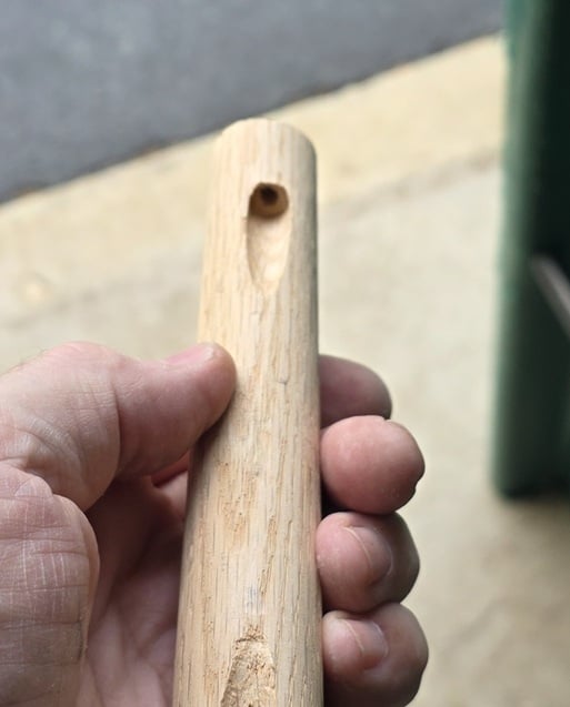

    I went with screwed and glued braces. I used my Kreg pocket hole jig to drill holes. You have to select the correct length screw to prevent an exterior surface alien breakout. Orientation of the screws is important, especially at the front. You only have the speaker terminal plate hole to work through from rear using a drill and extension driver (the easy way) to drive screw in. My old man hands and wrist appreciate the drill method.
    How about that placement. Jig hole B worked best. I used the edge of a file to cut some glue grooves in.
    Maybe brace first... With Larry's Rings installed, to get dowel braces in, I inserted them thorough tweeter opening and navigated them to their proper location. Pretty amazing, the cabinets had no real loose or real tight spots (provided I didn't tip the dowel) meaning Polk did a great job of cutting and assembling the cabinet pieces. I smeared glue about an inch before final placement so ends of dowel could grab some glue.
    After installing braces, I applied a bead of glue around each dowel while on its back. Allow to dry then flip cabinet to do front. Otherwise, gravity pulls the glue down the dowel. I screwed up and drilled one hole for the speaker terminal plate 8-32 threaded inserts clean through. I'll plug it. .75" screws will work fine there without bottoming out.
    We are being careful with grill studs too! Always use spacer blocks of wood when speaker resting on front to save from shearing them off.

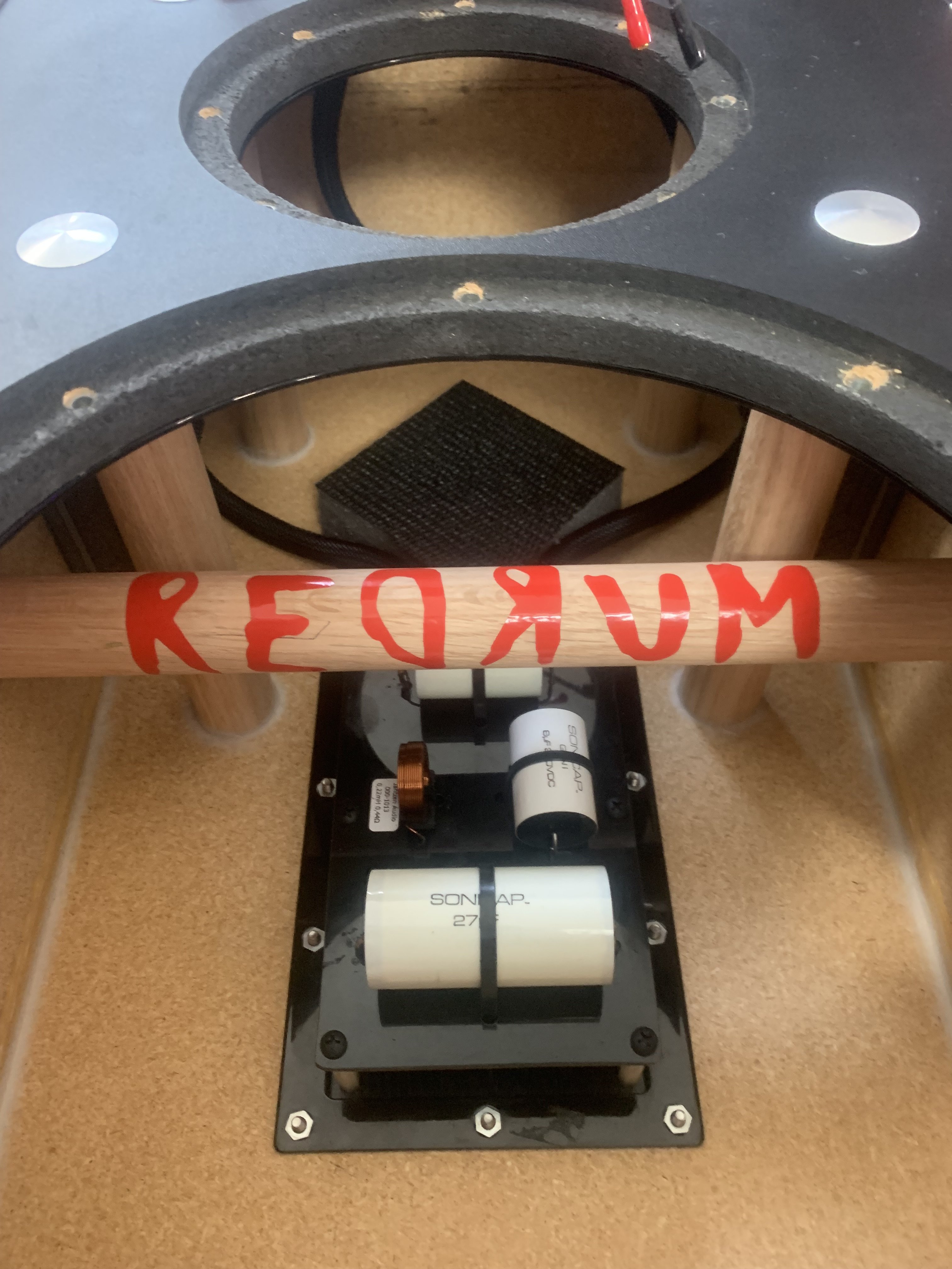

    Toolfan66 Posts: 18,331
    edited July 24
    My bracing was a little overkill 🤣
    Viking64 Posts: 7,737
    Toolfan66 wrote: »
    llikrevo
    SCompRacer Posts: 9,214
    edited July 24
    Had a flashback to Danny riding his bike down the hallway! Redrum! I like that.
    Sweet jebus! Did you do use engineering software or just couldn't stop yourself? :D

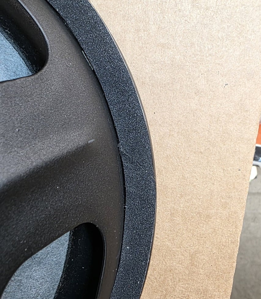

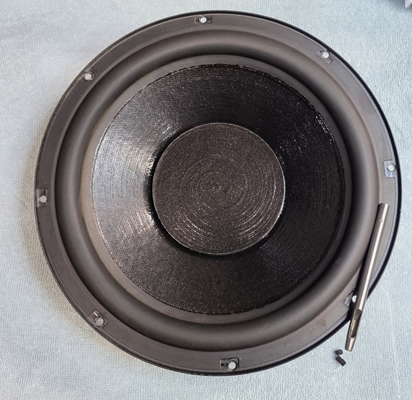

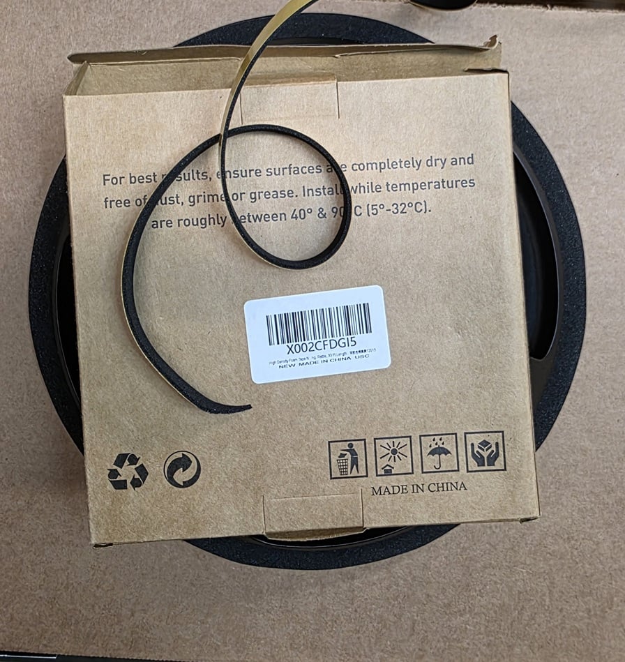

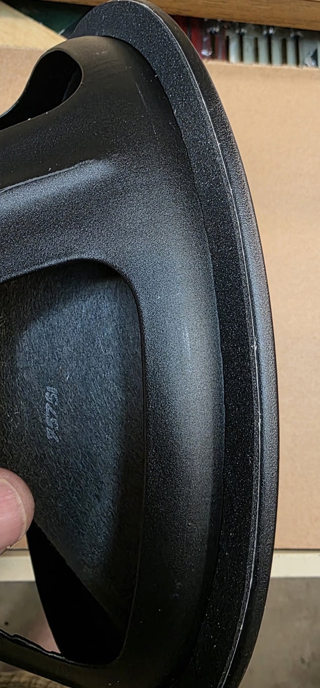

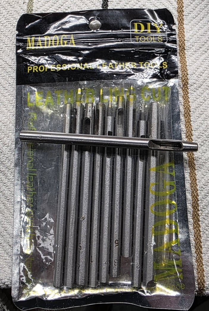

    How's this seal look? I had some tear so got this 1/2"/12.7mm wide by 1/16 /1.6mm thick weather stripping stuff on Amazon. One side adhesive. 33 feet. Bends nicely around curves once the backing is removed. Nice fit and it's black. Link below.
    Splice seam.
    Used a # 4 leather punch to knock holes out.
    https://www.amazon.com/dp/B07Z4PKBC5?ref=ppx_yo2ov_dt_b_fed_asin_title&th=1
