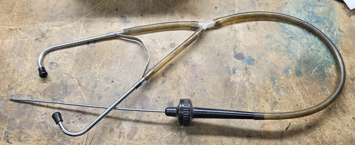

A problem, bearing noise from the Otari MR-1L capstan motor in my Otari MX-5050 BIII-2. Noise is not too bad, but it won’t get better. Cleaning and repacking with grease helped but still have a slight noise. Yes, the front bushing was oiled properly with Otari capstan oil. It is the rear ball bearings that are noisy. A bearing stethoscope confirms it.

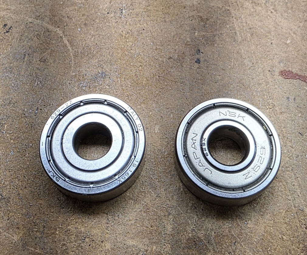

More problems, Otari used custom NSK 629 Z bearings with 629 X marked on inner race indicating custom inner race ID ~ .003” larger than standard bearing. Bigger problem, the last place that had them for $88 each, Precision Motor Works, sold the last two a month ago.

So far so good. No grit in bearings, tape did its job. Old 629 X bearings at right. Let's hope the enlarged ID isn't lopsided and outer race jams in the bore.

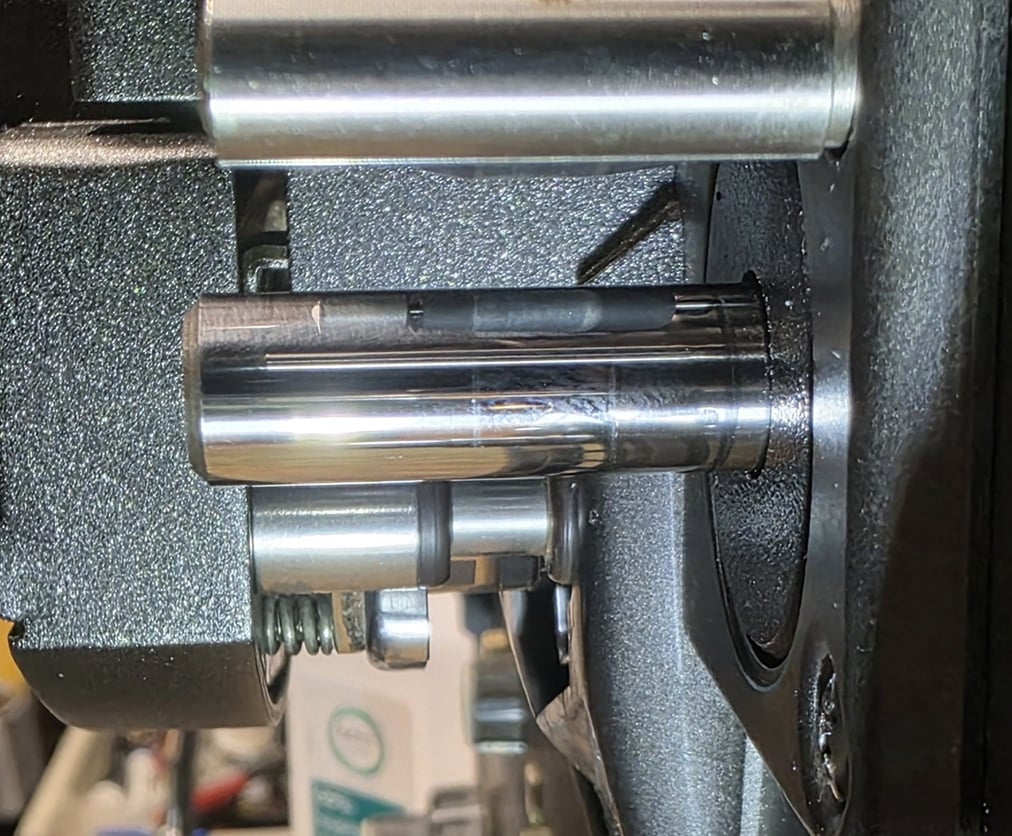

    Thanks! That's a good question. I'd be afraid of pressing the old capstan shaft out with magnets on the front and rear of armature. It would probably be expensive to make the shaft with machining, hardening. The end that drives the tape would have to be perfectly sized or speed would be off. The BII had a glass beaded capstan to drive the tape while the BIII was polished.
    A significant order would be required for NSK to make more. I got an SKF 629 2Z for comparison.
