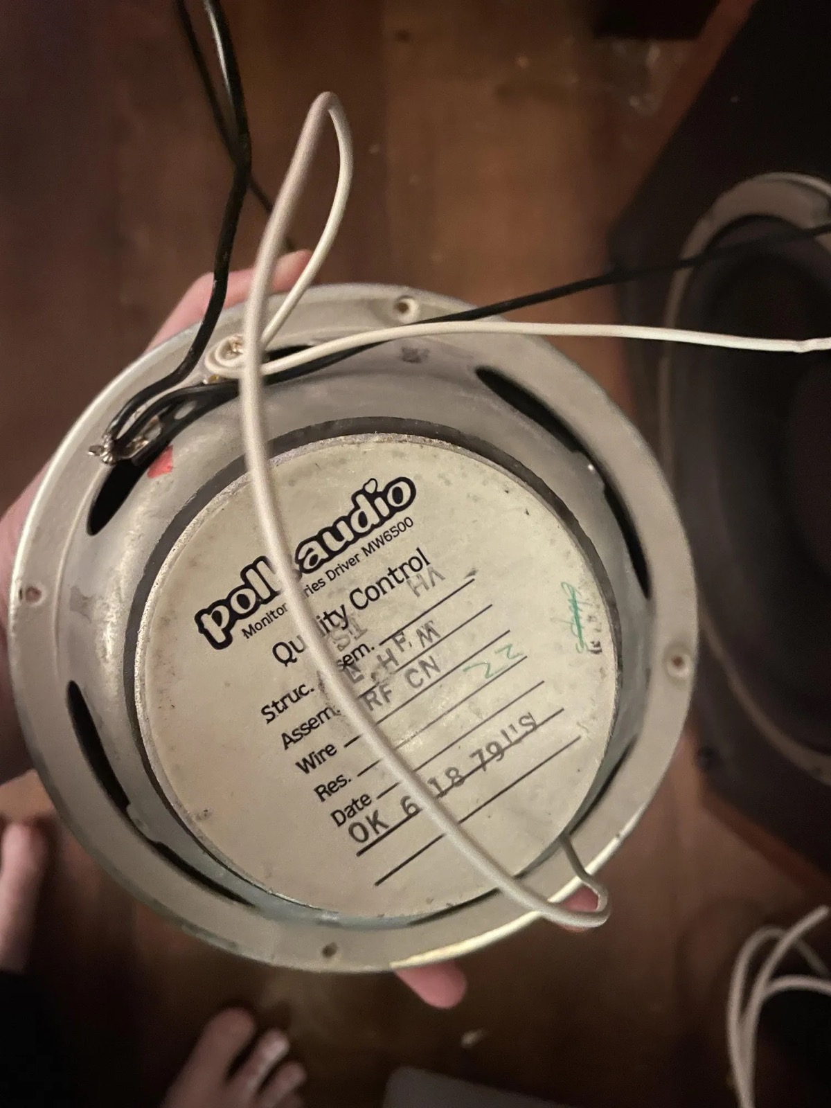

    This photo is from my first post on this forum, how the wires were connected originally before I replaced or changed anything. that’s the driver that connected directly to crossover and other driver. and why I wondered if soldering directly like they did might be easier, without any fastons. I am not sure of using the top tab in terms of how they fit I think it would easily become disconnected and that may have been a part of my issue (along with the too big fastons)

    Polk used a higher AWG (smaller wire) and therefore it was easier for them to solder to a single tab. Sometimes it is advantageous to bend the tabs at their base while keeping the rest of the tab flat and you can do that.
    When we do upgrades most of us go to a larger wire, like 15 or 14awg. I used 12 awg on my 7B midwoofer lol. For the wires connecting the + to + and - to - you could use a smaller wire than the ones going to the PCB. Try that and see if you can stuff the two into a single Dorman 0.187.
    Yeah sure. Solder if you want to ensure consistent contact and sacrifice driver ease of swappability.

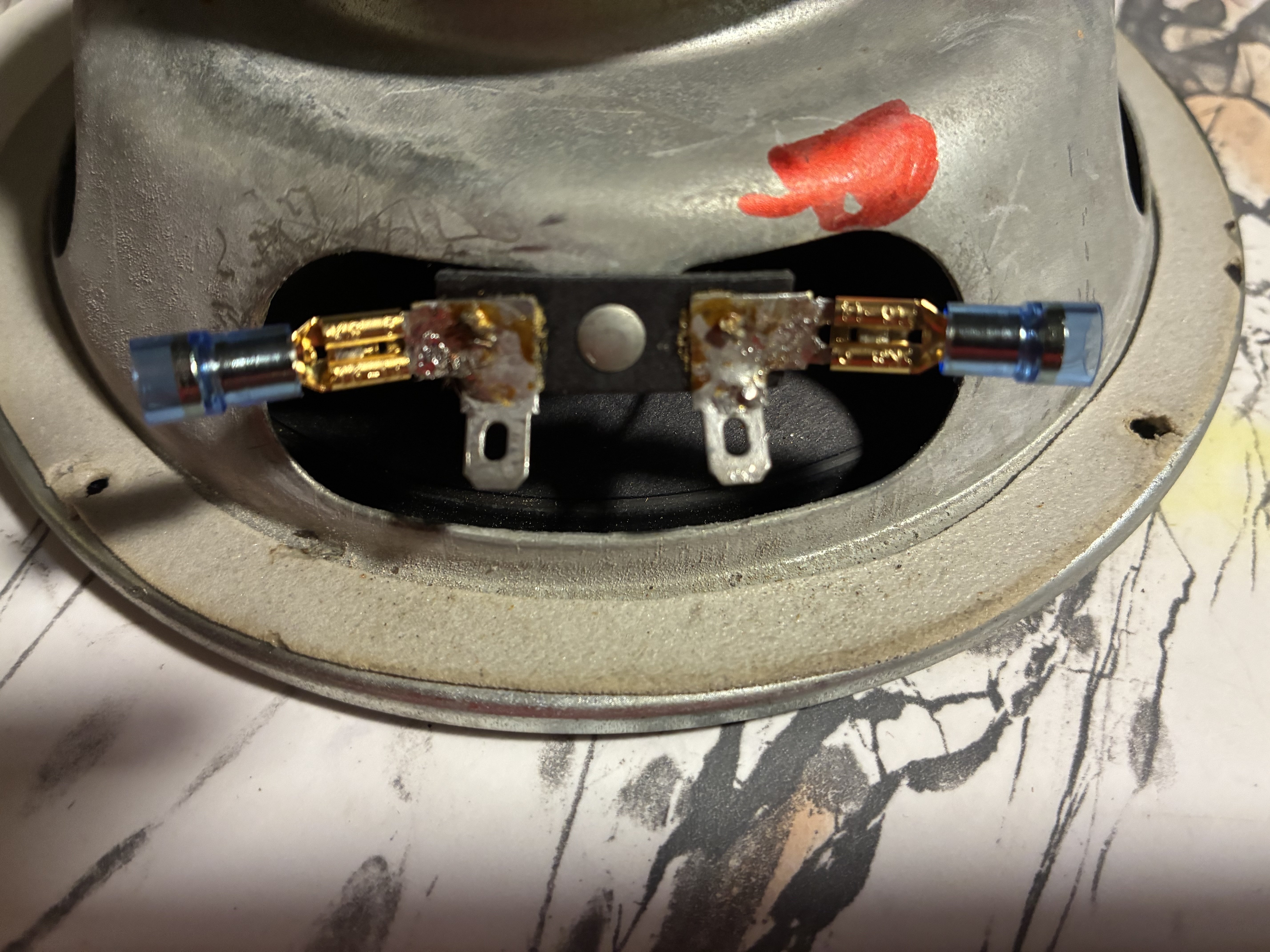

    so success with filing the tabs a bit to get dormans on. Also I think what helped is that this is less than half a millimeter, when I tried thinking about in inches I kept thinking it was more filing than it actually was, but in metric it made more sense to me and seemed more manageable. (this is the other one)
