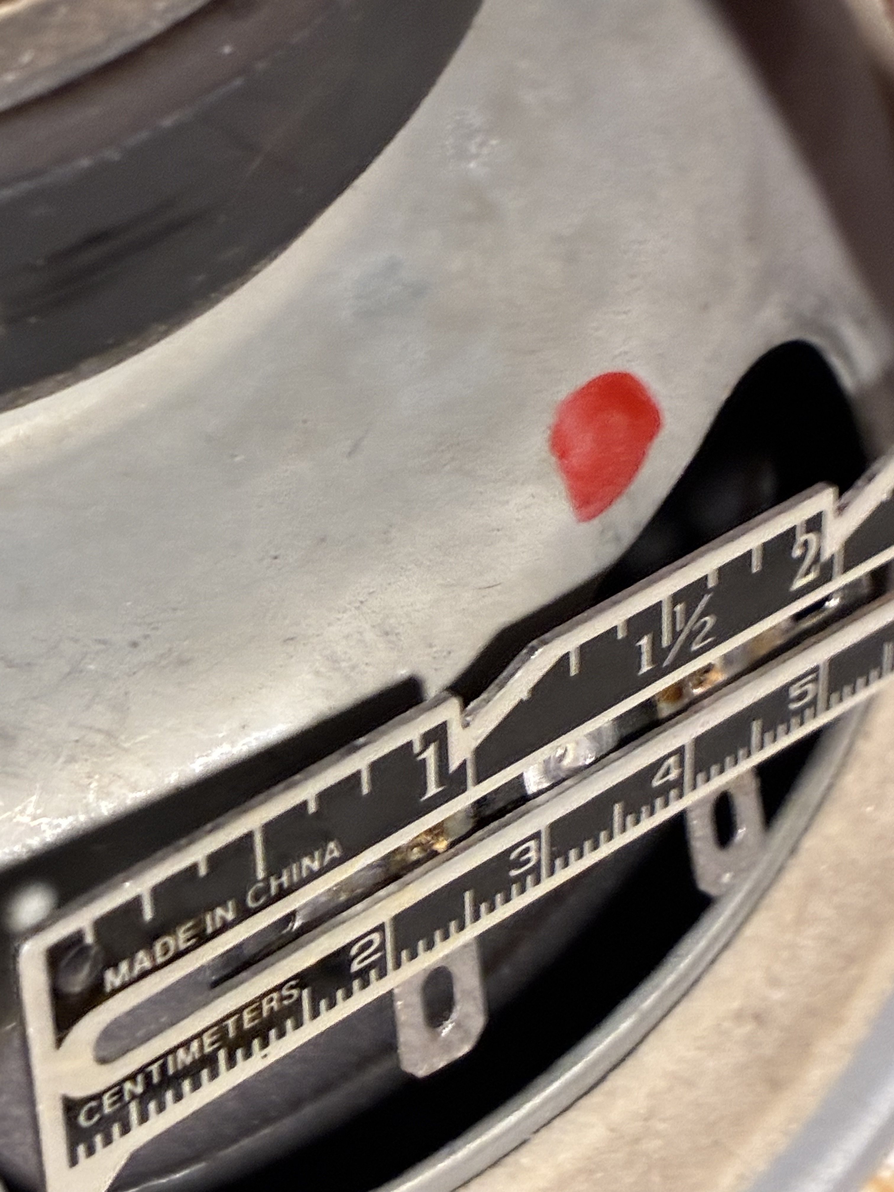

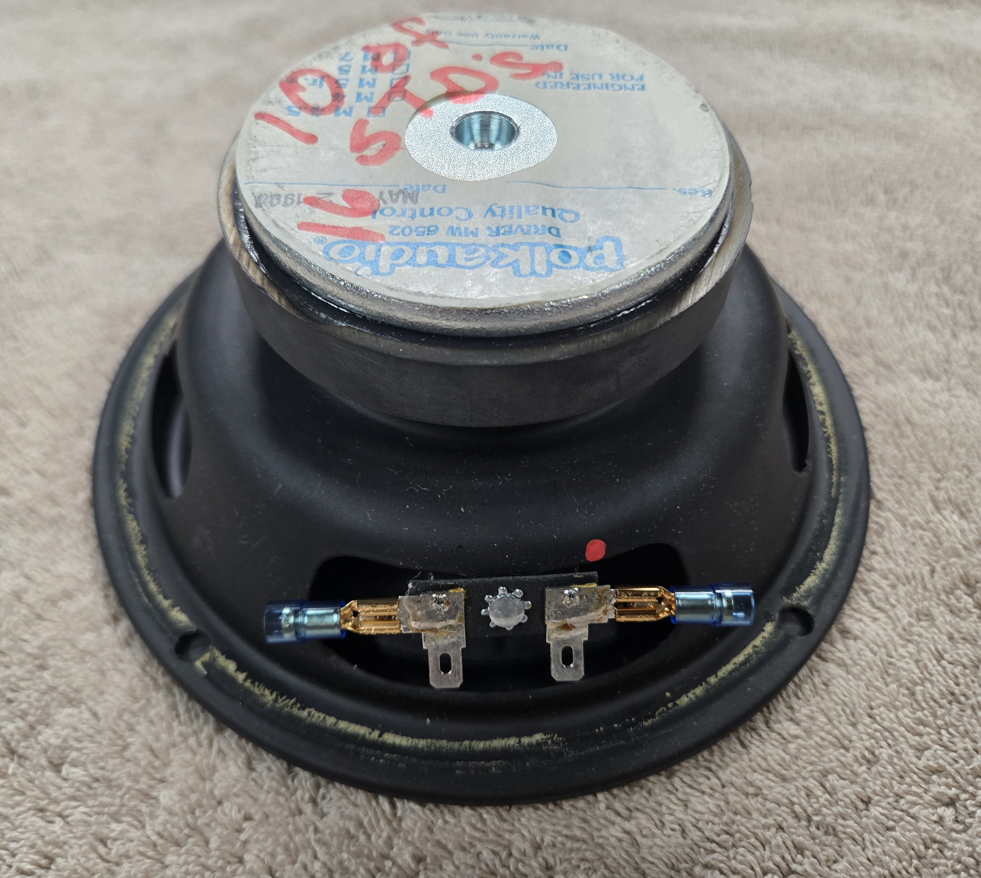

    update:
    I removed drivers, tweeter and crossover from one speaker, I could not fit the .187s on the driver or .110s on to the tweeter and the few times one did fit they seemed like they might tear off the tab. I tried two different brands. I can see that these should be the right size, but solder is preventing that. And I still have little ventilation in my apartment. I don’t have another place nearby I can go desolder these. (maybe I have bad technique but I find desoldering far more fumy than soldering). So how much would my idea of cutting the wires, solder the original end to the driver and putting fastons to connect the cut wire degrade sound quality? Or other ideas?
  • Gardenstater
    Gardenstater Posts: 4,829
    edited May 15
    In what way do they not fit? Blobs of solder causing problems? Tab too wide?
    I have used a brand new Xacto blade in Xacto knife to carefully (!) remove excess solder.
    The drivers I have have tabs that are around 0.20 to 0.205 in. or 5.2 mm, so not really 0.187 which is 4.8 mm.. They are about 0.020 in. thick. You could take a needle file and file them narrower. The metal dust particles are non magnetic but you of course need to insure that they don't get into the driver.
    These are really 5.2 mm wide tabs, not 4.8 mm. Some 0.187 in. (4.8 mm) fastons might be manufactured to a loose enough tolerance to fit and some might not. 5.2 mm. is actually a standard size also.
    These phosphor bronze tin plated ones from Digikey would fit if you crimped them a bit tighter with needle nose because they are for a 0.032 in. tab thickness, not 0.020 in.
    https://www.digikey.com/en/products/detail/te-connectivity-amp-connectors/42233-7/2284428

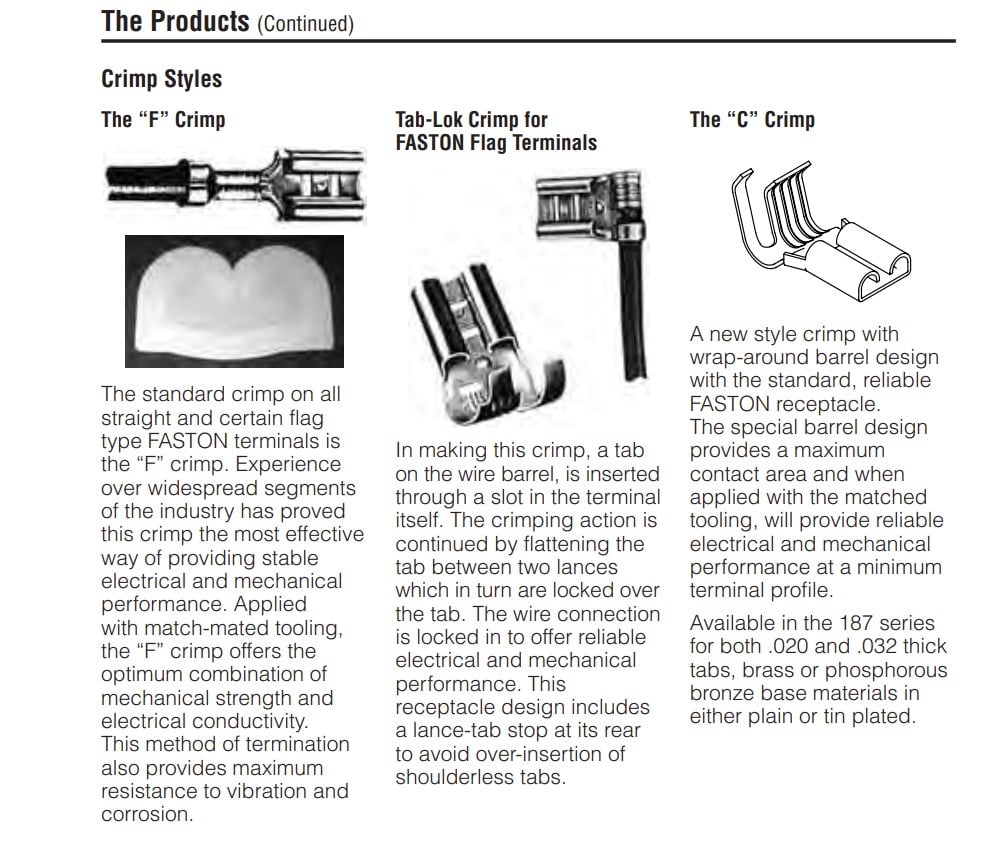

    Get yourself one of the crimping tools that does both the wire and the insulation at the same time, with crimps that bundle the strands in two tight groupings.
    From the catalog https://www.te.com/commerce/DocumentDelivery/DDEController

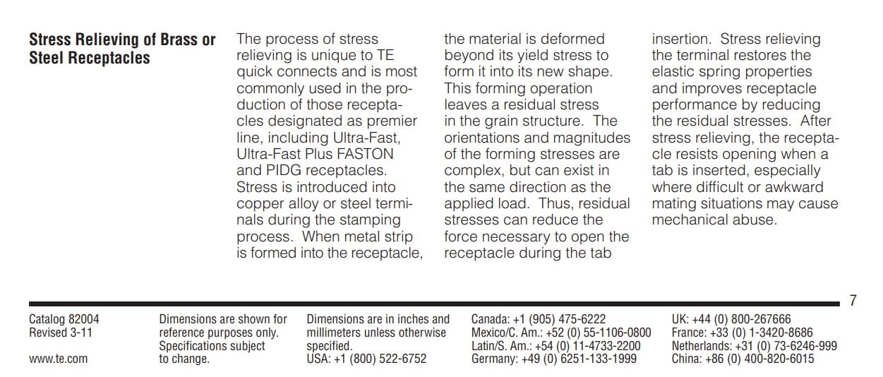

  • Gardenstater
    From the catalog above, a clue as to why some brass fastons might not stay tight and others do. Lack of stress relieving step being performed in the manufacturing:

    Bad link to catalog above. Correction: https://www.te.com/commerce/DocumentDelivery/DDEController?Action=srchrtrv&DocNm=82004_FASTON_TERMINALS_-_FULL_CATALOG&DocType=CS&DocLang=EN
    It hasn't been updated to include new part nos. Date is 2011.

    Internal widths of Fastons (Polk tab width approx. 0.202 to 0.204 in.)
    Polk OEM: 0.221 in.
    Dorman 84546 0.202 in.
    WBT 82856 0.200 in.
    Welp thar's your problem!
    Parts Express has tin plated brass Molex ones that are 0.205 in. although non specified tab thickness (Polk tabs are 0.020 in.)
    https://www.parts-express.com/0.205-16-14-Female-Disconnect-50-Pcs.-095-282?quantity=1
    Also, you do get less contact area because of the hole in the Polk tabs which is approx. 0.070 in. wide and 0.12 in. long and the spacing on the receptacles of 0.32 to 0.55 depending..

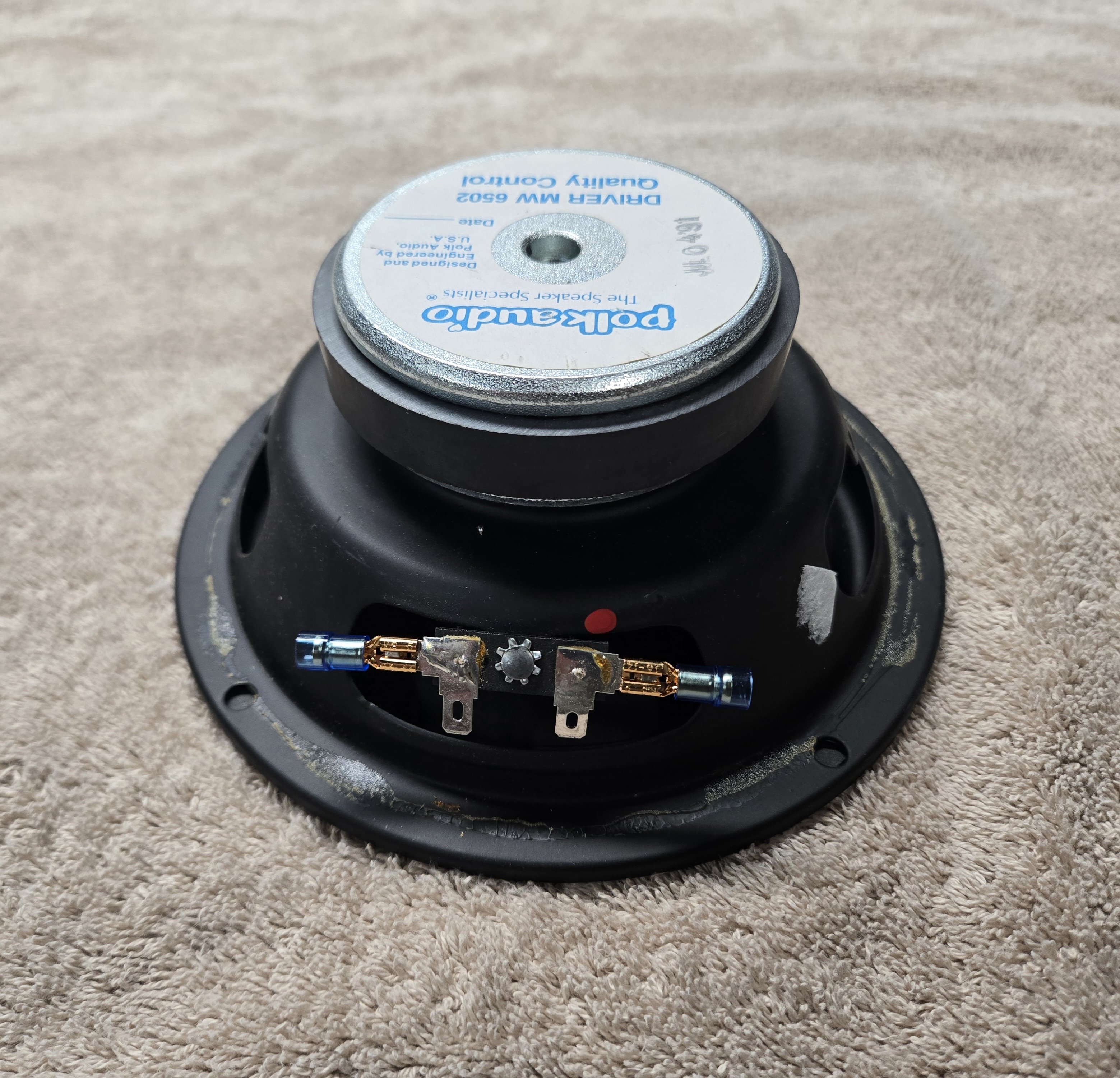

    F1nut Posts: 52,082
    Dorman .187 on a MW6502...no problem.
  • Gardenstater
    edited May 18
    Those are the ones I used on my drivers (earlier MW6500s) but luck of the draw fo sho and obviously some will have interference fit. I can't remember but I think I filed the tabs slightly, or maybe I just forced them on. Having it tight on the sides has an advantage in that it increases contact area to make up for the large elongated hole in the tabs but it could cause them to spring open and decrease contact force on the flat.

    F1nut Posts: 52,082
    Different driver, random Dorman fastons...no problem.
    TIP: if one encounters a faston that seems a bit difficult to push on take a small jewelers screwdriver and slip it in under the curled ear, one ear at a time. Very gently and very slightly pry up on the curled ear. The faston will now slip on the tab without issue.
