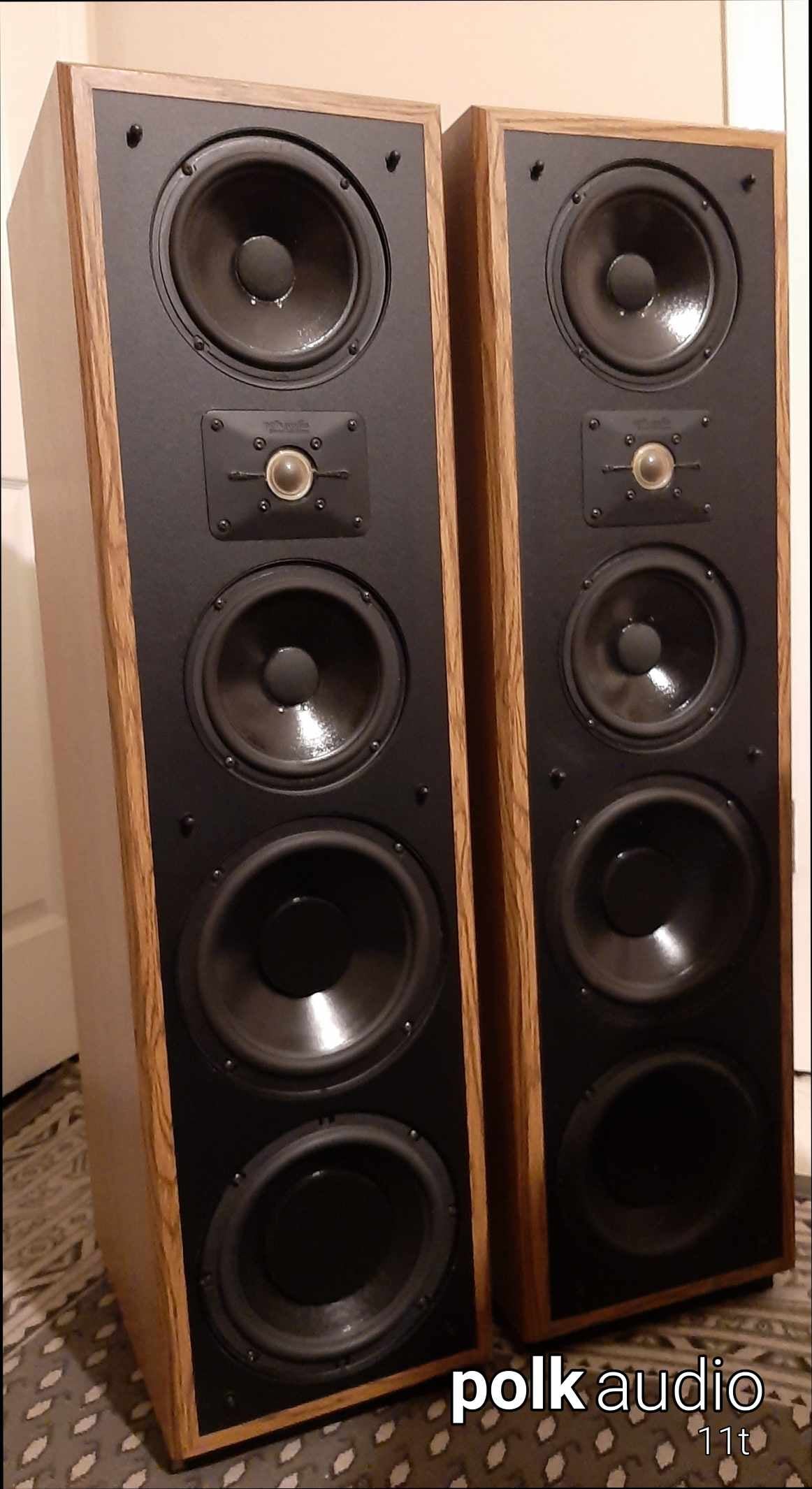

That's crazy cause I had Monitor 11T and they looked like this
That's because yours have a T...for tower.Political Correctness'.........defined
President of Club Polk -
There was some confusion between calling them Monitor 11T and RTA11T. I believe the early ones were Monitor. Same with the upgrade RTA11TL. Early ones were labeled RTA11T eventhough they had the SL3000 tweeter and all the other TL upgrades.Stan
