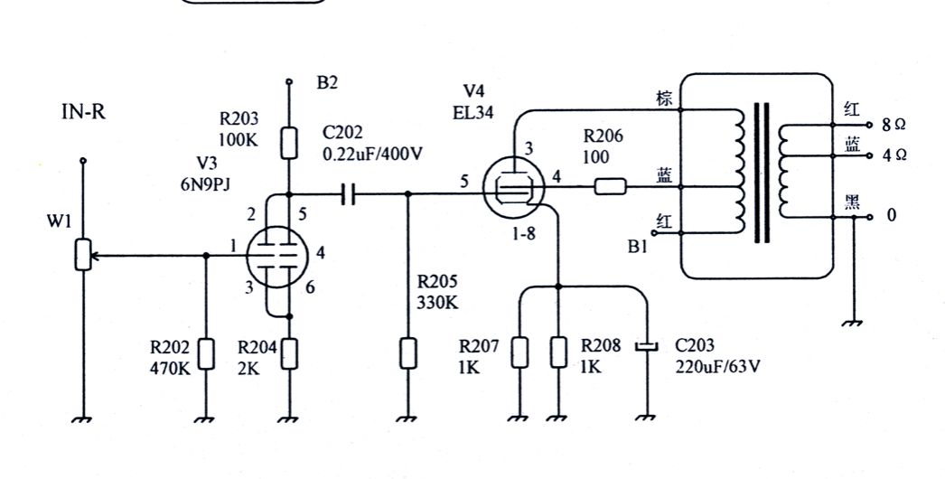

    After a bit of an online search this is probably the schematic for the output stage of your amplifier:
    It shows the "0" terminal to be connected to ground so it should be fine with the SDA speakers connected. Of course to be sure, connect the amp up to both speakers without the SDA cable attached. Use a volt/ohm meter set to read AC voltage. With music playing touch one probe to the negative speaker terminal, labeled "0" and the other probe to any grounding point, such as the shield side of the input RCA plug. There should be 0 volts on the meter, now touch the first probe to the speaker terminal marked "4 ohms" and there should be numbers displayed going up and down in value. This means that the SDA connection will not short out the amplifier since there is no voltage being generated at the "0" terminal, it is at the same potential as any ground point in the amp.
    mhardy6647 Posts: 35,246
    I agree, FWIW, with @SeleniumFalcon's assessment.

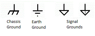

    For the record, the seemingly trivially simple notion of "ground"... isn't. ;)
    Generally, a schematic will show the nature of the signal return/"ground" for signal vs. "earth" and/or the chassis of the component. The latter "should be" ;) at 'true' (earth) ground, but it also might "float".
    https://www.ni.com/en/support/documentation/supplemental/18/chassis--earth-and-signal-grounding--terminology-and-symbols.html?srsltid=AfmBOorza0ZHl1286sswJ3cqlq_d1BWI4b3Fm13LLcF8CQs5nAs2tLEE
    "Pro" sound reinforcement "guys" (ahem, people) need to live or die by this stuff... unfortunately, particularly in times past, literally. :(

    I noticed something interesting about this amplifier, notice the two parallel resistors R207 and R208 which are cathode resistors. Why not use a single 500 ohm resistor? It would give the same value and be one less part needed. I thought about this and believe it is done to reduce heat, each resistor will conduct 1/2 the current improving long term reliability. A second reason is that higher wattage 1 k ohm resistors are more common and thus less expensive than 500 ohm resistors. A third possibility is that parallel resistors have slightly less thermal noise than single resistors. This is why super low noise preamps will use lots and lots of parallel resistors. There is also the parallel bypass capacitor C203 and having the two resistors in parallel will slightly lower the ESR.
    It's the little things.
