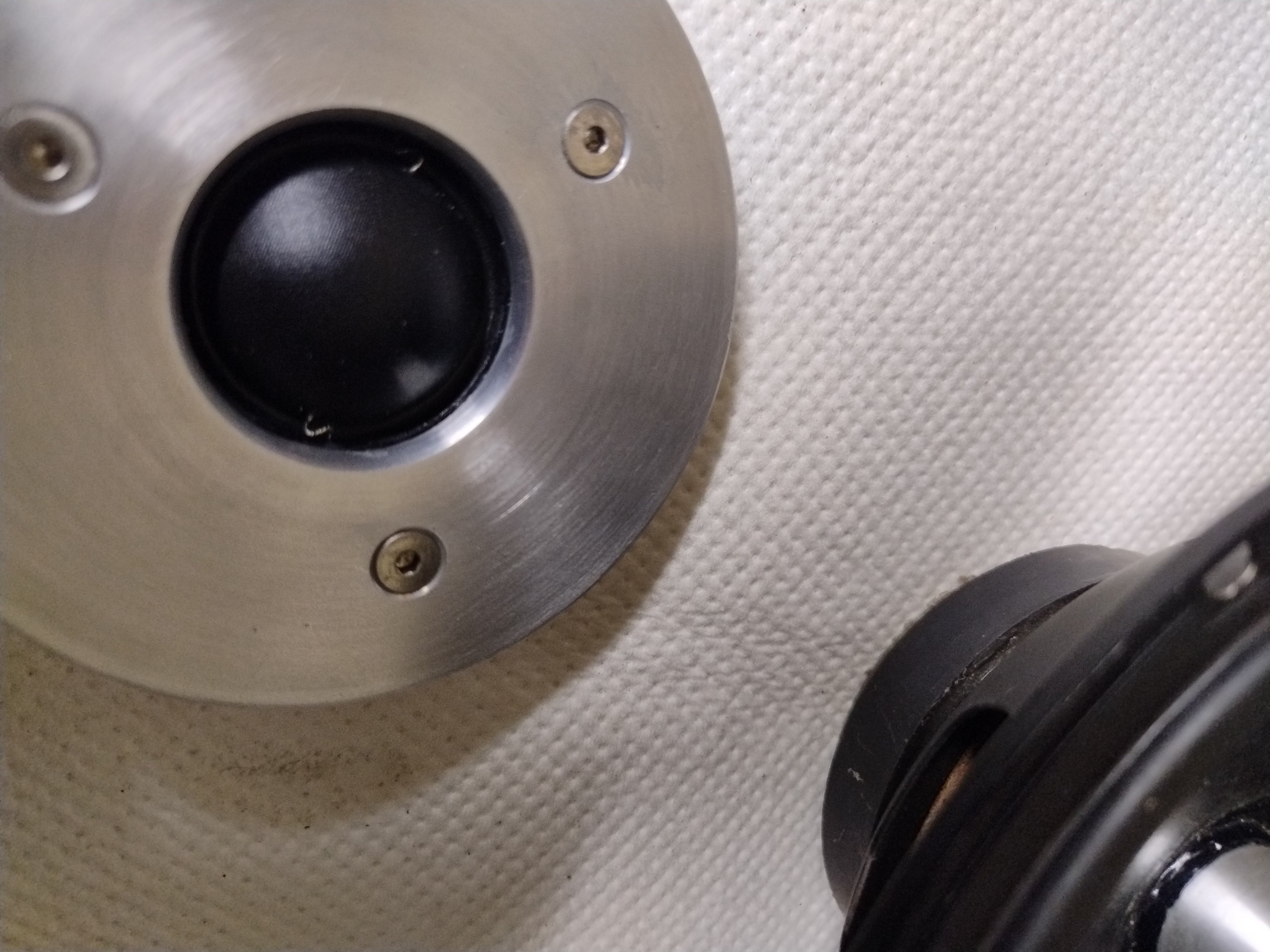

    the tweeter cap if need be for a 28mm black silk...
    Dayton ND28F-6

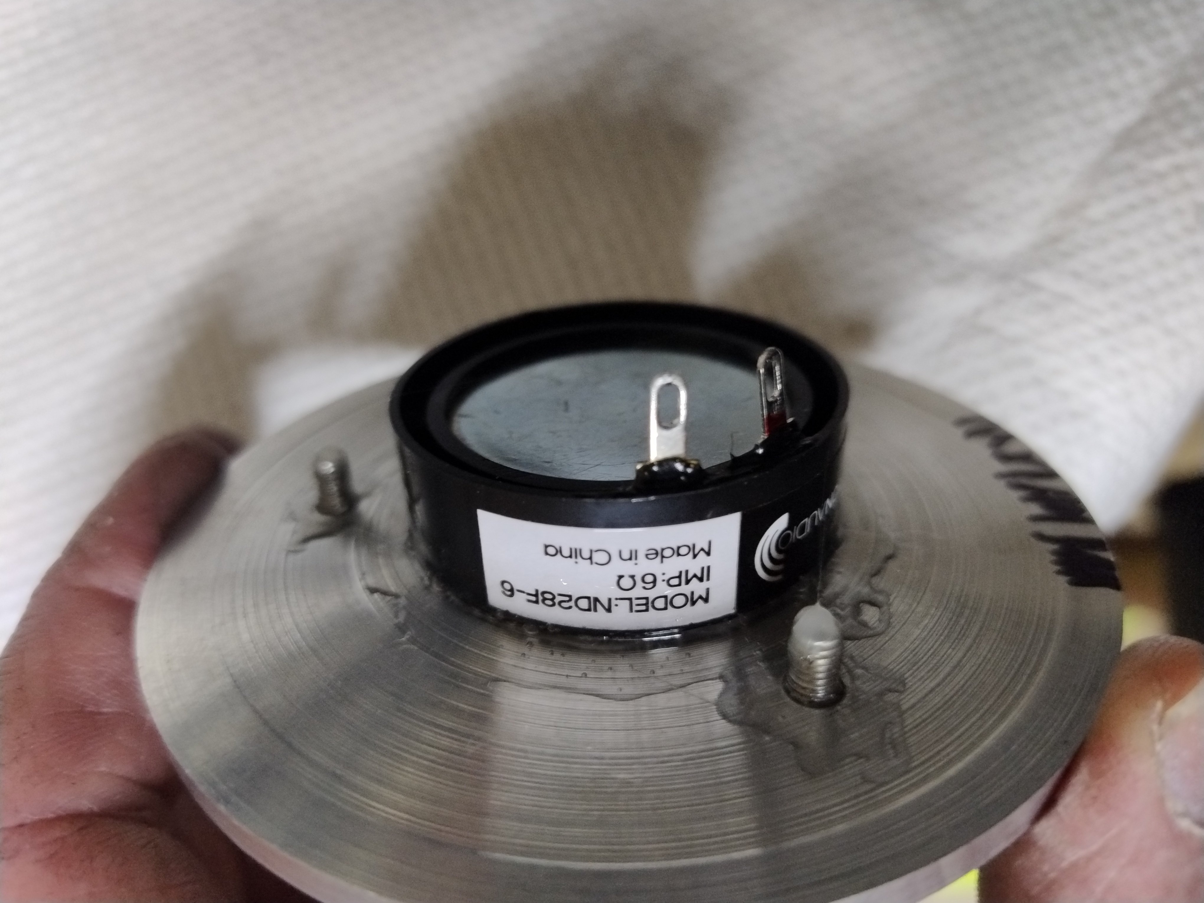

    I removed it's plastic factory bezels last week and carefully glued on the old DC28F billet bezels and tested them in 5Bs taped up temporarily. Sounded very similar with a touch more top end sparkle.

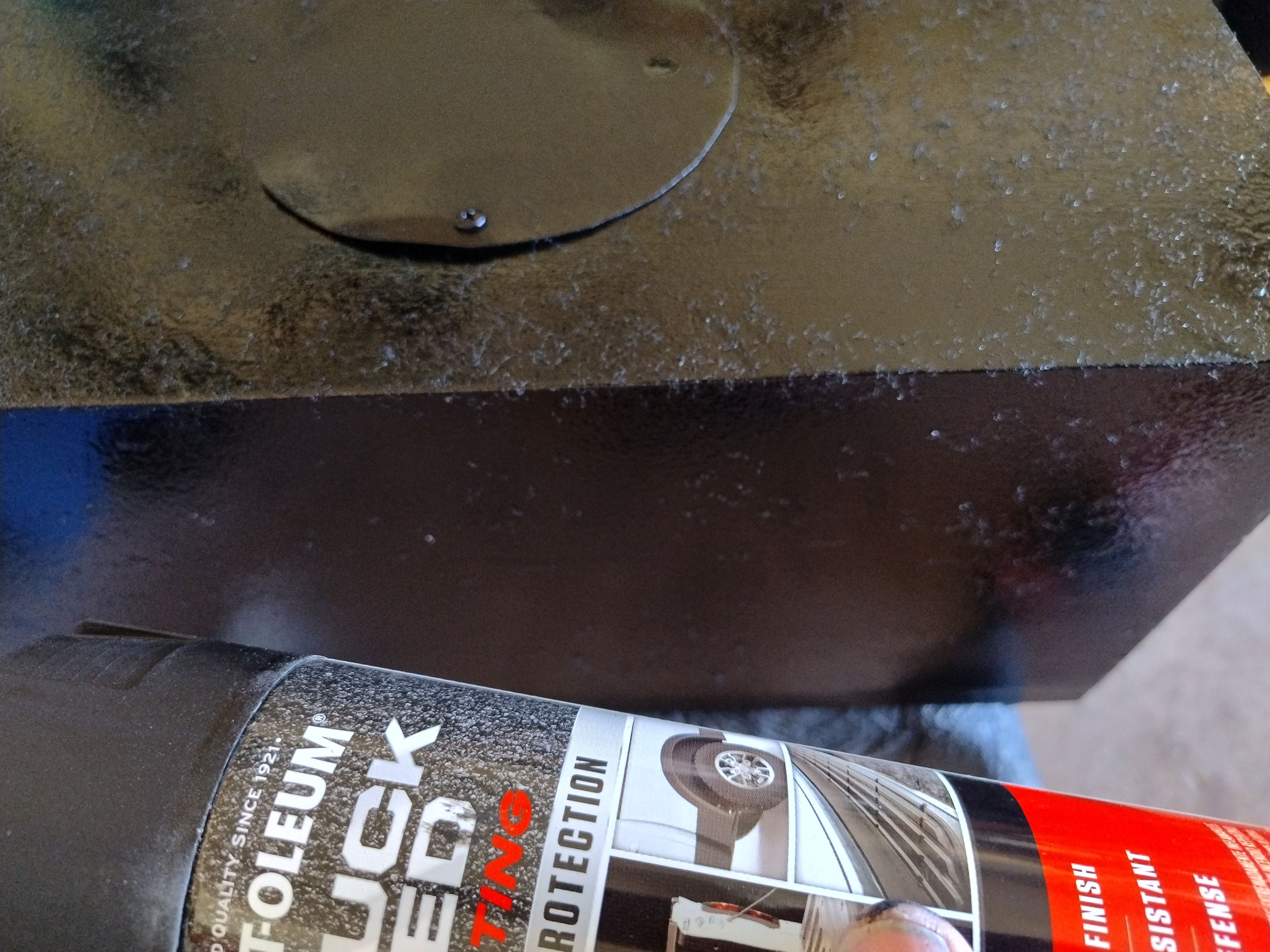

    Rustolem truck bedliner is crap. Not the right texture like the 5B customs.
    Going to order the Herculiner.

    Ahh you nixxed the magnet screws in the Dayton and glued to the faceplate? How do they compare in SQ to the RD0s? Too bad we are missing sensitivity data for all the Polk tweeters.
    Those tweeters are very small. I wonder what it would sound like to turn down the faceplate to a smaller diameter and offset the tweeter in the cabinet for diffraction purposes while keeping it as geometrically close to the midwoofer as possible.........

    These sounded better than 194's, maybe on par with the shimmer of the 198s with the factory 5B crossovers.
