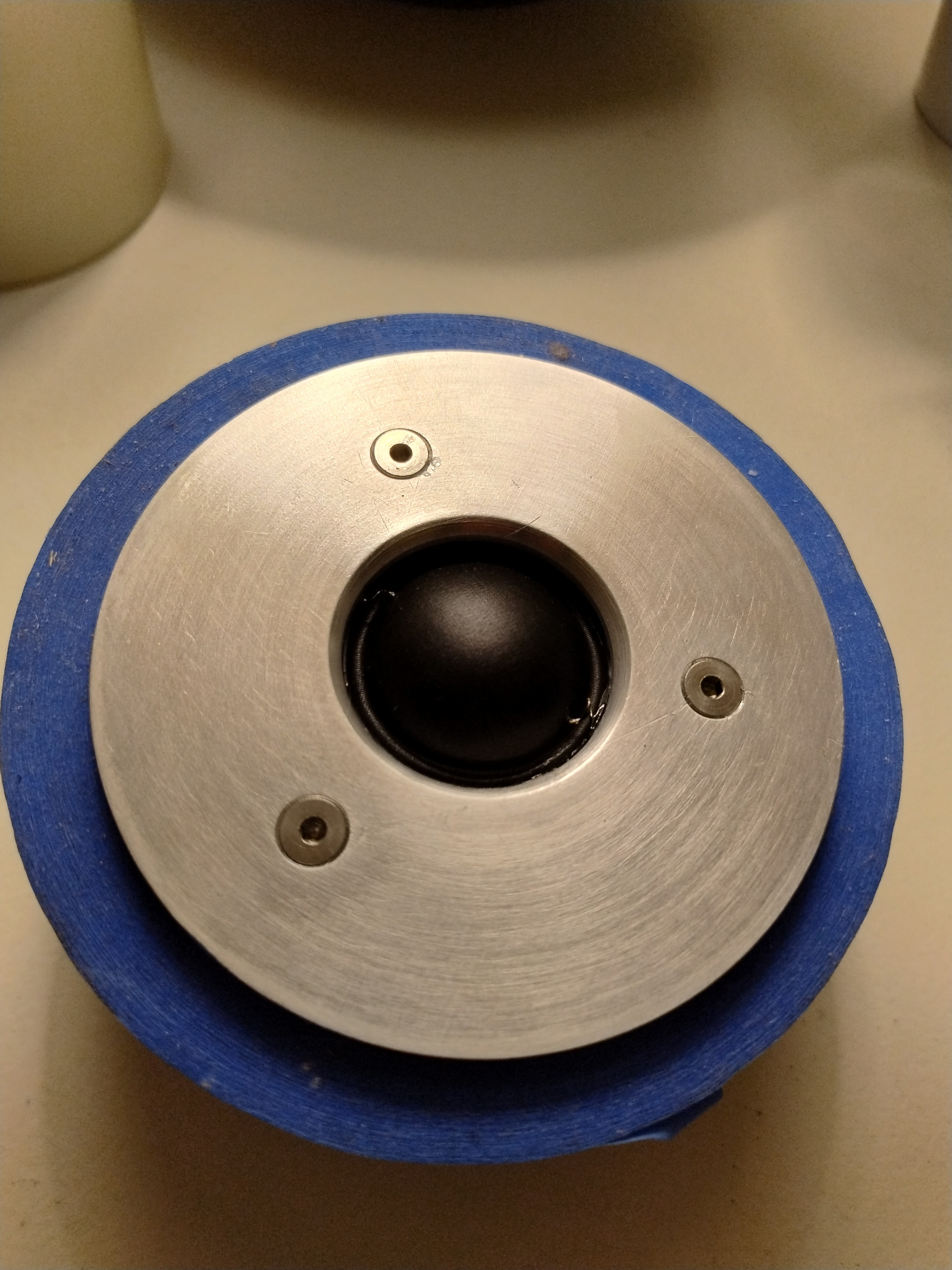

All,
I’ve searched the threads as best I can. I’m looking for pictures on how to upgrade the crossovers on my 5JR’s. I’ve had them since 88, and they’ve been great all these years. A couple of months ago one of my tweeters stopped working. I’ve bought the items needed to upgrade. Specifically new RDO198’s, sonic caps 13UF and the resistors, I can solder and all that. Just not really sure where the new parts go. As they say, pictures are work a thousand words. I’m an newb for this.m0expa0y7g00.jpeg

    OP, you'll never fit all of that on the original board. One option is to mount the new components on a separate board and run leads to the original board. Another option is to make an entire new point to point wired crossover.
  • Original tweeter is an sl2000. F1nut, have any links to accomplish what your suggesting?
    I’ve seen pics of different crossovers having the components being mounted on the back of the board.
    F1nut Posts: 51,912
    In that case you bought the wrong tweeters, you want the RD0194.
    No links that I'm aware of, but some searching online should turn up something.
    The problem you have is a serious lack of real estate.

  • Thanks for the information, I had ordered the 198’s prior to removing mine. Didn’t catch that mine had the sl2000’s until now. Curious. What’s the difference between the sl2000 and the sl2500?

    Thanks for the link. Looks like I’ve jumped the gun on ordering parts. I based the parts bought on it appears series 2 JR’s. Guess I’ll see if I can return the 198’s for some 194’s.

    I installed the resistor in place of the poly switch and installed the two 6.8UF's in series. Installed new RDO198's and put the crossovers back in. Both speakers work and sound much better than they did before. Thanks everyone for the help on this. Hope the pics help someone else who is new to all of this. Please excuse the dirty solder joints. Pic was taken prior to cleaning the boards of the extra flux. o5ynknaavlkc.jpg
