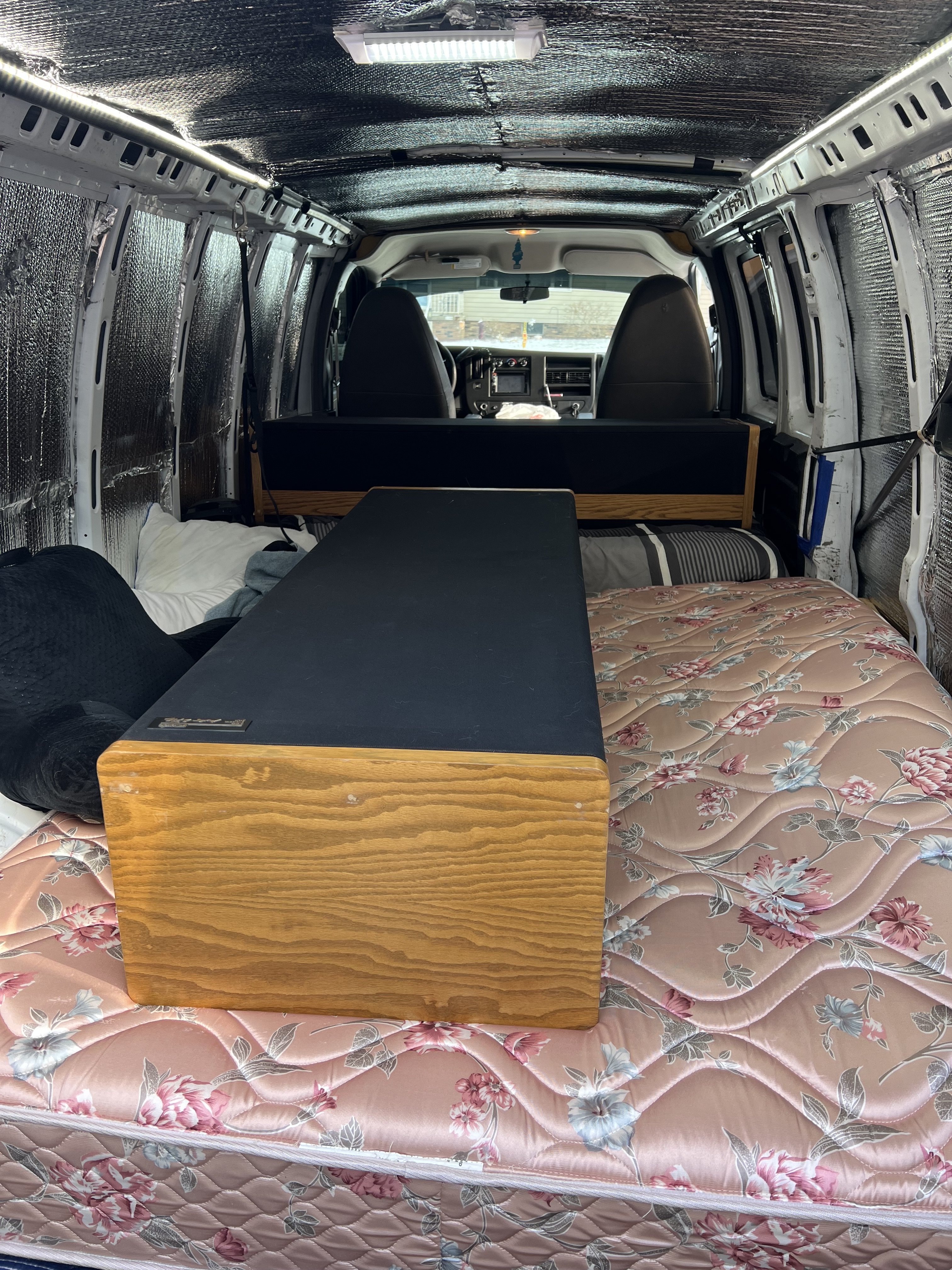

Also, regarding transportation — I see that everyone is saying that the speakers need to be transported on their backs. Unfortunately the trunk in my car doesnt have enough space to place them side by side on their backs. The best I could do is place them (along their height) in a V-shape in the trunk, with the backs facing the sides of the trunk, and the drivers facing each other at an upward angle (crude drawing attached)… thoughts on this?

    You would be at risk of the dreaded magnet shift. If possible remove all the mid-drivers, place in boxes with the drivers facing up or down and transport the boxes flat.

    Another idea is to rent a large SUV or van.

    Renting or borrowing a van to transport them is the easiest/safest idea.

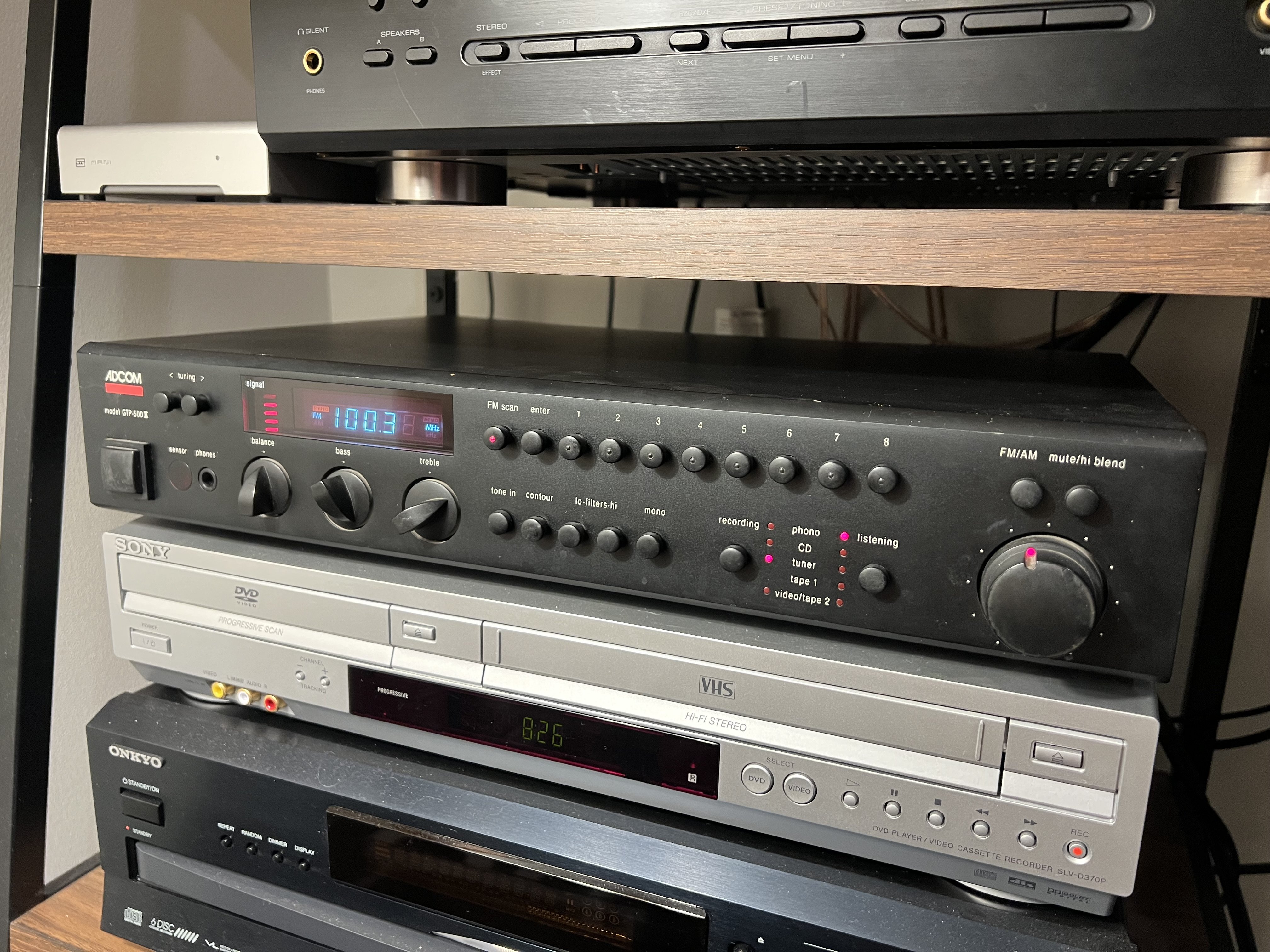

    It's hard to tell from the photos but it looks like the three pieces of equipment at the top of the rack in the original system may have been Sony 300 or 400 disc Megachanger CD players. I had a couple of those way back.

    Thank you all for your input! I will now have a van large enough to transport these towers on their backs, on top of a mattress, with as much padding I can find to put between the towers as well.

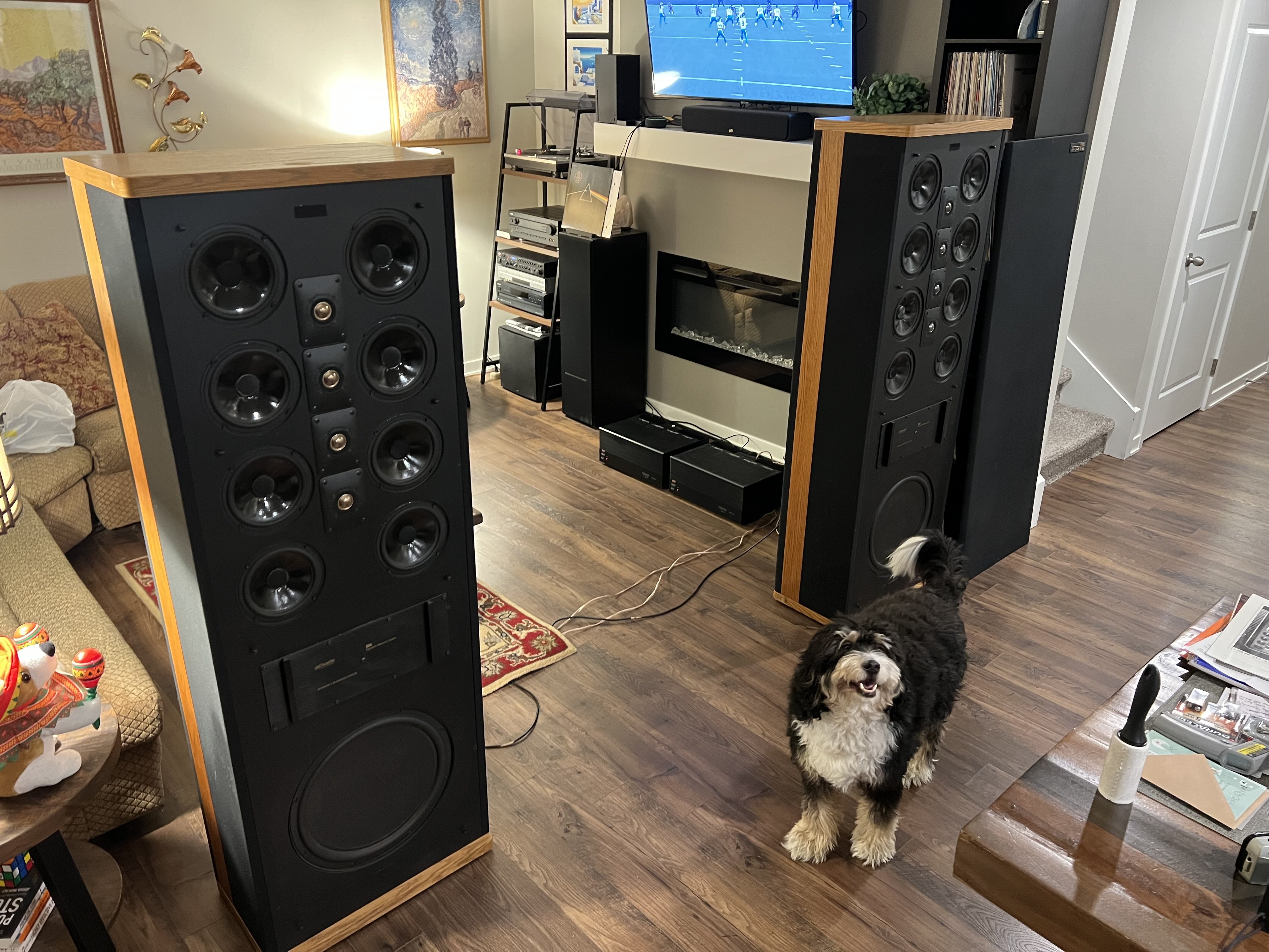

    Gents — Just wanted to update that the speakers were acquired and safely transported back without issues last Sunday! Having a large van with a mattress or futon to lay the speakers on is a must!
    Currently have them set up somewhat crudely in my living room to enjoy (and oh my do they still sound fantastic) before I transfer them to their permanent space, which will be a dedicated in-home listening room.

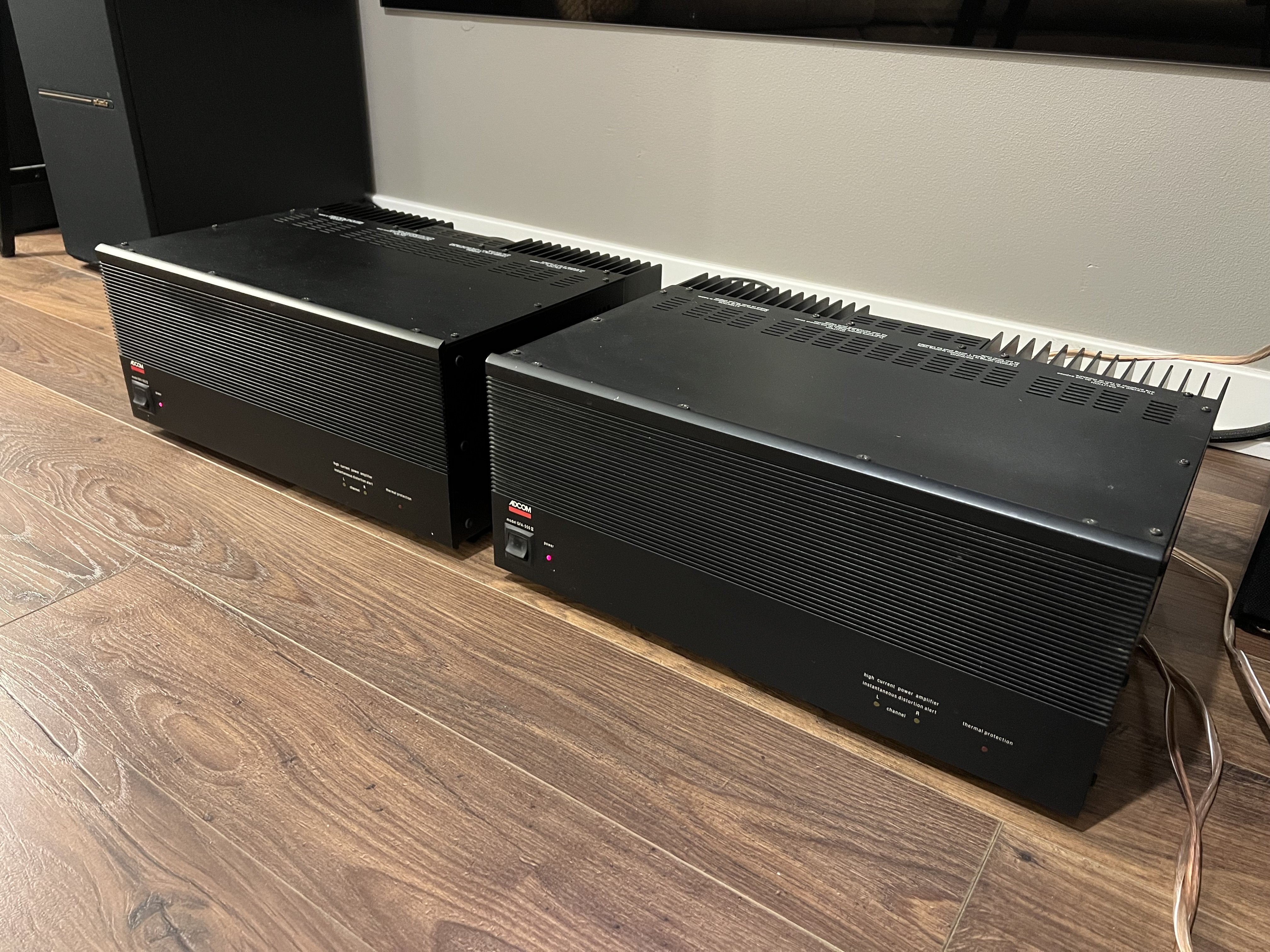

    Current setup includes the following:
    Source:
    1. AT-LP120 TT (modified w/ removed integrated USB/preamp board)
    2. Onkyo DX-C390 CD Player
    Pre-amp: ADCOM GTP-500II
    Amp: Dual ADCOM GFA-555II bi-amped horizontally (one amp for mid-high drivers, and the other amp for low drivers).
    Waiting on delivery of Blue Jeans interconnects and speaker cables to give this rig the quality components it deserves. Also currently on the hunt for a Sansui SR-838 TT…

    ^That's the way to transport these.
    It's how I brought mine home in the back of our Tahoe.
    Good job on getting them home safely.
