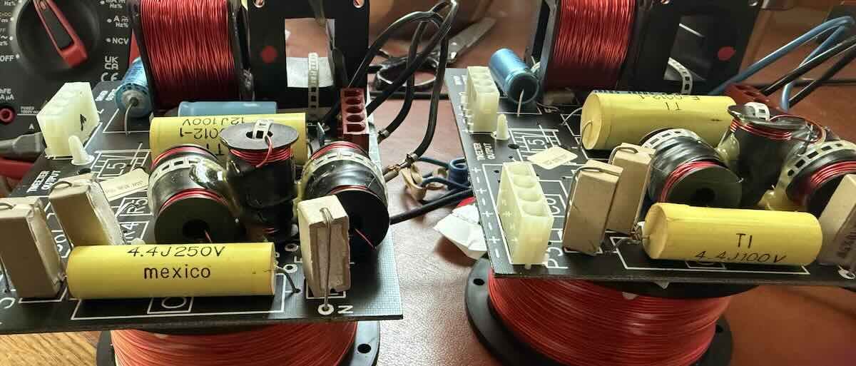

    This seems kinda interesting, one channel has a 4.4uf 250V, the other has a 4.4uf100V and looks to have had a piggyback added and removed at some point.
    Since they're out now, I might as well replace them.
    So the two yellow caps on each board, I replace with the same value Sonicap?
    And I've found Mills 10w 7.5 resistore and Vishay Mills 5W 2.7 Ohm Vishay Mills MRA-5
    Sound like a plan?

    pitdogg2 Posts: 27,201
    Sonicraft are a good choice. Same value, the voltage will be higher and the size larger, that's okay.
    F1nut Posts: 51,920
    If you think replacing only the 4.4uF caps is the way to go you would be sadly mistaken.
    xschop Posts: 5,330
    All those caps are fubar.

    I'm replacing all the caps and resistors (and the polyswitch).
    Thanks for all the help!
    F1nut Posts: 51,920
    Good man. Do not use Solen, Dayton or Bennic caps.

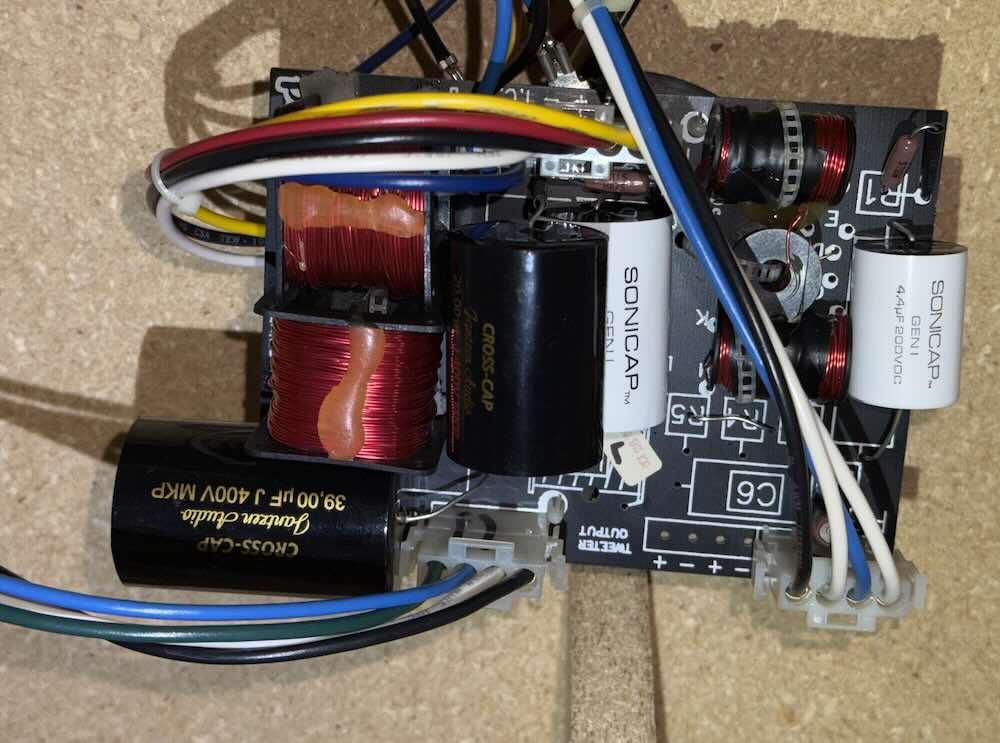

    Got them done finally.

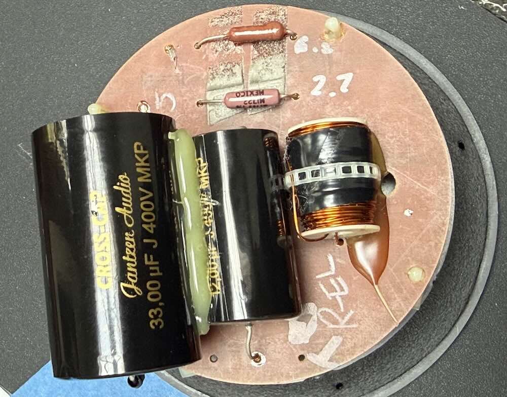

    Did my old 5A's while I was at it:
    F1nut Posts: 51,920
    How's the sound?

    I kind of suck at describing sound, it’s like trying to describe wine for me but the whole “veil lifted “ cliché seems to fit. They sound… silkier?
    I’m still working on Dynamatting the PR‘s and installing hurricane nut so I haven’t really pushed them yet.
    The 5a’s were a similar improvement.
    F1nut Posts: 51,920
    There ya go B)
