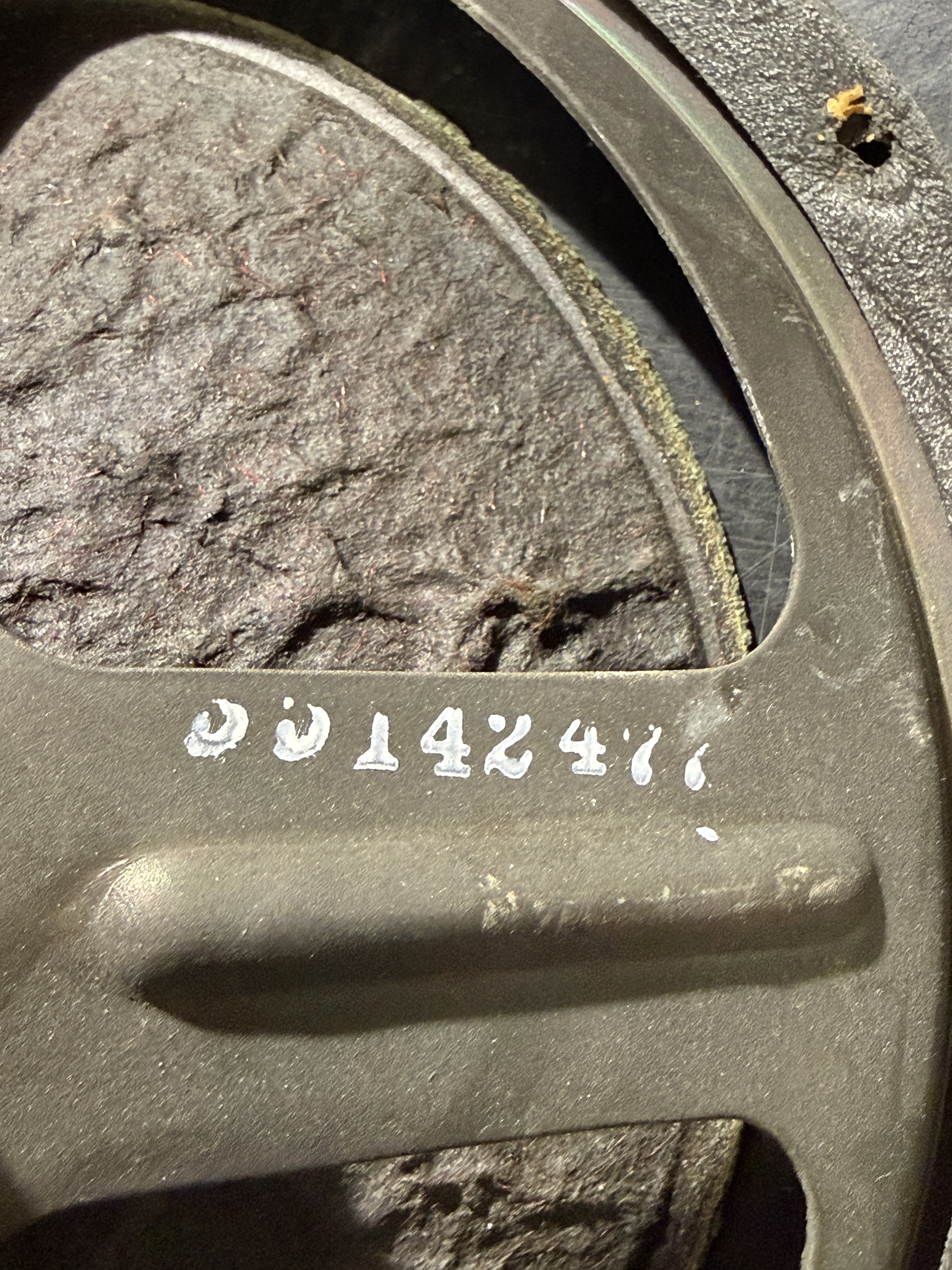

mid 70s KLH Woofer made by Polk?
I have a mid 70s KLH woofer from the Baron (model 355) speaker that has a mfg code of “DD142477”. The 1st 3 digits, “142” are supposed to be the driver manufacturer. When I searched who is “142”, it came back Polk(!) Is this possible? Thoughts?356j5jn59nss.jpg

    If that's a 10” woofer, it's probably not from Polk. Polk's early models were all based on a 6.5” woofer combined with a passive radiator. I don't think they ever made a 10” driver.

    Update: now the code “142” is returning “Heinz and Kaufman, Ltd”, Culver City, CA. So maybe not Polk, but I can’t find anything on H&K in the 1977 era, though. Does anyone remember them making drivers in the 70s?
    billbillw Posts: 7,735
    I think you are trusting that old number too much. They were probably from Peerless or made in house by KLH.

    The Audiokarma forum may have some members who have history on the woofers in these. I understand the Model 355 woofer is an odd sized 11 inch. KLH + Infinity was a far bigger speaker manufacturing company than Polk back in the late 1970s and tended to use drivers from their own sources. For example, the Peerless tweeter seen in those was from their company stable.
  • Gardenstater
    Gardenstater Posts: 4,801
    It might be 55142477. Could be a Peerless woofer mfg. date 24th week of 1977.
    This seems likely, “55”, vs “DD”.
    and if “55142” corresponds to Peerless, I’d say you are right.
    I’ve only heard of Peerless in relation to tweeters, sounds like they made woofers, too?

    Danish, although the ownership of the company has had many international twists and turns over many decades including US ownership for a long time. That's why there's a link between Peerless and KLH.
