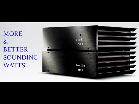

    Steve Guttenberg did a, rather long-winded, review of the SIT-5 amps earlier this year. He did use them with a range of speakers from high efficiency to low efficiency older Magnepans.
    https://www.youtube.com/watch?v=ongk4CApoKs
