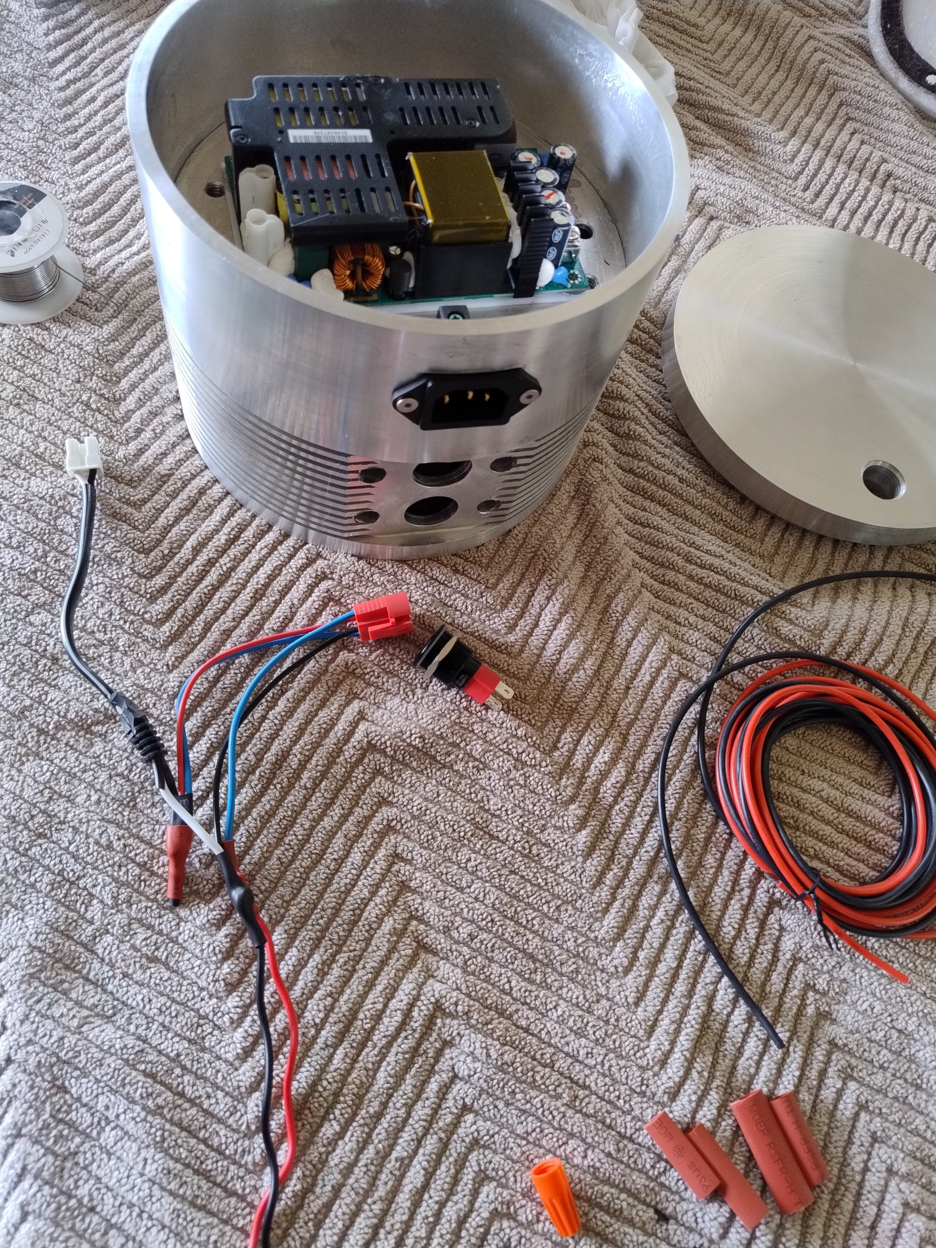

    Not sure I posted this pic. Still running this amp on my desktop setup. Starting to pre-game a Starkrimson module build with one of these cases, instead with heatsinks towards the top and SWPS/IEC at the bottom...

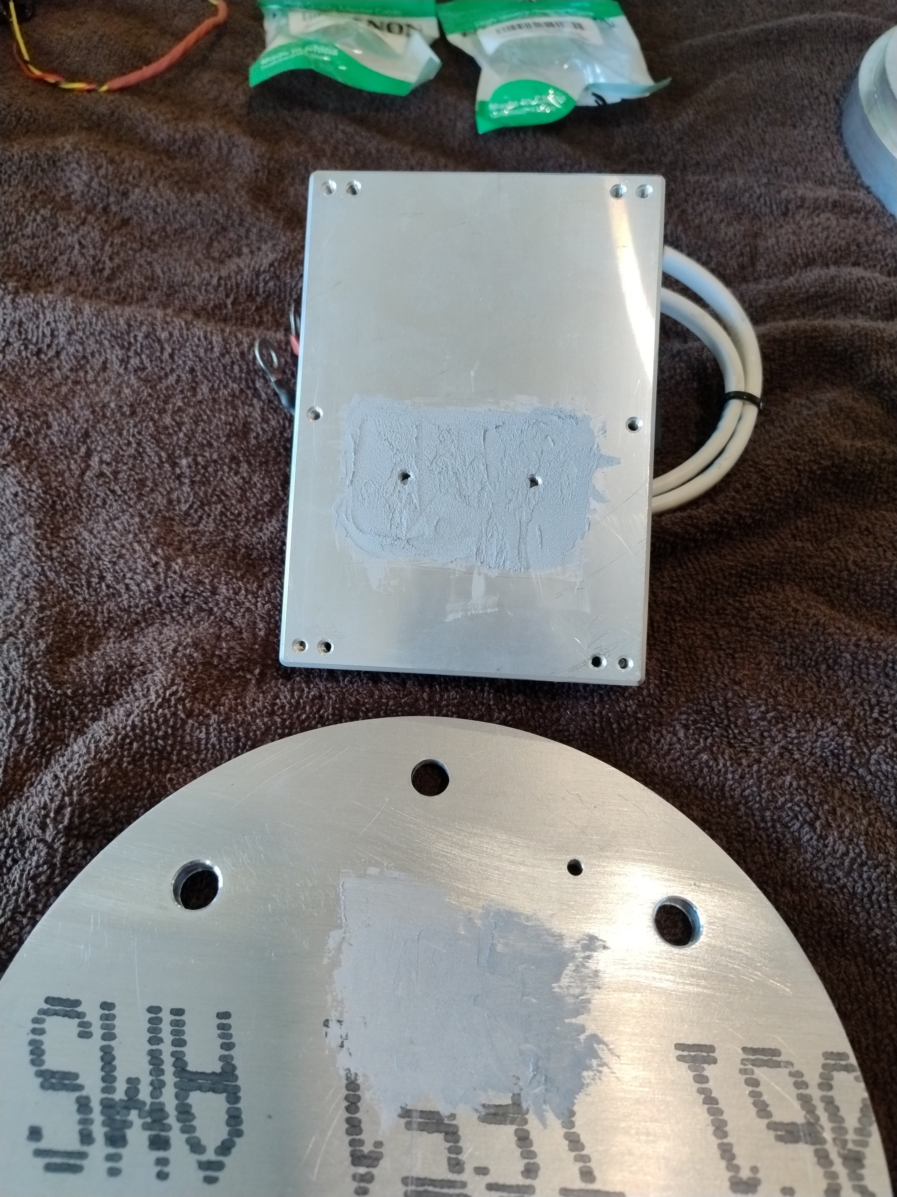

    I machined it for the A04 case to drop right in without it's top cover (since these cheap factory black cases trap the heat) and thermal paste applied to the base plate for maximum heat dissipation. I also drilled the same diameter hole thru the factory bottom case where it interfaces the billet bottom plate for convection around the 3251 chip/PCB... It barely gets warm after hours of cranking the large dia. knob.

    Cleaning up and extending wiring....

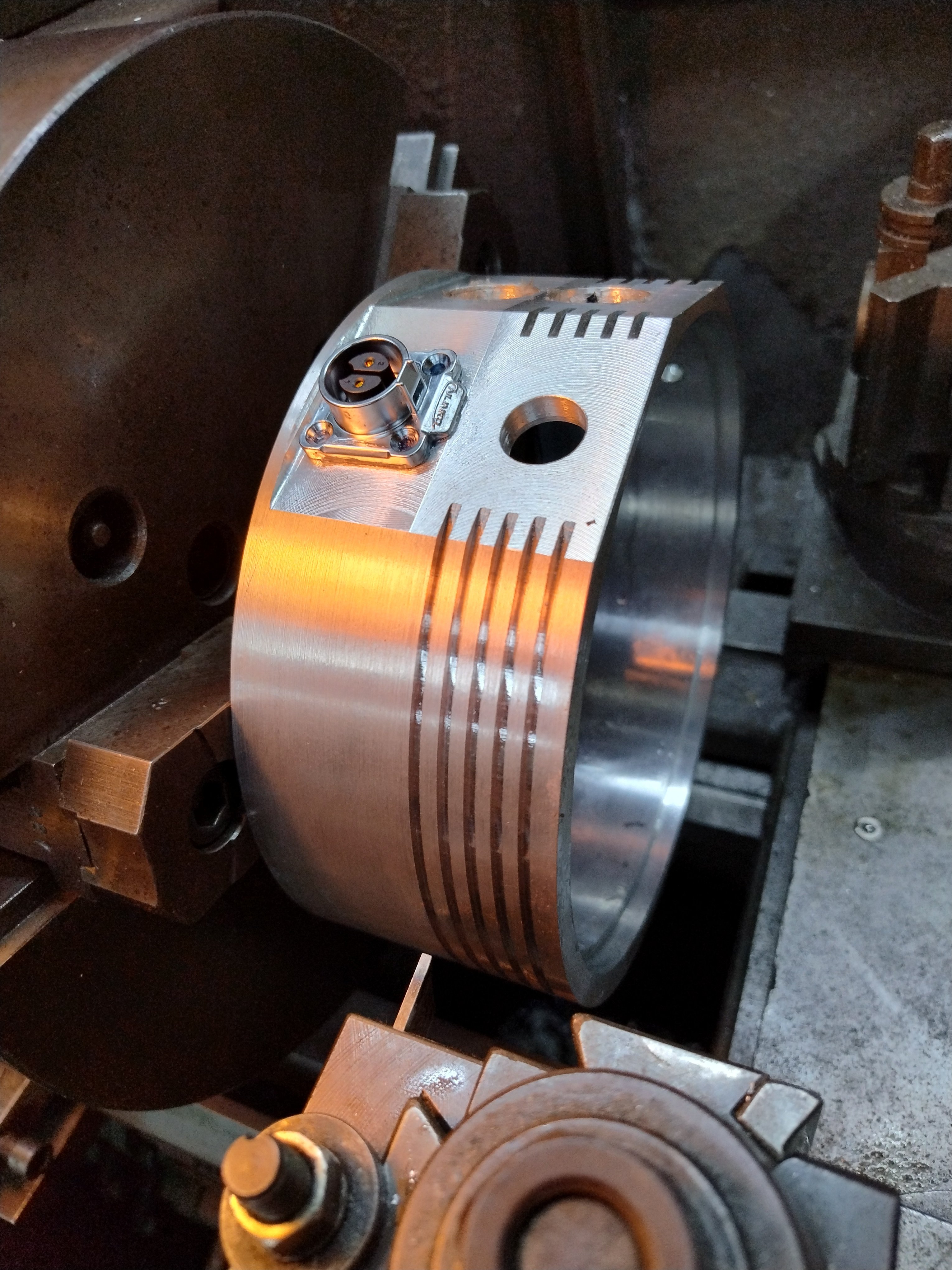

    Thanks Steven. It more than doubled the heat dissipation in that area.

    Updated the first 3E amp build for the owner.
    Took me only 10 minutes to disassemble and chuck up on the lathe. He likes his ribs elevated lol.
