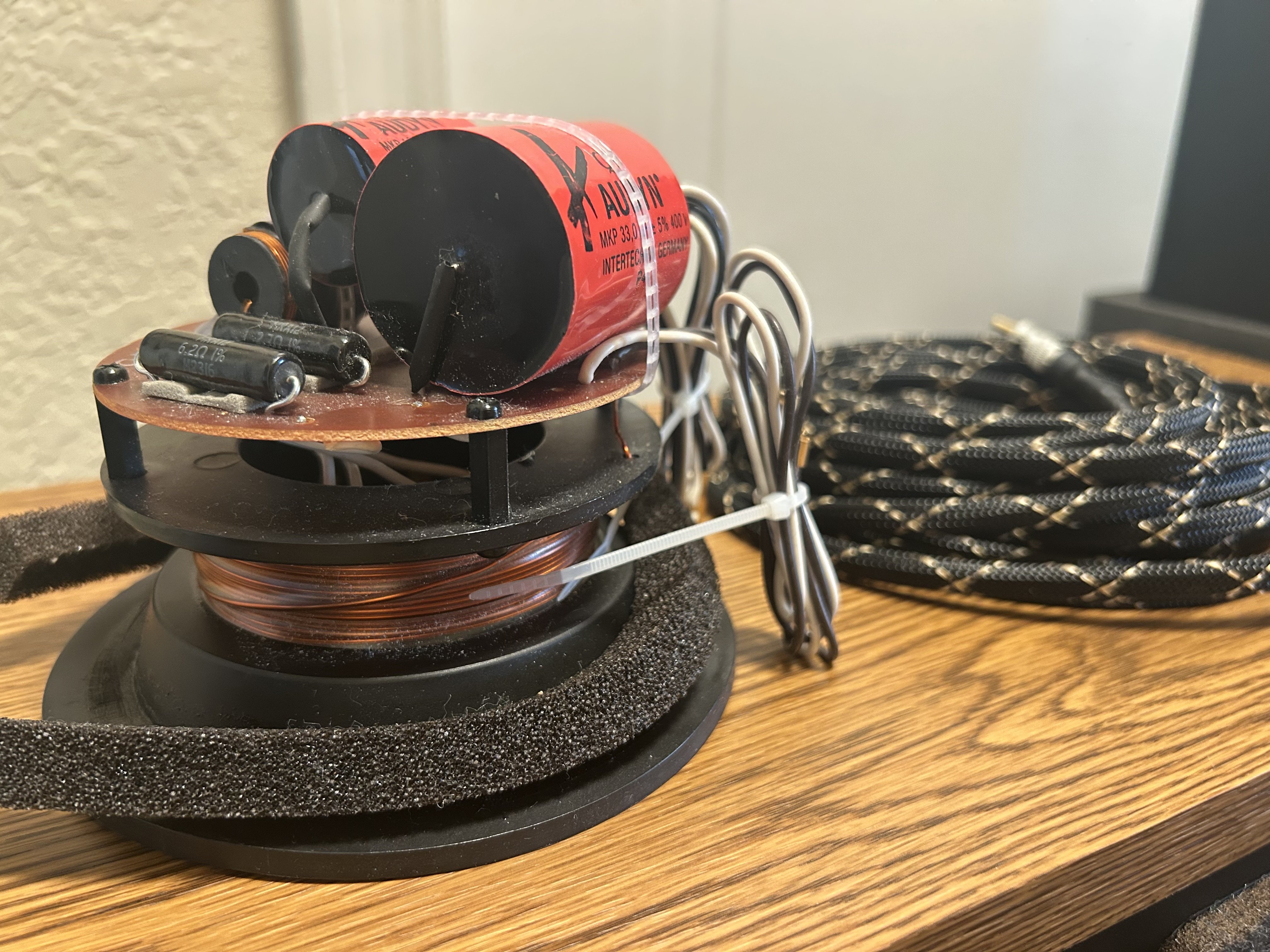

    This has long been on my list of diy upgrades, now retired I think this has my name all over it. Any chance you have the source / part# for the parts, I would like to do the same mods, I blew out the woofer years ago and replaced them and updated the tweeter to SL3000 ?? I believe ... cant find the paperwork any longer. But did have the schematic update for the newer tweeter. ru8wsvz4c8oj.jpg

    @mwk1001 When I zoomed in on your photo I didn't see any foam ring so it must be that you bought the RD0198-1 silk dome upgraded ones. Check and make sure you have RD0198 (5.39 Ohms) and not RD0194 (6.6 Ohms).
    You already did most of the homework by grabbing the schematic. I think if you read that link above he said that he only did the low pass inductors for the midwoofers and he used Jantzens. you could find them maybe at partsconnexion.com. He used Sonicaps from soniccraft.com which are highly favored around here, for all the caps and Vishay/Mills 12 W resistors.
    Oh, for the sub bass inductor he used Erse Super Q? For that you will have to look at Uscoils.us.

    Thanks for that. I was not sure after going thru the threads, my purchase doc was lost but the schematic was saved in 2016 so that is when I upgraded them. I found the mills resistors and went with Clarity CSA's for tweeter/midrange Clarity PX for the SDA 6.5 driver (2x20)
    Some fun reading the humble homemade HiFi capacitor page and balancing crazy money against my enjoyment of the CRS+ I had sonicap/mundorf supreme in my head but I'll try these CSA/PX's see how it goes.

    I guess you still need to check the DCR of the tweeters to see which ones you purchased. If they said SL3000 compatible or something like that, you probably have the RD0198-1. That shouldn't be a perfect match for your unmodded crossover without doing the tl mod, which you are planning to do.

    F1nut Posts: 52,406
    No need to bother measuring. The easy way to tell is the tabs on the RD0194-1 are the same size while one tab on the RD0198-1 is bigger than the other.

    Grr. Off it comes again. I think I'll do both since the photo I took I cannot make out the tabs well enough ! if 194 i'll probaly just get the 198's in for a penny .....zd90h7xipty0.jpg
    F1nut Posts: 52,406
    Same size tabs.
  • mwk1001
    mwk1001 Posts: 5
    edited December 2025
    Same size tabs and 7.5 Ohm across the unplugged driver ??
    Probably my meter jumping around alot but plugs are clearly the same size and all measures are 6.6 ( one ) the rest higher ...6vfmmu8dalbu.jpg
    F1nut Posts: 52,406
    Yep. I don't know what meter you are using and it doesn't matter. If the tabs are the same size it is the RD0194-1.

    I sent a note to polk parts and I see some about ... so 0198's it will be .

    Original standoff from Polk were a plastic/nylon that the crossover snapped over on either the binding cup or board above the binding cup. Most of us reused them or bought longer nylon or metal hex standoffs to use for the larger caps we may have soldered under the board due to size constraints on top.
    On the SRS-SDA yours is behind the aluminium XO plate you see on the front of the speaker.

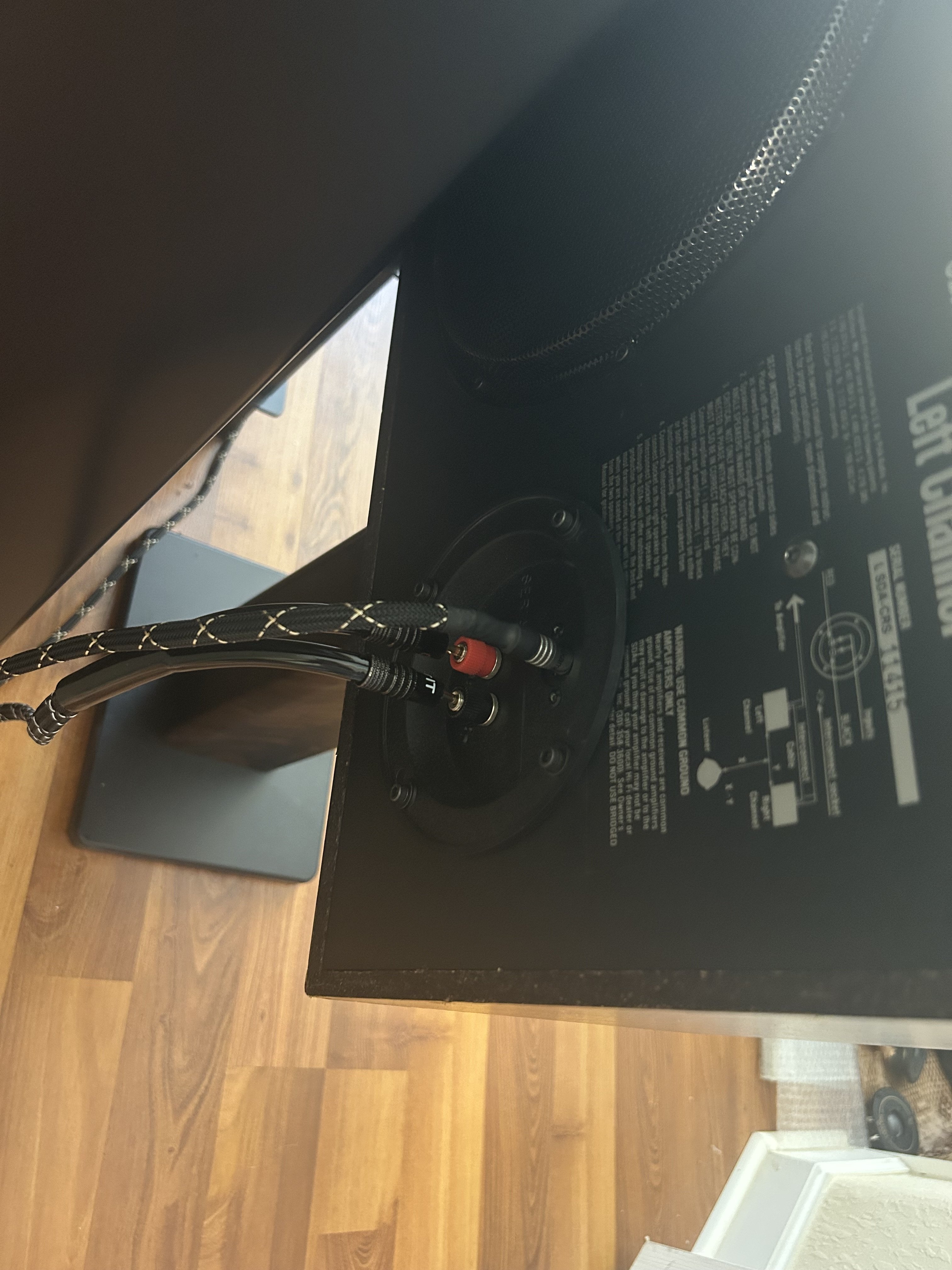

    Made new ends for my SDA cable. Fits much better now.
    "Equality is a myth to protect the weak. Some of us are strong in the Force, others are not. Only a fool believes otherwise." - Sith Proverb.
