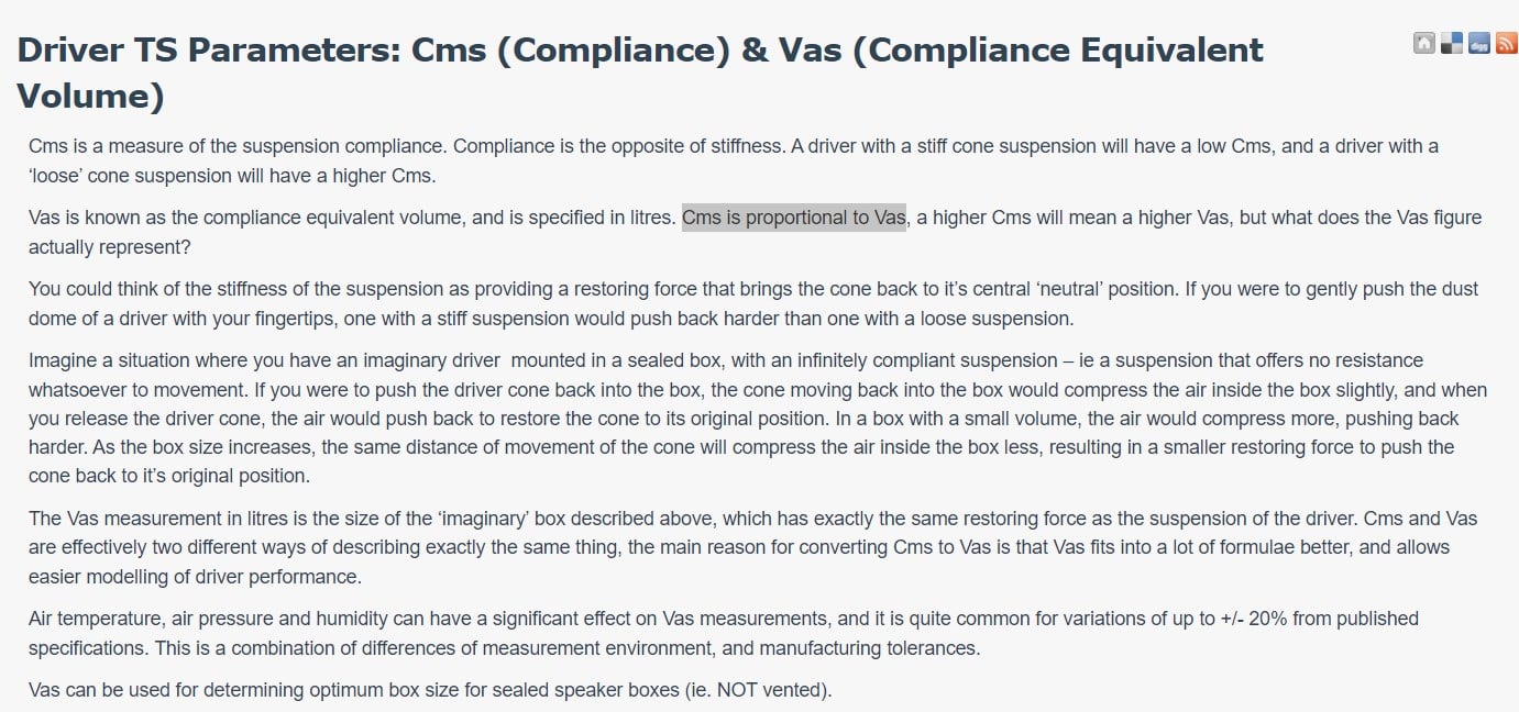

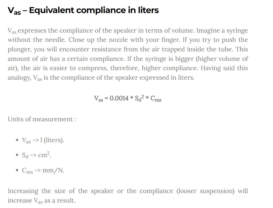

    I think it is notable that there is significantly higher Qms compared to our T/S parameters in the forum, which would tend to indicate a loss of damping in the doping perhaps. Something to look into regarding whether or not re-doping or applying a thin coating of "something" to regain the original stickiness might bring this to where it aligns more with the T/S parameters we have in the forum. Also, the Vas is less which would mean less compliance. I would've thought that counterintuitive since I would think that the suspension would get softer over time (may not be true esp. the surround rubber) but perhaps that again is related to the cone getting stiffer as the viscoelastic damping material dries out over the decades.

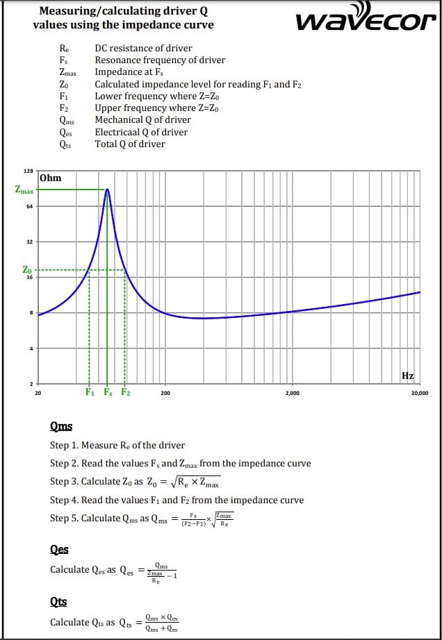

  • This is how the Q's are calculated from the open air impedance curve measurements:

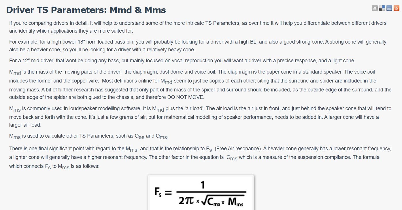

  • More background info. on T/S parameters:

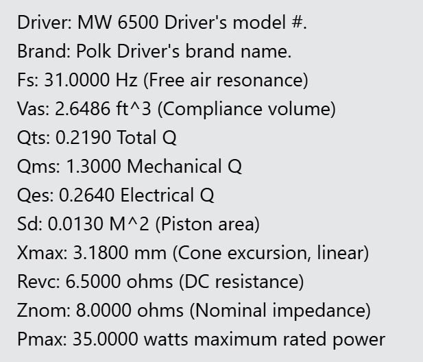

    Unfortunately this is all we have for the T/S Parameters of the MW6500 and notably missing is the Bl, which can be calculated from what we do know if we assume that the avg. Mms obtained by MrGeology applies to the new MW6500. Probably true since why would mass be lost or gained appreciably?
    Bl = √(2π × Fs × Mms × Re / Qes)
    (with Mms in kg, Fs in Hz, Re in ohms).
    That gives Bl (new) = 6.60 Tm.
    The others come out to (1983 from 7B, 1980 Silver Basket): 5.78 Tm and 5.73 Tm
    So you can see that a considerable amount of Bl was lost due to possibly degradation of magnet strength and less than optimal alignment and increase of Qes with aging (possibly related to loss of cone damping which increases Qms)

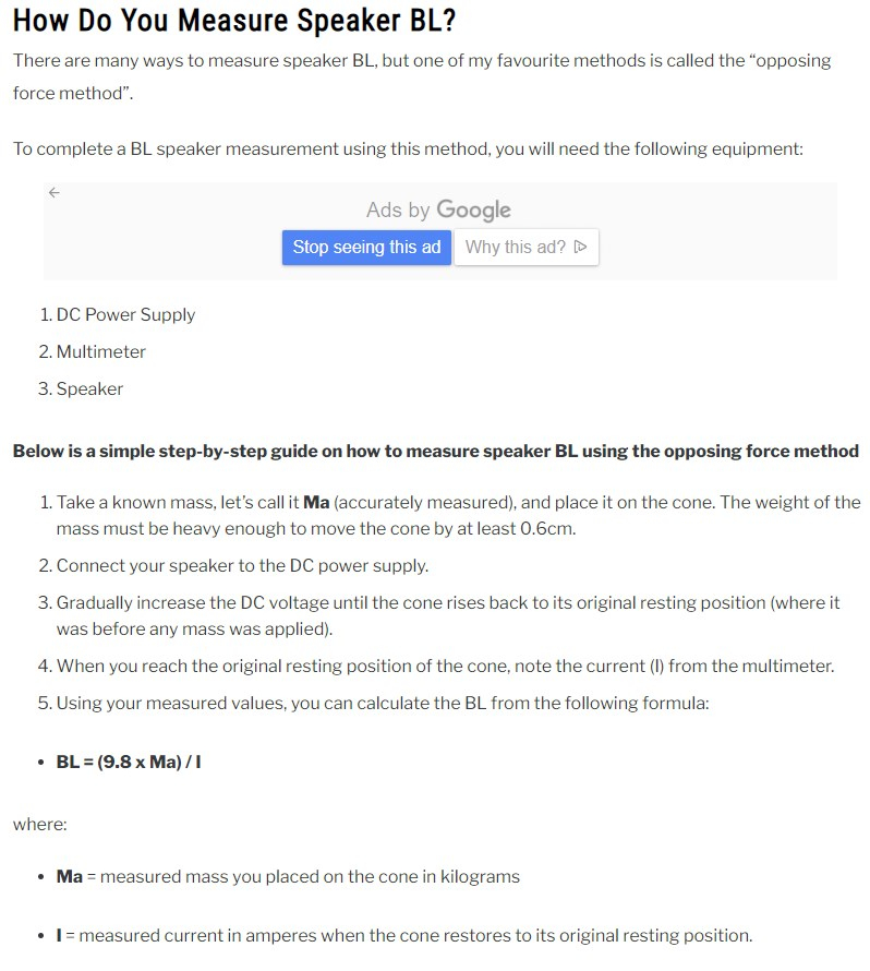

    And here is a way to measure Bl where all you would need would be a variable current DC power supply. Something to try for sure to see how much has been lost in these vintage drivers:
