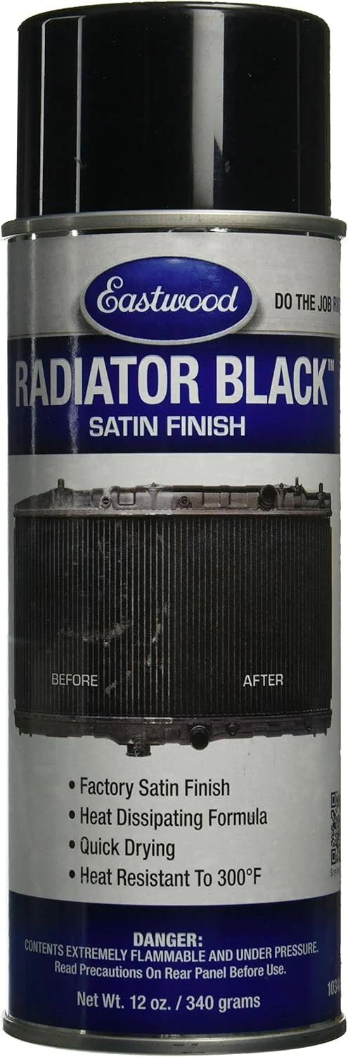

    "Or I could paint the ones I have with high temperature black paint - but where would I find some??"
    Eastwood has some good black paint used for radiators.
    The paint is heat conductive... wouldn't know if that's a good or bad thing for tubes?
    Used this on a Turbo Intercooler and it worked great.
