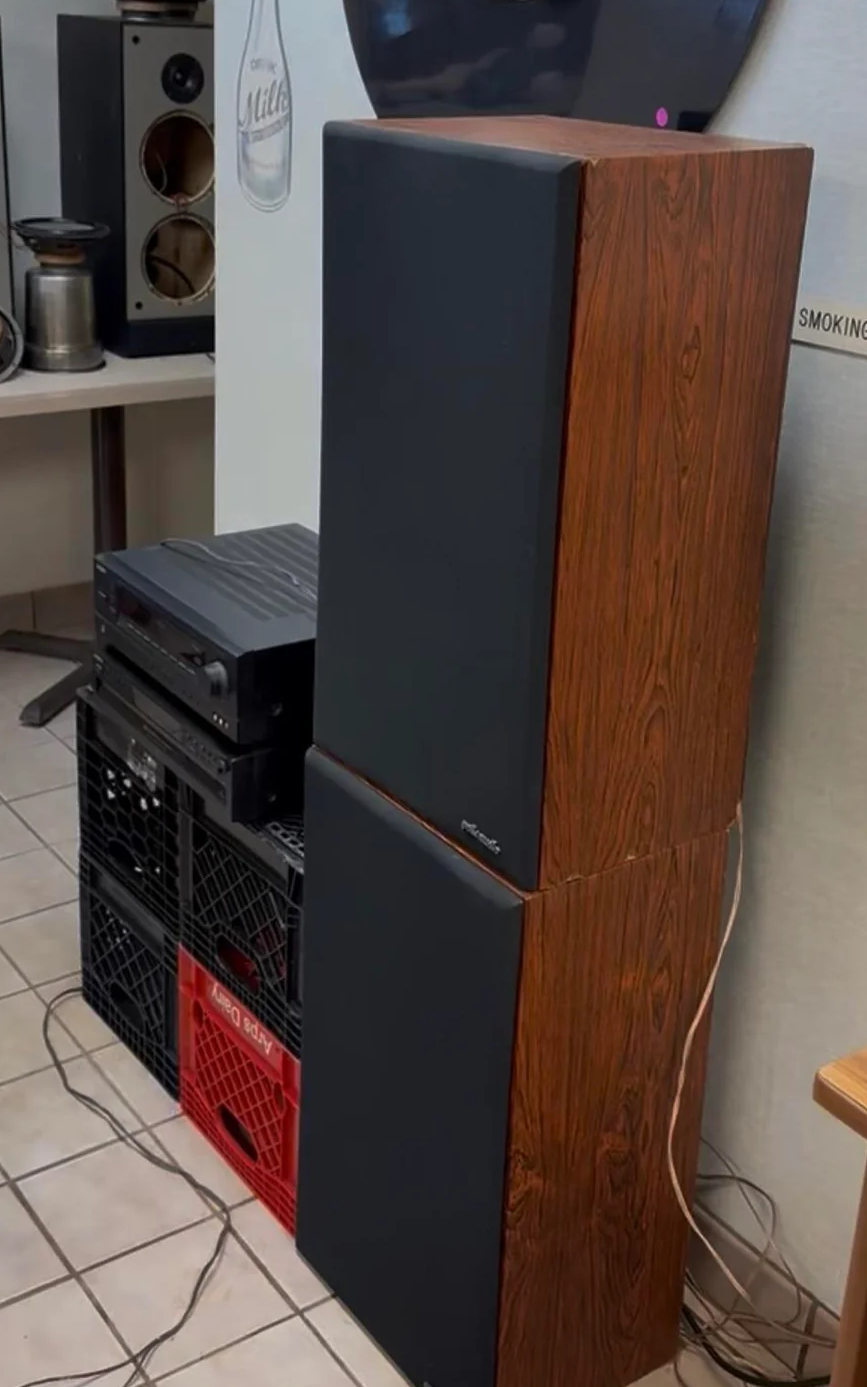

Father retired about three weeks ago and in clearing out his restaurant/pull barn has decided to sell his Polk Audio speakers he purchased when he was about 16-17 brand new (1976/78 ish??) he told me he was gong to sell them for 200 bucks. Worried if they are more special than just “decent old speakers”

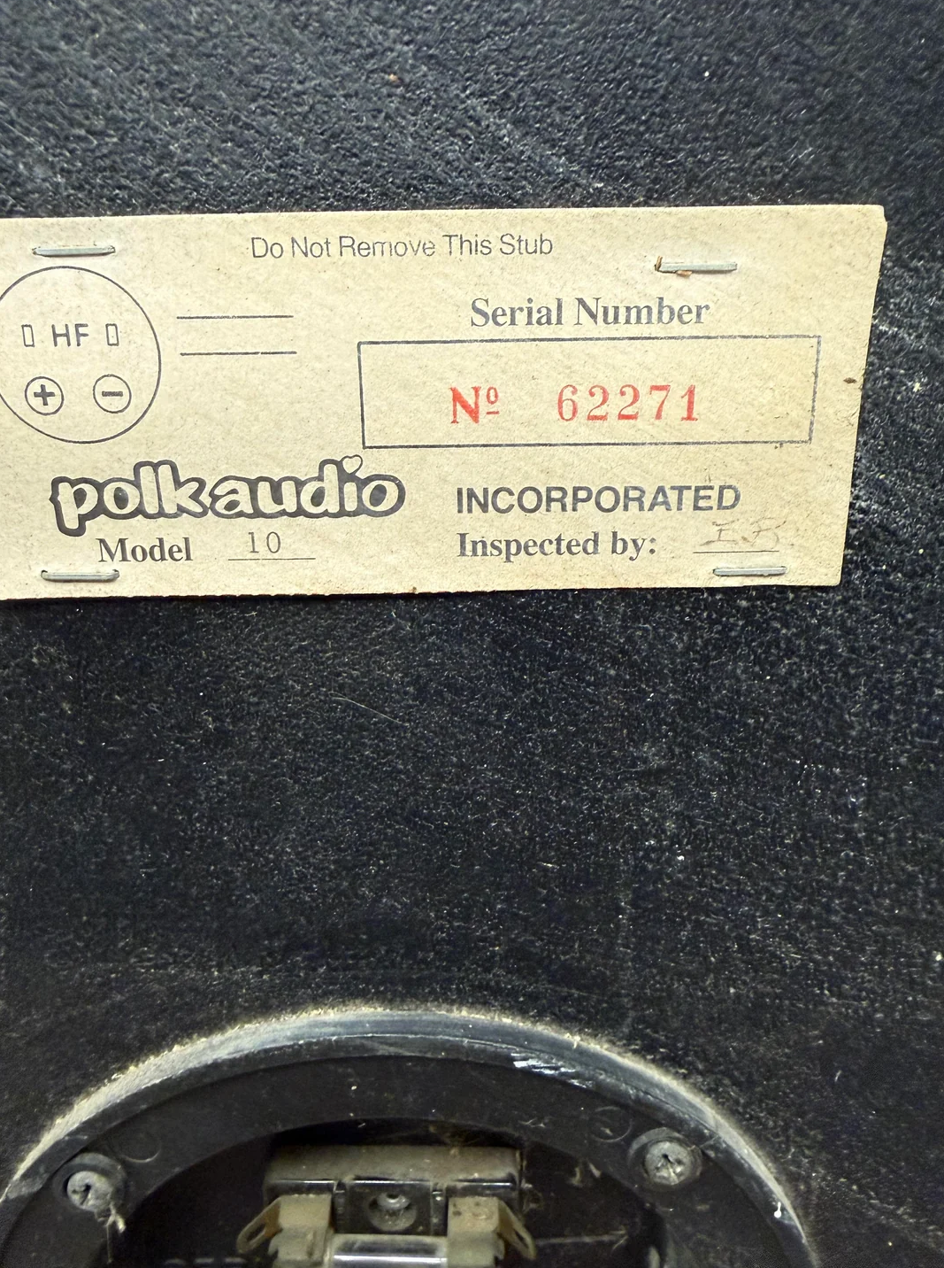

Can’t tell if they are 10a or b. I know they launched them in 1976 from what I can find. Googling the serial number doesn’t lead me anywhere. Mostly I just want to make sure he’s not giving away something far cheaper than it’s worth or if they are special enough that I should adopt them.
They still work great; but they have been truly used for 40 years. Anyhow, any help is very appreciated/opinions too.

    $200 is about average price for those. If you're interested in adopting them and fixing them up, they are worth it. It would be a fun and rewarding project especially being your dads old speakers. He might even get a kick out of it too.

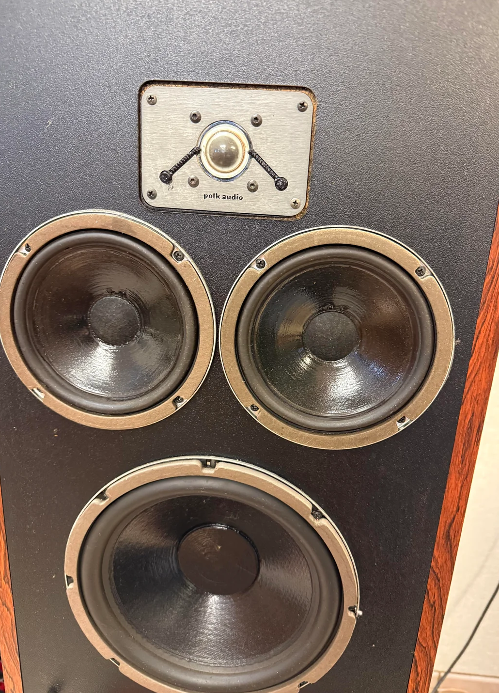

    They are probably 1978-1979 with the tag/stub. The tweeter was definitely replaced.
    Are both tweeters the same?
    If you open them the woofers and the crossovers should both have exact dates written on them.

  • Shouldn't this early model 10 have peerless tweeters?
  • Gardenstater
    Gardenstater Posts: 4,782
    edited December 2025
    @DeRod You're right. Those silver basket midwoofers and passives would not have shipped originally with SL1000. And an LOL from f1 is basically a badge of honor around here 😉

    Something some seem to ignore. Polk changed just about everything on the fly back then, so it's entirely possible those tweeters are the original ones.

  • They may have done some changes on the fly but they never had any SL1000 to ship out prior to 1984 when they had to stop using the Peerless.
    Have you ever seen any 1984 speakers that shipped out with silver basket midwoofers and passives?

    That tweeter was probably a Polk factory replacement for a bad peerless, that’s why I ask if they were both the same.

    Also, take a look at your tweeter route out and look at the gap around the SL1000 tweeter bezel. The SL1000 had a slightly smaller plate than the Peerless. DarqueKnight gave the measurements in his Tale of Five Tweeters epic thread. You can see that yours has a gap around the front plate. Should be about .045 to .050 in. margin around which looks about what you have.
    Here's what the route out clearance typically looked like from Polk with the Peerless:

    SL1000: 4.485" x 3.039"
    Peerless datasheet: 114.5 +0.3 mm x 80 + 0.3 mm
    Peerless (one of mine date code 3577): 4.576" x 3.135"

    50 thousandths each side is easily discernible by eye, so this makes sense.

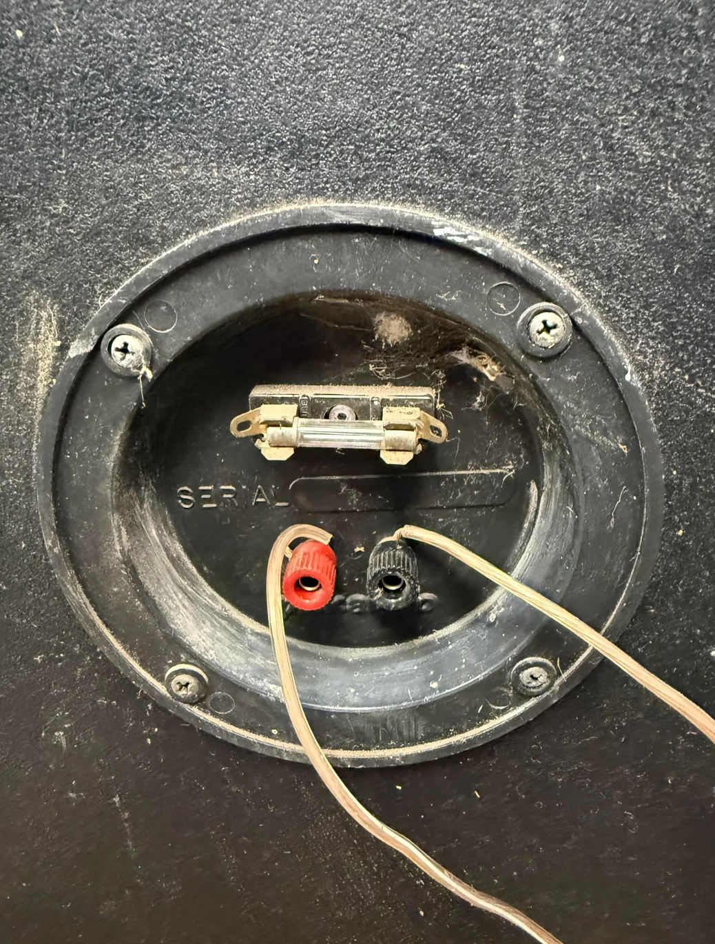

    Yeah. Yet another thing is that at some point they went to a silver color plated (tin probably) fuse holder and the picture from the OP is the unplated brass one. My 79 7Bs had the brass. I have a 1-28-83 M7 crossover where it is the silver.

    OK that is a sloppy fitted Peerless indicating they didn't always get it to fit right, especially in the early years and that white Mortite accentuates it. Can you imagine how sloppy that would've been with an SL1000 like in the picture OP posted? We're still waiting for you to address the 4 other issues (except by LOL'ing) besides the rout out gap, that are not in agreement with this being an early 1984 10B, which it would have to be to have shipped with an SL1000: 1) silver basket midwoofers and passives (like in that Peerless M10 you just posted a picture of), 2) The stapled on paper tag type label and high serial #, 3) Brass un-plated fuse holder not being in use at the time of the early 10B, 4) The grille OP shows is the early full frontal type with the Polk Audio badge being on the grille instead of the partial grille with the exposed Polk Audio badge on the bottom of the enclosure that I showed they were using in the early 10B.

  • Hey guys I am so sorry on the delay. I confirmed with my father that he damaged the dome of the original tweet and had it replaced, hence why it may look like the wrong dated tweeter. I am going to have him take a picture of the other tweeter and maybe look in the back for a printed year. Again sorry, this doesn't send notifications to my email when you all post so I didn't think anyone was responding after the original response.

    If you do decide to keep them you should change the silver (SL1000) non-original to that speaker tweeter to the black peerless like the other speaker. you can find them eBay for around $45
    And for all the doubters - I was right, that SL1000 was a replacement, and I didn’t need a time machine 😂😂
