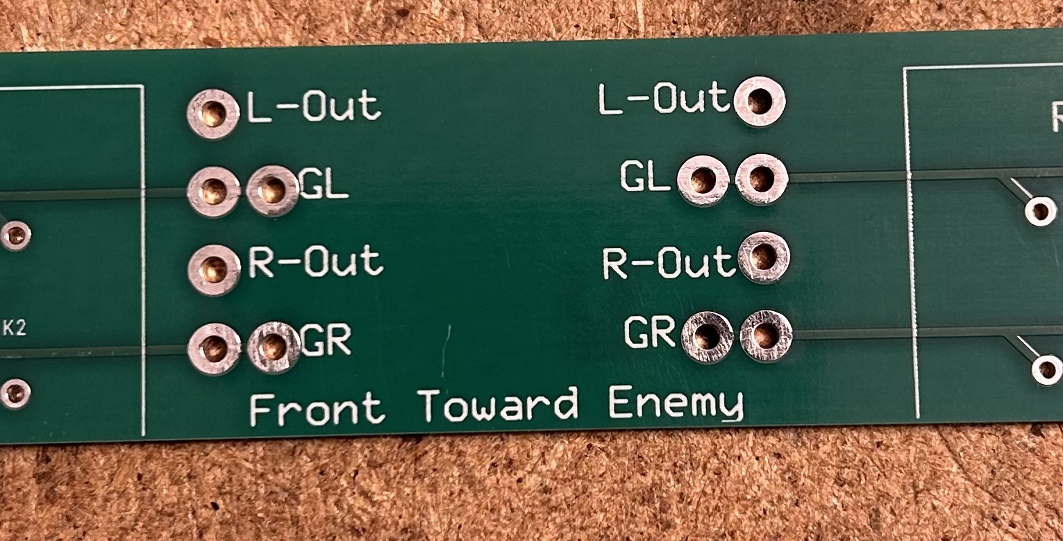

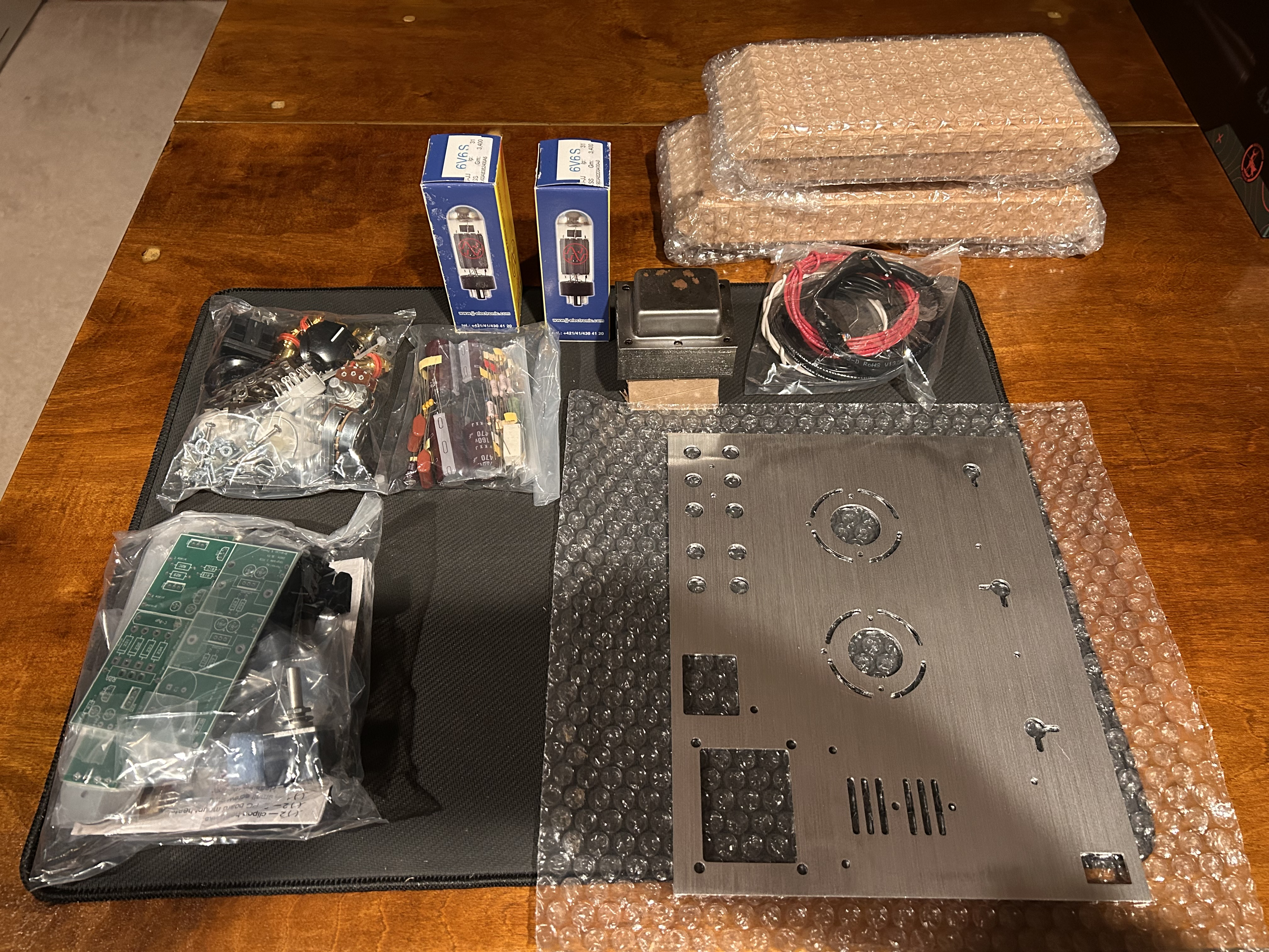

    This one’s the Moreplay.
    Should I be concerned? This upgrade board is called out as the “claymore”

    Just avoid squeezing the M57 clacker, if included with kit.
    I'm anxious to see an upgraded base.

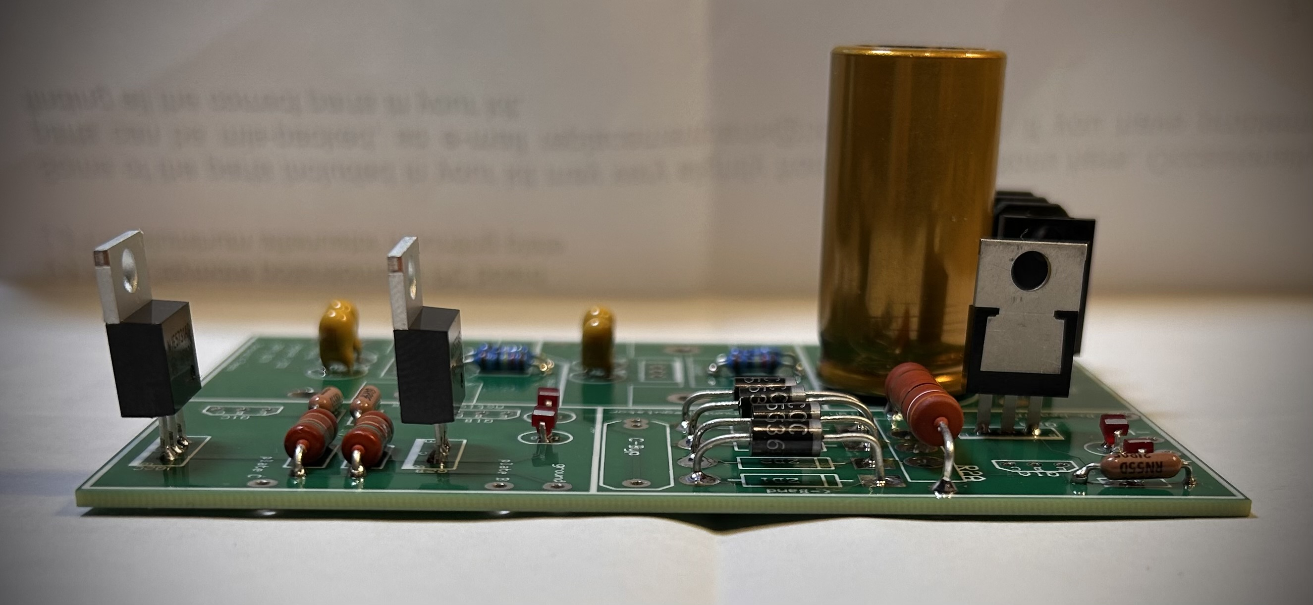

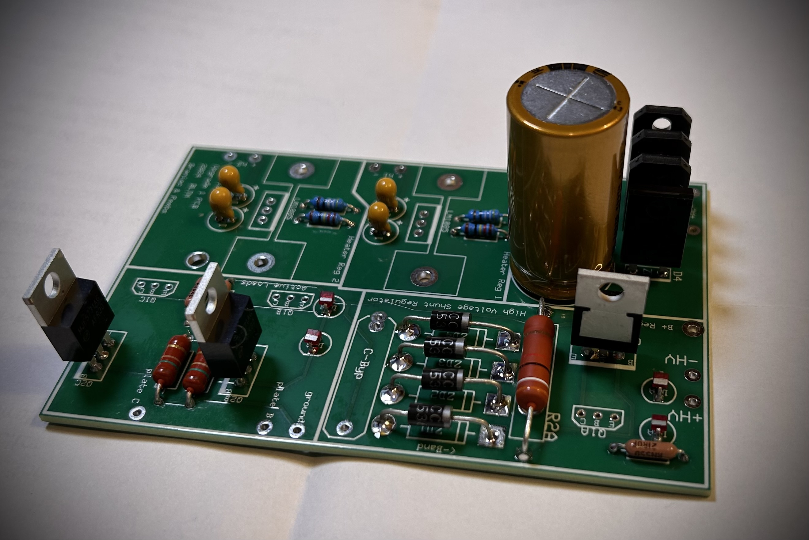

    While pondering the plate color and base wood thought I’d start with the upgrade PCB.

    Is this the Bottlehead preamp with a 6v6 power tube?
  • ALL212
    ALL212 Posts: 1,663
    Yepper.

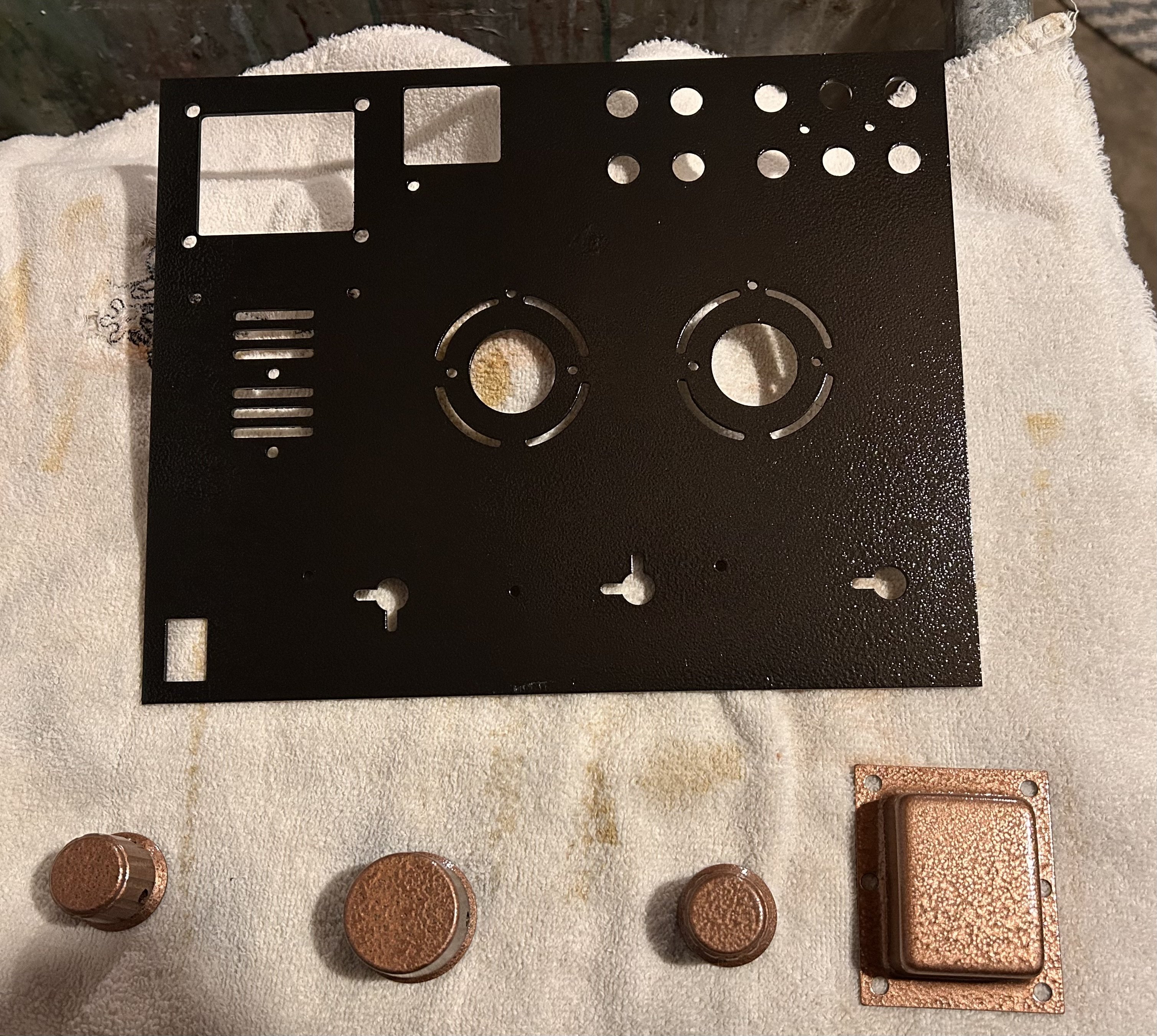

    Paint job done.

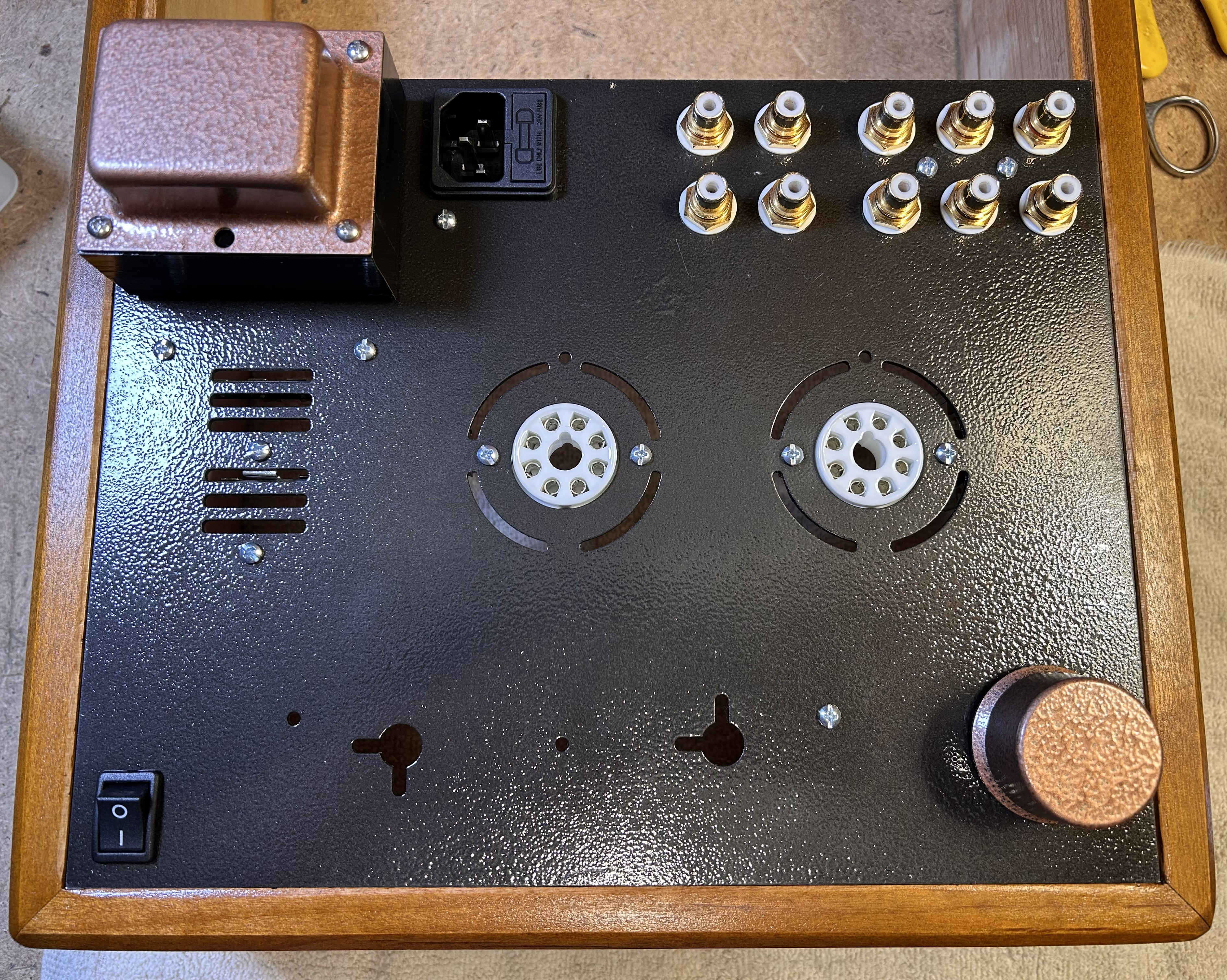

  • ALL212
    ALL212 Posts: 1,663

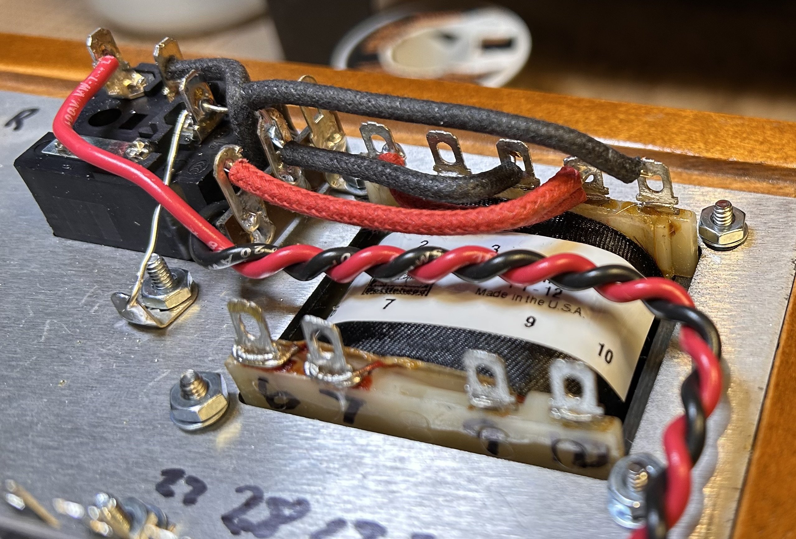

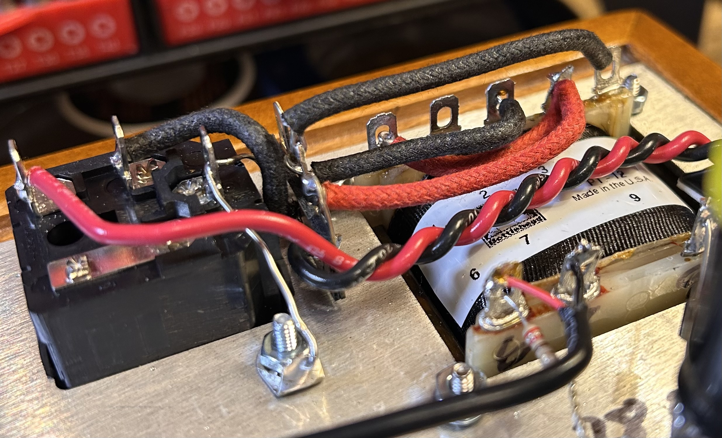

    Enough for today.

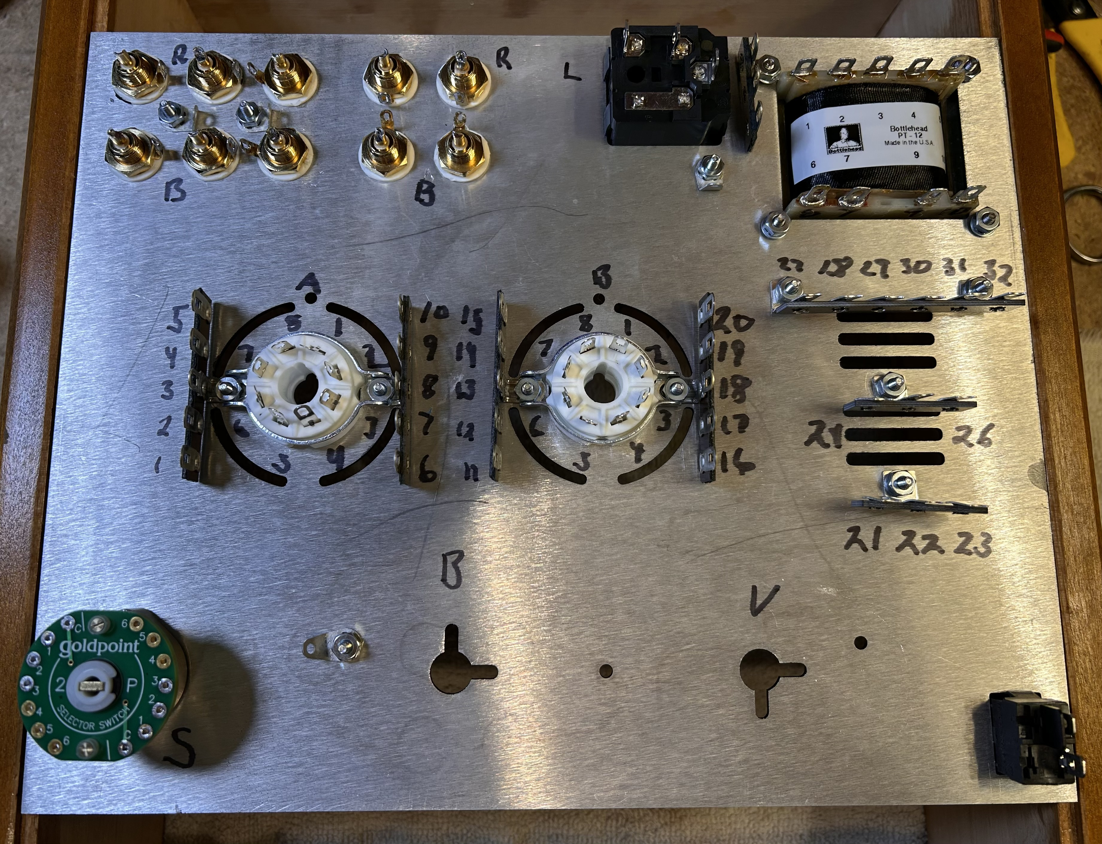

    Not stock:
    Power switch is a Cherry, not a big deal but the one that comes in the kit tends to melt if you leave heat on it too long.
    Input terminals and the Goldpoint selector were pulled from a scrapped passive pre experiment that worked but provided no sonic improvements (and way less gain) then any other.
    I’m going to try and stream in the upgrade kit rather than build stock and then rip/replace.
    So far no additional cost but there are some upgrade caps on the way.

    Next time you buy paint, check the expiration dates first. :D
    Looks good! I was going to do my Otari faceplate and rack mounts with Rust-Oleum Textured Black. The face plate cleaned up nice, so I was just gonna do just the rack mounts. I shook the can really good, it started spraying then the feed tube clogged. I just used the Behr old rubbed bronze paint I had used for the head cover and returned the black for a refund.

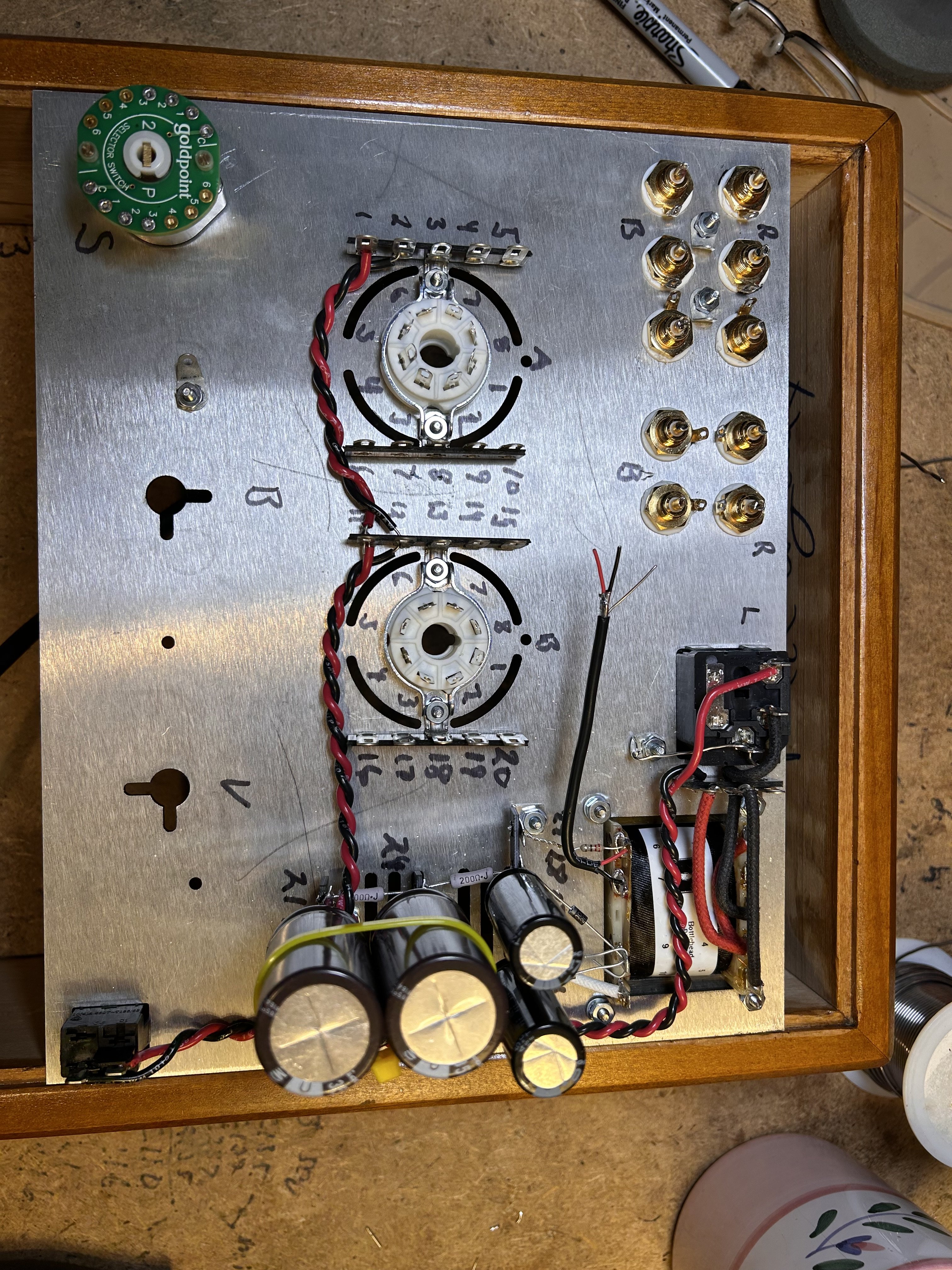

    Power supply basics done. 330v DC where it should be. It’s just a bit high but I have no load at all on the transformer.

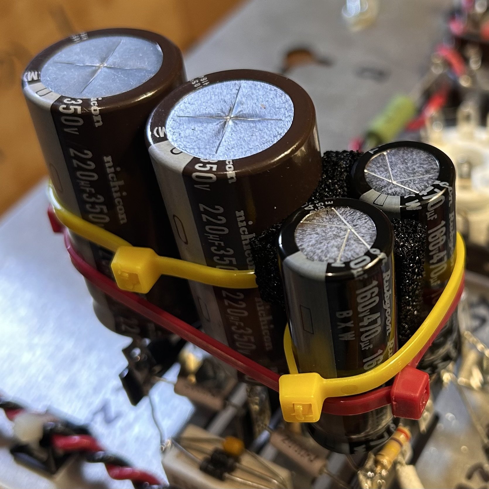

    A bit more but have to stop as I’m awaiting some caps.
    So far voltage checks are good and I’ve yet to pick up the hot stick by the wrong end.

    Got some 2.2uf 250v film caps coming down from Madison- should be here tomorrow latest.
    Thanks fer the offer but I’ll wait it out. Best I do this slowly anyway

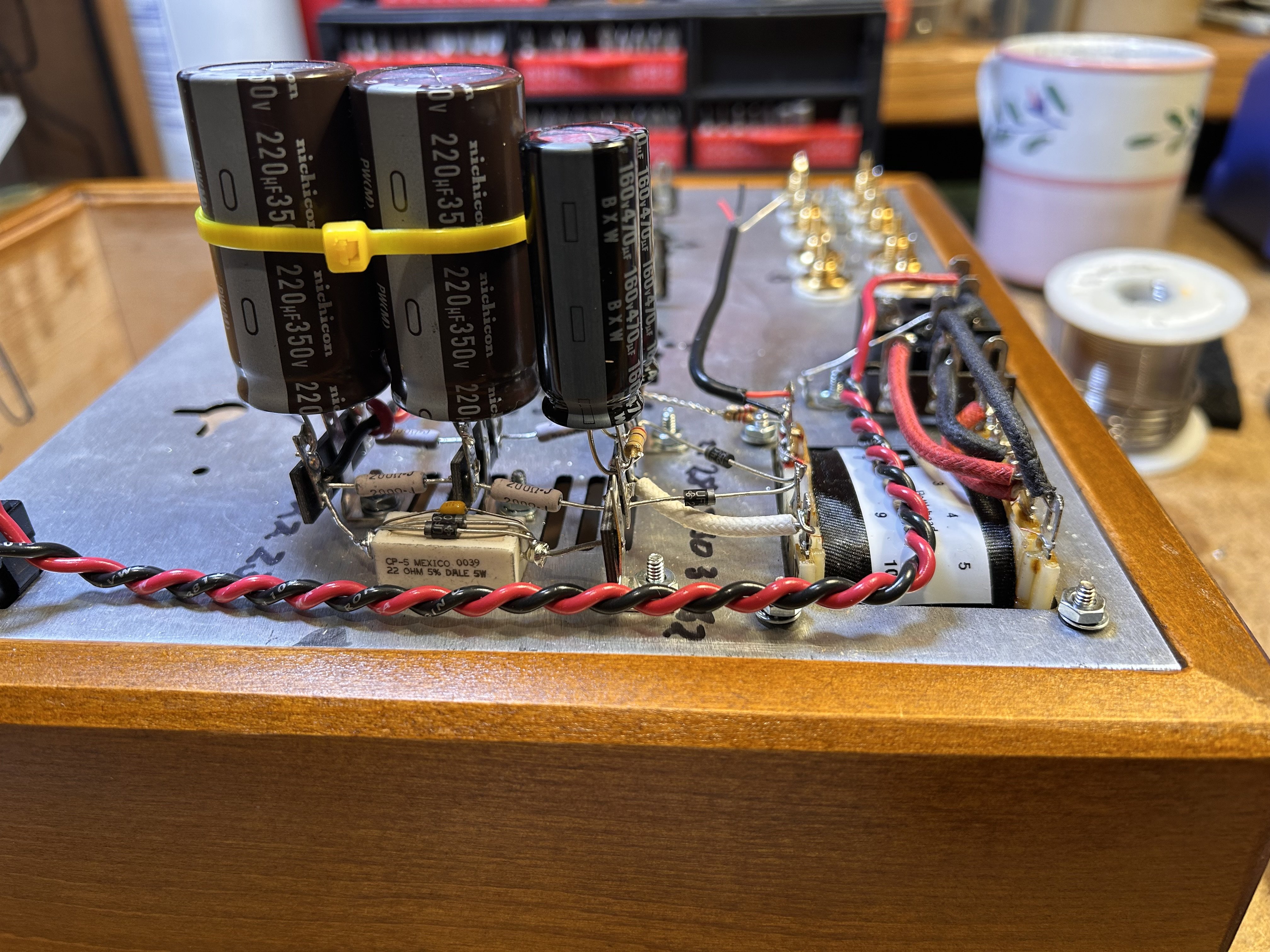

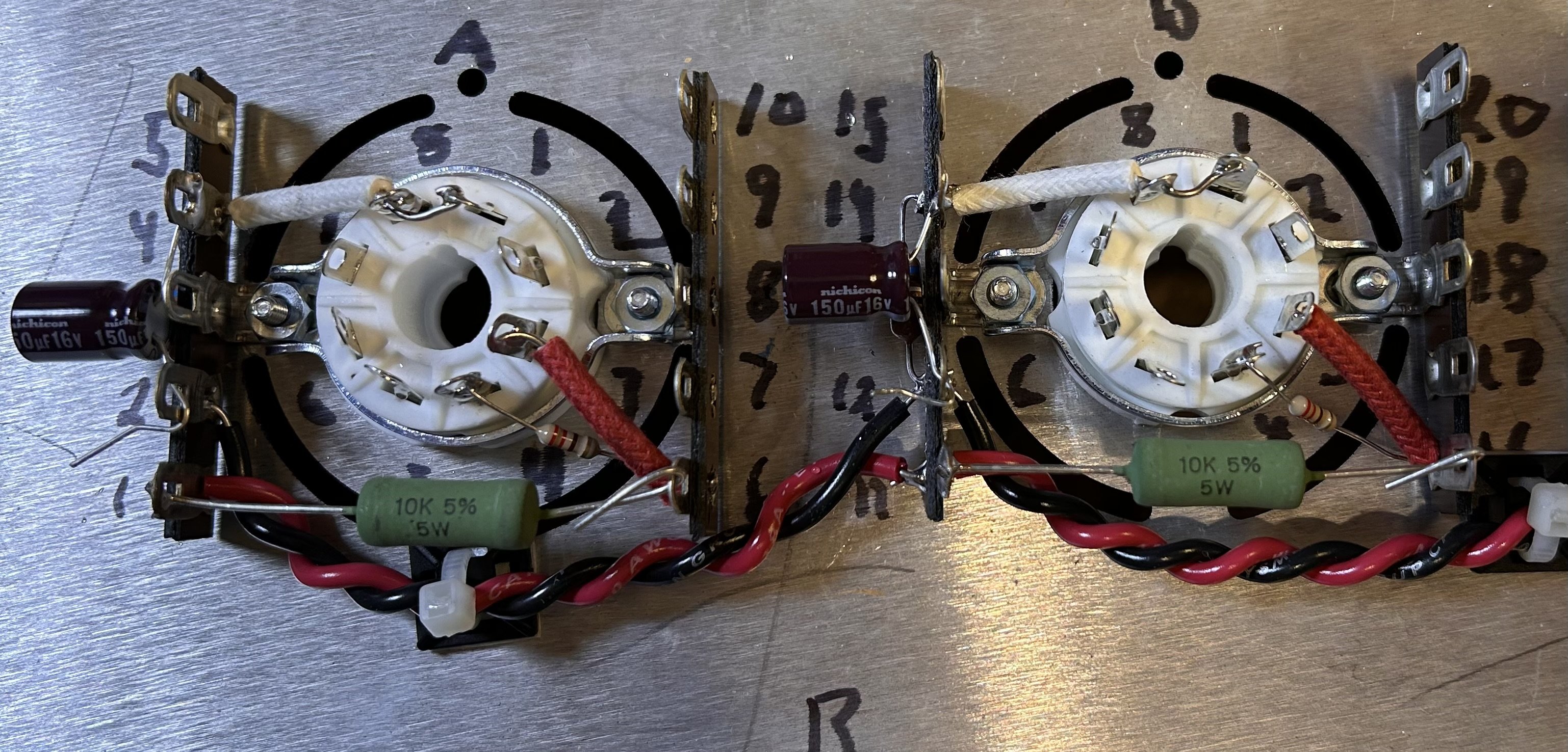

  • ALL212
    ALL212 Posts: 1,663
    Getting close…
    Some checking to do yet and B+ wiring changes to accommodate the upgrade board.
    Lose mogami wire there just to size up the paths needed. One output will be non amped for a straight to headphone amp connection.

    Huh.... how about that - it works! On the first try yet.

    Hey, nice work. Did you have to look at two sets of instructions to apply the update in the initial build?
    pitdogg2 Posts: 27,230
    AI was surely involved....
  • ALL212
    ALL212 Posts: 1,663
    SCompRacer wrote: »
    Ya… Bottlehead doesn’t like you streaming in upgrades. Should it not work it will become very difficult for them to assist and I’ve seen them request the builder go back to stock.
    I print (in color) both manuals and figure out what I can leave out in the basic build and where I need to go in the upgrade manual. I still got ahead in the basic build but in order to do volt checks sometimes you have to do basic and then back it out.
    I picked up a 27” monitor in an auction. That helped a lot as I have it right at my work desk. I can blow up directions so the neighbors can read them!
    One output is setup to go from selector straight out so I can run a headphone amp out of it.

  • skipshot12
    skipshot12 Posts: 2,091
    edited December 2025
    Have never owned any tube equipment but me think's those heat sink fins are a good idea.
    Does help in extending tube life via cooling?
    Have also read about some folks damping the tubes for vibrations.
    Do those fin things help with that too?
    Looks cool.
    Skip
  • ALL212
    ALL212 Posts: 1,663
    In theory - yes to both.
