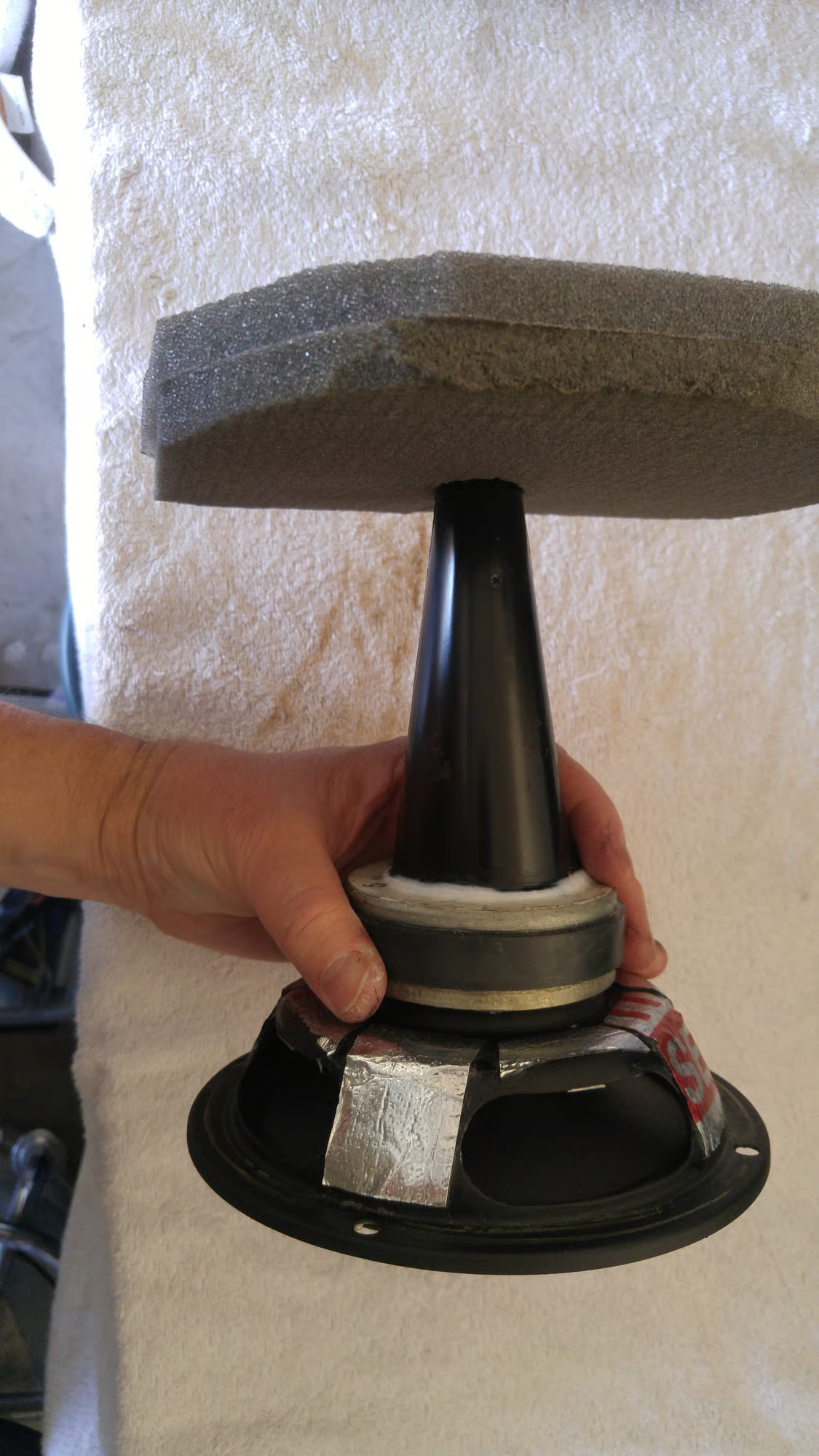

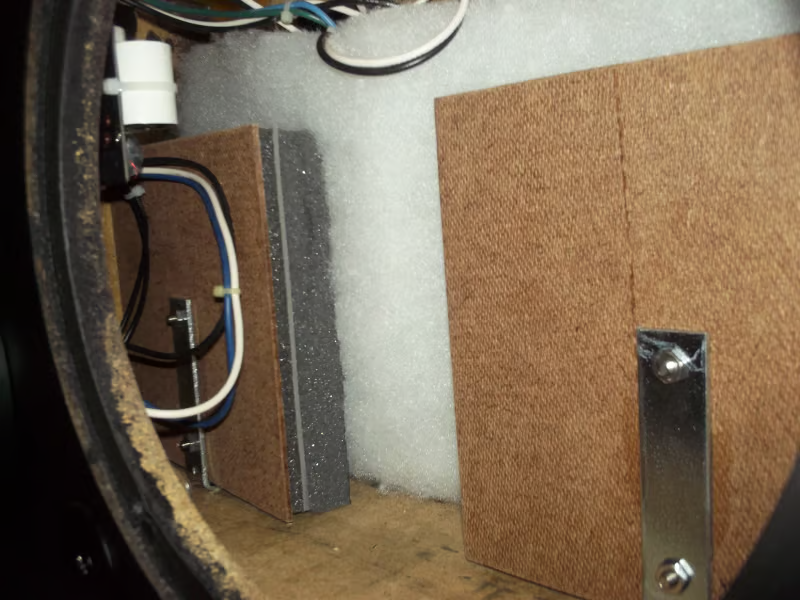

  • Check out these two threads which show how WMG and xschop approached the issue of backwave control in these. Also check out how WMG did his boards, not that yours aren't fine 😉
    https://forum.polkaudio.com/discussion/169838/sda-crs-crs-something-different/p1
    https://forum.polkaudio.com/discussion/177189/take-a-guess/p1

  • WMGs crossover above was the tl mod. You could use that as a template if you ever decided to go that route.

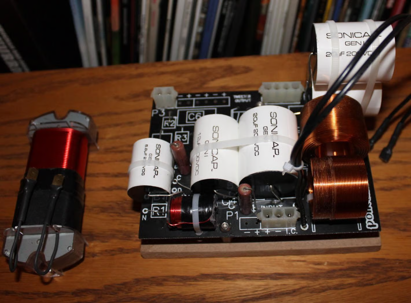

    This has long been on my list of diy upgrades, now retired I think this has my name all over it. Any chance you have the source / part# for the parts, I would like to do the same mods, I blew out the woofer years ago and replaced them and updated the tweeter to SL3000 ?? I believe ... cant find the paperwork any longer. But did have the schematic update for the newer tweeter. ru8wsvz4c8oj.jpg

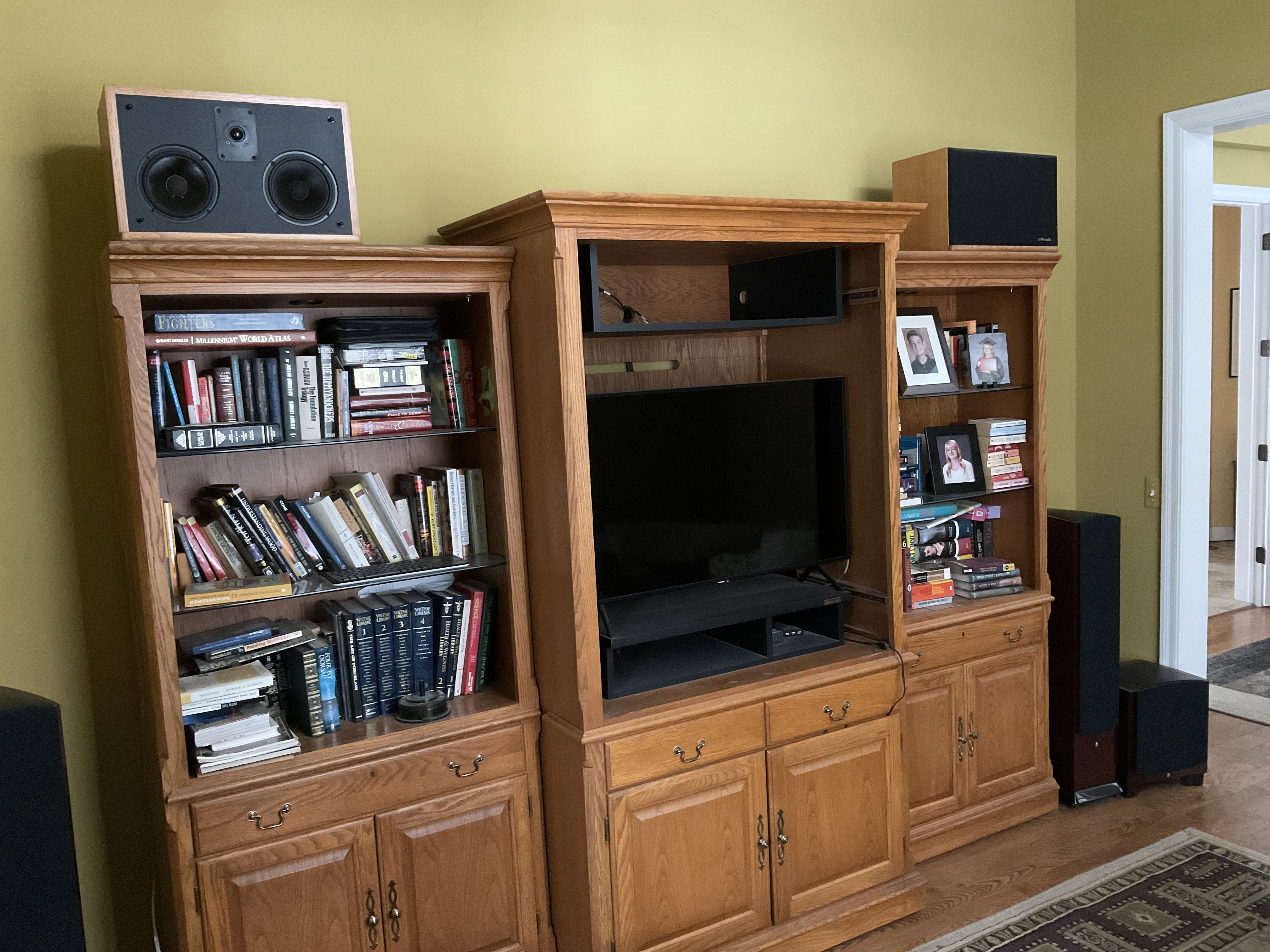

    VR3 Posts: 29,541
    How tall are you?? 👀👀😁😁

    @mwk1001 When I zoomed in on your photo I didn't see any foam ring so it must be that you bought the RD0198-1 silk dome upgraded ones. Check and make sure you have RD0198 (5.39 Ohms) and not RD0194 (6.6 Ohms).
    You already did most of the homework by grabbing the schematic. I think if you read that link above he said that he only did the low pass inductors for the midwoofers and he used Jantzens. you could find them maybe at partsconnexion.com. He used Sonicaps from soniccraft.com which are highly favored around here, for all the caps and Vishay/Mills 12 W resistors.
    Oh, for the sub bass inductor he used Erse Super Q? For that you will have to look at Uscoils.us.

    " When I zoomed in on your photo I didn't see any foam ring so it must be that you bought the RD0198-1 silk dome upgraded ones. Check and make sure you have RD0198 (5.39 Ohms) and not RD0194 (6.6 Ohms)."
    Thanks for that. I was not sure after going thru the threads, my purchase doc was lost but the schematic was saved in 2016 so that is when I upgraded them. I found the mills resistors and went with Clarity CSA's for tweeter/midrange Clarity PX for the SDA 6.5 driver (2x20)
    Some fun reading the humble homemade HiFi capacitor page and balancing crazy money against my enjoyment of the CRS+ I had sonicap/mundorf supreme in my head but I'll try these CSA/PX's see how it goes.
    @vr3 How tall are you?? Yeah I know, The "dream" was to have that wall like a real library with rolling ladder and all ... Then they would have had a custom space carved out with room in the rear a tad lower :) . But that has not happened yet ... you know we have only been here 20 years ... I have a nice woodshop but everyone else's stuff seems to come first !! I even have a tiny 3 axis milling machine that I made the baffles for my office speakers from a planet10 box design and CSS fr-127 full range drivers hooked up to an Ncore 2 channel DIY..
    Found the box of old drivers and a slip of paper saying they were the RD0194-1 I'll double check but odds are this slip is correct I have 0194-1. So no 5.8 cap ?

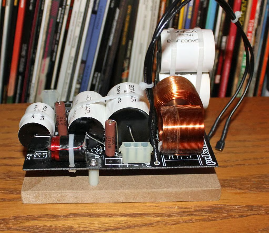

    "Replace the broken plastic standoffs with metal hex standoffs."

    skipshot12 wrote: »
    Hey Jesse,
    What's this and where?
    Does that also include my SDA SRS's?
    They are the white plastic pieces supporting the board.

    skipshot12 wrote: »
    Hey Jesse,
    Original standoff from Polk were a plastic/nylon that the crossover snapped over on either the binding cup or board above the binding cup. Most of us reused them or bought longer nylon or metal hex standoffs to use for the larger caps we may have soldered under the board due to size constraints on top.
    On the SRS-SDA yours is behind the aluminium XO plate you see on the front of the speaker.
    xschop Posts: 5,385
    Bump for the current CRS builders. I tried finding an old pic/post where I found 3.5" long styrofoam cones from the hobby store that worked perfect for the stand-off foam mod.
