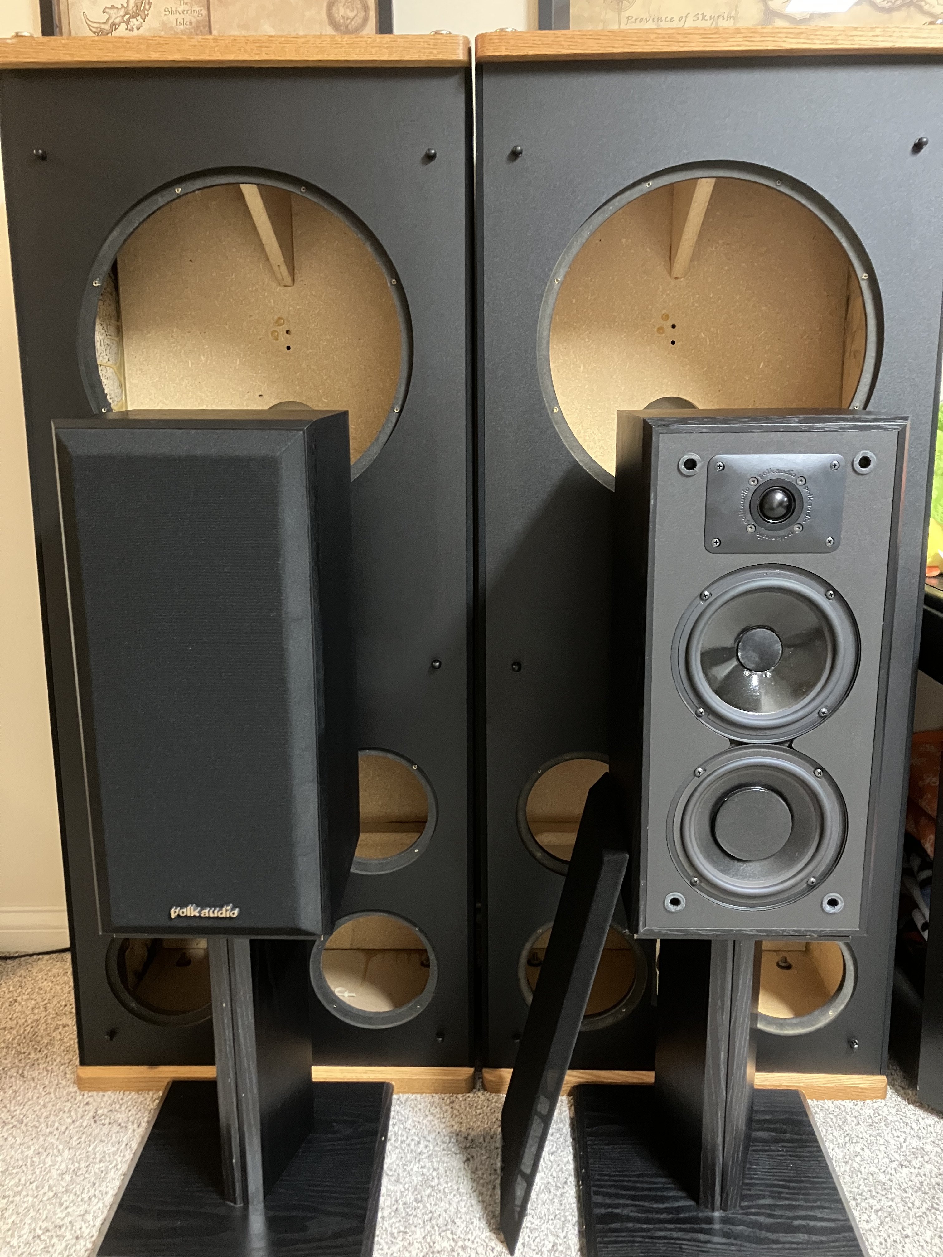

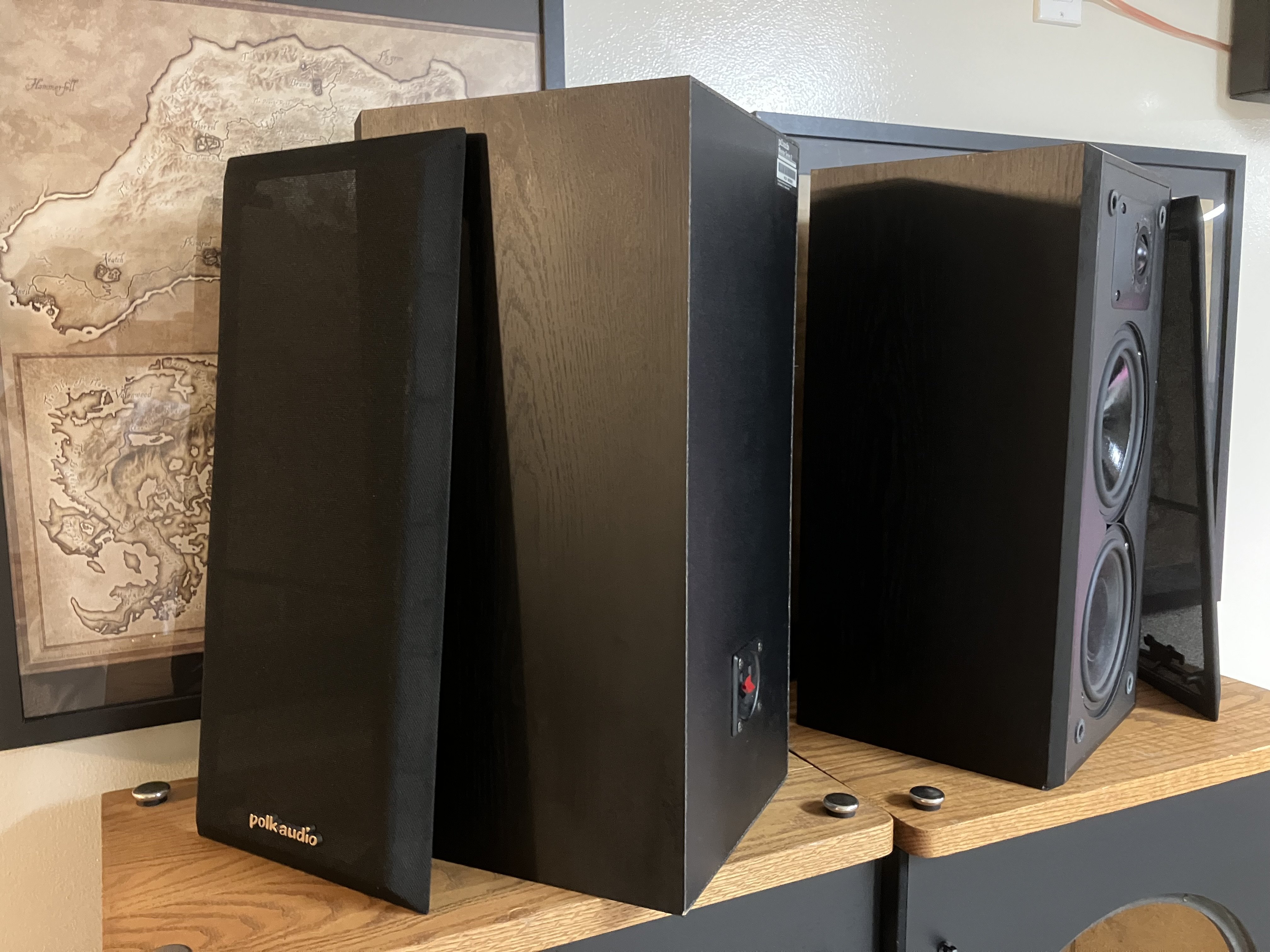

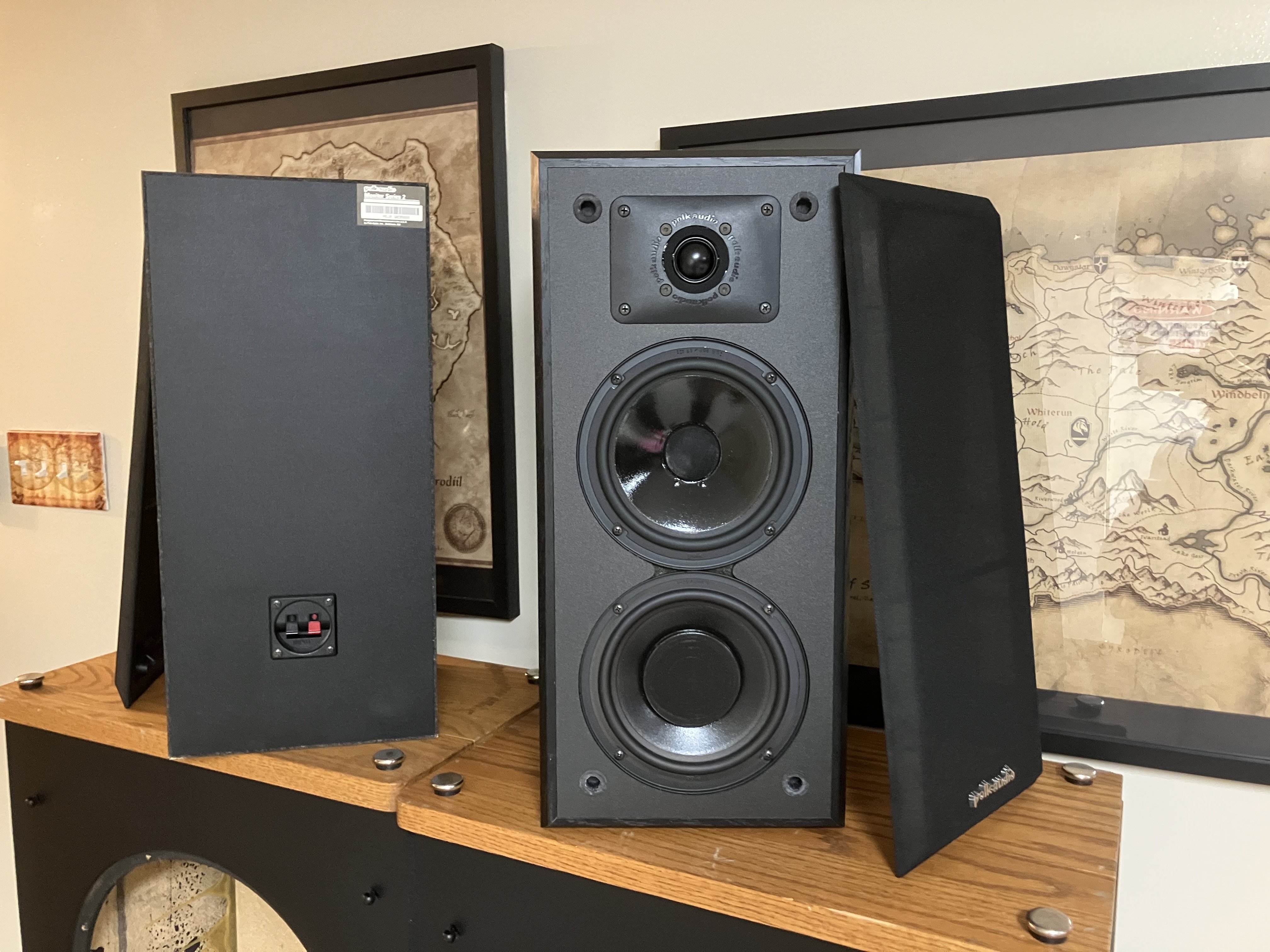

The 4th pair of speakers I've added to my collection this last week lol!
These nice condition little monitor 5s were a pure impulse buy, add came up on FB and it was inline from my wife's work back home.
I had her pick them up and now i have to figure out another system haha! I ran out of amps/sources 2 pairs back, I may try a modern all in one class D setup with this pair and see how it goes.
Upgrades wise I'm going to do the standard cabinet mods, throw two SL3000s in from the 1.2TLs when their 198s get here, and I may upgrade the crossovers myself with reasonable parts pending if I like how they sound.
Setup I had in mind was a semi near field in a room with 6-10 feet away from all walls and 20+ foot ceiling. Something different basically.....

    That's a Monitor 5jr Plus Series II. Also, all the Series II Monitors used the SL2500 (except the Monitor 4) which is different from the SL3000 and not perfectly interchangeable (couldn't hurt to try). Heck, the RD0198 is the upgrade from both of them so try it.

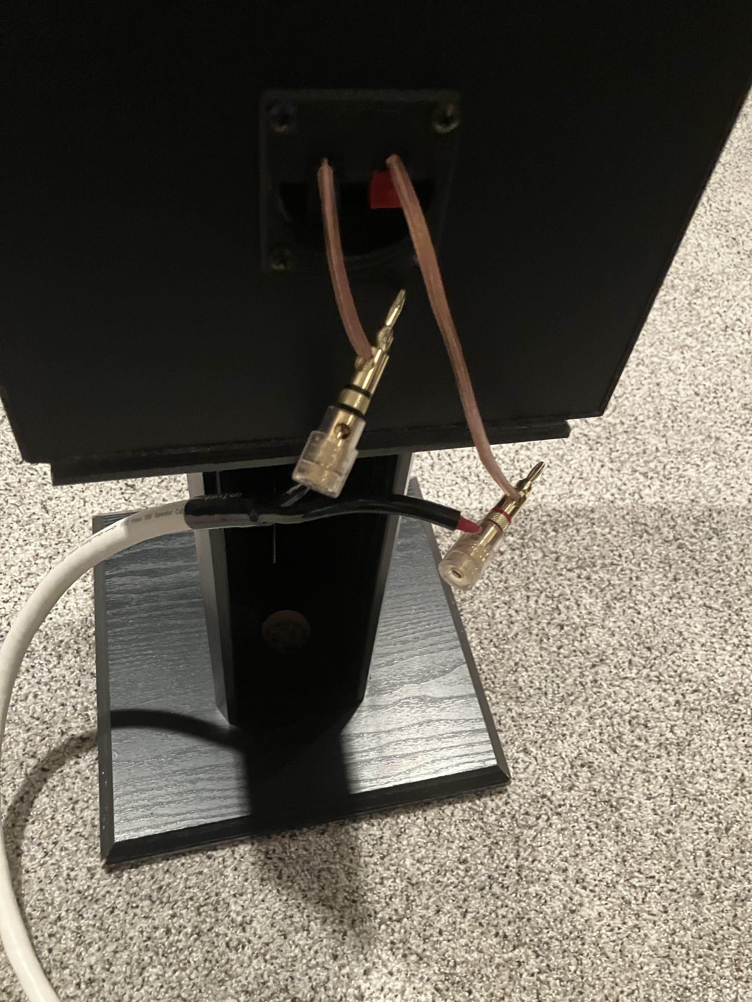

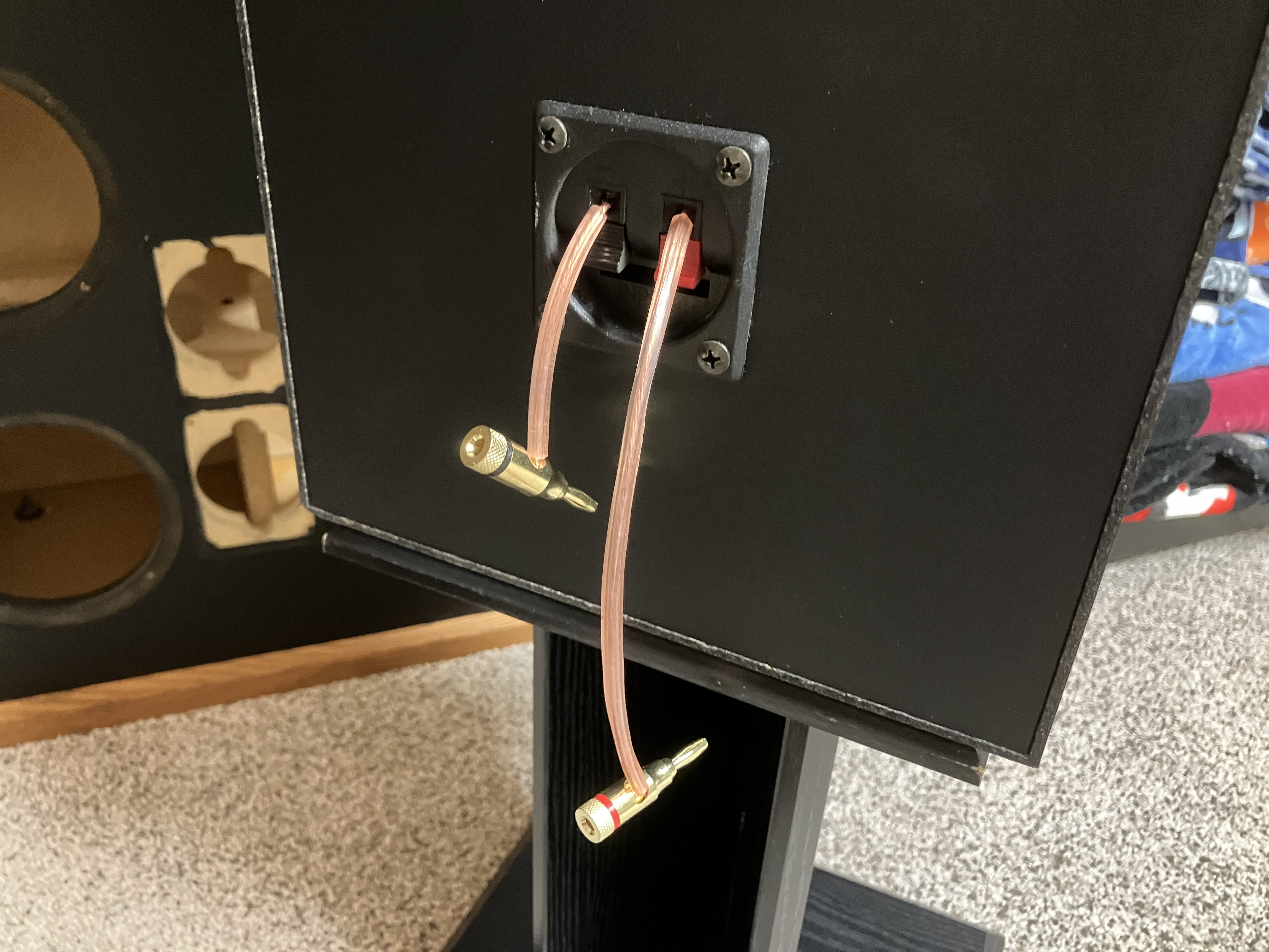

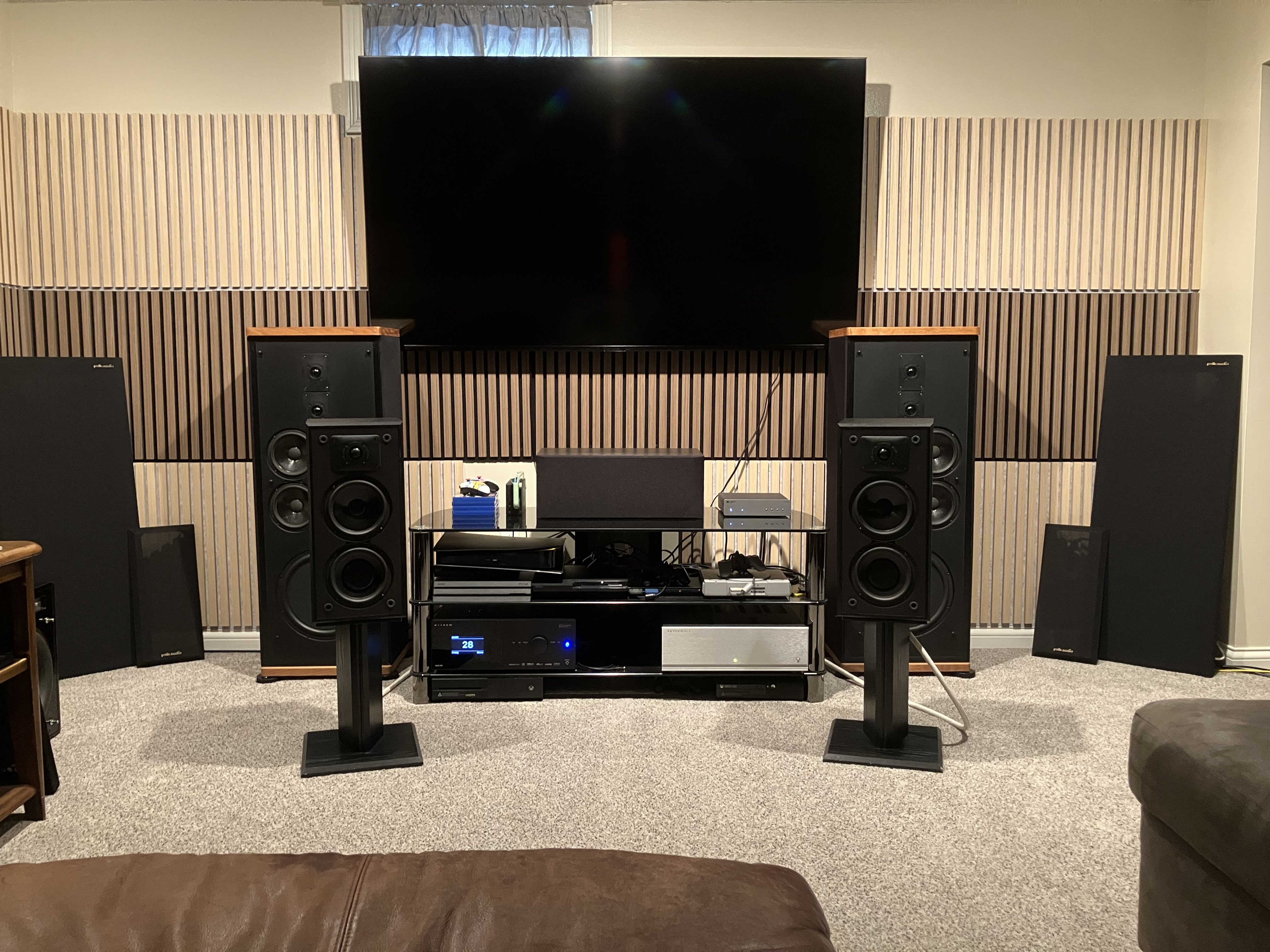

    I finally caved into curiosity and set them up today, had to Jerry rig the cables but eh....it's fine.
    They actually don't sound half bad! Soundstage is that of normal speakers but I'm getting some depth, imaging is okay at the dead center but everything else is just stacking on the speakers L/R.
    With the Fathom helping the low end this is not at all a bad experience, I'm going to give them 5-10 hours to loosen up since they haven't been used in a decade. To be clear though these DO NOT have any low end on their own nor did I expect any, it's not the like 1Cs that can send a subsonic wave though the room that is felt rather than heard.
    The SL2500s are WAY better than SL2000s stock to stock IMO
    If I was to "complain" about anything it's that they are lower SPL at a given setting than the SDA1s and I'm not confident really driving them because of how much excursion I'm seeing at 28% requested volume. Don't want to hurt them and all that....getting 72-76 db at my listening position about 10 ft from them
    Next step is full cab mods to see how that helps my imaging and details, then VR3 crossovers to give them a chance against $3k modern bookshelves

    Nice setup. I'd suggest ditching those spring-loaded terminals if you can. The 2500's are no slouch. Tired X-overs will definitely veil them. The MW's and PR's need Dynamat/butyl rubber treatment on their baskets at the least. BH-5 or similar behind the mids, and if you're brave, full-monty foamed frames and phase plugs will put them in $3K monitor league.
  • Striker2237
    Oh I definitely plan on getting them replaced with proper posts, ditto on all the mods other than the phase plugs. I'm not certain I want to do that because it stops the sleeper effect haha!
