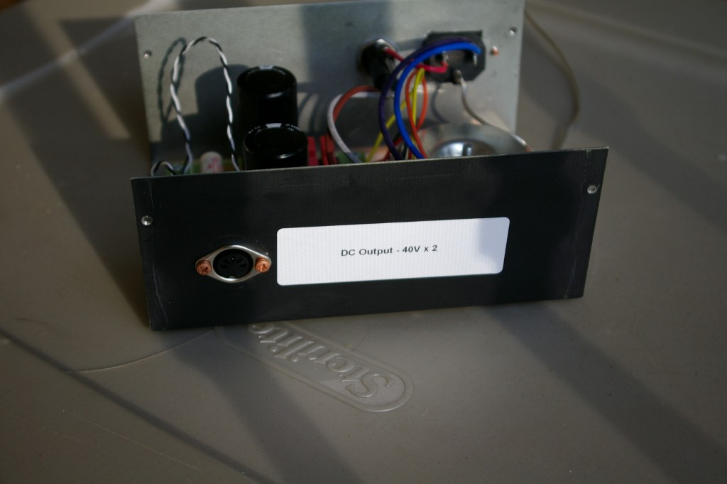

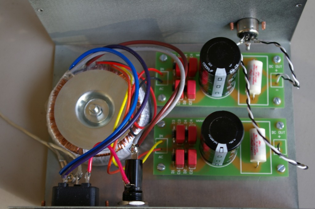

    If you are going through the effort of building your own ACA kits, why not build your own linear power supply? These things are really quite simple. For the low wattage of the ACA, I'd just build one dual channel ~24V-30V LPS with a dual tap torroid, a pair of 15K 35V filter caps for each channel, a 8 appropriately sized diodes, 8 Wima Caps for each diode, and a pair of decent film caps to run in parallel to the big electrolytic.
    I did this many years back for my Pearl Phono and it was really pretty simple. Mine was tad harder because I wanted to run both DC channels in a single umbilical, but for those ACAs, you would obviously want separate runs to the amps. (Note: Later, I went back and added a ground wire to run through the umbilical and tie into the mains ground.)
    (note: I'm pretty sure I mislabeled that and it should be 2x30V)
    I'm not sure if the ACA needs a regulated supply or if they amps have regulators built in. For my Pearl, each channel of the preamp has onboard regulators to bring that 30V down to 24V if I recall correctly. If it needs a regulated supply, that's a bit more complex.

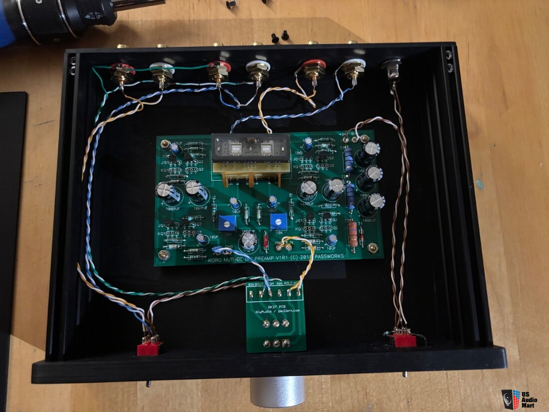

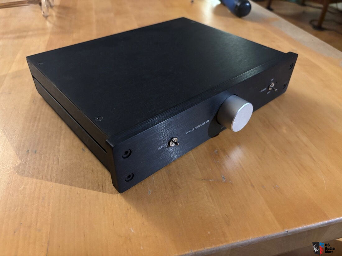

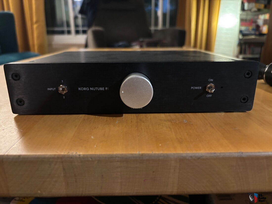

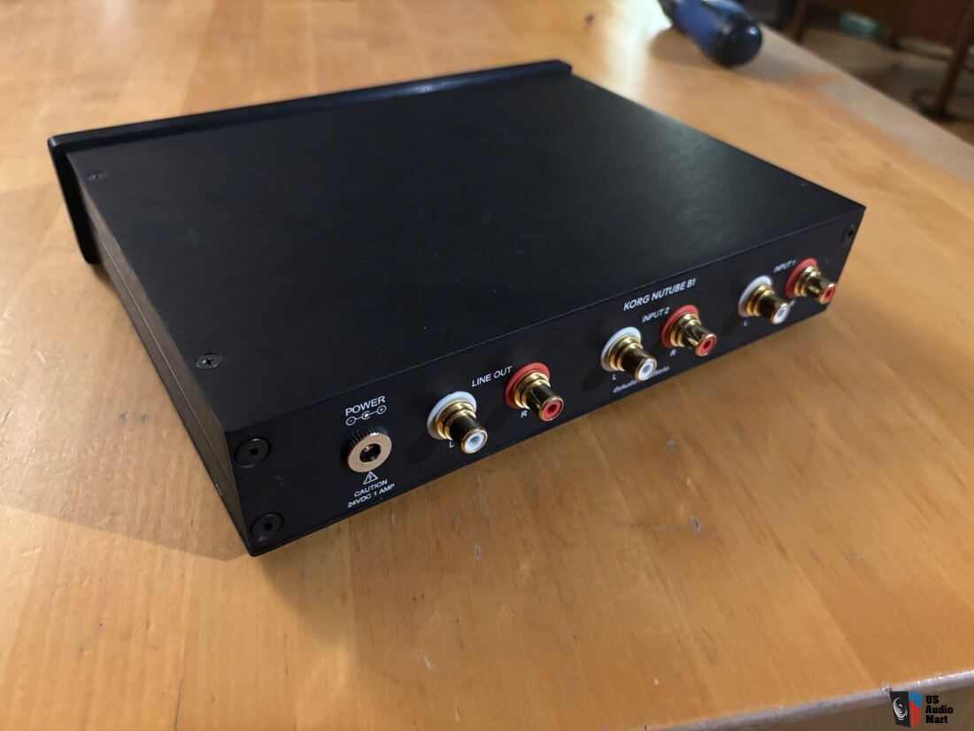

    I've added/swapped in a new piece of gear. These have been out of stock at DIY Audio store for awhile. Just recently back in stock.
    But I found one already well built for a decent price from a great seller. This thing because of the Nutube needed to be well packed. The seller did a stellar double box with 4" of bubble wrap and shipping peanuts.
    Pass Korg Nutube B1 pre-amp.
    FIRST WATT B1 PREAMP WITH KORG TRIODE
    Running a pair of Pass ACA Class A mono blocks- about 20wpc.
    Sounds so fantastic, can't get enough. Haven't messed with the 2nd harmonic adjustment yet.
