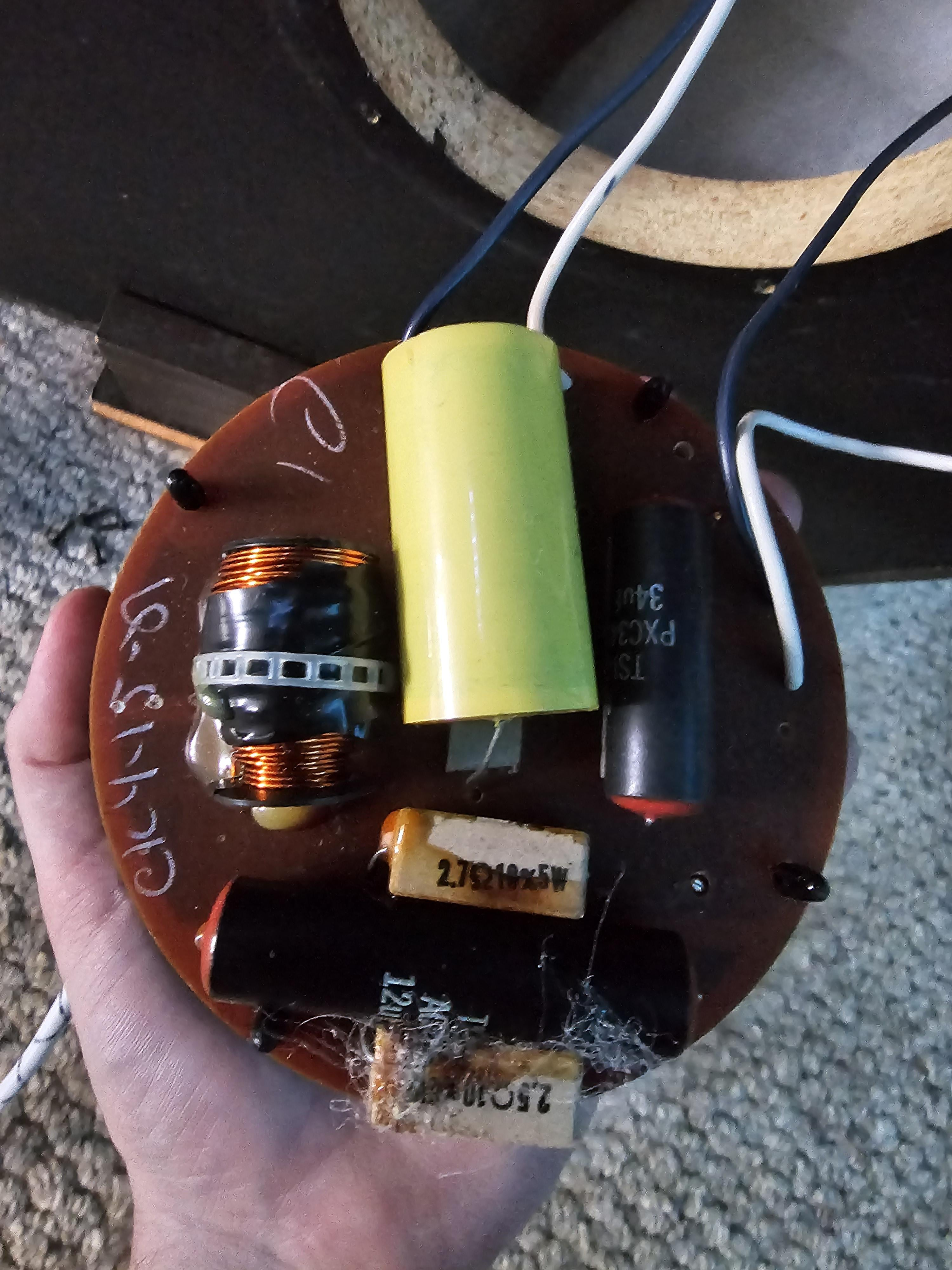

    This is a Monitor 10 crossover, yours might look a little different. FYI, this one has cooked resistors.
    Anyway, as you can see there's not much to it. Those black Temple caps are horrible.
    Do you have a brand of caps in mind? What about resistors? You might talk me into doing them.
