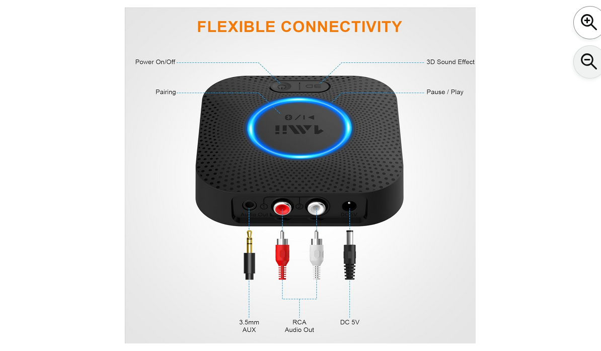

    I would think that you'd need exactly the same latency for both the Edifiers and the subwoofers.
    Now, if that subwoofer will take a full-range line-level signal in and then output a high-pass signal for the loudspeakers (which, if they're like the Edifiers I've seen, have some line-level inputs on them, too -- do they?): then you could use a BT receiver to get a line-level signal into the subwoofer, but you'd need wires to the Edifiers.
    I use a little gizmo very similar to the one below this to get computer audio into one of the oh-so-analog hifis here in the house (mostly for videoconferencing).
    https://www.amazon.com/B06-Plus-Bluetooth-Receiver-Streaming/dp/B078J3GTRK/ref=pd_lpo_d_sccl_2/138-3239819-3231766
