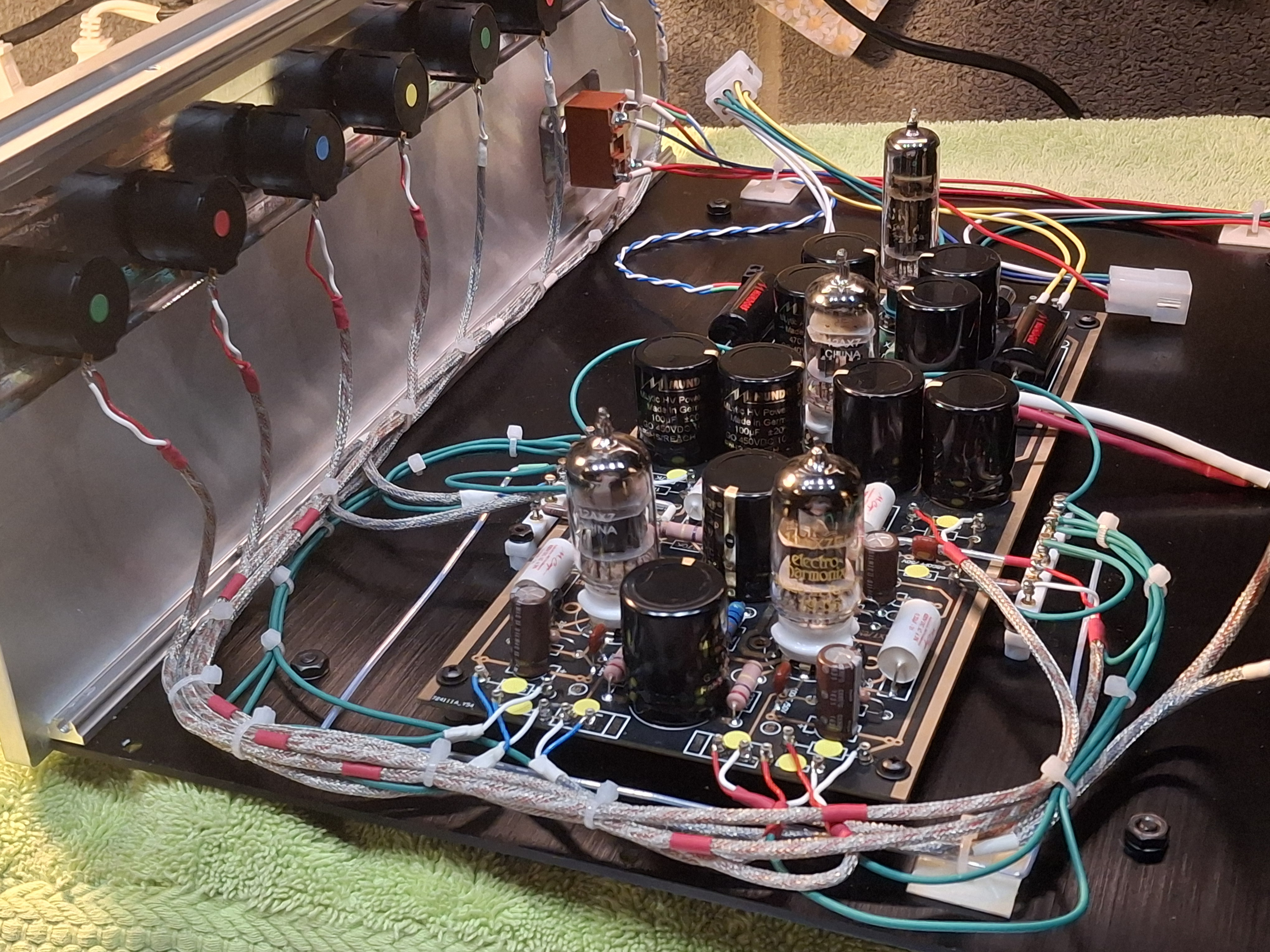

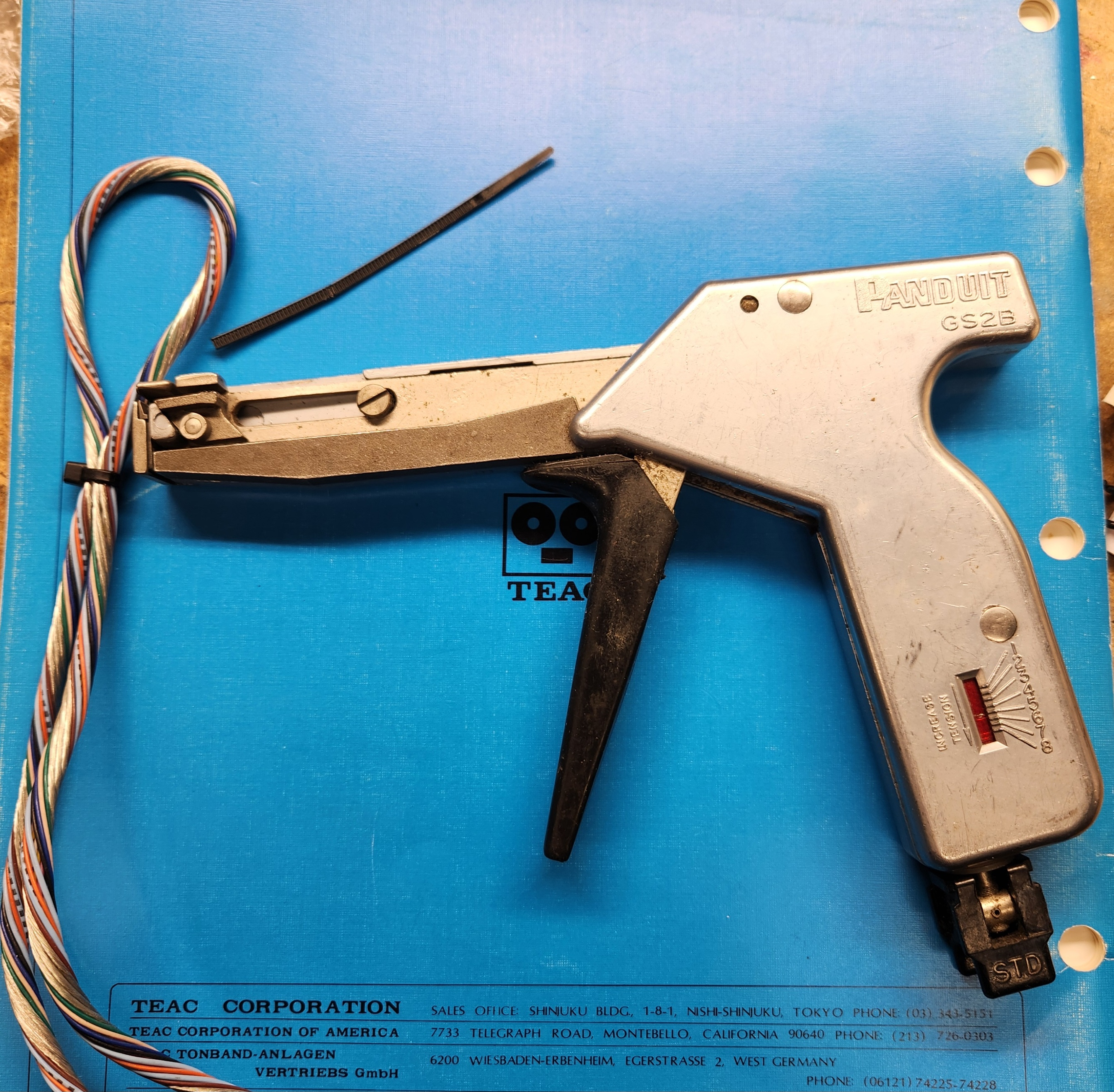

    When Zip tying a harness, I always use my trusty Panduit GS2B cable tie installation tool. It sports three quick-flip tension settings for mini, intermediate and standard ties at bottom of grip with a tension scale on side. This ensures proper and consistent tension, so your wiring has equal power and signal choke at all tie points. This results in balanced power and signal restriction for each channel. When squeezed, the built-in knife blade conveniently slices off the excess tie cleanly.
    :D
  • SeleniumFalcon
    SeleniumFalcon Posts: 4,405
    that looks like a handy tool. I like the old gear that used string to bundle up all the wires. I guess that was done on a loom with all the wiring in a harness.

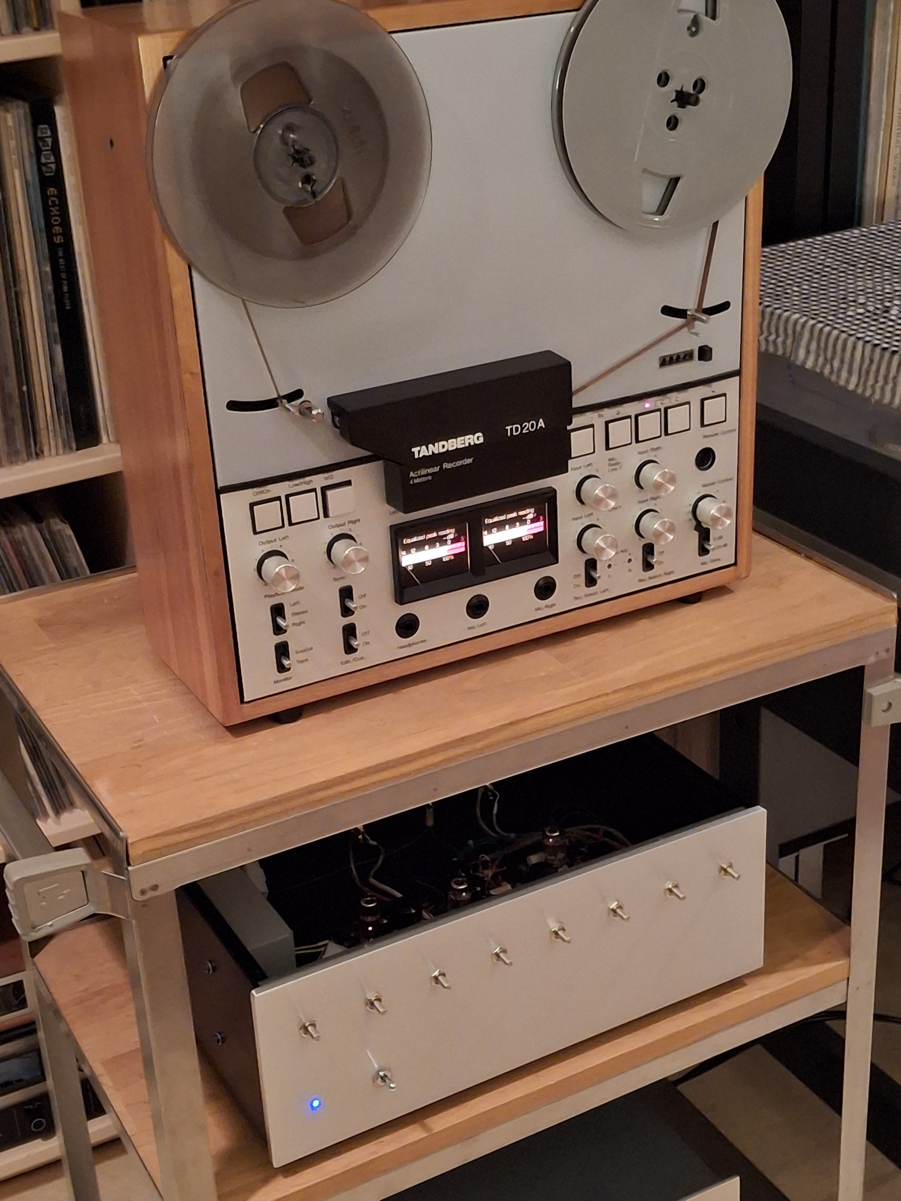

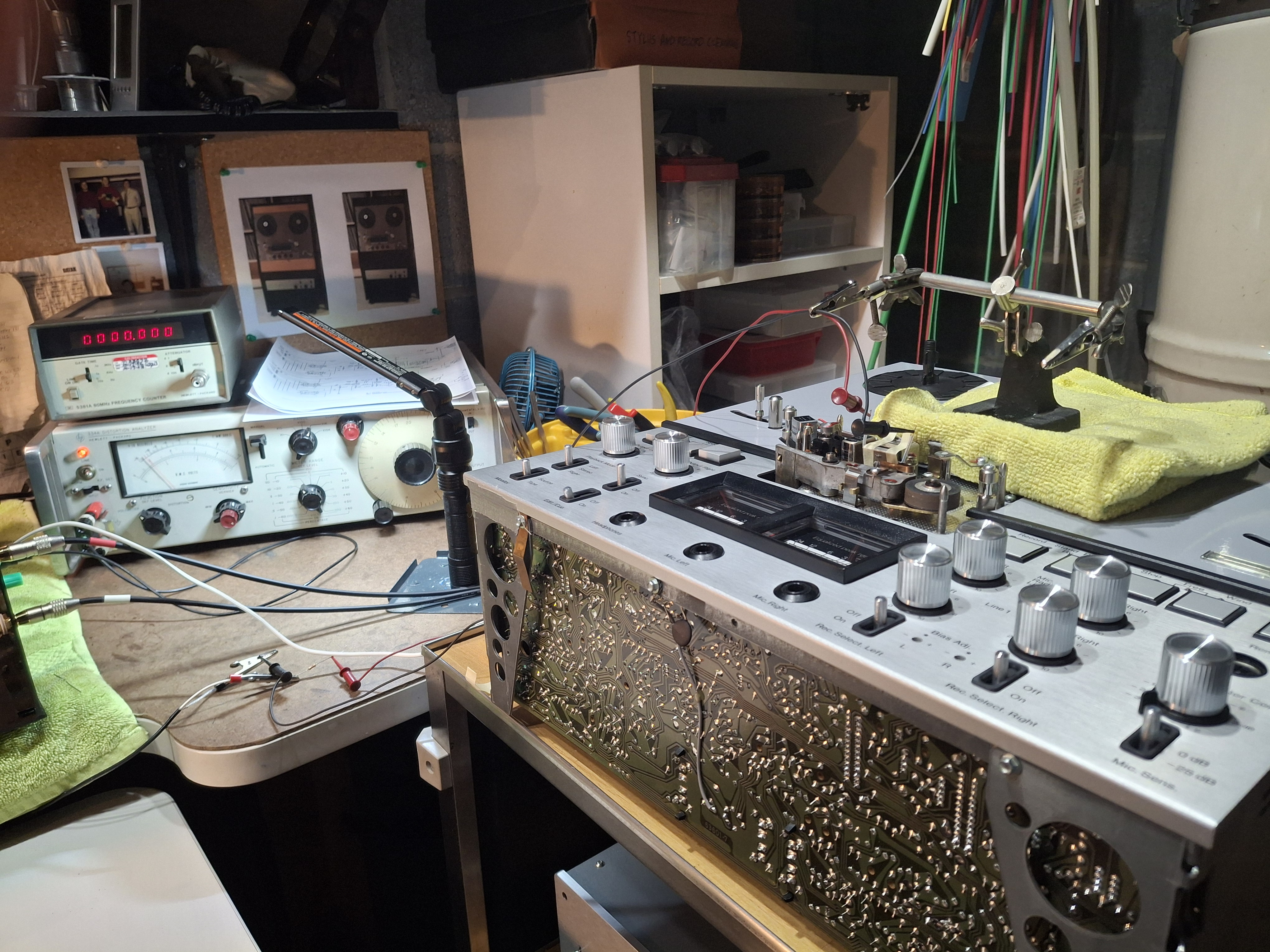

    Finished the right channel connections. Now to begin calibrating the preamp to the Tandberg.
  • SeleniumFalcon

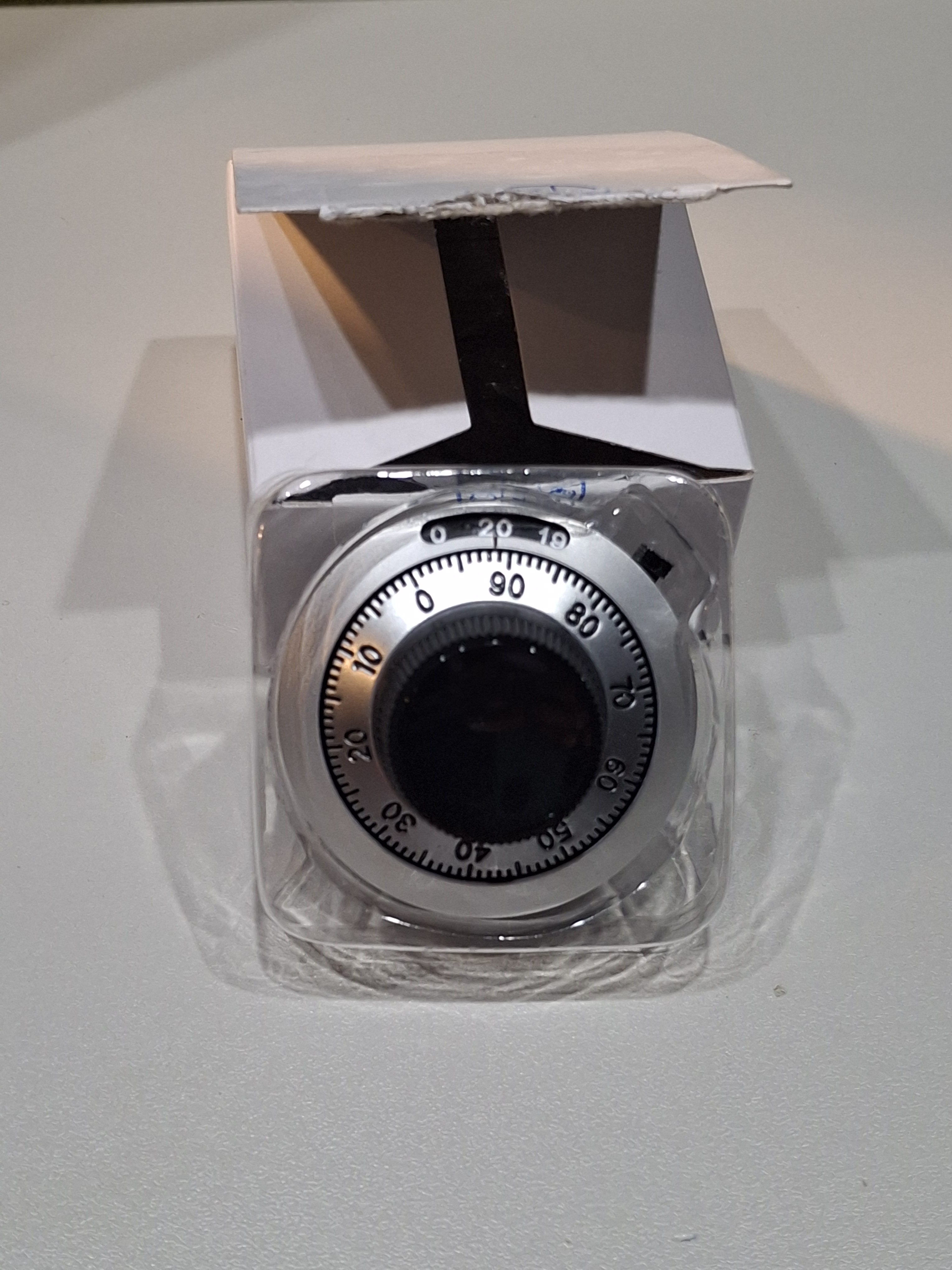

    Still having problems with finding a suitable control knob. I ordered one that I thought might work but the shaft of the potentiometer doesn't come forward enough to be secured by the set screw on the knob. I'm about 1mm short.
    SCompRacer Posts: 9,408
    edited May 2025
    High marks! Outstanding workmanship! Interested in the calibration process. Do you have a service manual written for it yet? :)
    Darn shame about the knob. Extensions would push knobs out too far.
    Are the potentiometers flush to inside chassis, like no nut or washer used there?
    The other option other than finding different knobs would be to disassemble, ugh, machine recess for knobs in the front or rear of panel for potentiometers.
    Have you considered knobs with dial plates? Space permitting of course. I'm guessing you'd need marks for the full 360 degrees.
    EDIT: Never mind, forgot about the multiturn potentiometers, you need a counter.
  • SeleniumFalcon
    Well, the next step is to get some new tubes. The ones I've been using are pretty sketchy, just ones lying Around from old projects. There's some noise on one channel and I'm pretty certain it's tube related. I've ordered some Mullards from Tube Depot that seemed reasonable, all things considered.
    Knobs is a continuing issue. I didn't think it through when I drilled the faceplate, but any knob with a counter requires a small hole below the dial to keep the outside part of the dial from turning when the knob is turned. The second problem is that there needs to be more of the potentiometer outside of the faceplate so the dial has something to lock on. I may have to visit my machinist friend again.
    The calibration process involves mostly learning how the various adjustments effect the playback response. If the playback head has a high frequency resonance then the input loading can be used. The gain adjustment can be used to carefully match the two channels, but can also lead to oscillation. The sections of the feedback that influence the bass and treble are going to be dependent on the characteristics of the transport and how a test tape looks when connected.
    At this point the LED lights up and that's a beginning, right?

    I dug around in my tube inventory and found some more suitable choices, channels seem fine. I did a frequency response measurement, the adjustments for treble, bass are working fine. Distortion was 0.38% for left and 0.82% for right. I hooked it up and started to listen and haven't stopped, really nice sounding. I've listened to Gershwin, Wes Montgomery and Jimmy Smith and now Blood, Sweat and Tears. I like it, very rich sounding.
    edited May 2025
    High marks for you! Did you count turns? Just curious how many of the eight turns you used.

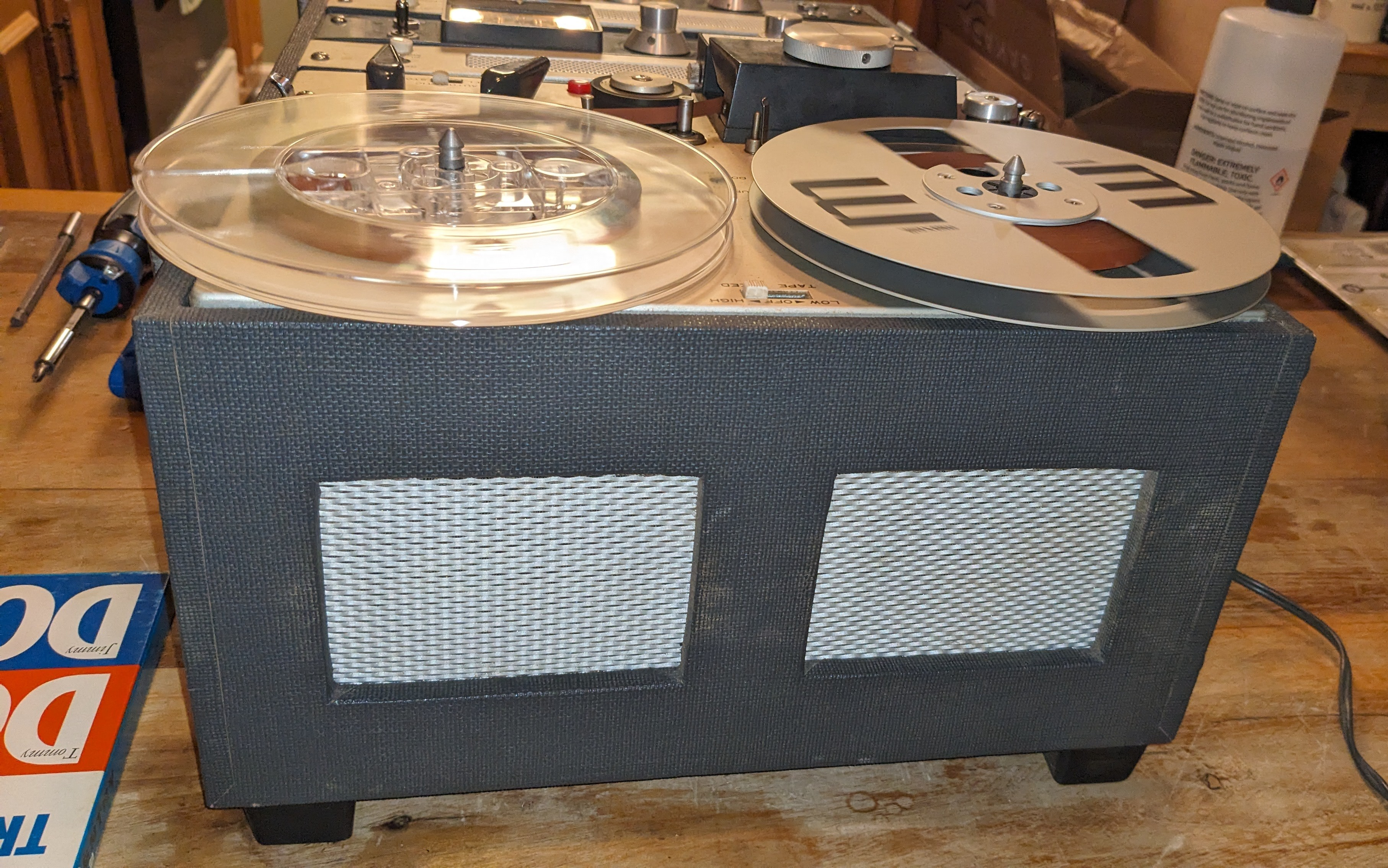

    That is a really nice Tandberg. I've always seen them with black upper faces, sometimes the lower is black. Is it because you didn't read the where to find black paint thread :D or was it a custom choice by you?
    Love BS & T. Remember the controversy when Blood, Sweat and Tears participated (or were forced) to do that government-sponsored tour to the Soviet satellite states?

    Thanks! So far the only adjustments I've used are the high and low frequency ones, I used a signal generator as an input and looked at how close the response compared with the NAB playback curve. I've been working with Kevin Barrett at KAB Electro Acoustics in converting his reverse RIAA device into an NAB curve. That way I can see how the EQ differs from flat. The input loading adjustment is there to compensate for any playback head resonances which will show up when the deck is connected. I would like a bit more gain from the circuit, but want to see how changing the gain effects headroom and distortion. The left and right outputs were exactly the same, so no need to change for that reason.
    I changed the color of the upper plate to grey from black, I had scratched the old plate when I didn't have the speed change push button bracket set correctly so I decided to get it powder coated. It looks a bit less severe and I like grey for some reason.

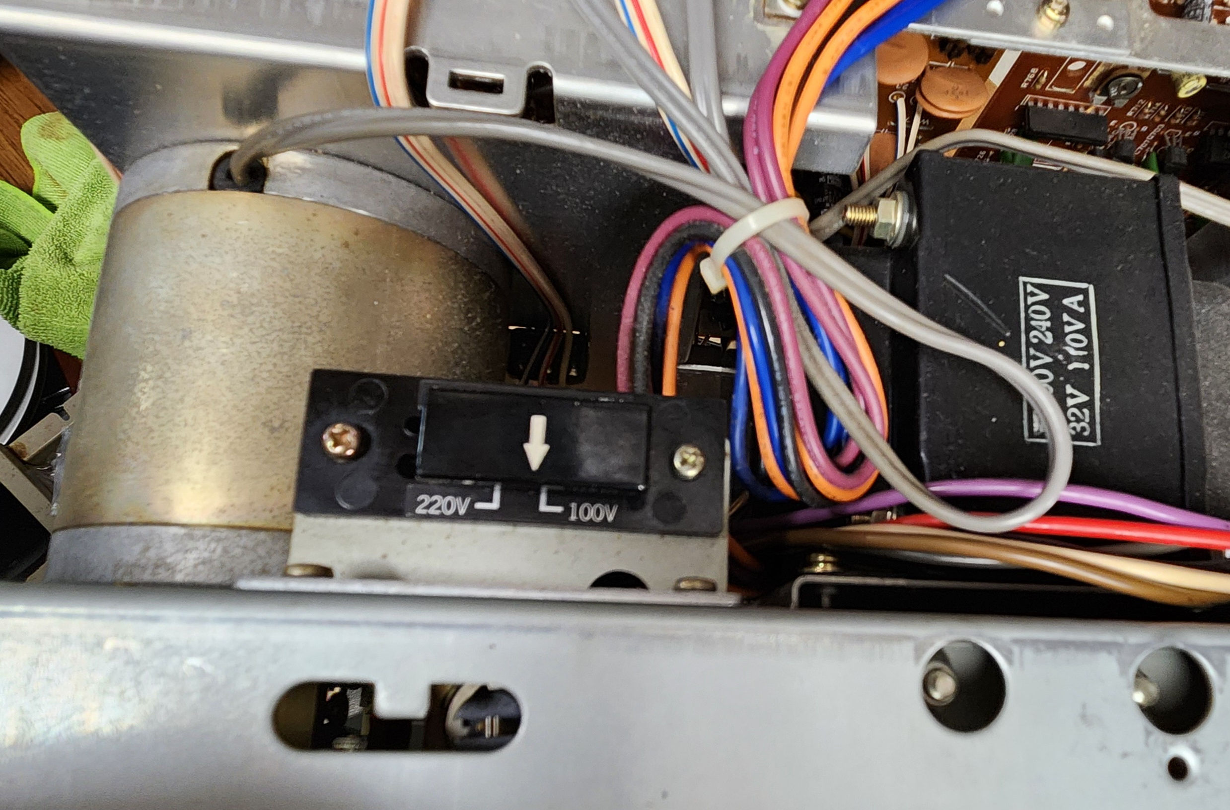

    Inspired by this thread, I pulled the Akai M-8 RTR tape deck from my dad's collection out of storage.
    This model has separate L/R pre-amp tube stages, along with separate output stages, which can drive the integrated speakers that point upward from the top of the tape deck, or it can connect to external speakers. Of course, it has pre-amp outputs as well for connecting to a proper system.
    The full tube complement is 2 X 6267(EF86), 2 X 12AD7(12AX7), 2 X 6BQ5, 2 X 6X4, and 1 X 6AR5.
    Some folks pull the amps out, and convert them into low-wattage guitar amps, which is apparently because of the 6267 tubes, which were also used in vintage VOX guitar amps. There is quite a bit of information about this on the web. All the input and output sockets are 1/4" (no RCA), which could be another convenient reason for usage with guitars.
    It has a couple of interesting features for EQ/Tone Control. For EQ, it has one setting for 1 7/8 IPS, and another for 3 3/4 and 7 1/2 IPS. I think the idea is that for recording normal speaking/speeches at 1 7/8, it has one EQ, and then for music recordings at 3 3/4 or 7 1/2, it has another EQ; I'm not too sure about all that. The deck also has tone controls, which I think are really just a low-pass filter, again similar to a guitar...from what I have read. In other words, there's no middle zero setting for the tone control - it just applies the low-pass filter at different levels, and doesn't really 'boost' any frequencies.
    Anyway, one thing I could use some advice on is the input voltage setting. It has settings for 100/110/117/200/220/230. It is currently set at 110, but I'm thinking 117 would be more appropriate in my case. The CPS setting is at 60Hz, but I'm wondering why the voltage has been set at 110. Any thoughts on that?
    edited May 2025
    That's a pretty neat old school deck. My Bottlehead Eros phono uses two EF86 in the first gain stage.
    I see that deck had the 50/60Hz selector in front panel. Most I've seen are inside the deck.
    I haven't worked on many RTR decks, but I found two set at incorrect voltages. A Pioneer RT-71 was set to the Japanese voltage of 100. The other ended up as Carl's Teac X-1000r. It was also set to 100VAC instead of the 120 choice. My guess, if the deck was built in Japan they selected 100VAC. The owner's manual typically mentioned how to change voltage and Hz for your country in the first pages.
    I chose 117 for the Pioneer since it was closest to 120. The X-1000r required removing cabinet to see/change the voltage setting while the Pioneer was outside and visible by the RCA input/outputs.
    I'm fairly sure they were like that from day one. Incorrect voltage settings can tax the power supply and provide excess circuit voltage causing excessive heat and failure. Fortunately, the two decks work fine after setting correct voltage.
    Present day, our mains here can be at 125VAC. On the old Scott 399 receiver I refurbed for Ed, I ended up building a bucking transformer for it. It has three speeds, line and two steps of reduction. At 125vac, the plate and heater voltage exceeded specs, enough to shorten tube life. The 399 was designed when mains were 115 or 117vac. One can tailor the bucking transformer amperage choice to the required load.

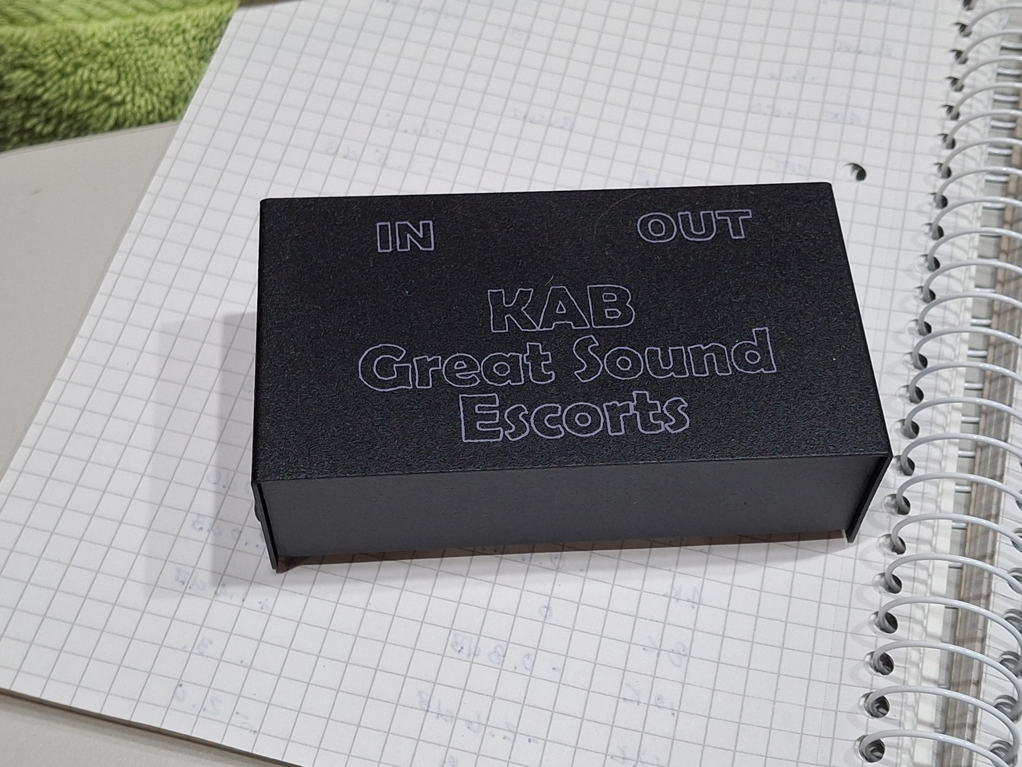

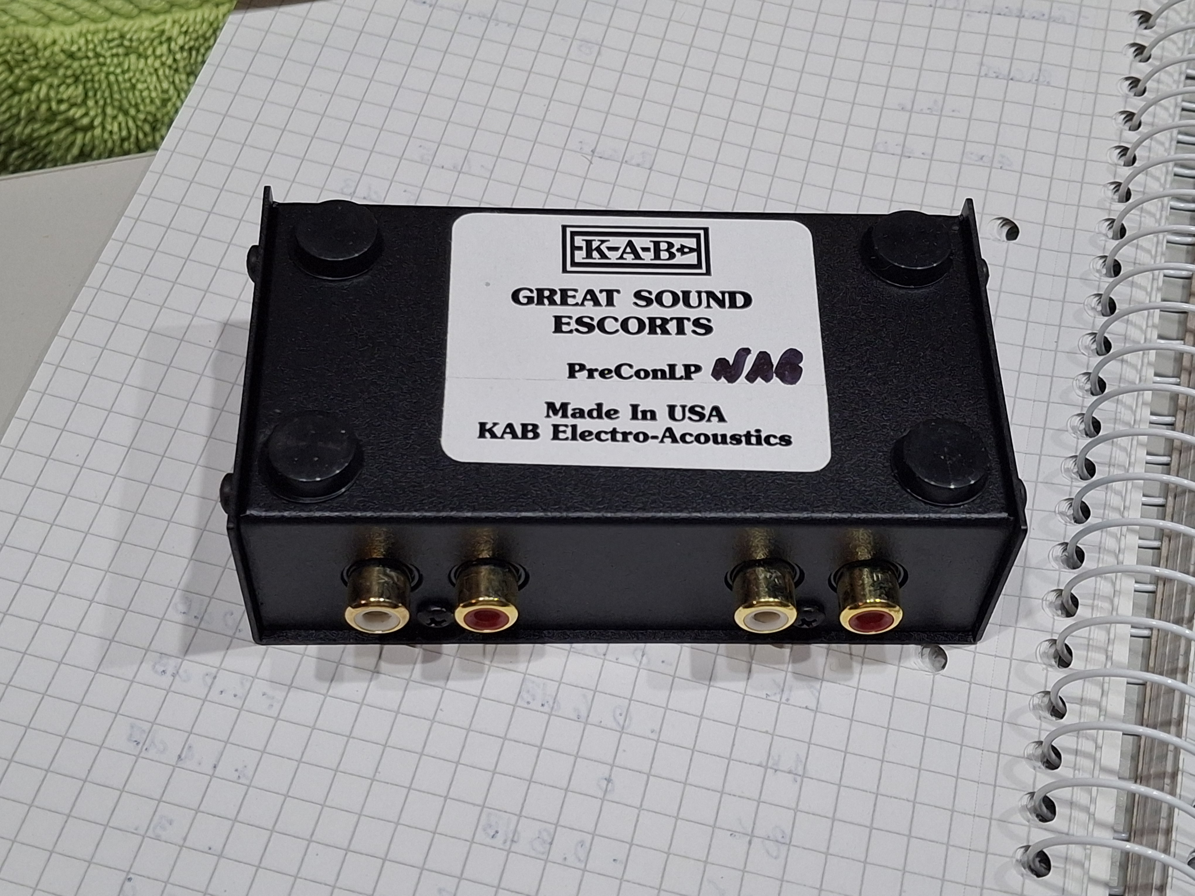

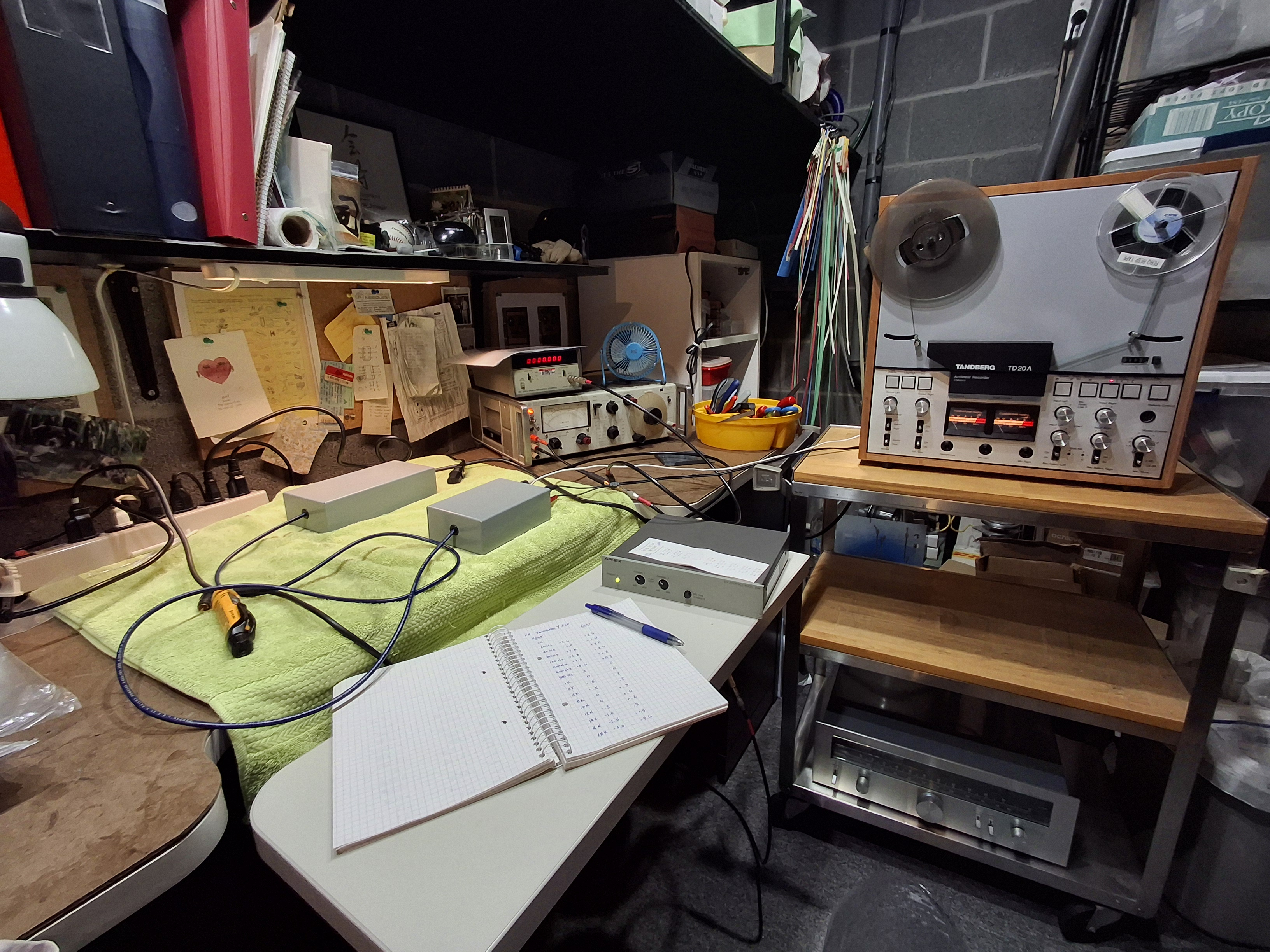

    Lot's of cool toys happening here at Muppet Labs. I received the reverse NAB EQ device from KAB Acoustics and have been connecting it to several tape preamps and recording the frequency response. Still some things to work out.

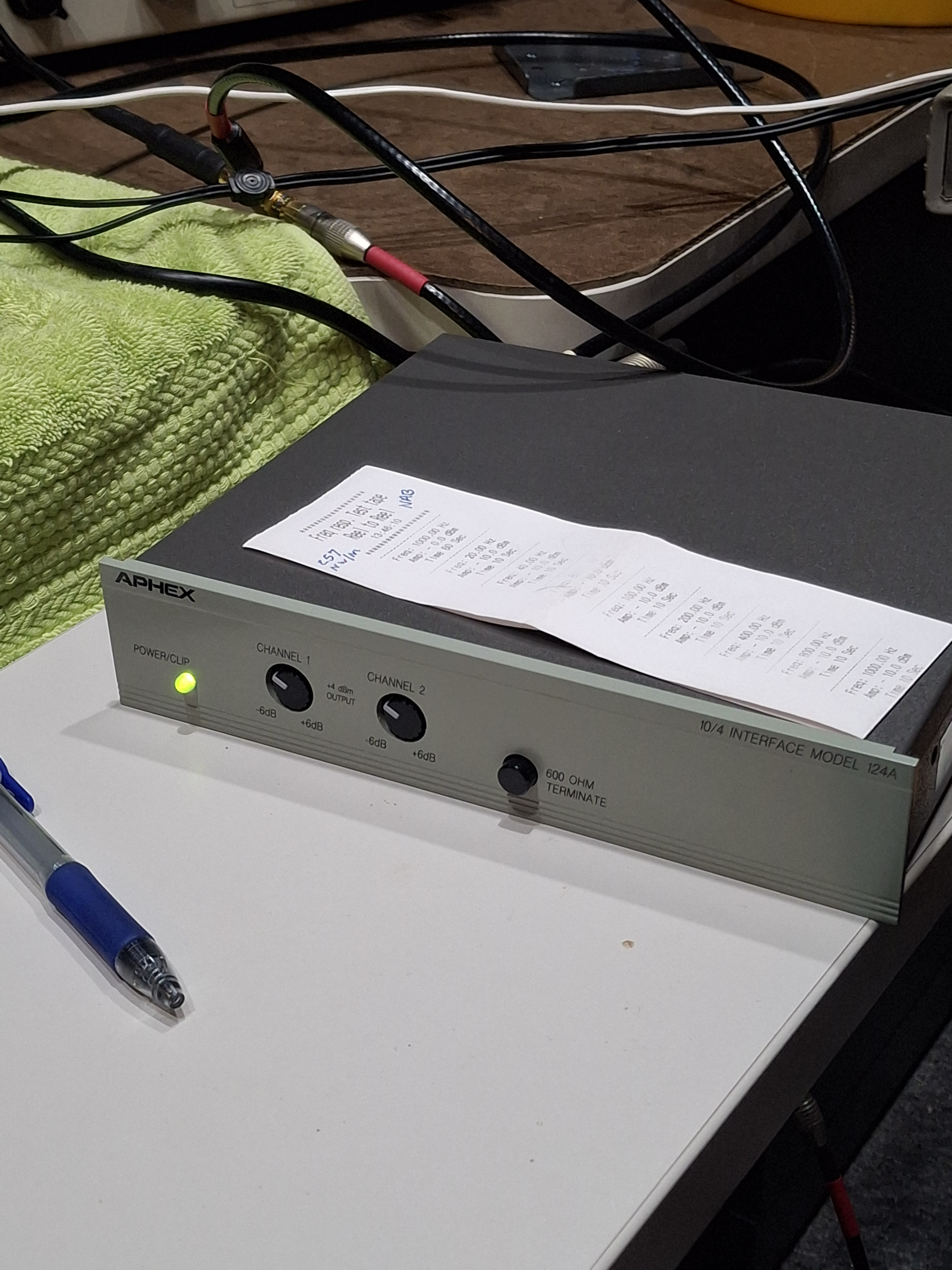

    Then I got a very unique device from a company called Aphex, a company that makes a wide range of audio devices mostly used in the professional audio world. It's really two devices in one enclosure, it can take a balanced signal in and provide a single ended output with precision level adjustments. Or, it can take a single ended input with balanced outputs also with precision level adjustments. It is extremely neutral and has an excellent power supply. I can use it to set an output exactly at "0" dB on my meter and quickly see the deviations from linear as frequency is changed.

    I'm using a calibrated tape to measure what happens when I use the Tandberg with an external playback preamp. Here it is connected to the Elliott Sound Products preamp which has no adjustment capability (as opposed to the Marantz which is the opposite). I'm finding that the Tandberg playback head exhibits a rise in the low frequencies due what is called "head bump" and a resonant peak at 8kHz followed by a rolling off at the upper end. Tandberg solves this problem in their onboard preamp section by having a variable resistor as the load and a frequency shaping EQ. By adjusting the input load and sculpting the EQ they achieve a flat response.

    I have quite a bit of adjustment capability with the Marantz, input loading up to 100k ohms (the Tandberg schematic uses 500k ohm trim pots, I may need to add some resistance), bass and high frequency adjustments. My plan is to learn more about what Tandberg did, so I'm going to take the chassis out of the cabinet and measure what the factory settings were for the head loading. Also I'm going to reconnect the Tandberg playback preamp and see what the test tape looks like playing it via their circuit. It's possible the playback head is worn (it doesn't look too worn) which would throw off the results. It's possible the Tandberg isn't a good choice for an external preamp.

    Are you wearing your Dr. Bunsen Honeydew labcoat? :) Neat toys!
    So the 600 Ohm button on the Aphex. Is that to switch between 0dBu = 0.775V rms and 0dBV = 1V rms? It's like that on my Leader signal generator.
    On the Teac A series, I read they added a level of boost at 7.5KHz in the record circuit to help early tapes like Scotch 203 to sound good. Later tapes didn't need the boost and some have changed Mica EQ cap values. You can get around it by biasing new tape at 1kHz and 10Khz instead of using the overbias method.
    I've never tried head out playback to external phono amp on the decks so running with their playback circuitry.

    I figured out the difficulty with the KAB NAB network. My signal generator has a 600 ohm output and the network has an impedance of 1.1k ohms at 20kHz, so the top end was rolled off. I used the Aphex as a buffer and the response was flat with the ESP preamp. I then used a BK Precision generator with an output impedance of 50 ohms and the response was flat as well.
    I think the Aphex can output 600 ohms for longer line connections in a studio application, where components can be 50' or more apart. It's really designed to allow consumer audio gear to match with pro gear. The balanced circuitry is transformerless and servo-balanced so transients are preserved. It's really handy and extremely well built. The schematic for the power supply is a textbook example for how they should be built. They can be found on eBay for very low prices, I found a NOS unopened.

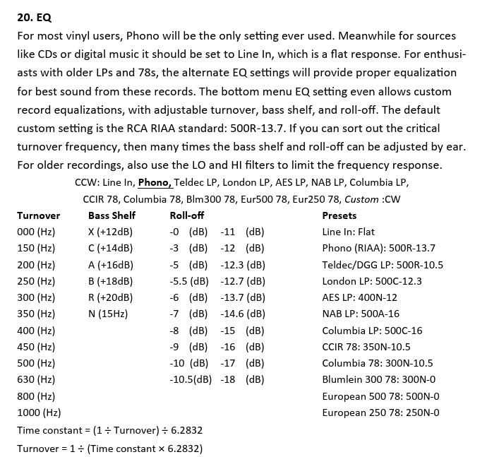

    You guys may not be fans of DSP, but the Parks Audio Puffin is basically a DSP phono stage, with MANY different EQ options, some of which might also be useful with a vintage tape deck...or at least give an insight into the options that these units are capable of.
    Below is a screenshot from one page of the Puffin owner's manual, which may provide a window into the capabilities.
    I realize that a phono RIAA EQ is different from what a tape deck might need, but this is just food-for-thought. Shannon Parks, the owner/operator/developer of Parks Audio products, is very accessible via email, and would likely be open to discussion about alternative EQ applications, that could be available as 'firmware' updates.

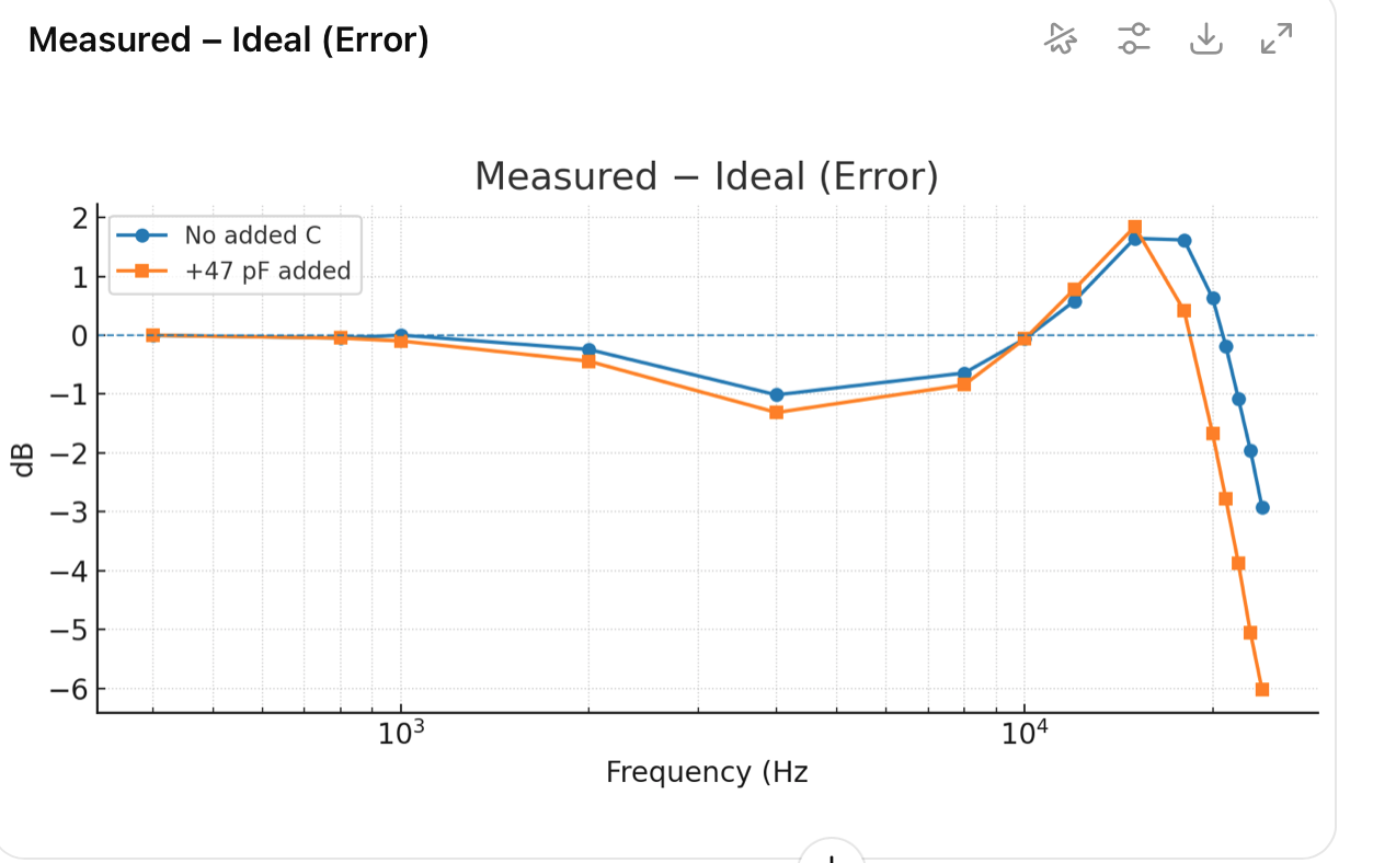

    A bit of an update on this project. I've been trying to learn about how to convert a phono preamp to one that would function as a tape head preamp. I bought a Dynaco PAS2 in good condition and combined with an original construction manual have determined how going from "phono" to "tape head" was done. I've spruced it up a bit and bought a few of the many upgrade components available for it. I've begun learning how to mathematically analyze the Marantz 7 circuit and create ways of predicting the interaction of the gain stages and the feedback network. Rather than just turning a potentiometer and seeing how it effects the output I'd like to be able to predict what the changes might be and then see if the results confirm it. I bought a test instrument that I can now accurately measure a tape head's impedance along with connecting cable's capacitance. This allows me to predict what changes head loading can accomplish. I've made some improvements in using a flux loop to measure how an external preamp interacts with a playback head and begun to understand the mathematics and physics involved. xboucjys6wib.jpg
  • SeleniumFalcon
    edited August 2025

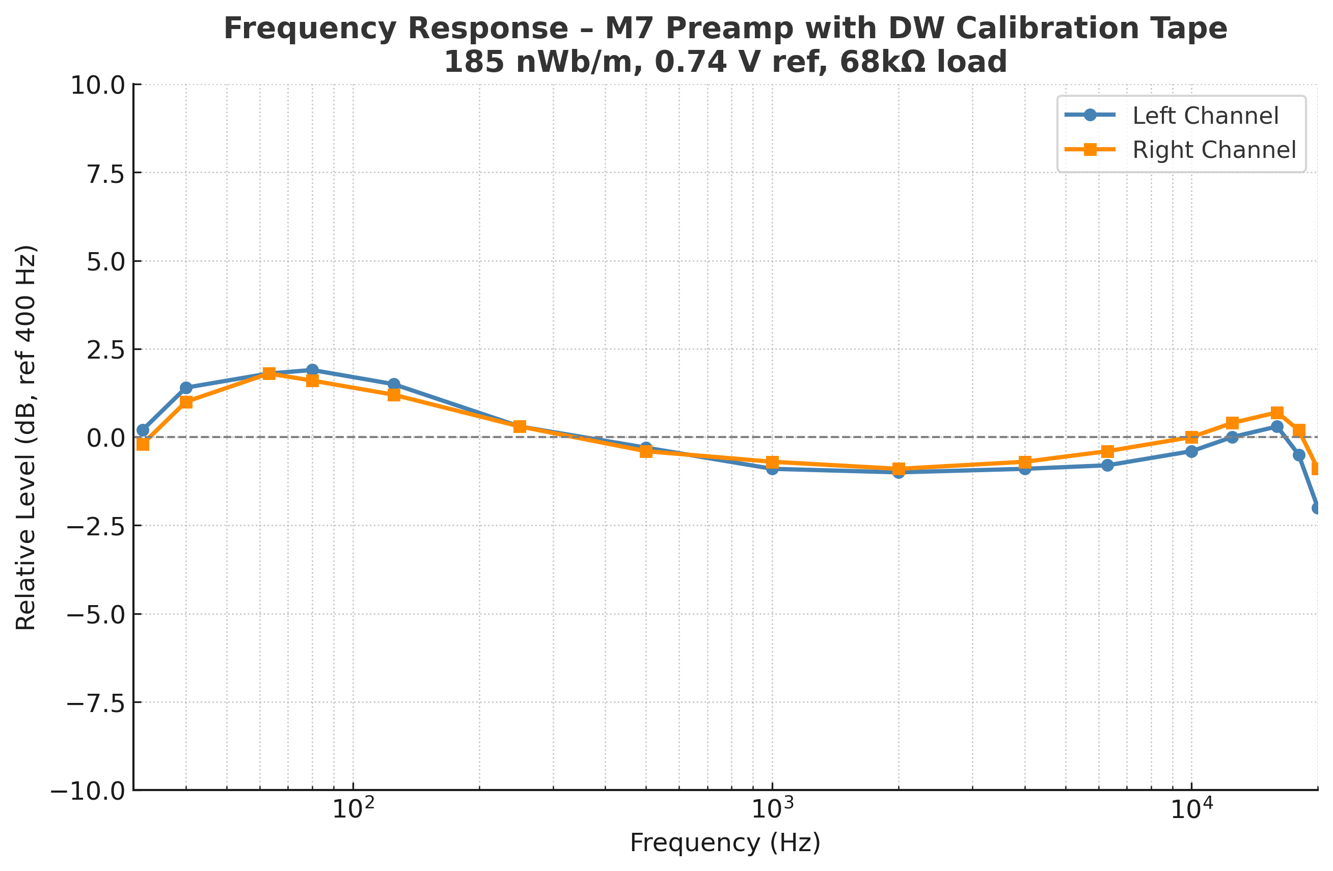

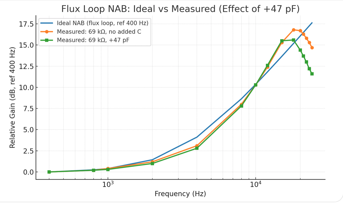

    Here's a curve that I was able to measure showing how adding 47pF capacitance to the input loading effected the playback EQ versus an ideal measurement using a flux loop attached to the Tandberg's head. The goal was to be able to predict what the change would be and then see if it happened.
