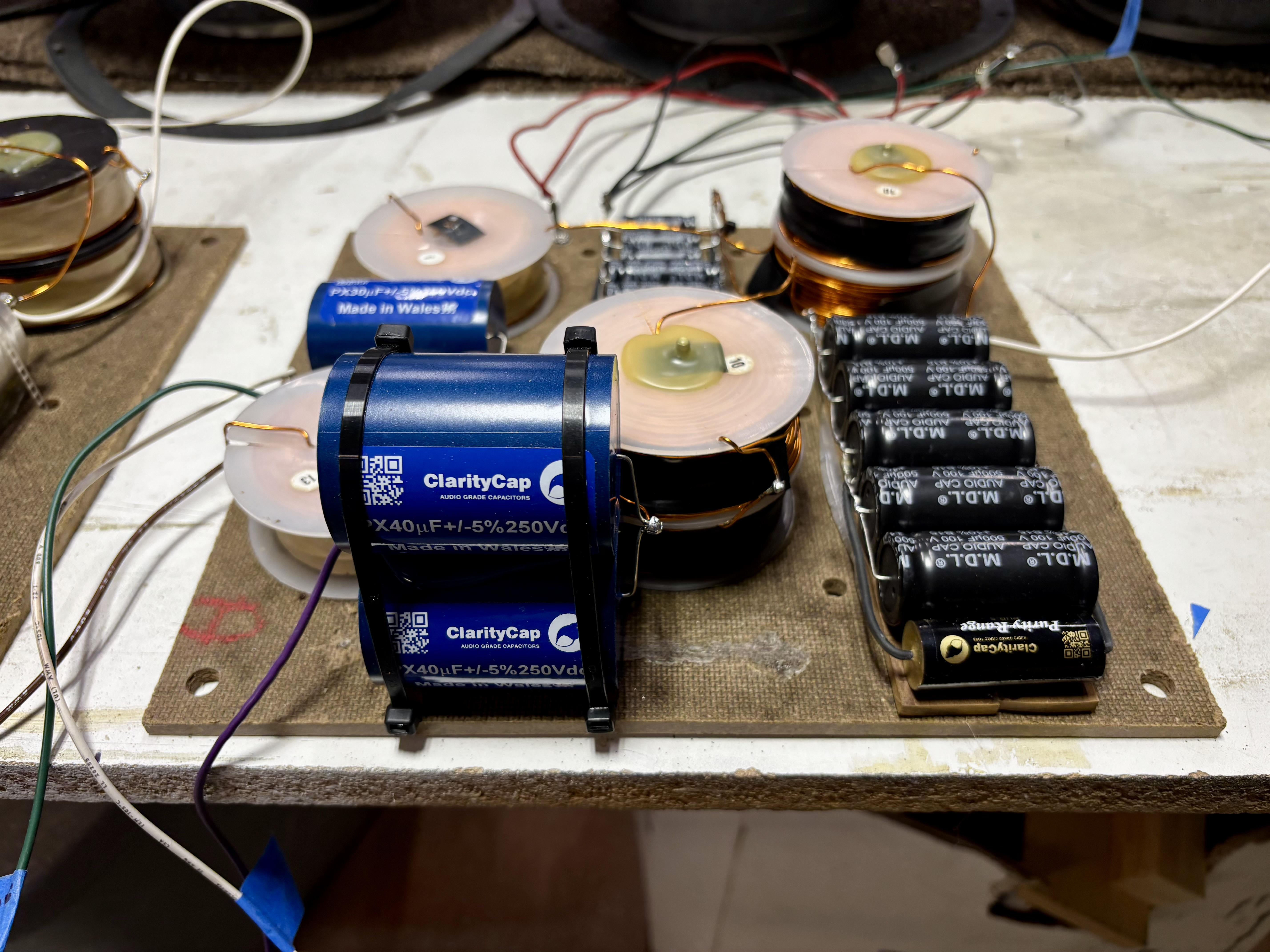

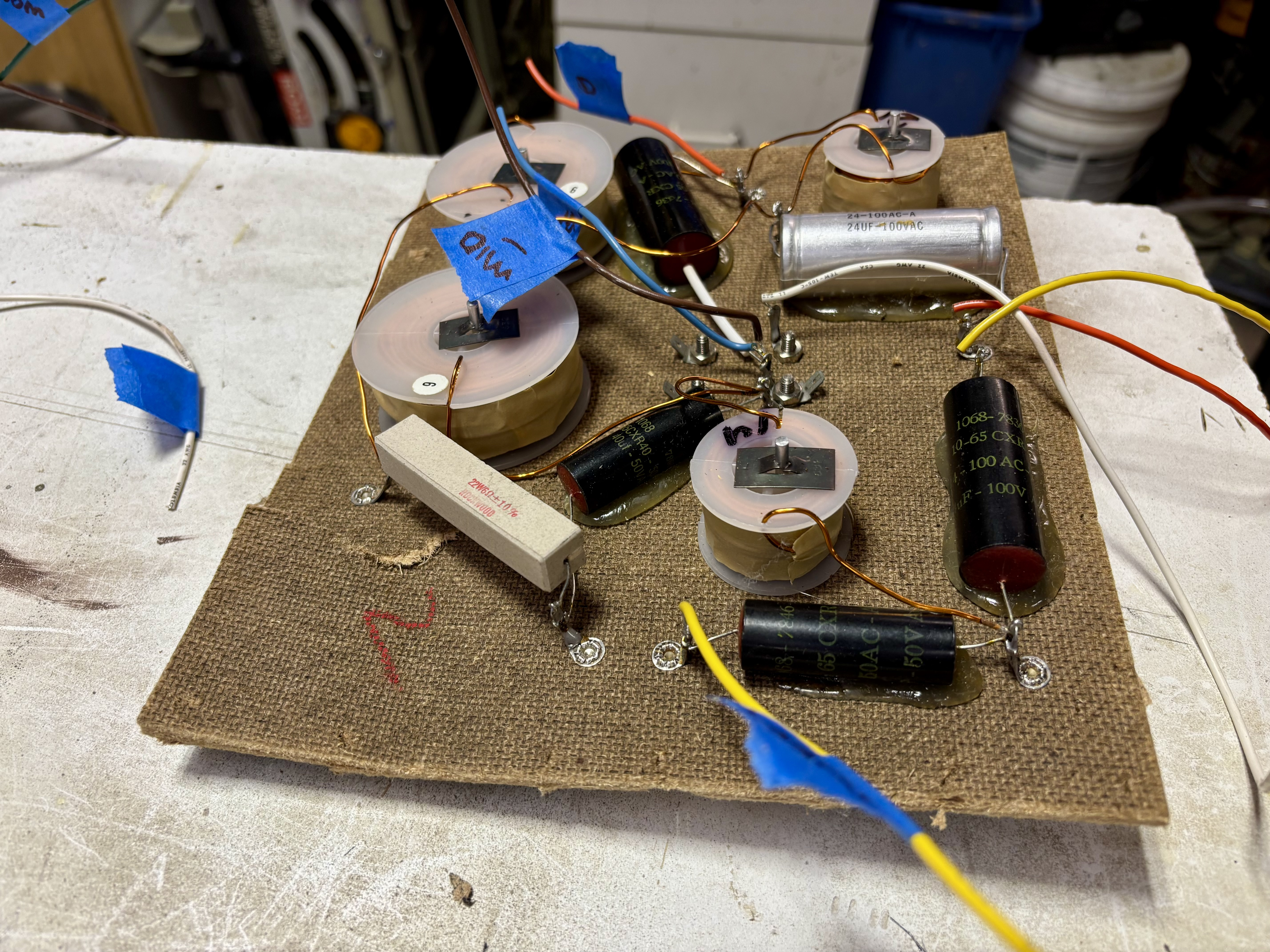

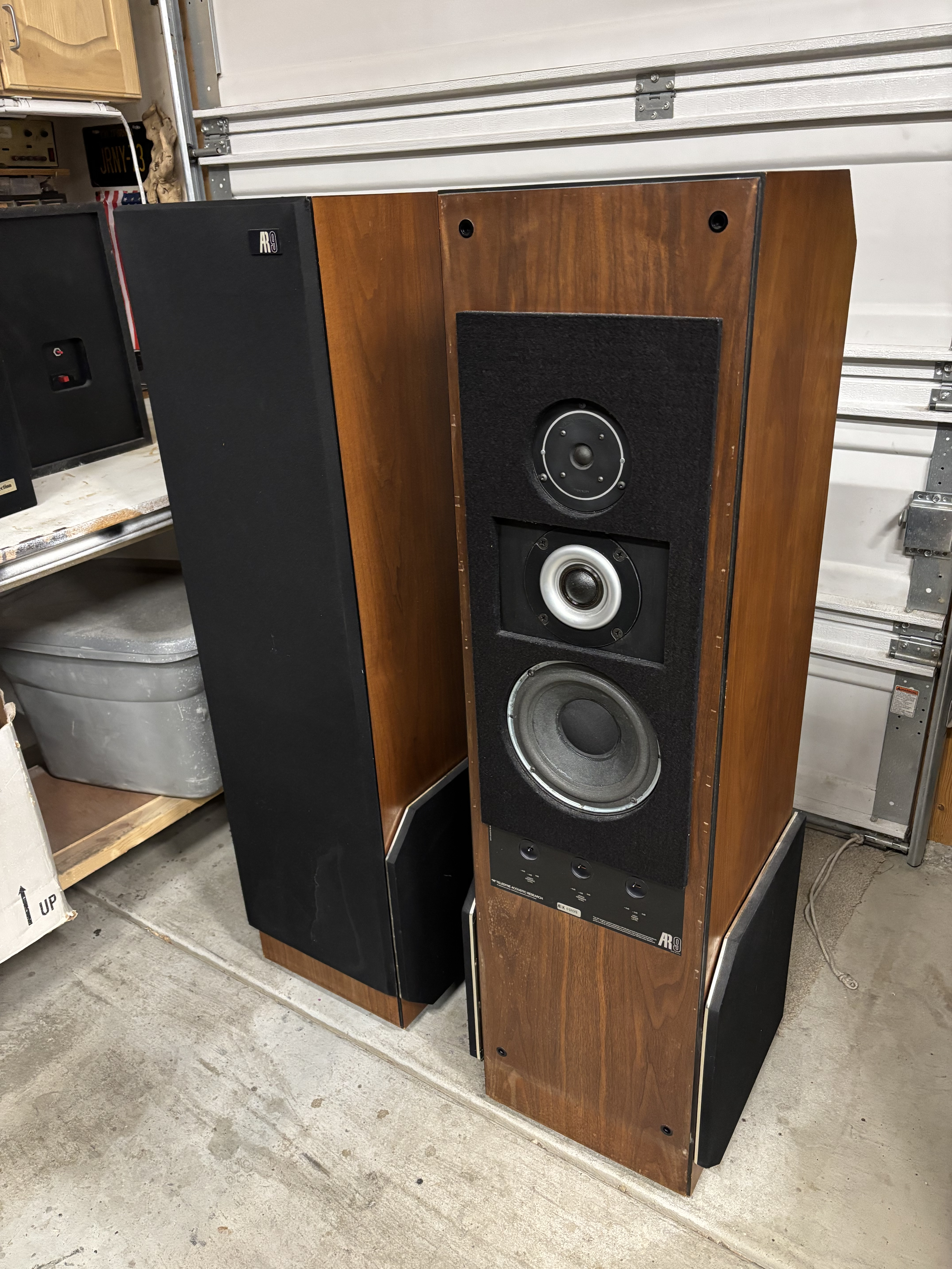

So a friend approached me a while ago about updating his AR9’s. I agreed before realizing how massive the beasts are. 130lbs each 5’ tall. Monsters. They almost filled the bed of my Tacoma.

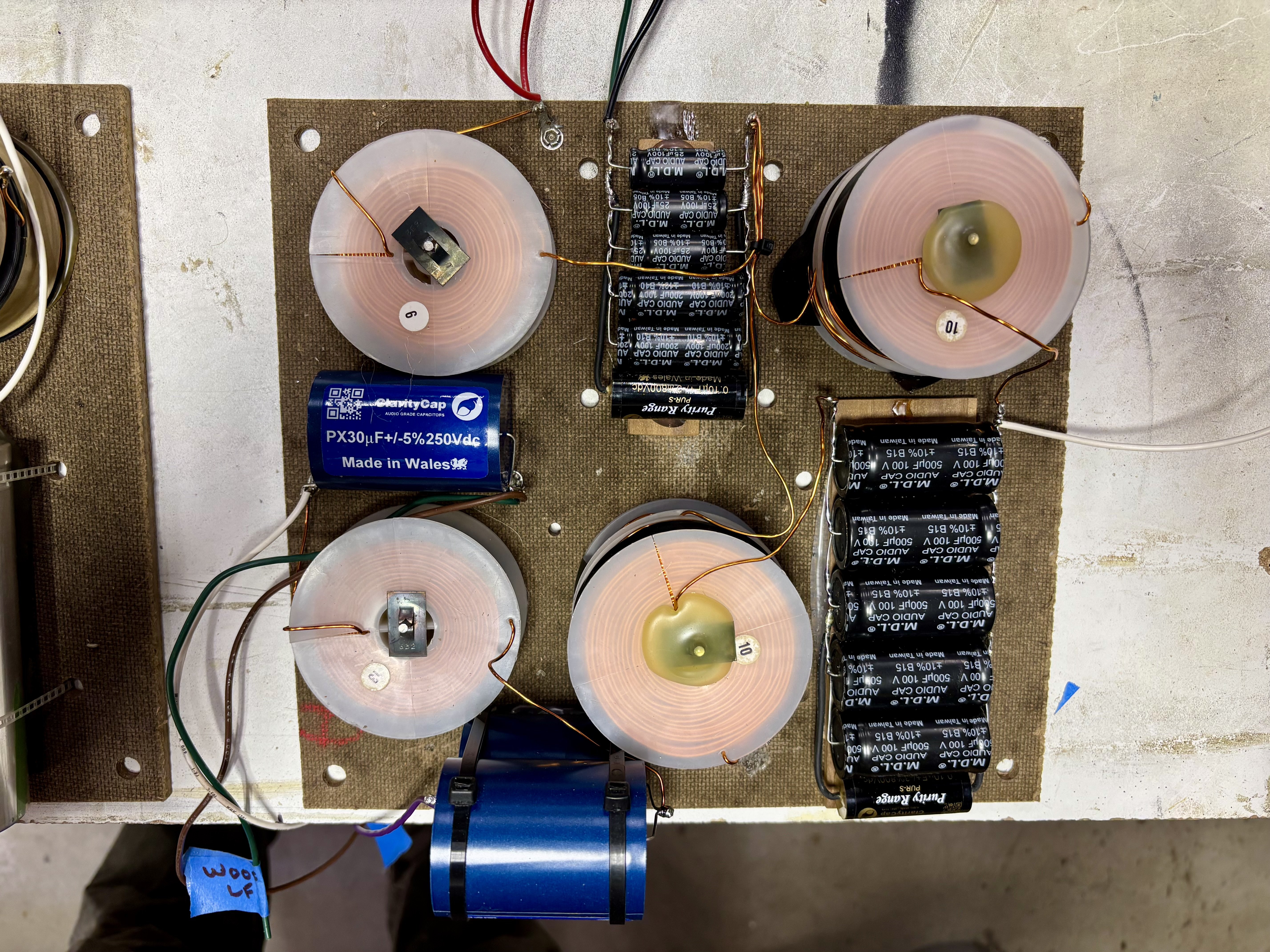

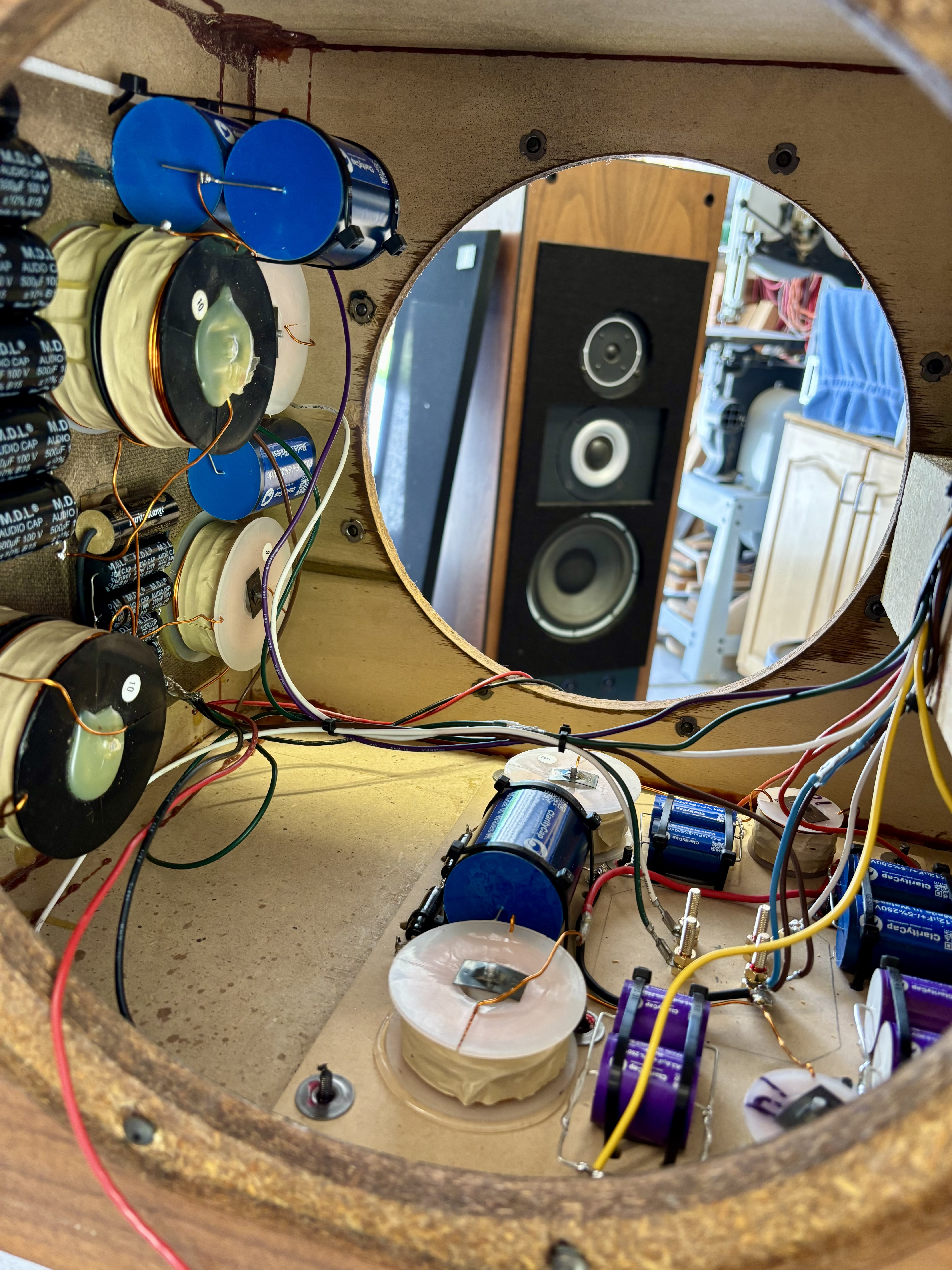

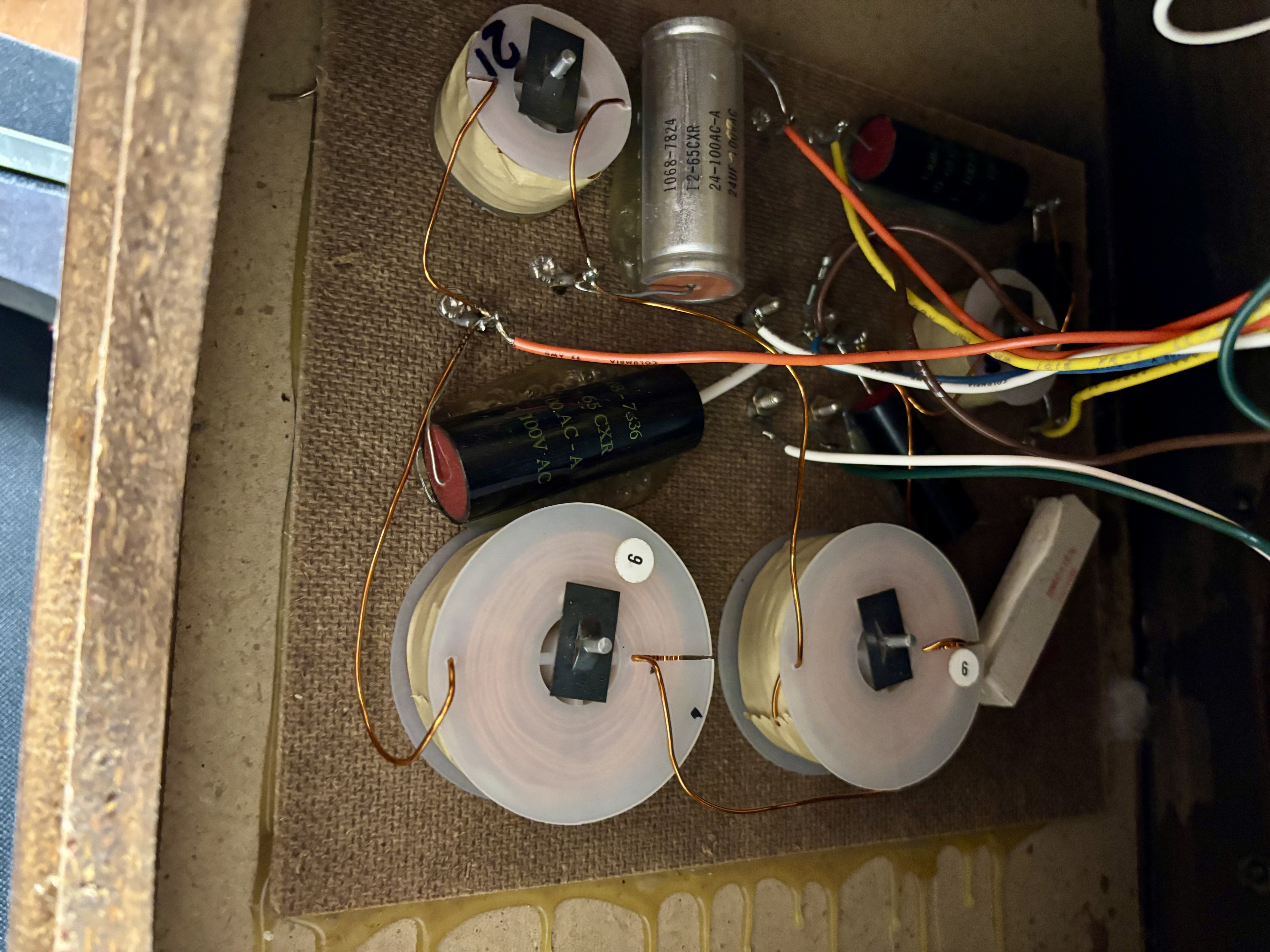

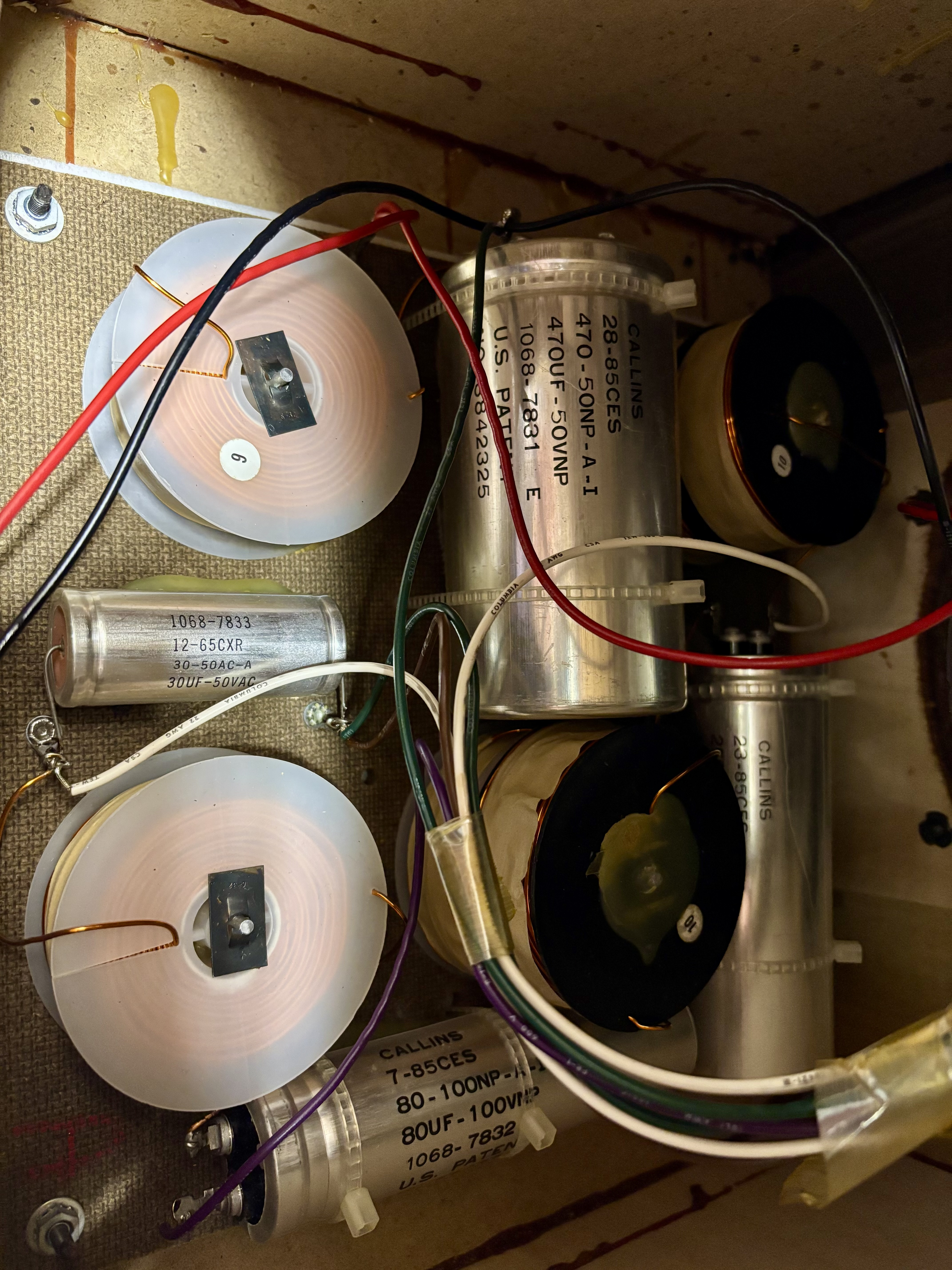

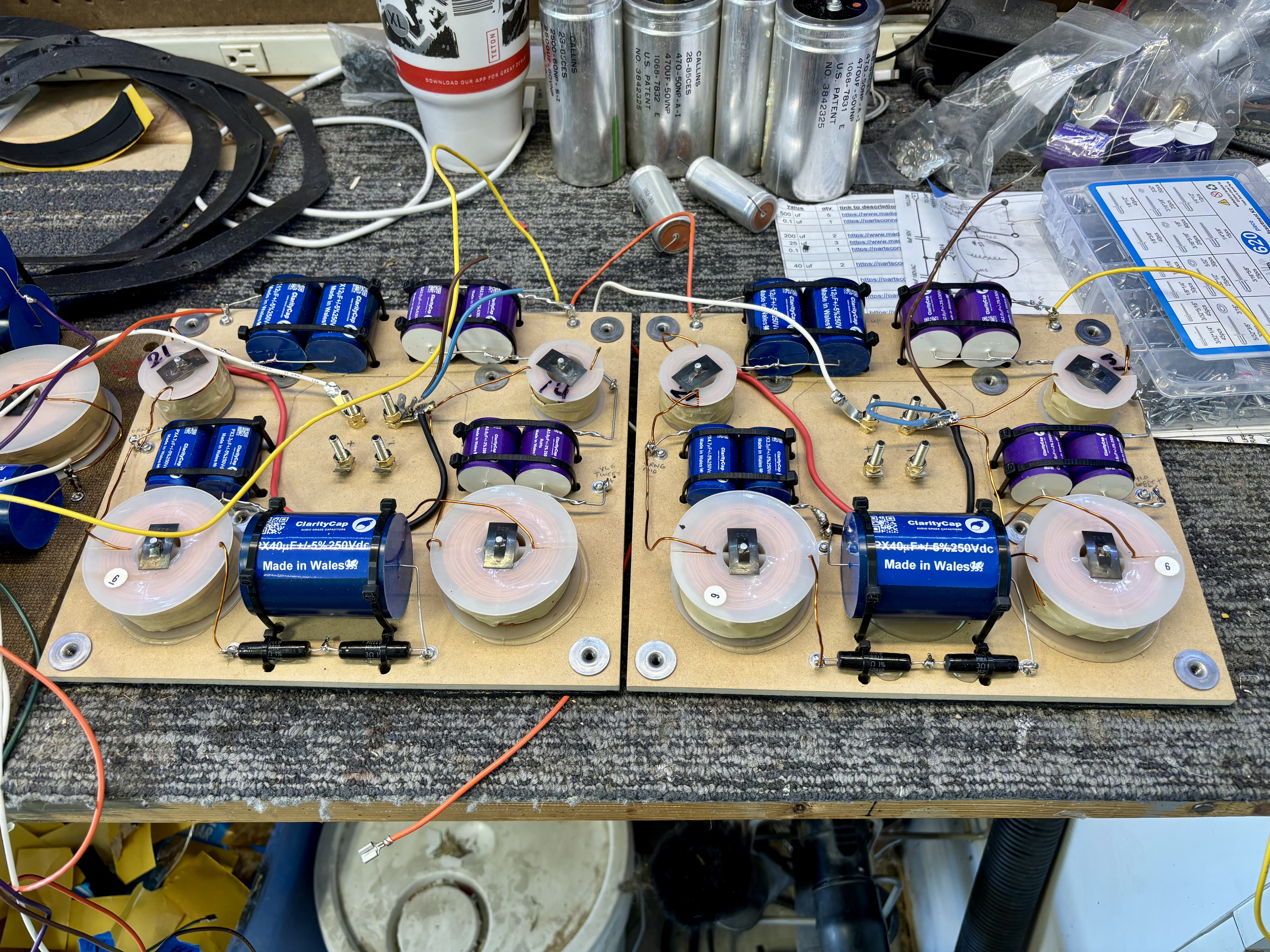

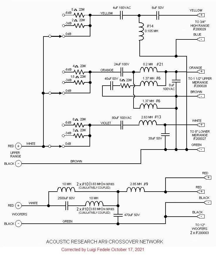

I popped a woofer and saw that the low frequency 470 and 2500uF caps were literally the size of coke cans, no exaggeration. Three of them tested bad zero capacitance. Lots of new electrolytics in parallel later with Clarity bypass films and some Clarity for the 8” midwoofers and the low end was done.

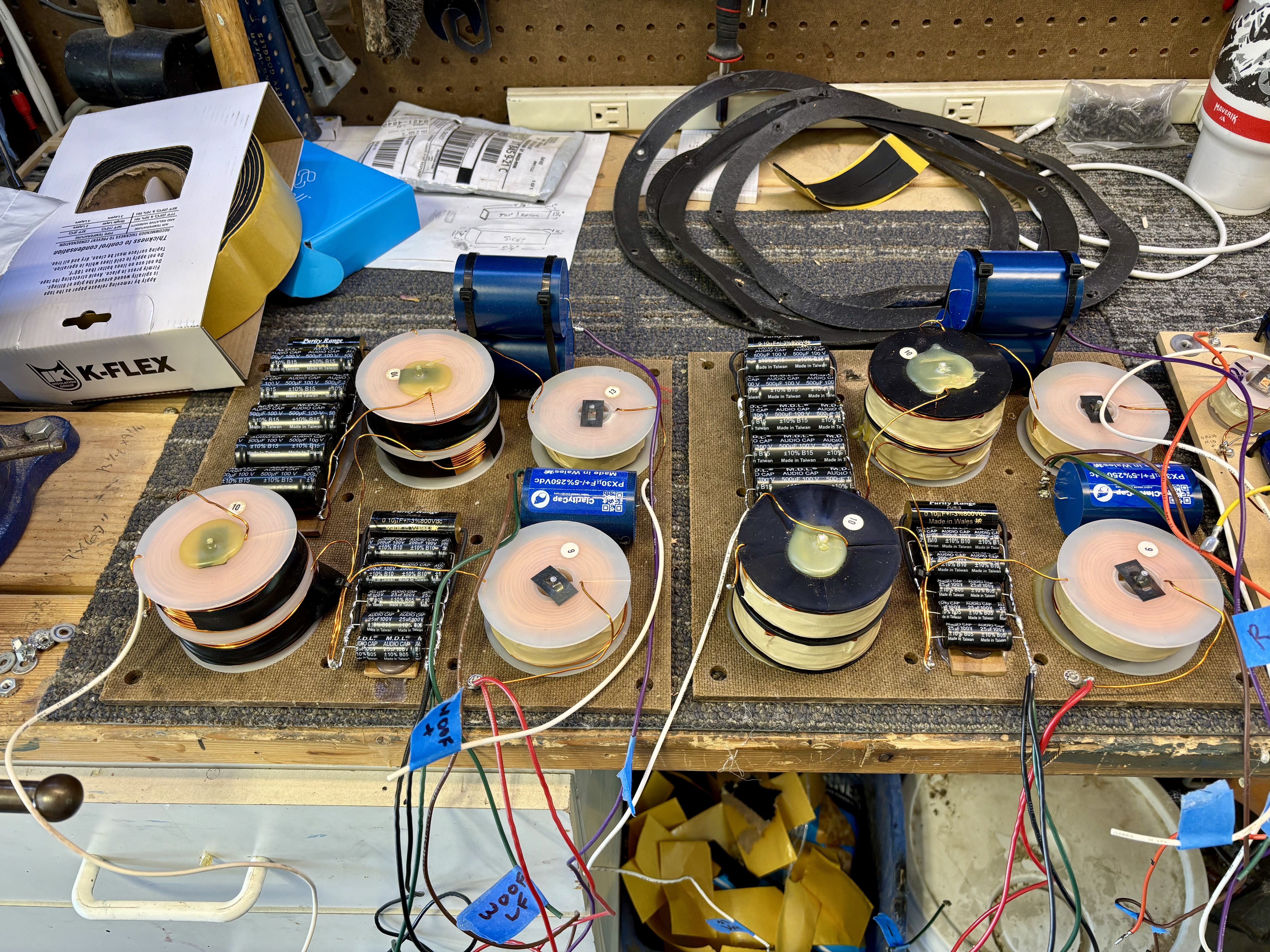

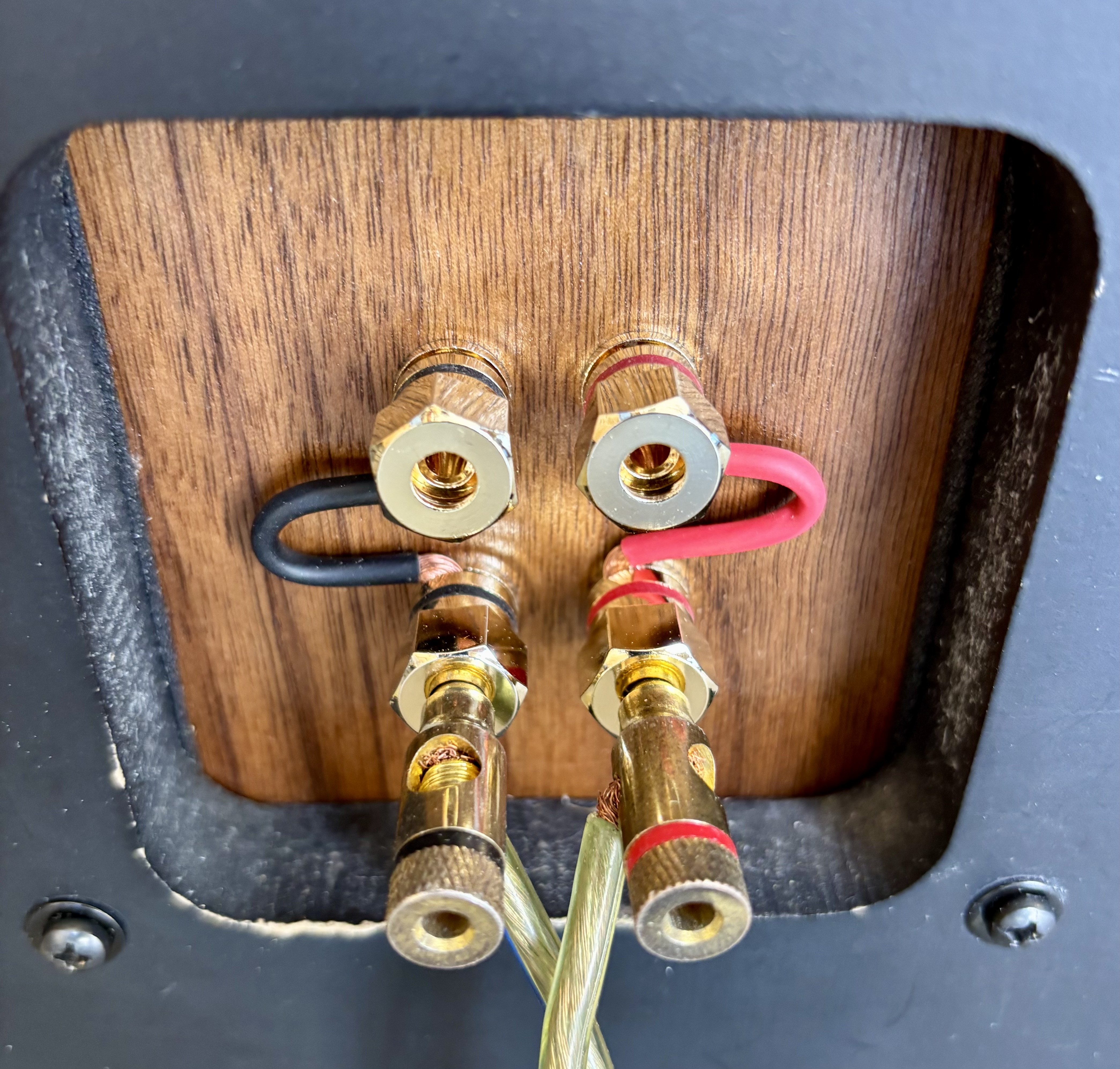

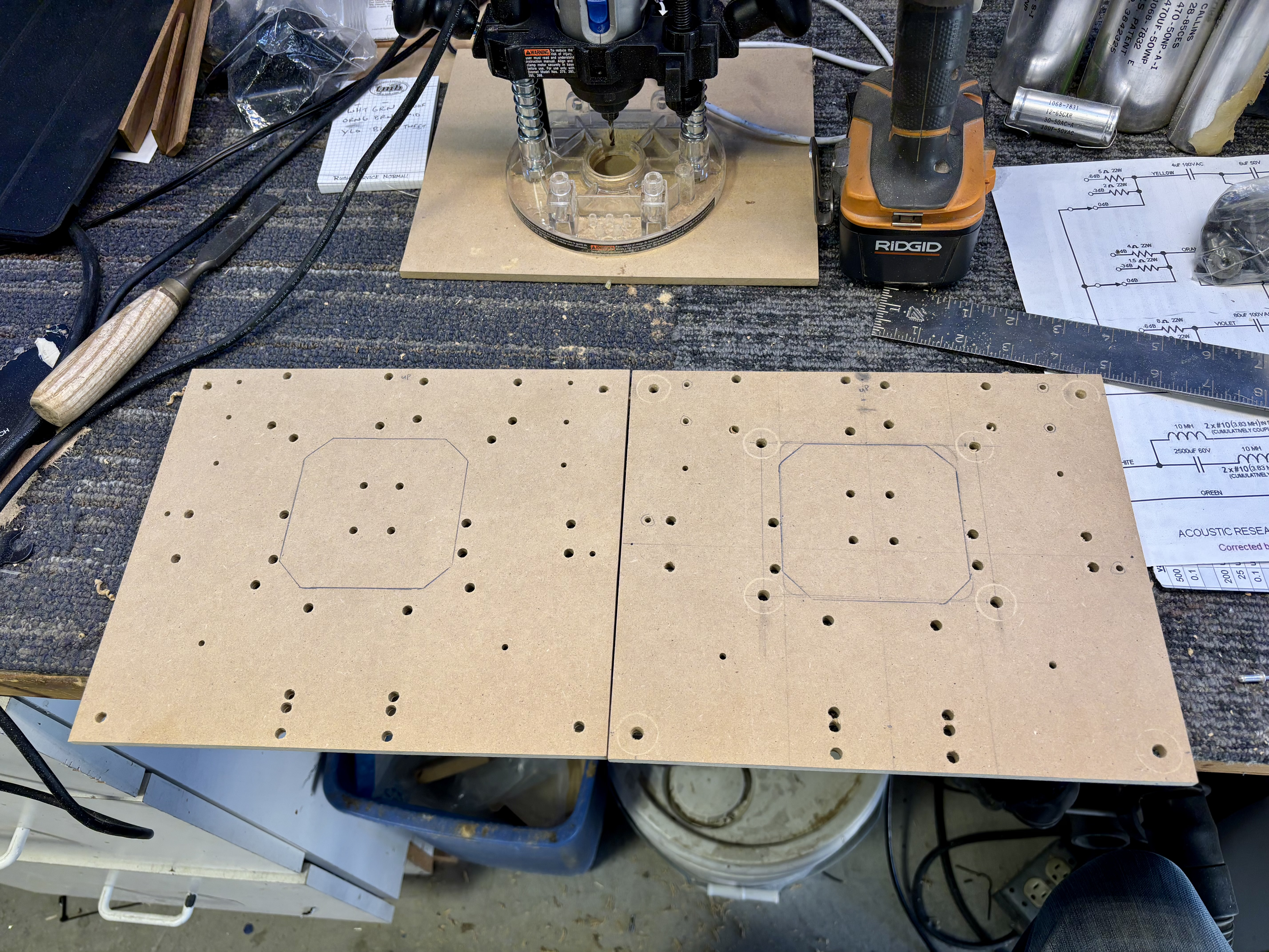

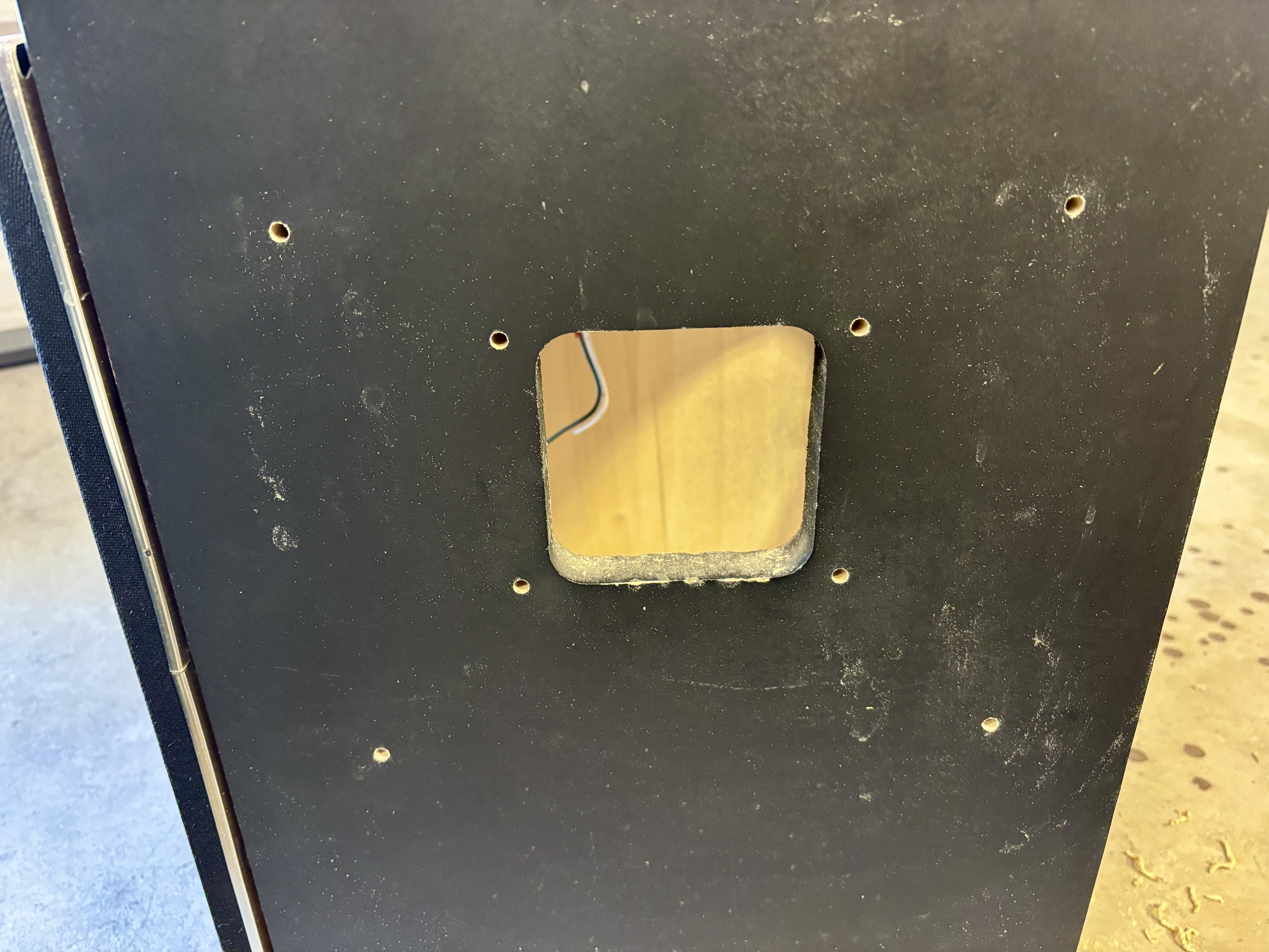

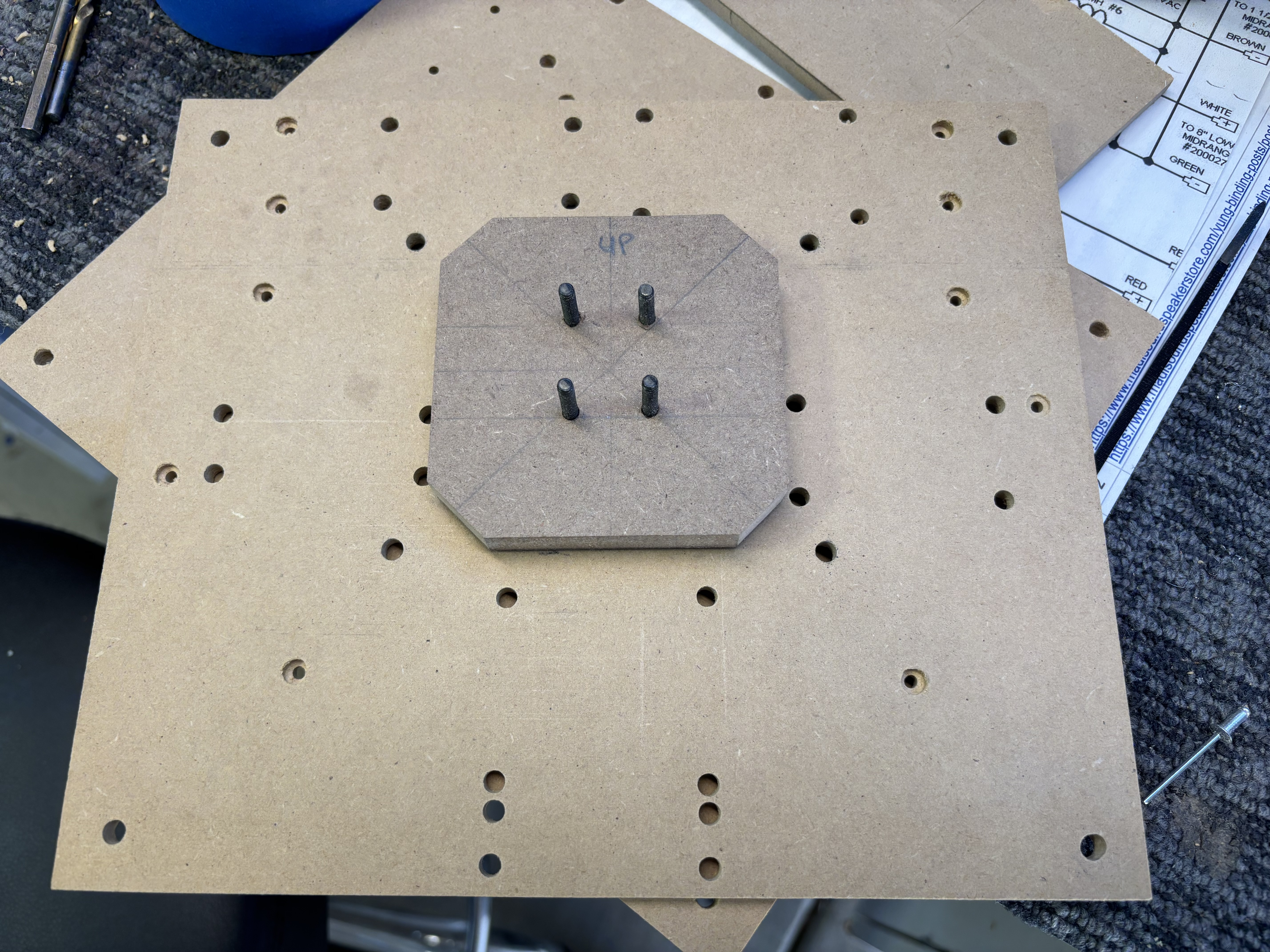

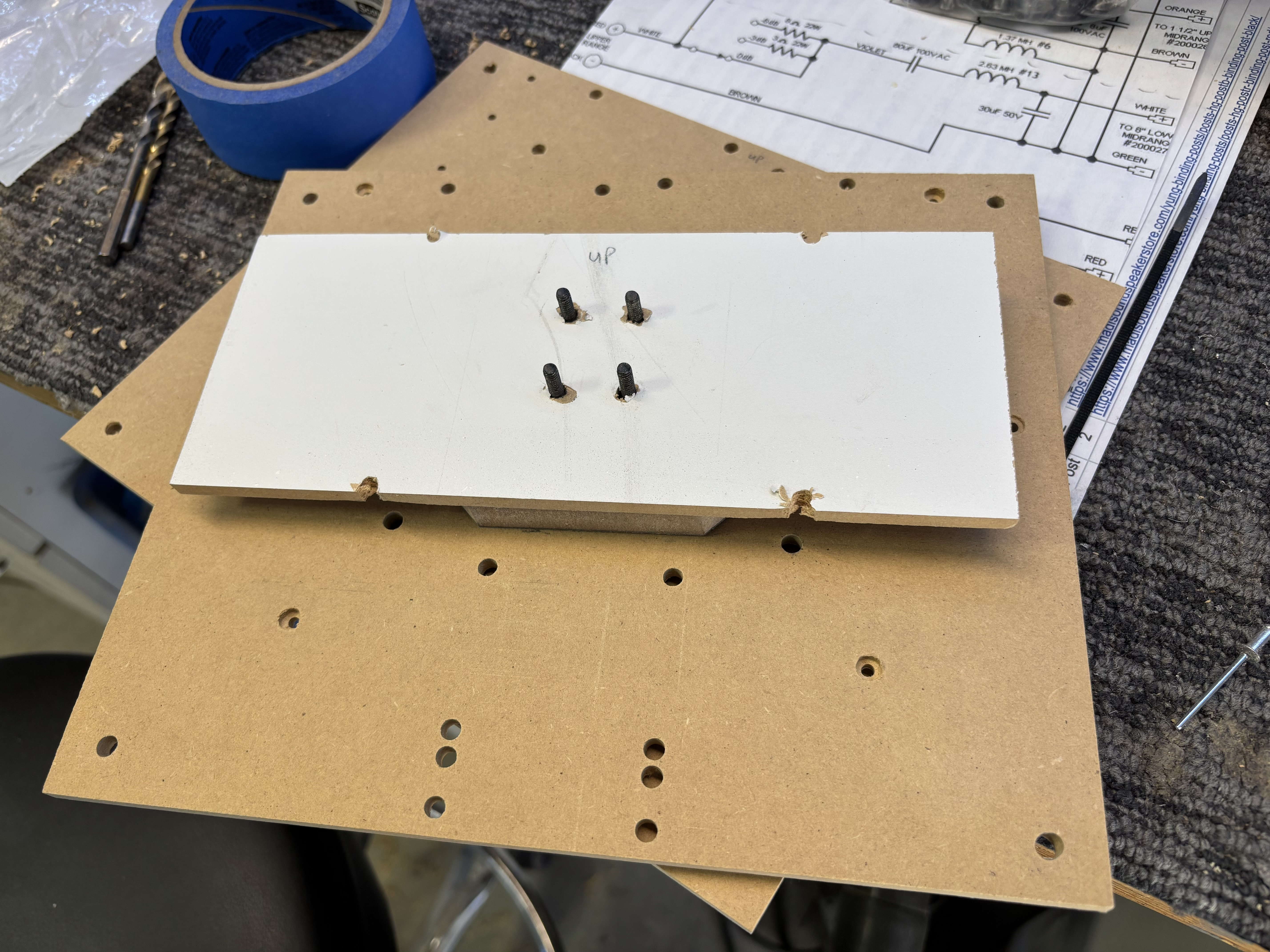

The high frequency sections of the crossovers were glued in and had to be pried out, I broke the boards in the process. So I built new boards for those sections. I lined the backs of them with gasket material and built an alignment jig that allowed me to drill holes to mount the boards with screws and hurricane nuts. I veneered the terminal recess with walnut and did some of the Bennic HG posts from Madisound, I really like those. All new Clarity caps for the HF section.

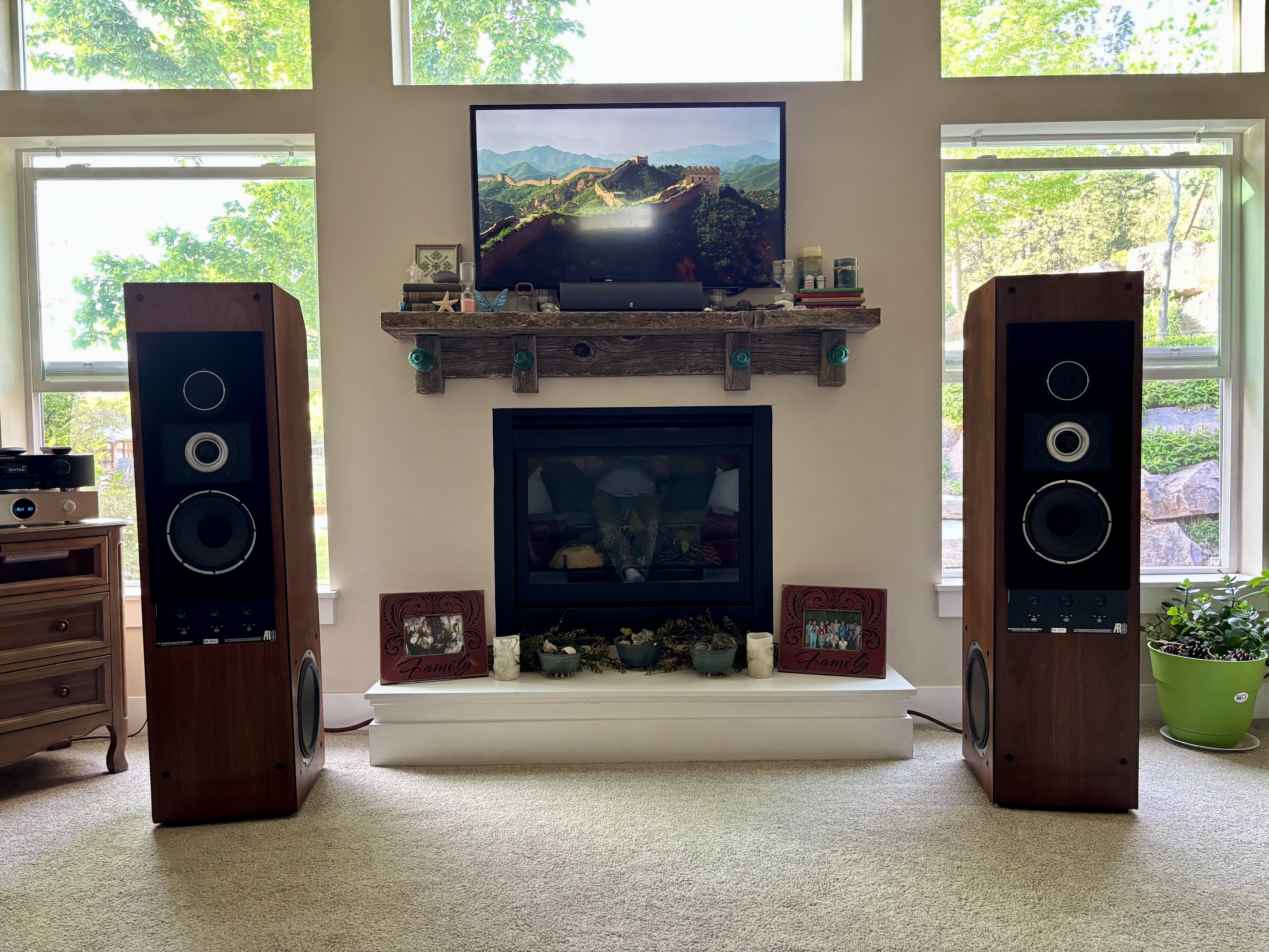

He didn’t want to replace internal wiring so I didn’t go that far, but after all was said and done, holy cow. Resolution is off the charts. Silky smooth from top to bottom. Biamped, they really performed well. The low frequency section benefited from more grunt - I used a 555ii for that and a Music Hall integrated at 50wpc for the top end during testing. Really a fun project, but A LOT of work. He is happy and now, on to the next project…

    They look great in their final listening spot!
