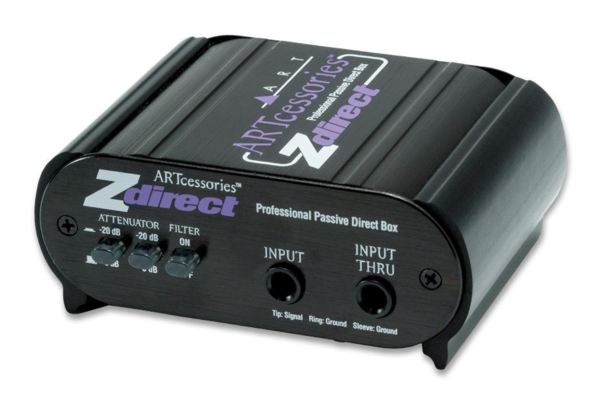

    This concept of how to invert the polarity of a single ended signal has been running in the back of my mind and I believe I've come up with a possible solution. One idea would be to use something like this:
    Basically it would take a single ended input (in this example it is a 1/4" plug, so you would need an adapter to go from RCA to 1/4" plug. Then into the box and select the "inverse" (found on the other side of the box, trust me) button. Then use an XLR to RCA cable for the rest of the connection.
    Whenever the "bridging" feature is part of the amplifier's design this happens in one of the interstage parts of the circuit. Most probably between the driver and output stages. This is more of a thought experiment, rather than something anybody needs to do.

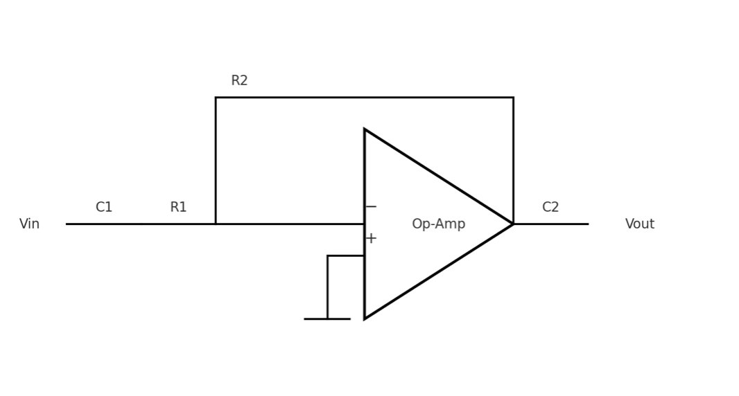

    A better approach would be to use a unity-gain op-amp configuration which would require a power supply. But it would invert the polarity and not bugger the sound very much. This is probably what most professional inverters use.
