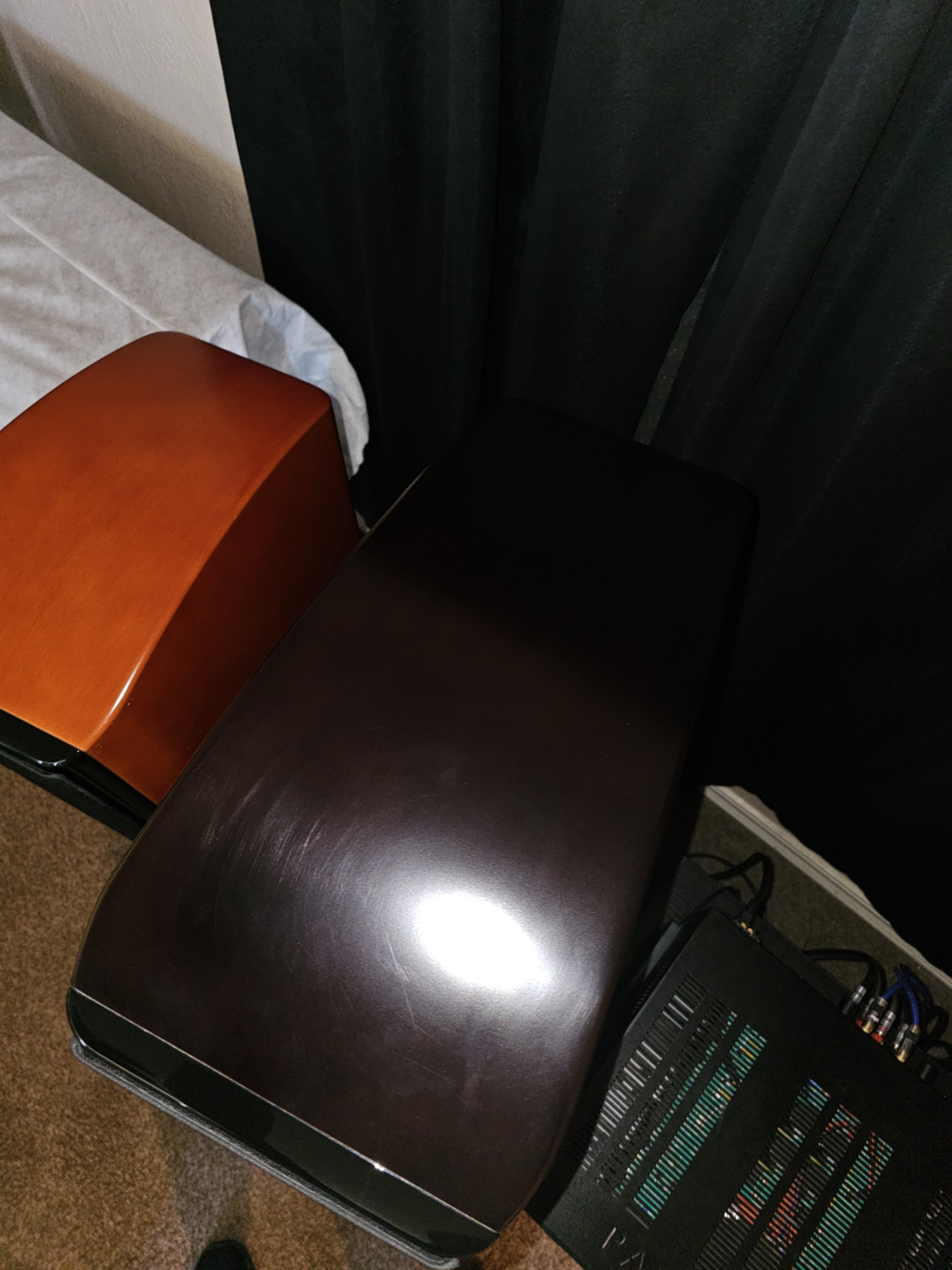

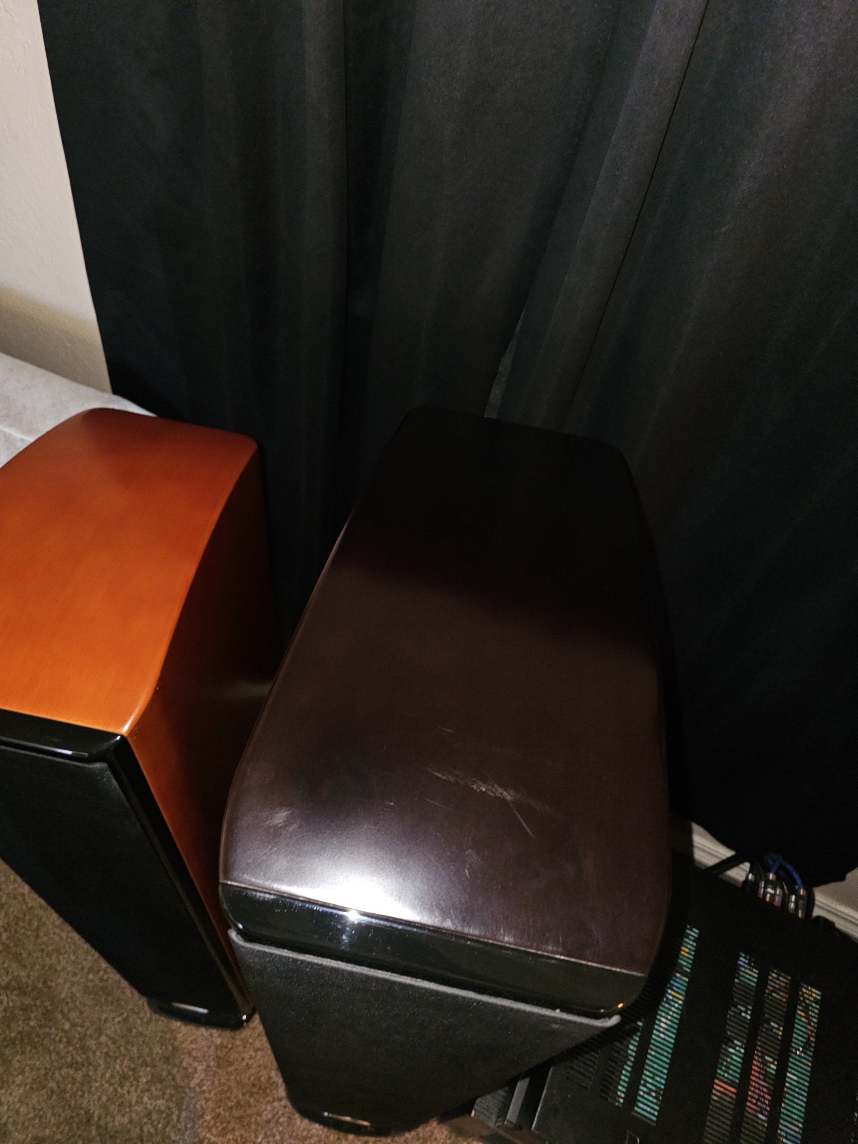

    Please take a look. I have marks like that all over the speakers. I want to restore my 707.

    Someone has not been kind to them.
    As a professional I can say there's no easy solution for you to do at home. Basically, they need to be wet sanded, perhaps up to 2000 grit, then resprayed with 10-15 sheen lacquer. Therefore, I suggest you seek out a pro shop.

    As previously mentioned, there is nothing that will easily remove those scratches. It is possible that a good quality furniture polish (non-silicone based) might lessen the look of some of the scratches, but otherwise, take it to a pro. I wouldn't try to use auto products.
