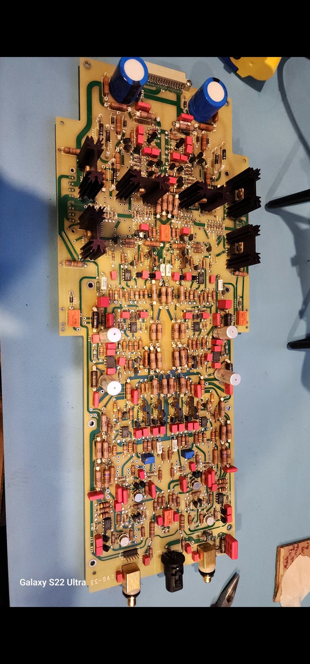

    I found a handful of suspect parts that seem to be associated with some nearby op amps (which are in line with those resistors)

    Some of the guys at diyaudio have changed out the 555 timer to a lower noise ICM7555IPAZ, I guess it's the heart of the oscillator so to speak.
    I sourced a military version of the ad705aq so I ordered 20 (minimum order). This opamp is used in a few other places in the amp as well.
    There is also a new version replacement of another ic I will go ahead and replace.
    I plan to rebuild the control board before I order anymore regenerator parts.
    The fun continues!

    So all caps replaced... Electrolytic, film, ceramic.
    Replaced all relays
    Replaced both op amps... The old ones measured good on the tester but I ordered 75 new ones so... Why not replace!
    Replaced around 40 resistors. I wanted to replace one pair but no one carried an equivalent quality. The resistor still measures perfect but just looks like it has been hot in the past. All of the resistors I installed are further from the board as well.
    Finally catching up to where I can tackle this again! Should be able to knock some out this week for sure! 😁

    Obviously it would be nice that it worked once I'm done hahahhahhahahhaha but I've learned alot working on it so far and gathered tools that will be helpful for future projects.
    The biggest investment so far have been Desoldering tips... Jeebus those bad boys are expensive but you definitely have to have the right size for different size pads, no question!
