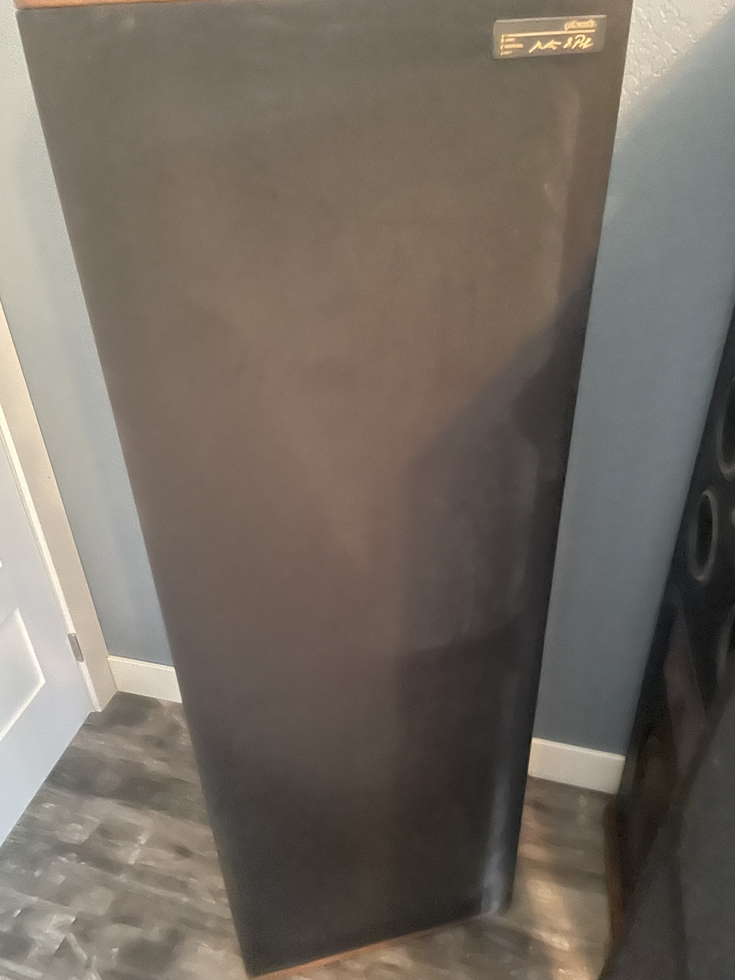

Bought these from original owner about 15 years ago. Didn’t have the drive to really acquire proper amp and select a proper listening room. Since then life’s been busy and these have been inside in a dry heated bedroom.

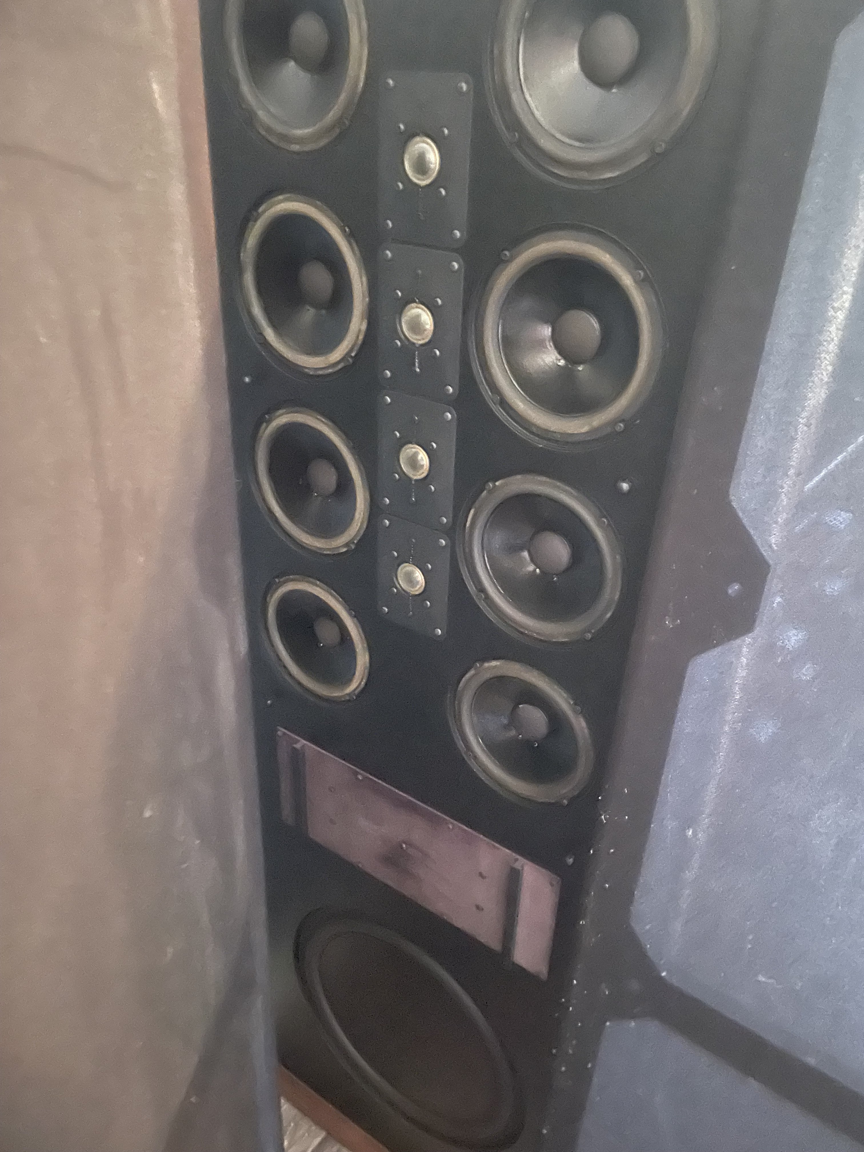

At this point I’m torn. Do I keep them and upgrade as needed (I’ve heard tweeters and crossovers)? Are parts still available and any idea on budget to do so? When I stored these they sounded beautiful and would guess they still do. I have carver amp and preamp. Don’t remember the output. Seems like 250-300w if I remember correctly. They sang with that little amp but you could tell it was just scratching the surface of their ability.

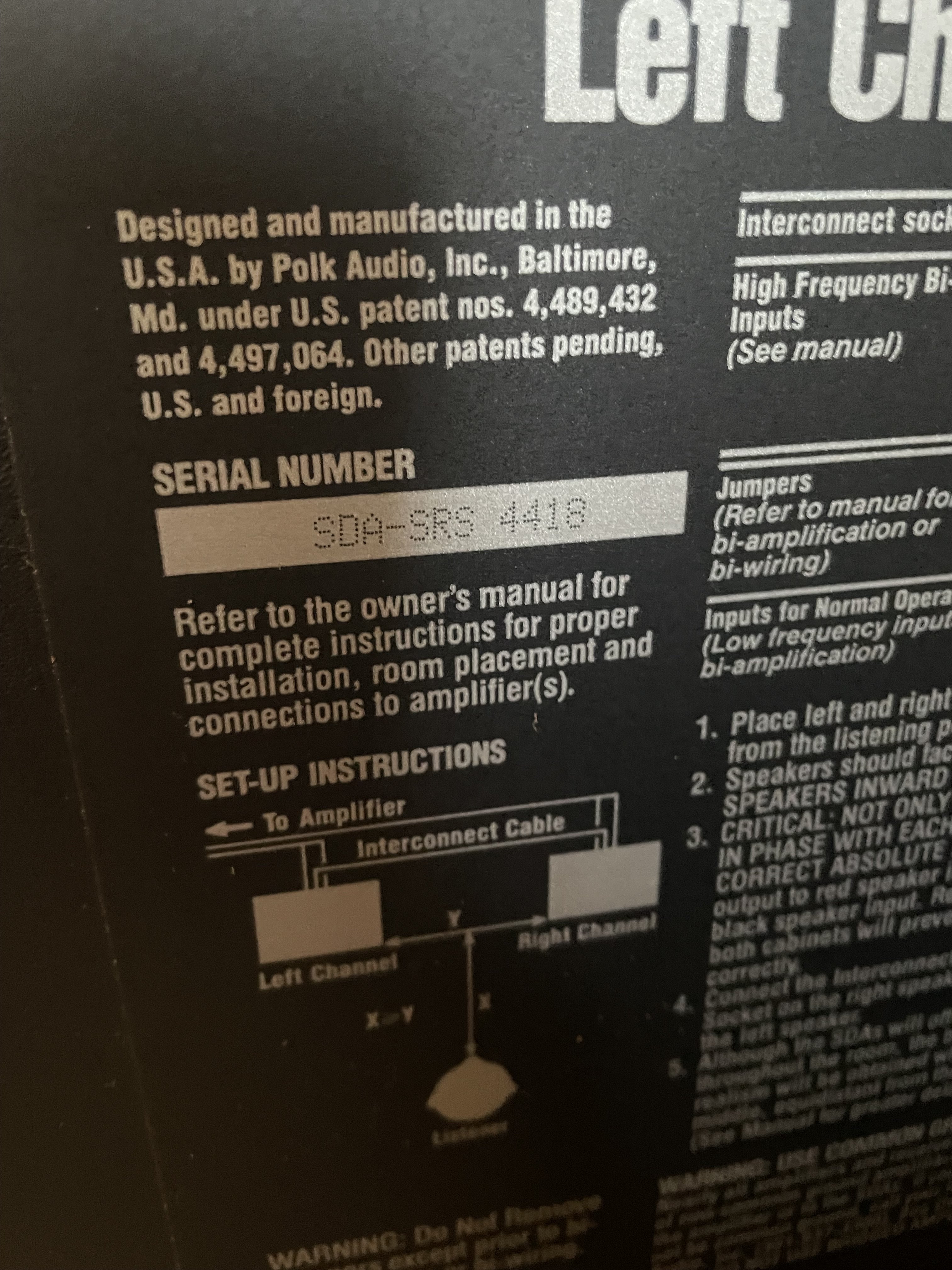

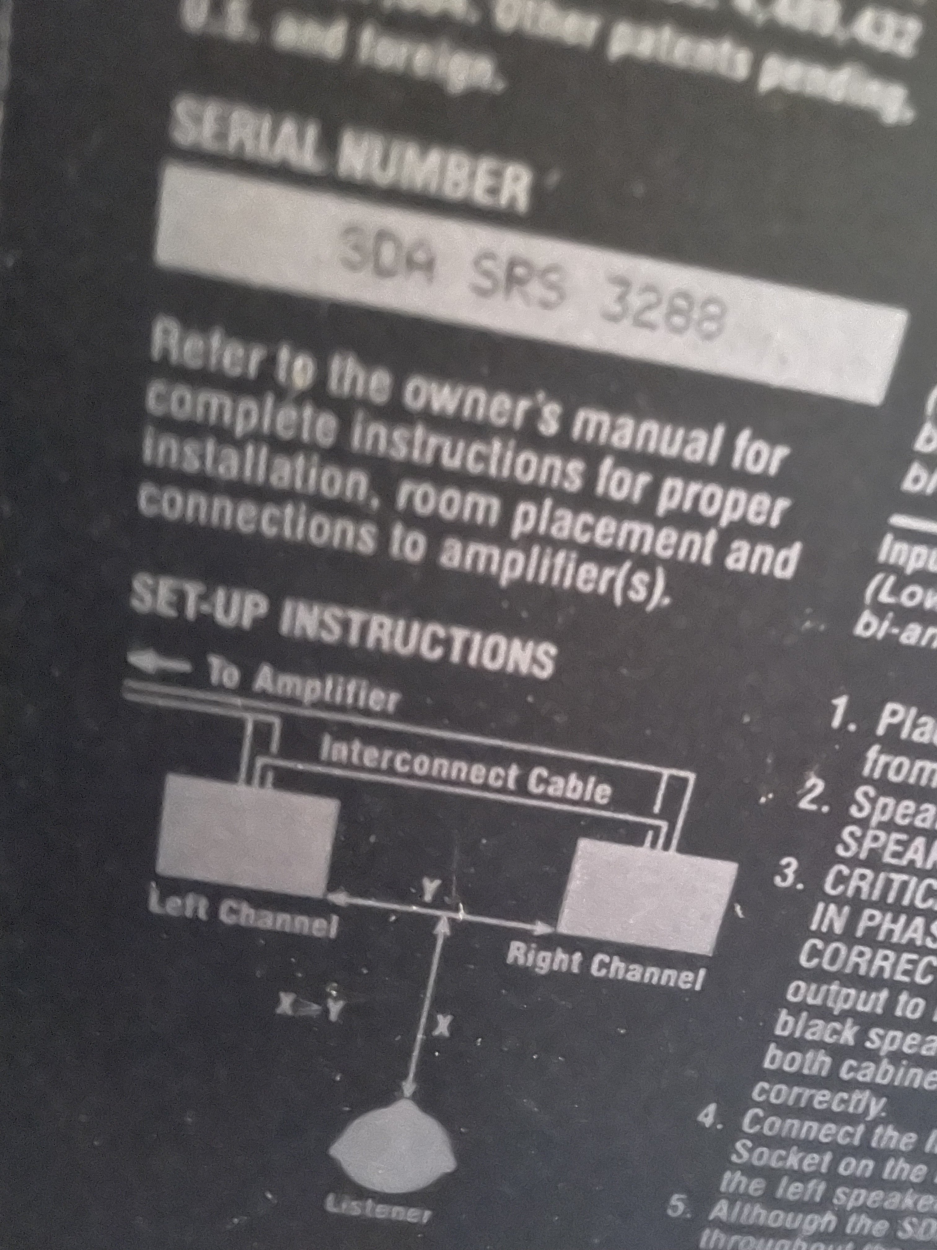

-what model are these?
-upgrade parts recommendation and approximate budget to upgrade?

Attached pics are shown with dust included. Carefully blowing that off now

    Original SDA SRS with the SL2000 tweeters, which look like they have seen better days. The proper replacement is the RD0(zero)194-1.
    Plenty of crossover upgrade info in here. The cost can be from reasonable to damn expensive.

    Thx F1! Kinda what I was guessing too. I’ll look into upgrade cost. In your opinion is there value in upgrading these based on final results / cost?

    Thx guys! I was more trying to find a typical budget for upgrading tweeters and crossovers if that’s what’s normally done here. I want to keep these and enjoy them.
    F1nut Posts: 52,244
    The tweeters are about $62.00 each. Crossover component costs vary depending on what you choose.
    The schematic is posted on the forum, so you can see the cap and resistor values, then go shopping. Do not use Solen, Bennic or Dayton in the high pass circuit.
