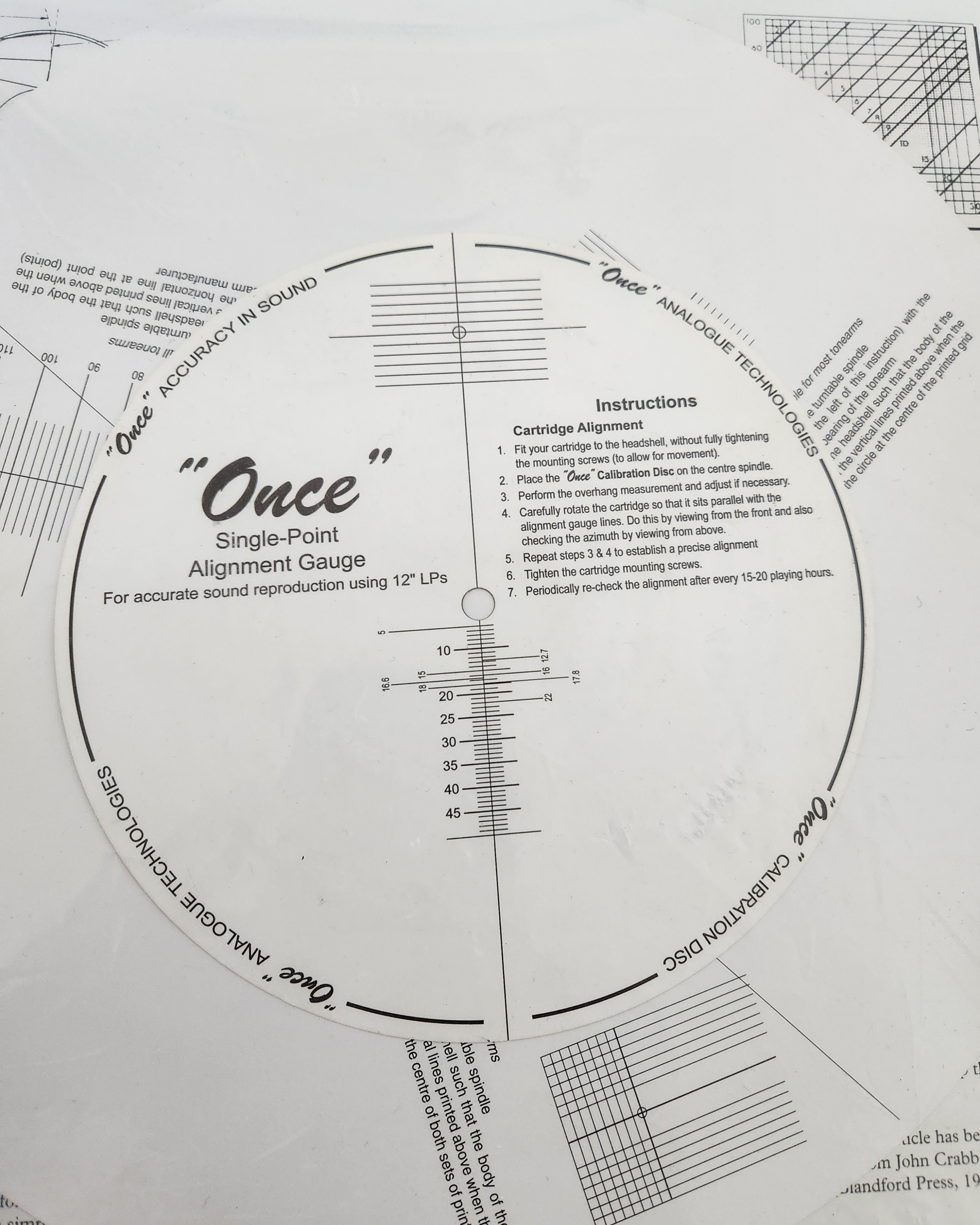

    I like to have the arm close to neutral balance before aligning a cartridge so I don't stress the cantilever with excess tracking force. What is the method VPI uses for aligning cartridge with that arm? Overhang or protractor?
    Pivoted arms will have an overhang spec, that is center of spindle to tip of stylus. Some arms won't swing over spindle to use an overhang gauge. When they did, alignment was so easy.
