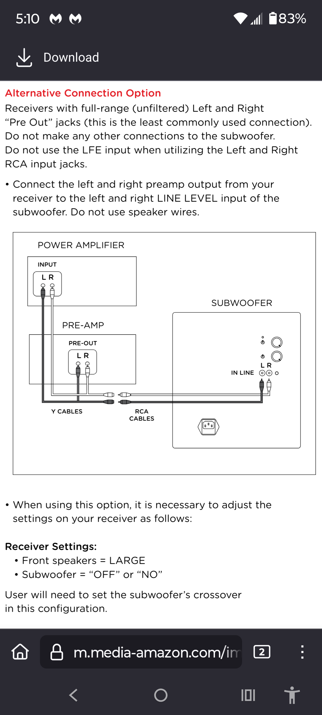

    Thanks for the quick and on-point answer. Are you sure that if I should follow the L/R route, there won't be any problem? I am asking because this case isn't described in the sub-woofer's manual. In other sub-woofers' manuals my case was described, but not here.
    pitdogg2 Posts: 27,883
    Are you sure, from the manual.
